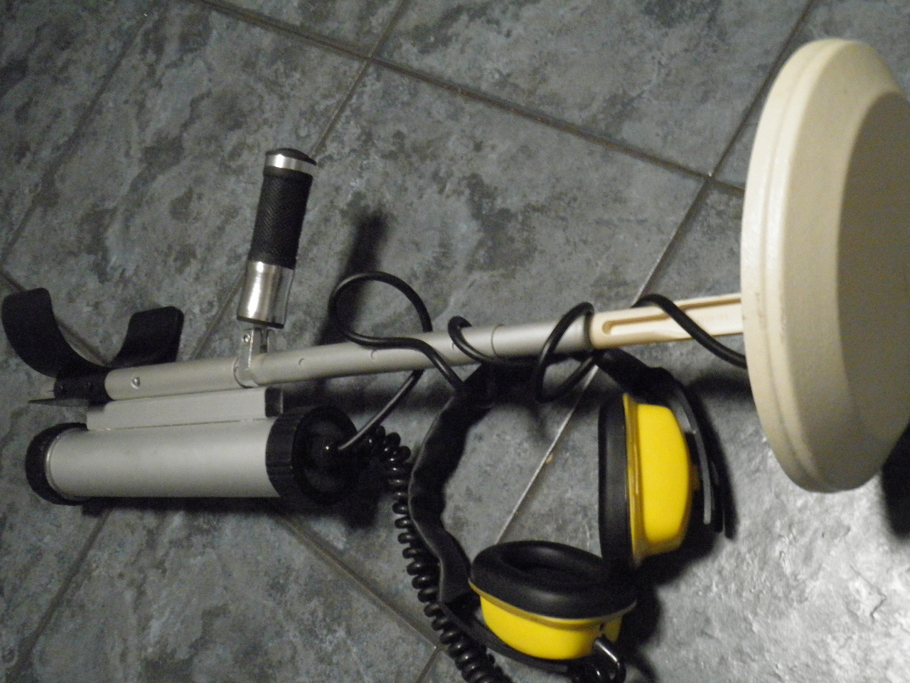

                                here is my underwater Click image for larger version
ID:	342813Click image for larger version
ID:	342813surf 1.2 finished
