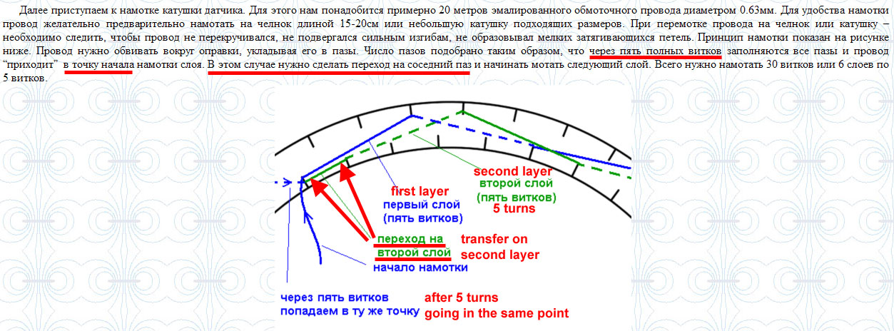

      Has anyone a complete set of instructions for making a Basket Weave Coil? I've made an oval template with 37 slots as per another thread. And looked at the Russian image with English translations. However, when I practice with string, after 15 or so turns, my results look nothing like the images I've seen. What I understand from the Russian image, starting from the top side,you progress 3 slots, on the underside 4 slots, for 5 turns. Is this maintained throughout the 32 +- turns, or is there a change in pattern after 5 turns?

        Its not complicated after 5 turns the wire drops into the same slot that you started with , move the wire forward 1 slot push wire through to other side and wind another 5 turns,
        The 2nd winding starts on the other side of the former and each time you move 1 slot the next winding starts on opposite side of former.
        You move forward 1 slot every 5 turns
        just look at my pictures

            this is called 'a transfer on another/following layer'. after you notice a turn goes at a turn its way you have to make the STEP on one slot.
                Some pictures might be wrong. You skip 2 slots on top and bottom.
                When the wire try's to go back into a slot you already used go forward
                one slot, this takes you to the opposite side for the next loop...
