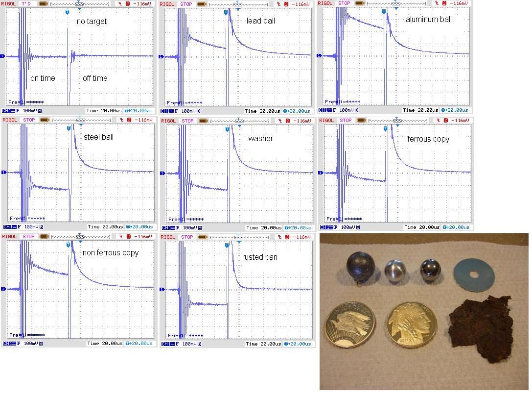

    Very good results. Looks like it works better than the Racetrack coil alone. The ferrite and other target responses during on time is especially interesting. It would be interesting to see the effect of lead and aluminum targets during the on time.
    Could you spread the two round coils apart until they achieve individual inductive balance above each end of the Racetrack coil. This would be a rough simulation of a DODD coil as found in a mikebg post below. The fourth coil L3 is not needed. The individual inductive balances might reduce the spikes and ringing.

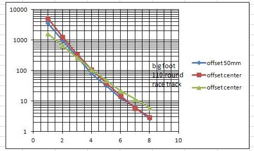

    Including a chart comparing the three coils at there best offset. The big foot and round are close. The racetrack looses strength at shorter distances but gains at longer distances due to the larger radius.
    Can't spread these coils apart because I glued them together to keep IB.

      Hi Green
      In the Post #14 chart; do the ferrite and nail charts change polarity during 'on time' when you move the target from one coil to the other coil?

        Hi Chet
        The answer is yes, The best picture isn't always in the center of the round, 50mm offset. More scope pictures.
          Hi Green
          Great work! It looks like it may be possible to use the "on-time" measurements for discrimination on strong target signals. Its also interesting how the rusty piece of can is similar to a ferrite core response.

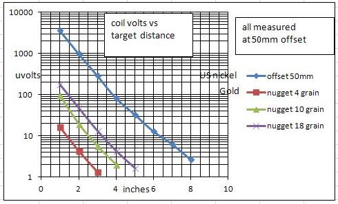

            A chart for gold nuggets using the 110mm round big foot coil. Dan posted awhile back comparing a target in the air and with the coil laying on the ground. He got a lower signal with the coil on the ground. I have a 11 x 10 x .5 inch zip lock bag with clay from the yard that I used to compare. The signal was slightly higher with the coil on the bag. I'm not sure if it means anything other than comparing the signal strength with a US nickel. For charting the coil is laying on a concrete block for stability. Actually I was comparing the coil on the block vs the clay. Sampling between 6 and 10 usec does effect the signal with the different time constants.
              Hi Green
              Good results on small nuggets. In your previous scope shots; maybe a damping resistor across each of the round coils would stop the ringing?

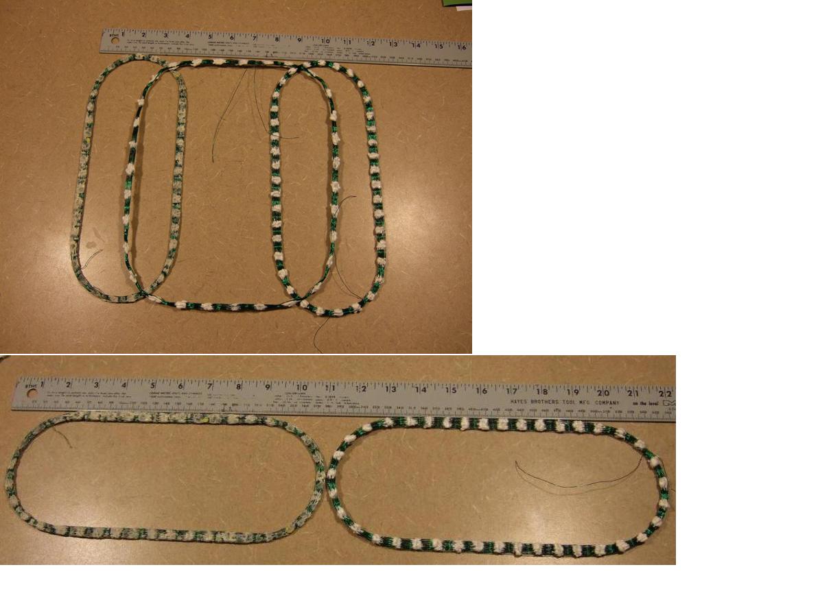

                  Building another coil. Have form for a racetrack coil,110mm x 170mm outside, that I tested before. Thinking could overlap two coils like a DD. end to end Rx and a Tx (big foot), side by side Rx and a Tx, separate side by side Rx with side by side Tx to IB like reply #15. Since each Rx is IB with the Tx should the Rx coils be in or out of phase? I've found a good way to learn is to predict what will happen before doing it. Any idea which one would be better and if any will be a complete flop? I'll post my predictions before testing.

                    Hi Green
                    Out of phase is my suggestion; out of phase provides ground balance and EMI cancelation.
                    It might be beneficial to have the receiver coils spaced above or below the transmit coil approximately 10mm. This should reduce capacitive coupling and loading on the transmit coil allowing the transmit flyback pulse to collapse faster. This spacing might also reduce the ringing effect in the receive coils.
                    I suggest leaving long leads on the receive coils to allow fine balancing of the null then glue the leads in place to maintain the null.
                    I think bunch winding of the receiver coils would be ok since there should not be a collapsing field within them.
                    Also the receiver coils could have two or three times more turns to achieve some signal gain.

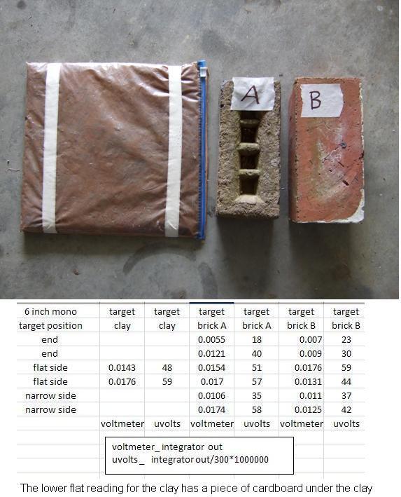

                        Hi, Green.
                        Thanks for the interesting post. If you get the opportunity, can you check how your coils respond to clay bricks?
                        Most of the ground were I live causes a reaction in PI detectors much like a red clay brick. I'm thinking it would cause havoc with the IB feature of you coil. In all fairness, it would have to be a several bricks.

                          Thanks for the replies. I had 1 racetrack already built, so I'll have to try some of the suggestions next time. Starting with the side by side and double racetrack. The double racetrack would have to have a lot higher signal strength since it doesn't cancel noise and EF. If I remember right I don't think it would be easy to discriminate ferrous either. Just a comparison test for signal strength. Thinking it might be easier to keep the side by side coil parallel to the ground vs the big foot for GB. Don't know if a long big foot swinging in an arc, different speed would cause a problem with EF reject. Signal strength for the 110mm round and the big foot were the same, so the big foot has to be quite long to get depth. Maybe good not bad. Picture of the coils included. The Tx is a little smaller than I would have liked. Think the Rx close together will be better than spread apart. When I first saw the picture spread apart I was thinking each one was IB with the Tx, but they don't need to be if one is inverted. To cancel ground both Rx coils need to see the same signal. I have some clay that I can detect, I'll try it to see how easy it might be to keep the same signal on both Rx coils. Need to make Tx for big foot.
                            [QUOTE
                            When I first saw the picture spread apart I was thinking each one was IB with the Tx, but they don't need to be if one is inverted. To cancel ground both Rx coils need to see the same signal. I have some clay that I can detect, I'll try it to see how easy it might be to keep the same signal on both Rx coils. Need to make Tx for big foot.[/QUOTE]
                            Hi Green
                            I think both Rx coils need to see the same small amount of transmit signal. To do that most effectively I think they need to be individually zero balanced with the transmitter coil. Otherwise one will have considerably more transmit/flyback signal which will unbalance small target signal response between receiver coils. In other words one coil will be less sensitive to small targets than the other.

                              Tried the 110mm round_bigfoot with the 10 x 11 x .5 inch sip lock bag of clay. With the bag over half, near but not touching the coil I get (coil volts) (660uv) during on time and (40uv)average between 6 and 10 usec after turn off. With bag over the whole coil I can adjust bag to get less than (1uv), but it's a fine adjustment.. Probably need the option to GB if needed.
                                Got a couple bricks to try. Used the 6 inch mono coil since that is what is connected. The bricks fave a different signal strength depending on position. One end or opposite end,same with sides. A 5/8 inch thick board was used to space targets from coil. The bricks didn't cover the whole coil. Signal strength similar to the clay.
