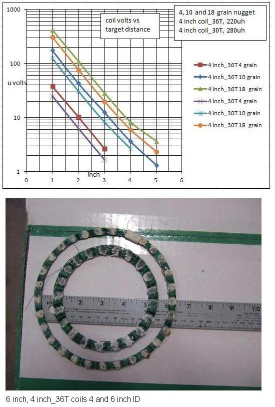

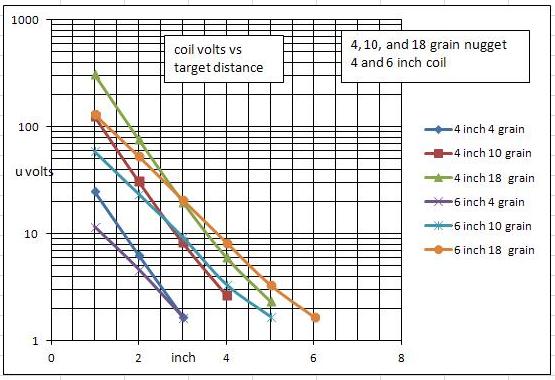

    I tried the coils in reply #27. Without shielding and making rigid it's hard to get good numbers. I didn't see anything yet that would make me want to make a finished coil with them. The double race track did look it might discriminate. Maybe I'll try one with the two race track coils. I think I like the big foot style better since it cancels EF,reduces noise and ground. Think I'll try a larger double round next. Charted a 4 and 6 inch round mono coil with the gold nuggets to see if a certain size might be better for nugget detection. The spiderweb coils wind a lower inductance than I expected so the signal strength would be a little higher with more turns. 4 inch(220uh) 6 inch(230uh). Don't know what uvolt level can expect to detect on the ground. If 10uvolts the 6 inch coil might be a good. If 1uvolt, should try a larger coil. 1 amp peak current, higher current might help.

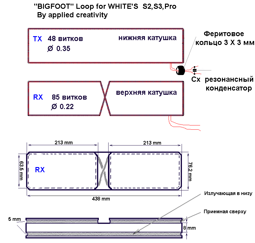

        Here is one way to make bigfoot, easily adapted for 3:1 PI, and former made from cardboard made in few minutes.

          No, it's potted. When I do another one I will try to get 300uh+. Looking at the chart in reply#31 I would have to almost double the turns to gain .5 inch in detection distance. 1000uh coil. I am curious what a few turns would do. After looking at it I think not much. Another thought. The added turns would increase the diameter with the spiderweb coil, maybe more change than I was thinking>

              Hi 6666
              Are the numbers 48 - 0.35 and 85 - 0.22 the number of turns and the size of wire?
              Thank you,
              Chet
                Hi Chet disregard the wire information the text on the picture is of a bigfoot for a whites S2-S3,
                the former could be used to make a 3:1 PI bigfoot, just wind the tx and wind the RX 8.
                I guess the word bigfoot has become a bit generic.
                Its just the shape I was showing, a bigfoot is a large TX and the smaller RX wound or twisted in an 8 shape
                and this former makes it easy to make.

                  Thanks for the picture of the big foot coil. It would make it easier to make. I've been using magnet wire and for me the bundle wind doesn't allow fast enough sampling. I started calling it a big foot style because somewhere in the forum I saw to make a figure 8 coil, make a round and twist it into a figure 8. No mention of a Tx and Rx.

                        Made another 4 inch coil. The first had 30T, the second 36T. still not enough for 300uh. The 4 and 6 inch are ID. Got a a higher increase in signal than I expected. Have to use a higher turn increase than I've been using for the spiderweb coils. Hi Chet, thanks for the reply. Some things to think about and try.
                              If this is a flat spiral coil, then 36 turns will not be enough for 300uH. The Coil Calculator estimates 36 turns will give 310uH, but that is for a tightly bound circular coil with 0.56mm wire.
