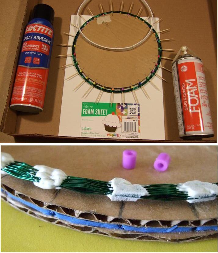

      Are you useing foam to stick in the tooth picks ?
      Yes I use a 2mm craft foam sheet sandwiched between two pieces of cardboard. If you are interested I could put together instructions on how I'm doing it now. I'm still learning so things keep changing.
          Yes please, would be interested to see it, thanks.
                          Started to do the instructions last night building a 8 in coil. The inductance didn't match calculated. Might be a few more days to post instructions. I'm trying to learn more on winding coils.

                            • #59
                              A way to wind a spiderweb coil. I used materials that I already have. (1)The beads, spacers I use are 5mm long, so cut a cardboard disk with a diameter 10mm less than desired inside coil diameter. (2)Cut a piece of the foam about 1 inch larger than the disk.(tape pieces of foam together with masking tape if needed). (3)Spray one side of cardboard disk and one side of the foam(not taped side) with the contact adhesive, let dry(follow instructions on can). (4) Stick together and trim foam. (5)Cut a piece of cardboard about 1 inch larger than the disk. (6)Remove masking tape from foam if needed and repeat step (3). (7) Stick together and trim cardboard. 8 Cut some 10mm wide foam strips, enough to wrap around coil. Glue strips together with super glue(cyanoacrylate). (9) Wrap foam around coil disk and cut to length. The foam was 620mm long for the 8 inch coil I was making. For ease of marking I've been using 10, 15, or 20 mm spacing. 620/20 equals 31. Need a odd number. For some reason I used 29. The foam will stretch. Mark the foam strip, cut to length and glue the ends together. Wrap band around coil form and mark cardboard, Remove foam band and poke tooth picks in foam, about 10mm. Tape wire to disk. Put 6 or 8 beads on the tooth picks. I go under over and pinch the over tooth pick and repeat. Add 6 or 8 beads as needed and repeat. I put a mark on a piece of paper each revolution so I don't loose track of turns count. I use insulating foam at the crossover points to keep things together before removing tooth picks. I'll add instructions for how I shield the coil later.
                              • #60
