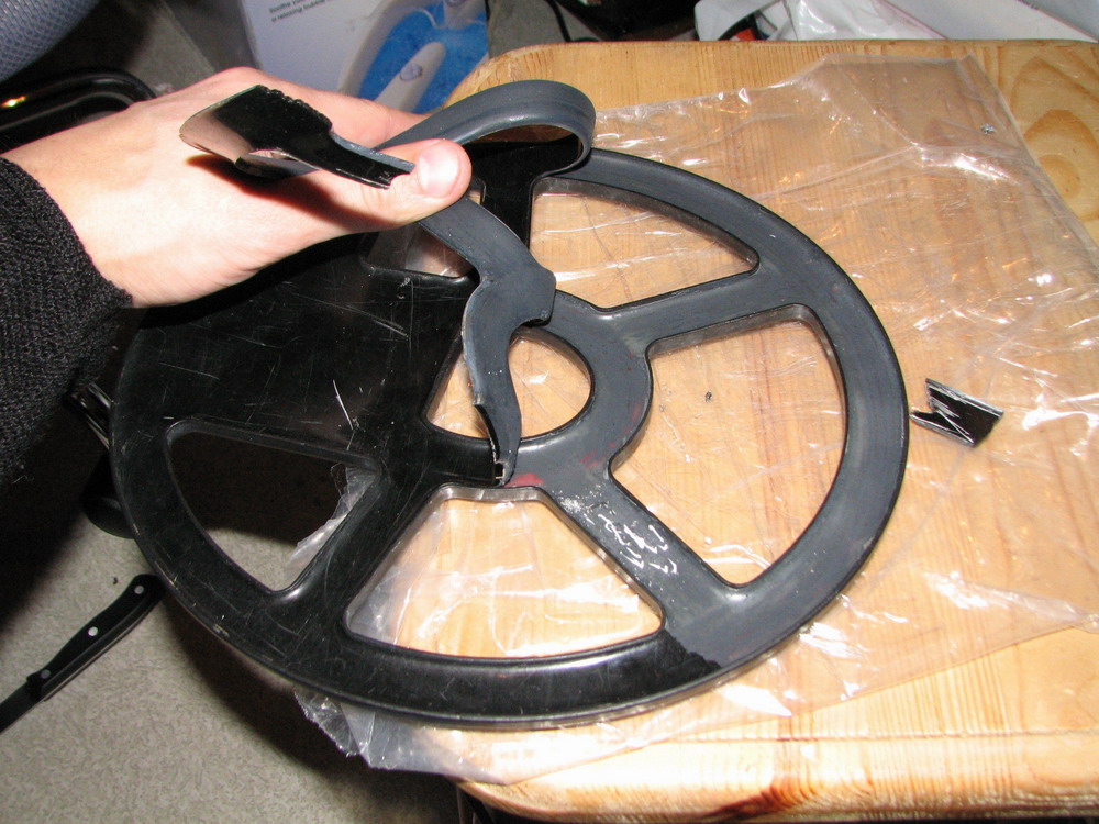

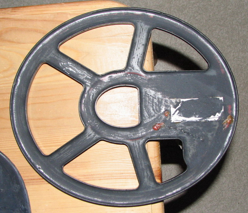

        look attentionally again intoinside the tesoro coil. a big problem of much people with high elecronics base knowladge they do not understand for what making the shielded layer, where it is and why. under resin you can see graphite layer, on another pic a bare wire in this layer touchingtogether to this layer. DO THIS WAY.

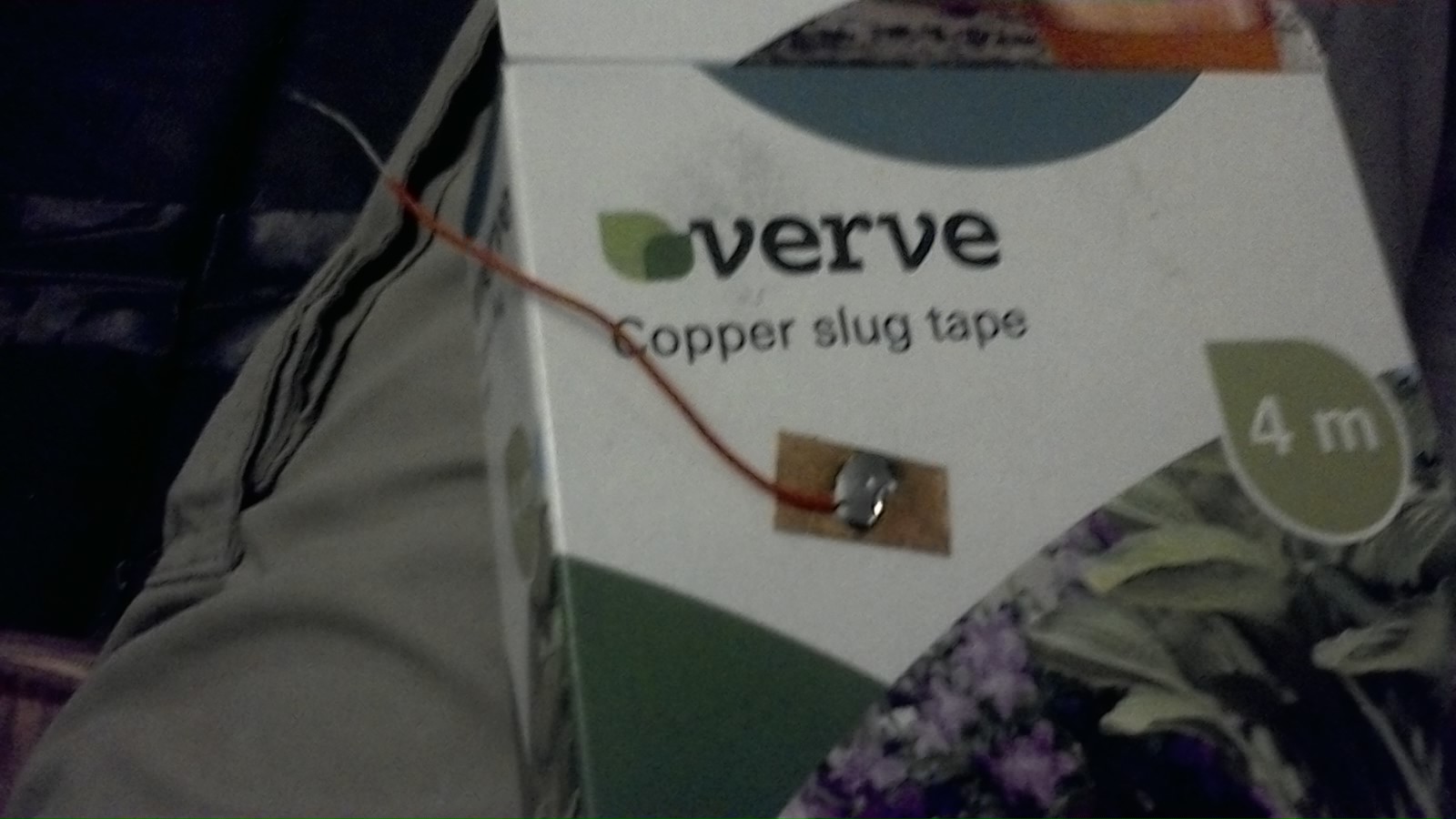

          Resin layer. Shield layer. Resin layer is the way I did it. Both top on bottom of coil. Also used a bare wire but soldered it to a small square of copper to increase its surface area
            did you check by measuring (kOhm scale) from this copper to every part of graphite layer? did you make sure there is a galvanic electric link to every part of the layer from shield wire?
              Yes to both questions. Between 100K and 150K
              Just check the coil as I have cut it open to retrieve the strain relief and lugs. Re checking and the shield has dropped to 40 to 50K. Strange when I probe the shield the numbers take a while to settle down much like a capacitor ?????
                that is strange for me you use a cooper plate for 'to increase its surface area'. you can really increase
                a contact using second, 3th... 4th... wire webbed around. but ' small square of copper' i am not able grasp what
                you want to get. nobody making this way - not tesoro not whites not fisher etc.
                can you give the pics of inside of coil with it?

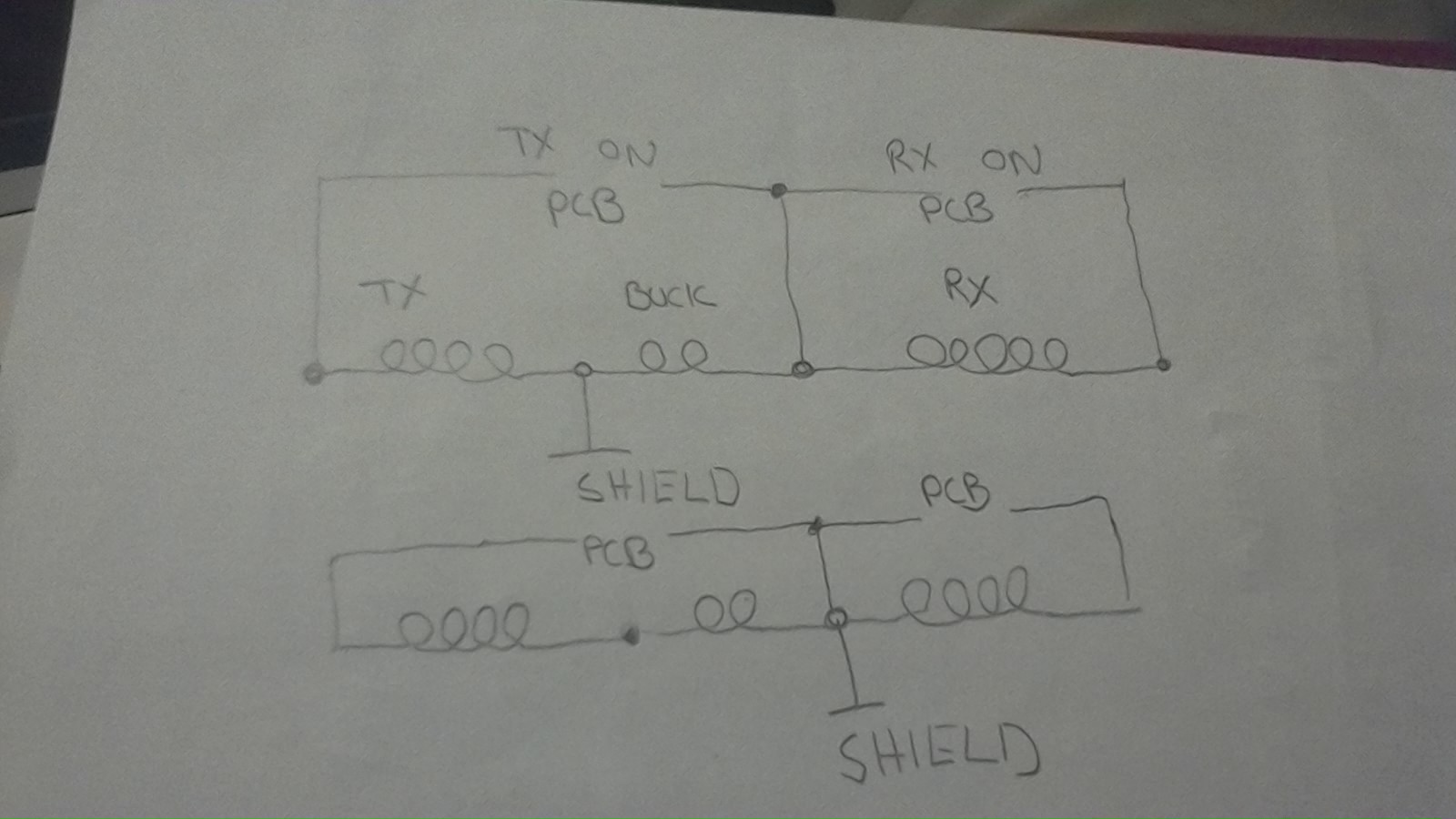

                    Which is the correct wiring connections
                    I have used the bottom one I suspect the shield should have been between the TX and buck as per top drawing
