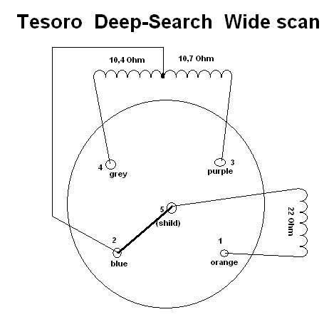

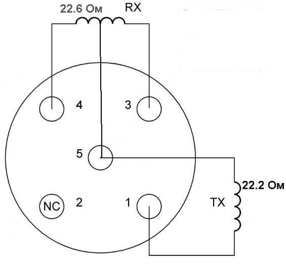

    change the wires tx <>rx. there is used differencial inputs of preopamp. so middle/general point ground related to RX winding.
      TXb is all ready connected to ground on the Bandido. Would connecting the centre of the TX to ground also short out the bucking coil ???? I am probably missing something obvious.
      No, proposed Wide-scan is DD design with (to ground) center tapped TX coil. Improper to same wiring in CC design. For CC design you wire according bottom drawing in your post #10. Main TX coil and bucking coil can be replaced by its position too, but you need to let possibilities to reverse bucking coil connection wires (if needed).
        why TX? i see in Golden umax schematic drawed by Carl M. CLASSIC tesoro's generator they use in all models.
        done on ONE transistor. so give some board/coil pics and schematics you see there center taped TX coil.

                  Sehnal jsem tovární cívku S.E.F. 5 pin pro Tesoro, má asi zapojení jak je na obrázku, na 10 kHz má posuv 40°, 12kHz - 50°, 15kHz - 75°(přibližné hodnoty), do 90° jsem pak měnil C12, v DISC. a dosahu žÃ¡dný velký rozdíl. Zapojil jsem pin 3,4 na RX, 1,2 na TX. Potíž je v nastavení GB, dost ovlivňuje nastavení DISC.
                    drawed by Foma

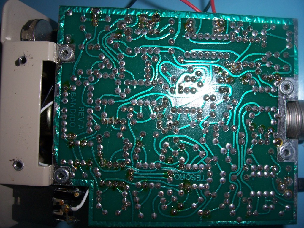

                      Ahhh built a new coil. Not happy depth is good but threshold pulses up and down about ounce a second very regular causing chirping in discrimination mode
                        can you send me bottom side pics of board? my email [email protected]
                        i need in high resolution pics.
                          Can't do hi res at the moment is all boxed up
                          The board details are in the Bambino SMT thread including the board files
                            i get Invalid User specified. If you followed a valid link, please notify the administrator
                            who is Bambino?
                              Bandido LOL autocorrect is good most of the time
                                bandido? for what? i asked you about Tesoro board. do not need in bandido.
