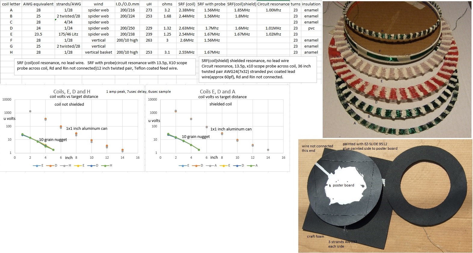

  • Hi Green
    Good test and good information. How much space is there between the coil and the painted surface?
    Thank you,
    Chet
    • Originally posted by Chet View Post
      Hi Green
      Thank you,
      Chet
      The craft foam is about 2mm thick. The painted surface is touching one side of the foam and the coil the other side of the foam so about 2mm.
        Hi Green
        Your results are sure much better than the copper screen that I have used in the past.
        Thank you again,
        Chet

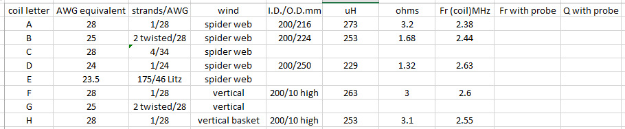

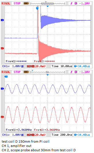

        • Was looking at target decays today with the bench PI . Put one of the coils I used for the Litz wire test over the test coil and saw resonance at amplifier out. All the test coils resonate closer to 4MHz than the 2.5MHz I get with my resonance tester(coil in series with a 1N4148 and a 2N3904 transistor switched on and off). I didn't think the diode would cause resonance to lower that much. Could it or is placing the coil over a operating PI circuit not giving me a true resonance? I don't have a signal generator to excite the coil to try measuring that way.
            Hi Green
            Maybe you are seeing harmonics. Otherwise the coil capacitance would have to be a little less than 5 pf to get as high as 4 mHz.

              You might be right. Including scope picture. Coil F connected to PI, coil H open circuit over PI coil. 6.8pf With the capacitance that low, maybe the diode or the capacitor coupling to the scope(twisted wire) might lower the resonance that much with my resonance tester.
              • Hi Green
                It doesn’t look like harmonics. 6.8pf sounds reasonable. Try two diodes in series it may cut the diode capacitance in half.

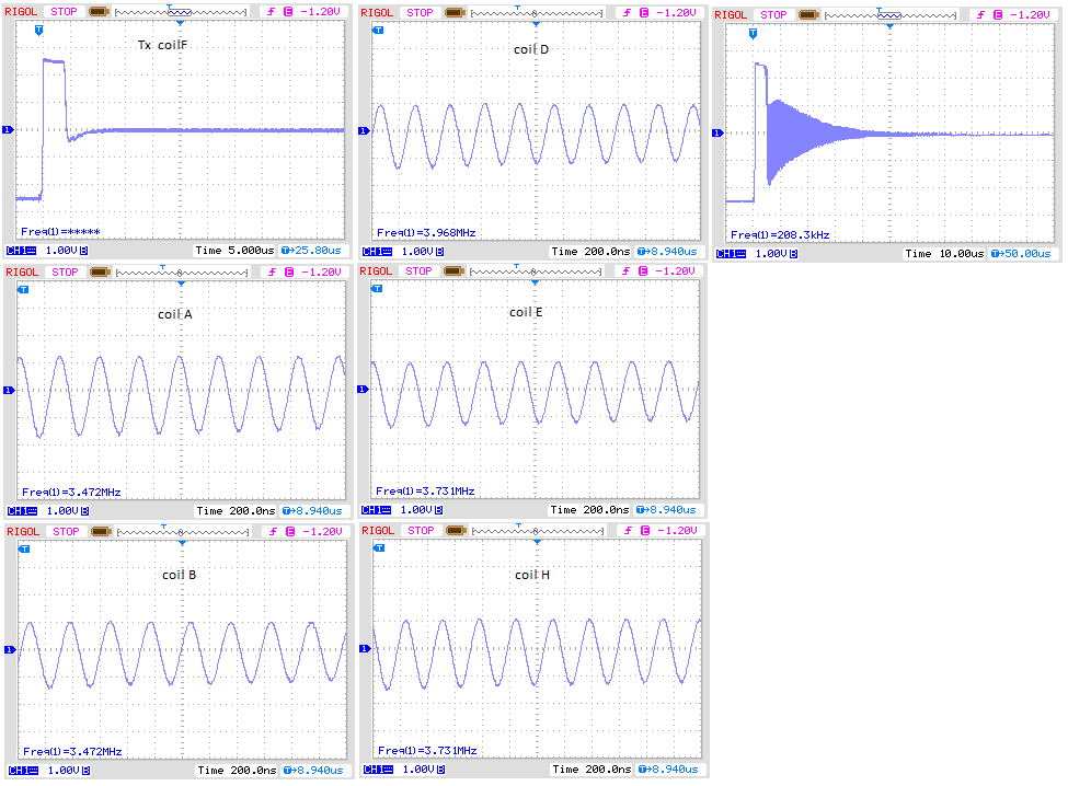

                  Some tries, start resonant frequency(2.6MHz). (#1) Replaced twisted wire coupling capacitor with a 3.3p capacitor, frequency lowered (2.3MHz). (#2) lifted diode and resistor(limits current) from board, twisted wire frequency increased to over 2.9MHz. The two diodes didn't do much. Forgot to mention series resistor in reply #109. Coil in series with a resistor, 1N4148 and 2N3904 switched on and off. Couldn't get the resonance up near the 4MHz I get placing the coil over a operating PI(Reply #109). Would like to know if placing the test coil over a operating PI is a more accurate way to measure true resonance. Probably doesn't matter since the frequency is a lower after shielding and connecting to the Tx circuit.

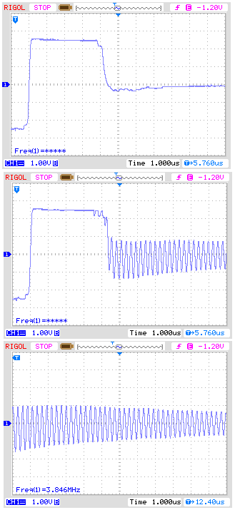

                  • Is your input amp oscillating? Doesn't have to be sustained oscillation, just resonance. A gimmick cap across the feedback resistor should show a change if this is the case.
                    • Originally posted by ODM View Post
                      Two stage amplifier. First stage feedback(20k,3.3p) Second stage feedback(15k,3.3p) Would another 3.3p across first stage work? Including some scope pictures. The resonant frequencies for the coils are close, but they were close with the resonance tester also.
