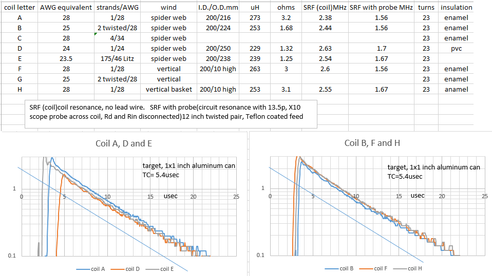

            Charted all of the coils I have made for the test. The target TC was 5.4usec instead of 5usec today, don't know why. Next test, chart signal amplitude vs target distance for the coils as is. Then shield some of them and with a longer lead line chart signal amplitude vs target distance. Targets, 1x1 inch aluminum can and something smaller. Maybe the smaller target will show a need for Litz wire. Maybe there is another test procedure that would show a need for litz wire. So far I'm not seeing it. Suggestions appreciated. Current profile, constant rate, 160usec on time, 1 amp peak.
            This is fantastic stuff, but what happened to the results of coils C and G? Also, where are you measuring the decay time from and to, or is it the rise time you are measuring and trying to minimise?
            • Originally posted by Elliot View Post
              Didn't make coils C and G. https://www.geotech1.com/forums/atta...2&d=1456254657 Recorded amplifier out with scope, no target and target recording. Subtracted no target from target recording in Excel and charted linear-log.
