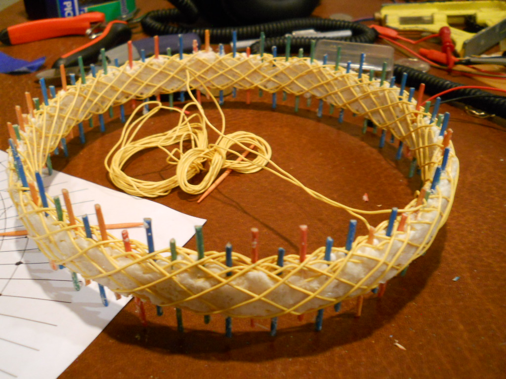

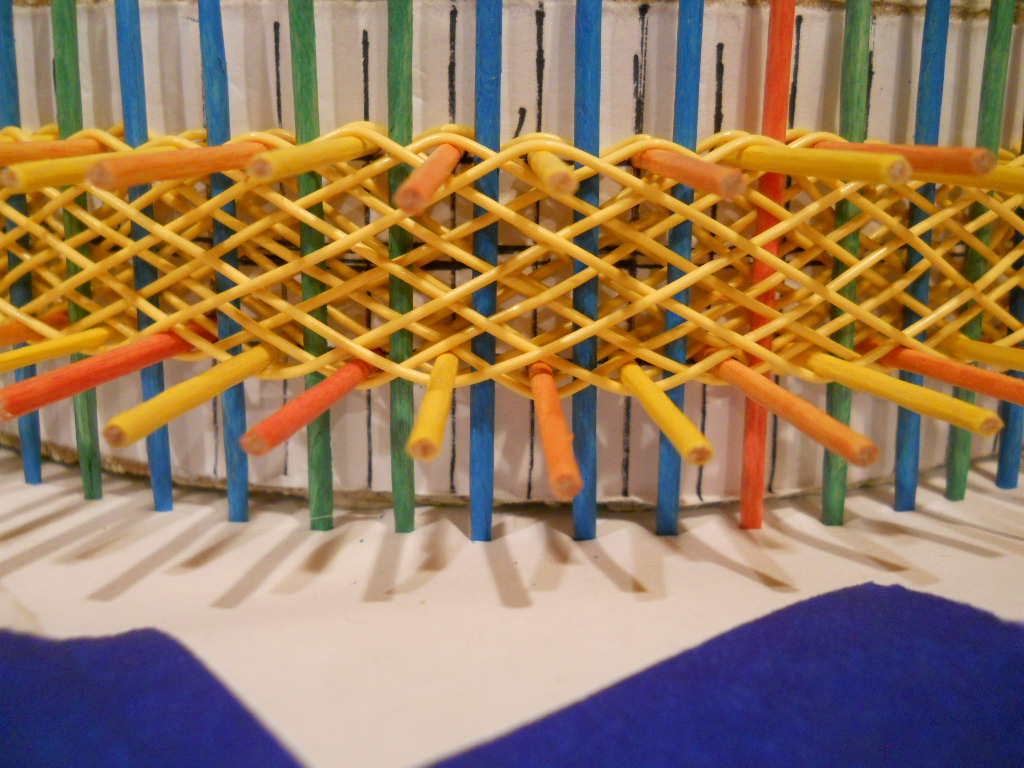

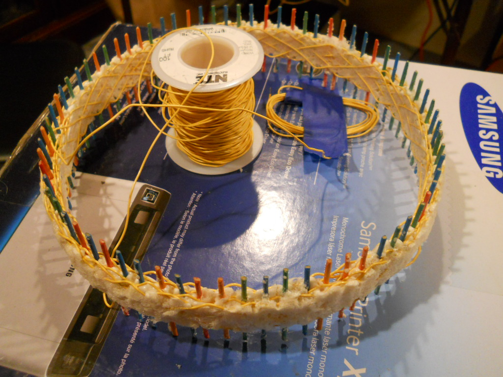

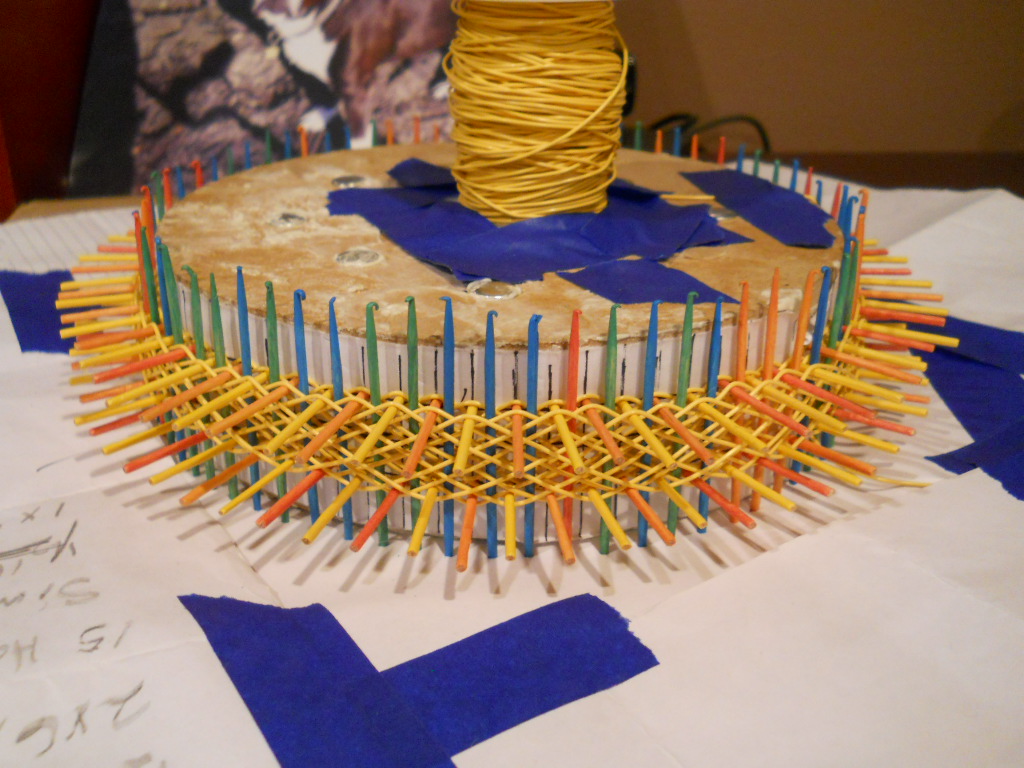

          Ok I finally was able to finish the 3D wrap around the vertical wrap coil.
          I went 20 wraps then inserted the 3D form between the wraps.

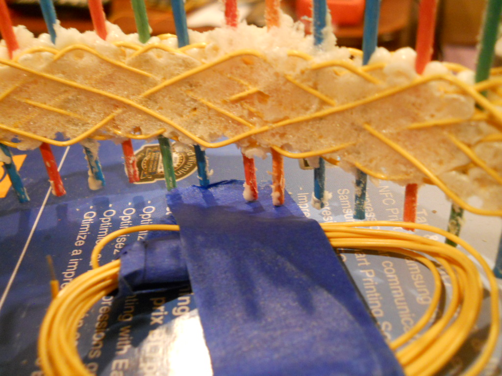

          Then I went 10 wraps of the 3DSS coil wrap around it. I used two forms and put 5 wraps on each so as to avoid the corners overlapping.
          This is the same wind as a3DSS but it comes out more like a braided cable look. (A new coil in itself)

          While it came out ok There is probably not enough wraps to call it a effective shield. I think doing any wore wraps negates the benefits of the vertical wrap.
          It measured 285 uh at 2.9 ohms .
          I probably will not try another of this style as it does not perform as well as the original or my coils. My coils are getting a good 2 extra inches over the 3D design as tested on a barracuda indoors. What was 9 to ten inches is now 12 to 13 inches on a nickel.
          Though the coil shows no sensativity to my hand at 7.2 us I will try it on my MPP at 5 us soon, I bought another MPP for the bench as I don't want to keep removing my coil from the one I have.
          I will look into shielding methods for my wrap that hopefully will not negate the extra depth.
          That is if its even needed. I have to get the coils outdoors and see how they do over ground.
          Any advice on how to check if a shield is required other then just the hand thing would be greatly appreciated.
            Most probably shielding is adequate. Even in full 3DSS only the last few turns count as shield.

              Hi Godigit,
              Did you perform critical damping on each of your coils tested? Are each of the coils within about 25uh of each other? Are each of your coils round and the same diameter? Did you use the same sample delay, pulse rate, and other settings on all of the tested coils? A nickel is a fairly big target. Could you test the coils with a 1/4" square of the sidewall of a soda can? If that does not work a 3/8" square is an easier target.

                Hi Dan,
                I had a little time last night to test a 1/4 square of can but I did not have a coke can so I used a pelegrino soda can, today I cut a cola can and it was visually thicker.
                I used my TDI pro to test all 4 of the coils I made so far (3 x 8" and a 8" x10") and a 8 inch 3D SS. All the coils have a inductance right at 300 except the last one I built. ( the one with the wrap). It came out a little lower, 285 I think maybe the toothpick wide space between the inner 10 wraps lowered it a bit. All the coils are 30 wraps. all 26 awg except one 8 inch 24 awg The 3d SS and the 8x10 7 strand the rest are solid.
                I'm able to detect the can piece form 1 1/2" to 2 1/2 with just the right sweep.
                I had the TDi set 10 us at 50% gain, to start with the GB off for all the coils. (cant turn it on indoors)
                In my hand and holding the foil flat I could barely get it with any of the coils, would not really call it a signal. I placed it on a piece paper and it was a nice little hit.
                Of all the coils they were close but the 3DSS trumped as I was able to get the gain/ threshold a bit higher it ran a little quieter then the non shielded coils in my bad test environment where I am now.
                To my surprise the coil I did the 3 d wrap on was a little quieter as well, It Appears to be shielded some. Maybe Ill go ahead and try one in the flat version and straighten the tracks a little.
                I still have not been able to get any of the coils over real dirt yet and away from all the emi they may work fine not shielded. Maybe not.
                Really the 3DSS is a hard coil to beat its a great performer for a home built coil.
                But Ill keep trying.
                Take it easy.

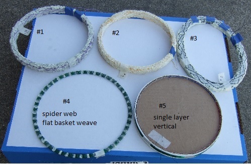

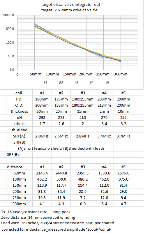

                              digit sent me three coils to compare with a couple of mine. SRF was measured be holding a open test coil above a operating PI coil and measuring the resonance with a oscilloscope, probe held near test coil. Inductance was calculated_ soldered a .01uf capacitor across the coil and measured resonance the same as SRF. Inductance=1/4pi^2/.00000001/resonance^2. Not a lot of difference except at 50mm distance. Don't know why his winding would be higher. Had 2mm foam spacer, graphite painted on side away from coil top and bottom for a shield.
                                Thanks green
                                the graphics are a little small but looking at the coloured lines, it looks like if you compare how complex the coil is to make to performance
                                then the simple #28 gauge spider web flat basket weave takes a fair bit of beating over all
