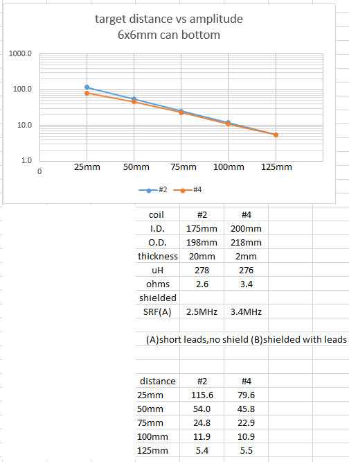

A couple coil experiments What do you guys think?
    digit sent me three coils to compare with a couple of mine. SRF was measured be holding a open test coil above a operating PI coil and measuring the resonance with a oscilloscope, probe held near test coil. Inductance was calculated_ soldered a .01uf capacitor across the coil and measured resonance the same as SRF. Inductance=1/4pi^2/.00000001/resonance^2. Not a lot of difference except at 50mm distance. Don't know why his winding would be higher. Had 2mm foam spacer, graphite painted on side away from coil top and bottom for a shield.

      Hi Chet
      Think your right about the diameter. Charted the #2 and #4 coil with the 6x6mm can bottom. I tried the resonance with coil in air and near a plastic bag with the California clay. Looked like there was a small change but scope resolution wasn't good enough to say how much. The #4 coil changed about 40 counts when I brought my hand near the coil without the shield and zero counts or close to it with the graphite shield above and below the coil. #2 coil changed about 40 counts wired one way and maybe 30 counts with the wires reversed. The shield above and below helped a lot but didn't get the change to zero. Probable due to coil thickness and inner diameter of the shield rings was just slightly smaller than the coil I.D. #5 coil, there was some small spacing not on purpose. Tried tapping the wires down spaced as close as I could. SRF dropped, 3.73MHz to 3.67MHz. Added two turns, inductance increased, 256uH to 310uH, SRF 3.05MHz.

        Hi Green
        The 6x6 mm appears to be a good test for this size coil. The self-resonant frequency / shield tests seem to reinforce my experience with the two different ways of shielding.
        The #5 coil is working so well that I might try to wind a similar one in the future. Adding uniform spacing between the wires would reduce the self-capacitance even more. The increased height of the vertical winding should not be much of a problem.

          Hi Green,
          Great job on the graphs. Thank you for putting my coils to the test.
          The yellow coil #2 was the one that teated the best on my barracuda. Giving me almost two extra inches. I now think That Dan may have hit it in his posts about critical damping. I set my damping to another 300 uh coil and was rolling with it for all my 300 uh area coils. That one may have had better attributes for the barracuda.
          When testing on my TDI #2 was still the best of my coils and barely beat by a 3dss 8" coil with 300 uh made from the stranded 26 awg. and only because I could get the threshold and gain little higher with the self shielding coil.
          All that said they seem to hold up pretty well depth wise against the larger coils. As 6666 has said maybe too complicated for any good use in comparison.

          My measurements on the coke can were redone with pressure on the calipers and I now get .0035 on the peligrino can and .0045 on the coke can Still a .001 difference with the coke can. Must be the area I cut from.
