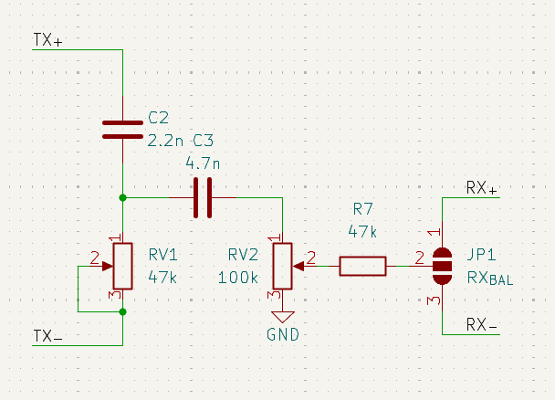

    How about nulling circuits? I saw them in a couple of designs but never tried them. Click image for larger version

          Hello everyone,
          What is JP1 in the circuit?
          Can you write in detail how the circuit works?
          Thank you very much.
          Best regards
          Gurdal
              I assume JP1 is a jumper, either connect 2-1 or 2-3.
              RV1 & RV2 alter the phase & amplitude of the signal that is injected into the RX coil to null out any physical imbalance.
                Thank you very much
                  Exactly, the whole circuit is just a passive filter that allows to take a portion of the TX signal and add it to the RX signal. The two potentiometers are used to define the amplitude and the phase of the input signal portion, and it has to be added to either the inverting or non inverting input of the RX preamp, hence the jumper. The goal of the circuit is to DECREASE the RX amplitude simulating a better balance of the DD coils. Clearely we actually want to SUBTRACT some signal to the RX, but it is all a matter of the potentiometer regulations.
                  I tried it in my circuit, it kinda worked, but I am sure that the values needs a little tweaking.
                  Eventually I did not even used it.
