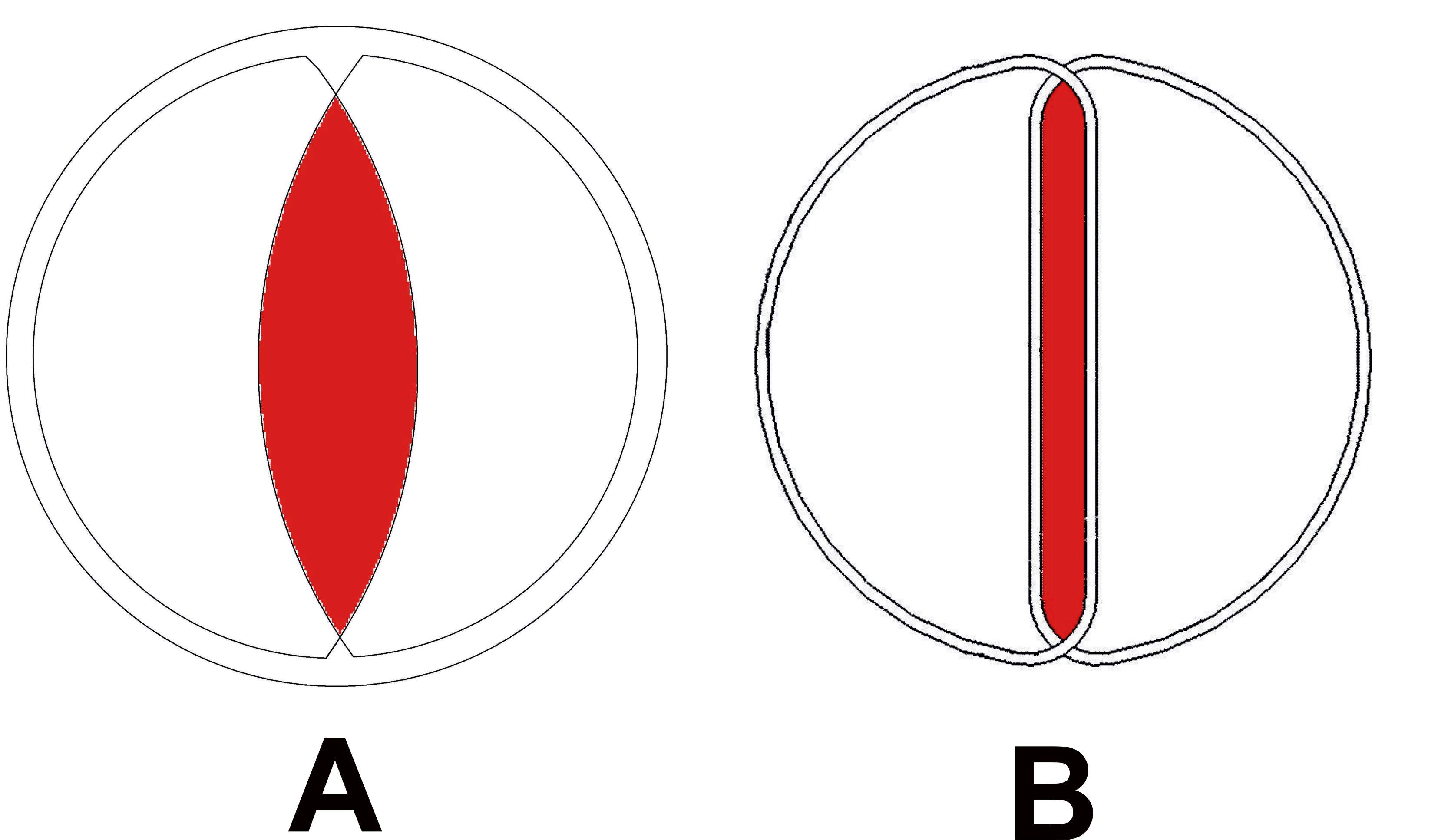

    It is much harder to balance coil with narrow and straight overlapping area (figure B on posted sketch below), i realized that recently.
    It is much easier to balance coil with wider and "belly" overlapping area (figure A on posted sketch below).
    So far i had success only with case "A" (figure A).

    I have only built type B
    Shape of Tx and Rx has to be identical for them to null to a very small voltage.
    A small bit of ferrite or copper moved around the overlap can be used to fine tune.

      Thanks Koala!
      Yes i noticed that coils must be identical, i am using exactly the same former when winding up those.
      But it is possible later those shapes to distort a bit... like i said i am using primitive and obscure method yet.
      I guess there must be a proper method to calculate close to perfect those D shaped coils, so later to be easy to balance them in such tight enclosure?
      Only way i can think on is to make few windings more on each and since those are made using coil winder and wire with adhesive layer; later when put and positioned in enclosure: it would be easy to unwind it to the point where easy balance is achievable... (though looks like a stupid method...)

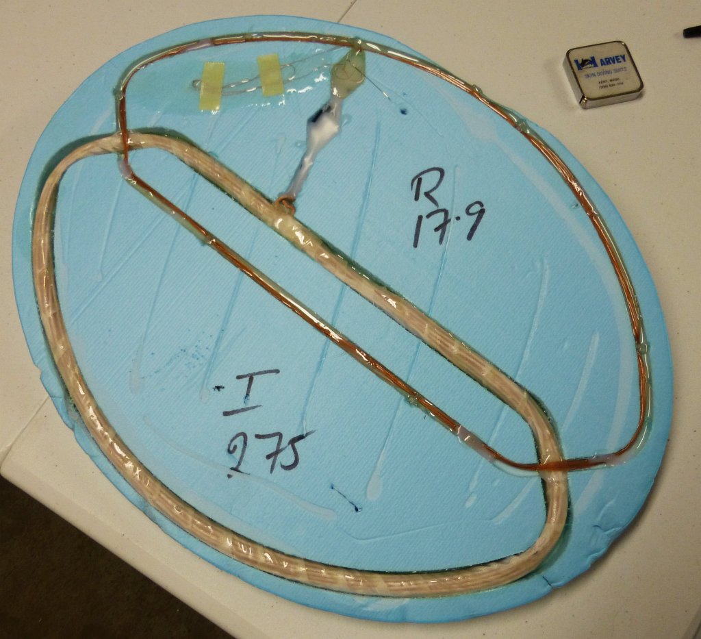

        Hello Ivica,
        i you have reached the area where it becomes critical to balance coils by move them more left or right
        just stop, fix both parts, then take a small Piece of alu or copper foil and move this over the middle area and
        glue it on, on of the coils in the Position where you can get best null voltage (fine tune)
        simple trick but works
              That's an option too.
              I tried that before in the past, with concentric coplanar coil, it works.
              But i am not sure at what degree "foreign body" in coil shifts the phase from default position?

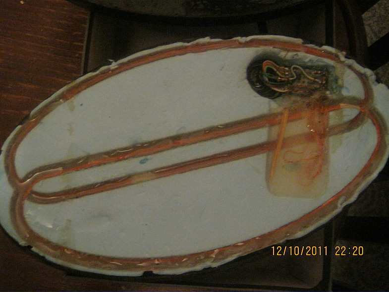

                  Ferrite balances in-phase component, exactly as pinching or stretching coils would. A small piece of tetrapack with aluminium foil in it balances quadrature component. Both are possible even after the coil is potted.
                  Of course, you must find a spot on a coil body where you may fix the piece.
                    There are a few pictures on the net that show a small portion of one turn left free, and twisting and moving it to get final balance.

                          Here there are another example of a DD coil with a loop for balancing.

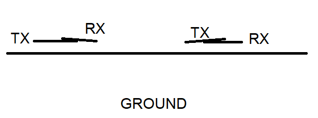

                            Hi!
                            I have a question.
                            It is better to have TX or RX under?
                              RX under, usually.
