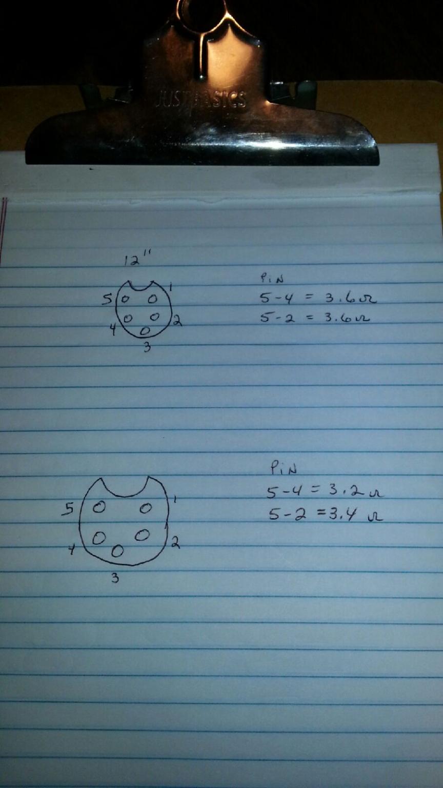

    I recently purchased a small coil from a fairly well known detectorist on many of the major forums. He stated the coil was an OZ 7.5" mono coil, but when it came the labels were missing and using an ohm meter I believe the coil is actually a dual field 7.5" coil.
    Needing a true mono coil is the reason it was bought. Well anyway ohm readings are slightly lower on the 7.5" coil over the 12" stock coil which is just what it should be.
    Question: A true mono coil should only have one set of windings and use only 2 pins in the configuration, correct?
    The dual field coil has two sets of windings and uses 3 different pins, correct?
    So that being said this is most likely a dual field 7.5" coil.
    Plug on bottom is the 7.5" coil
    Is this most likely a dual field coil?

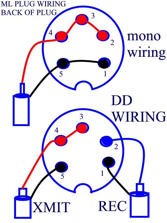

    The mono & DF both use 2 pins. The third pin is only unique on a DD coil.
      From Reg
      All coil connectors are wired the same whether the coil comes with a TDI or a SL.
      Pins 1 and 5 are shields or grounds. Pin 2 is the RX
      and in the coil connector this needs to be tied to pin 4.
      Pin 4 is the TX signal and on a mono coil needs to be tied to Pin 2.
      Again, this is the coil connector pin layout.
        So how can I tell what this coil actually is?
          Look here...
            I was wanting to know if the coil I received was a White dual field 7.5" or a Whites mono 7.5 OZ coil.
            Any help would be great.

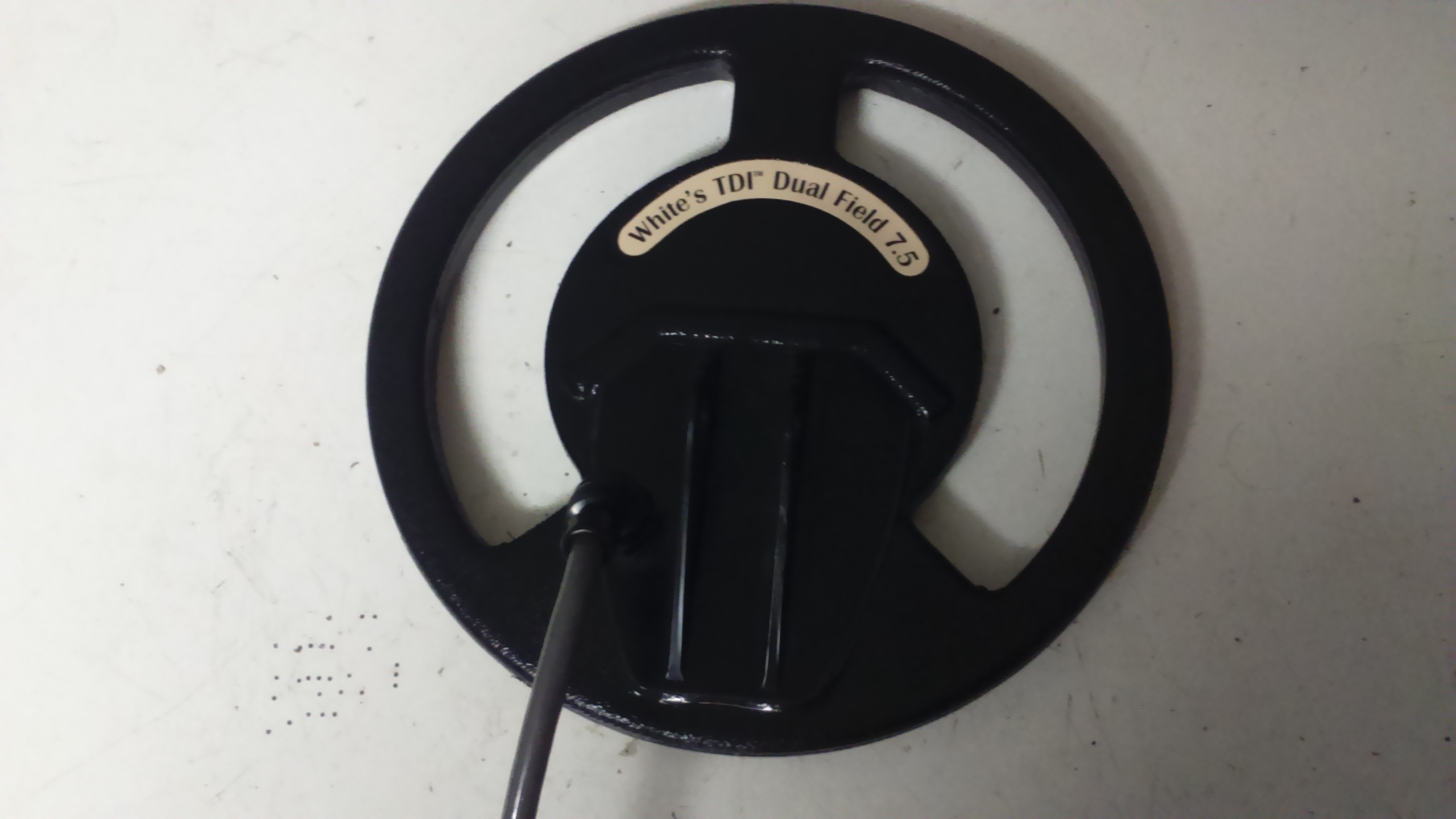

                      Carl the DF coil writes on it.. "TDI Dual Field 7.5".
                      I suppose that the mono 7.5 don't write DF...

                        it looks like VLF coil but is not VLF certainly. it is dual fieil - dual windings splitted in inside and outer parts.
                          Thanks Carl for the tip on determining mono or DF. The coil is definitely a dual field. It sounds off on both coil locations.

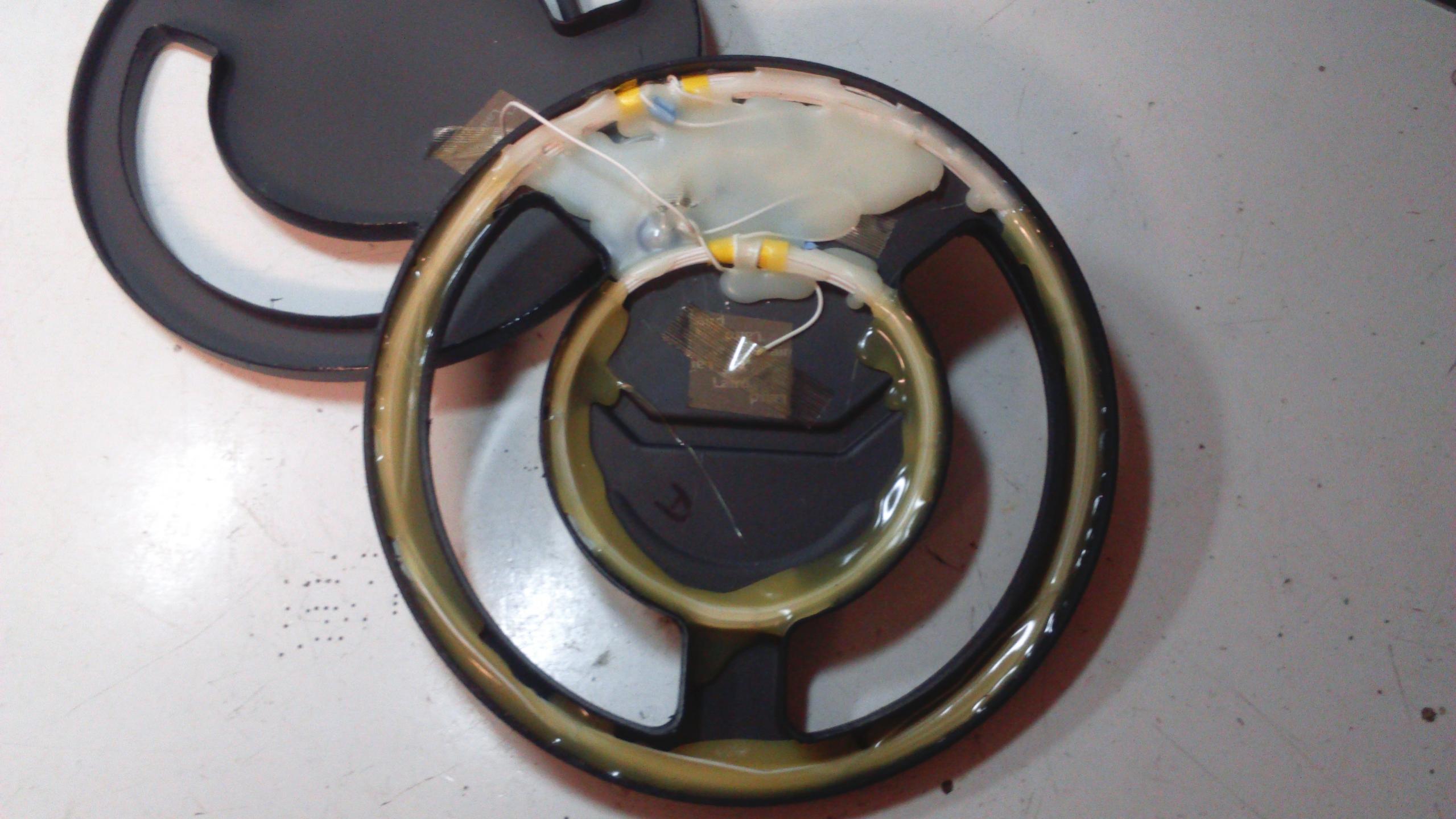

                            This is my 7.5"
                              another photo
