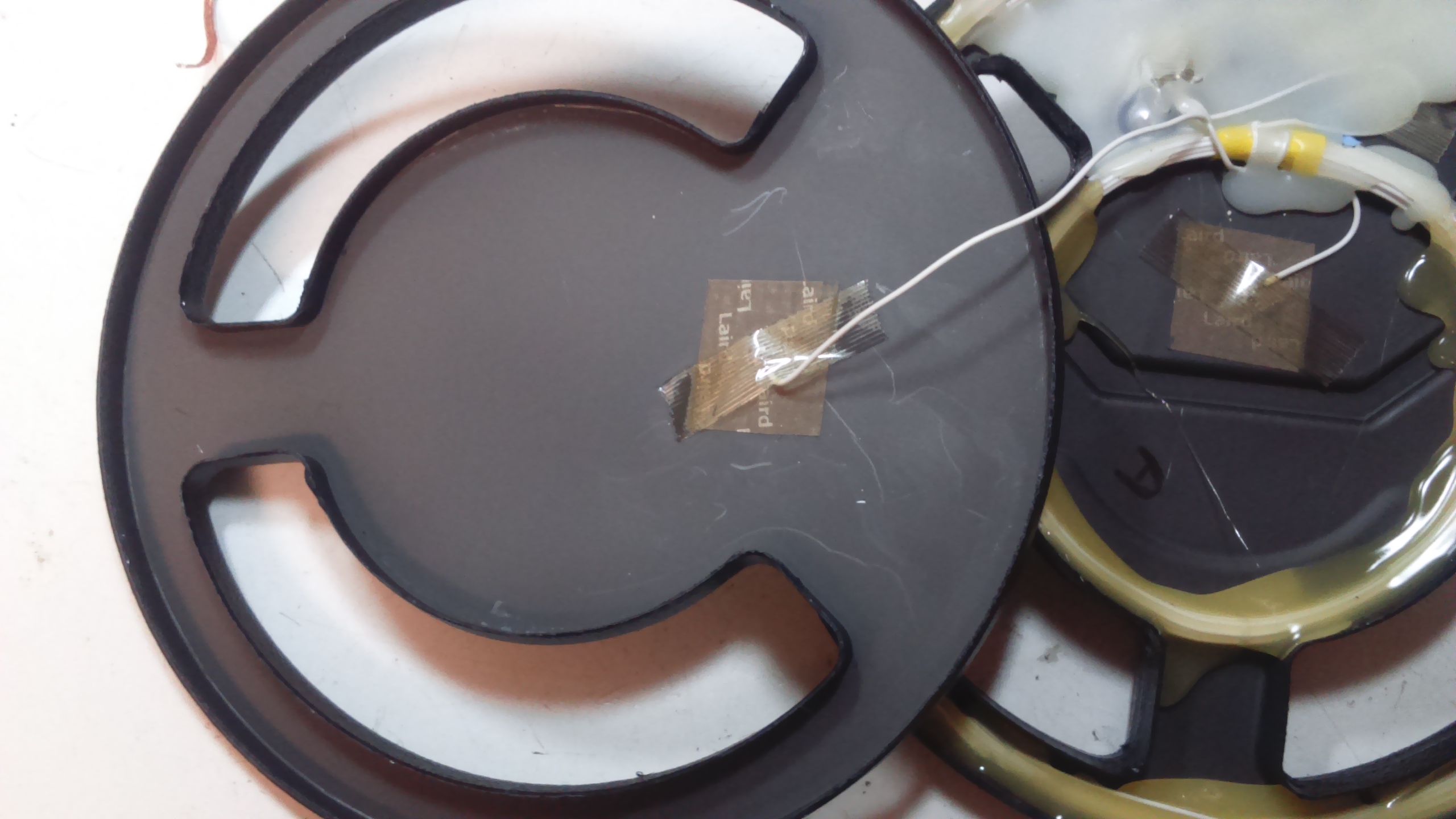

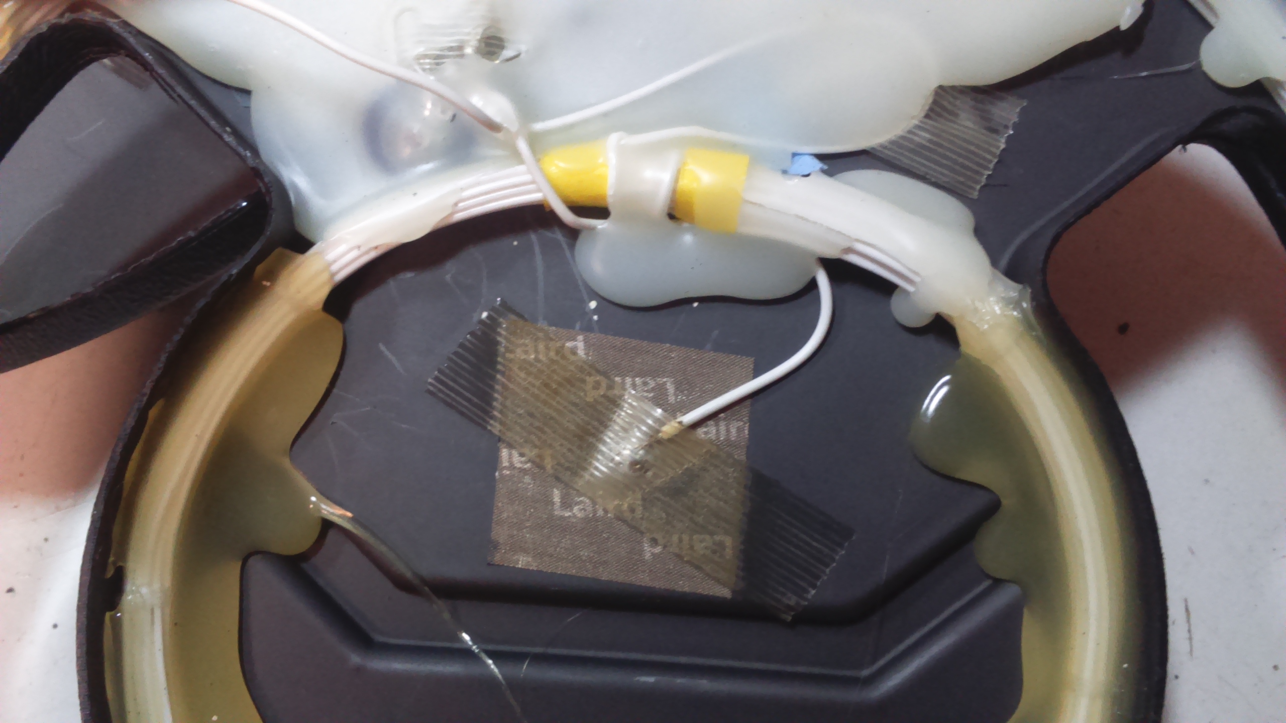

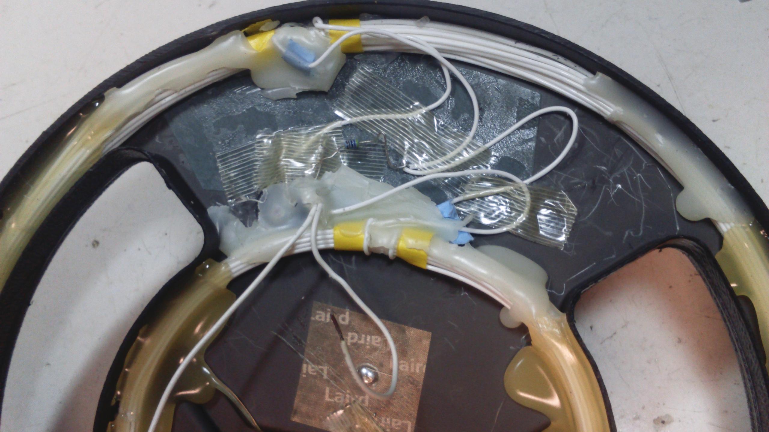

TDI coil pin out
    Thanks GEO
    Thanks for the picture, very informative

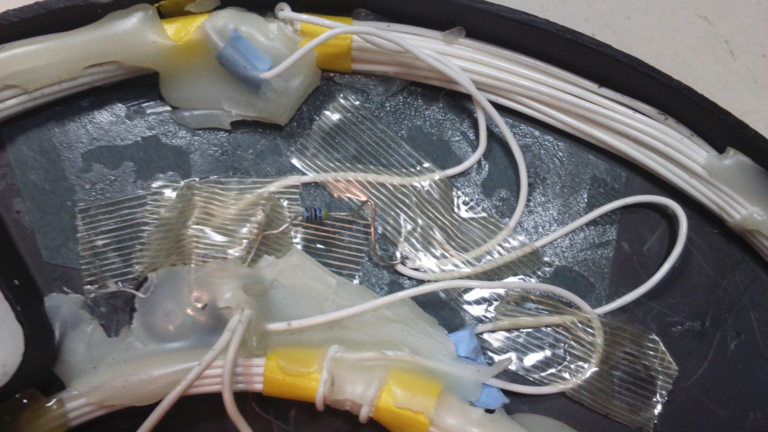

      thank you Geo. do you see some resistor/-s in the coil or nothing more?
      can you send me pic of high resolution under SUN light?

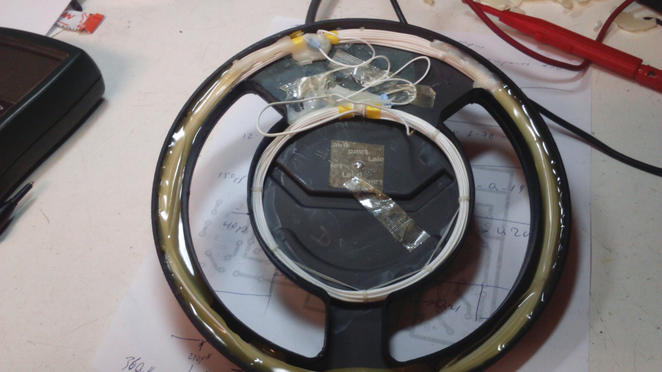

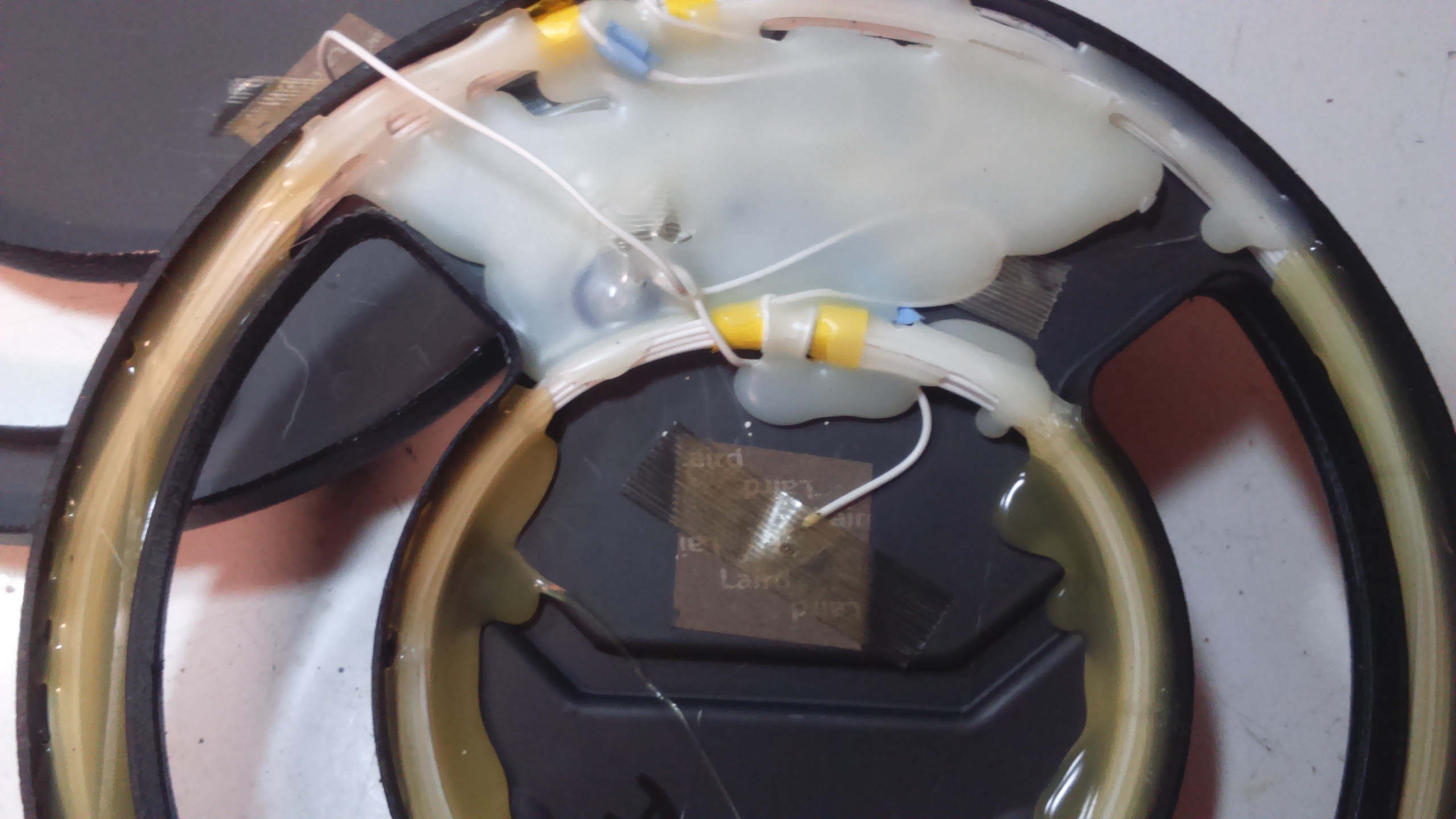

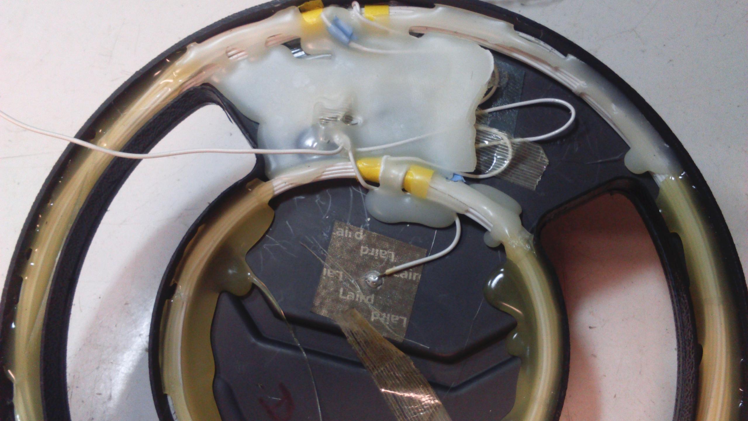

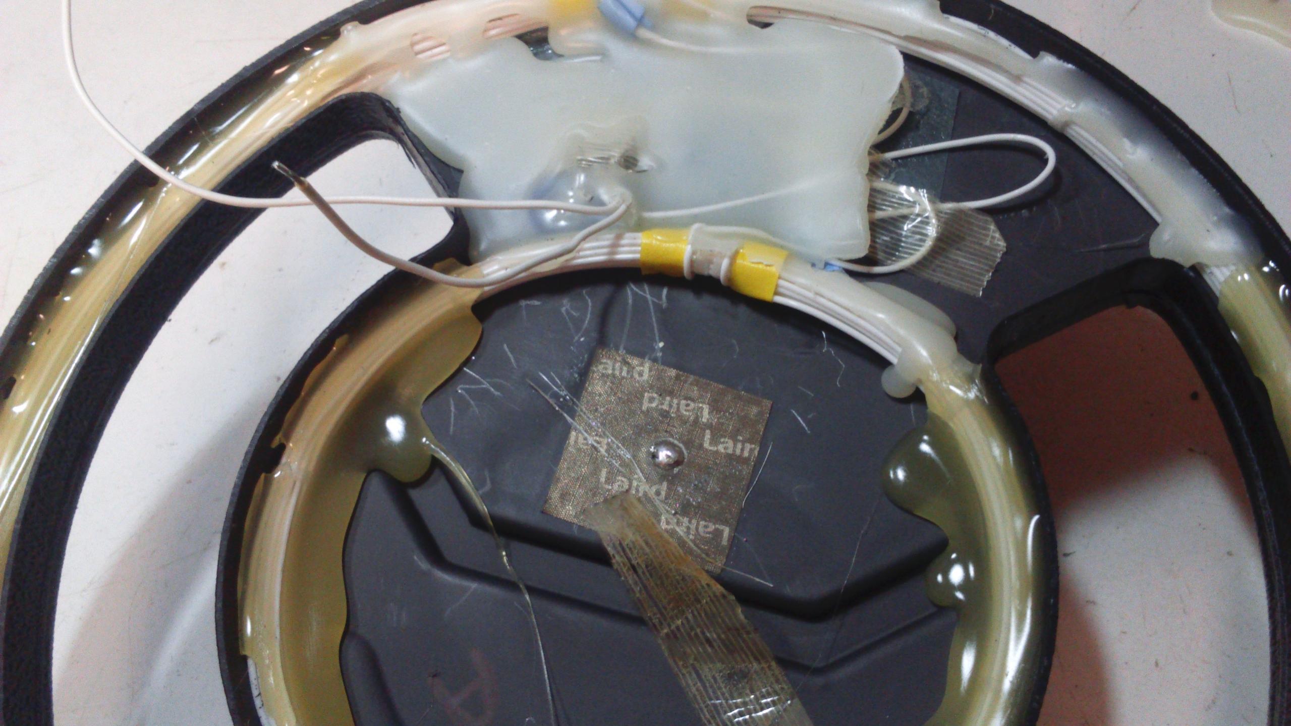

          Hi KT...
          I can't take more photos because i closed the house (it is glued ).
          Take what i have....
            more.....

              As i remember the oval coil (Razorback, Miner John) is a mono coil not a DF.

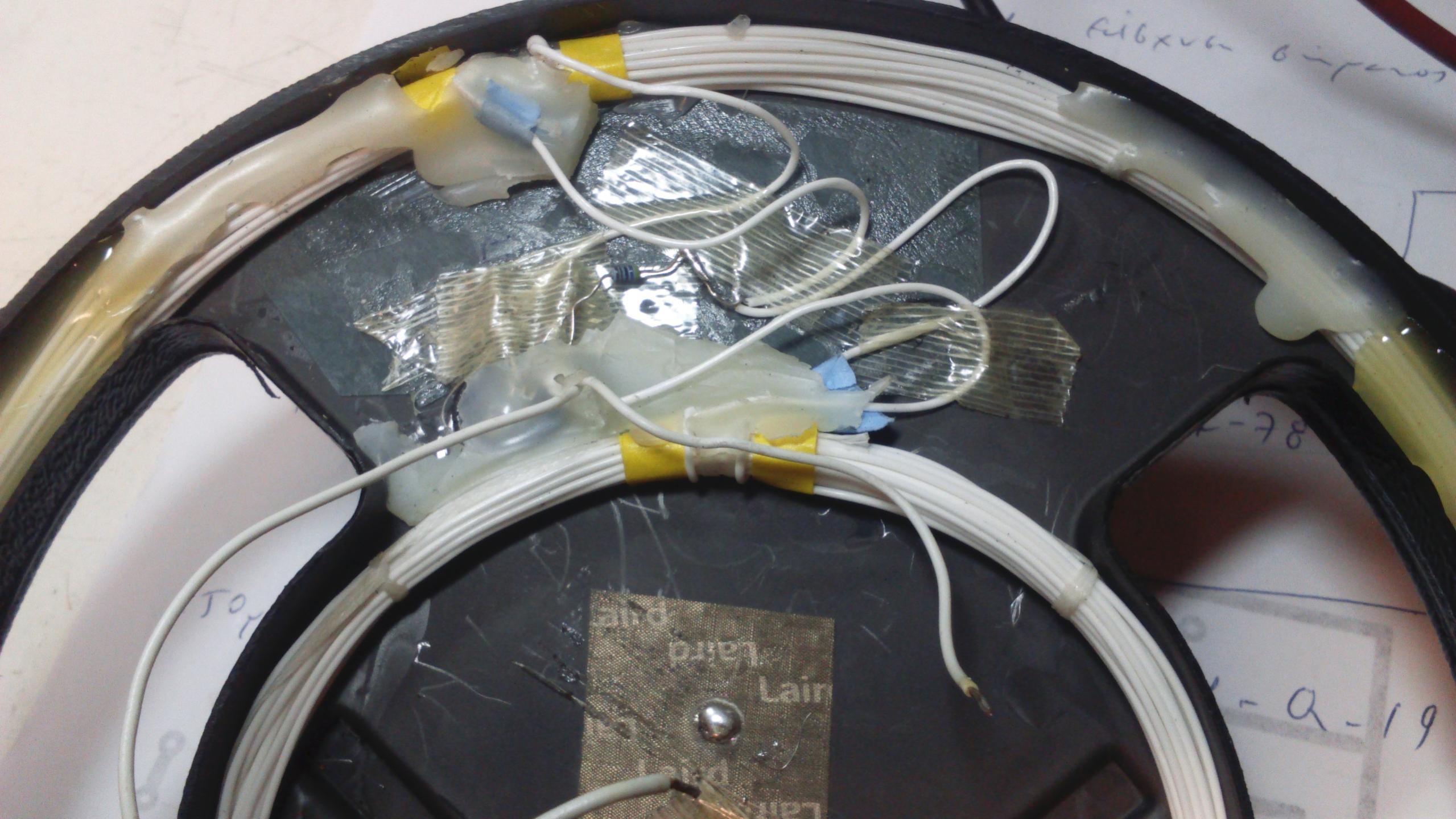

                thank you much Geo. what the resistor does is not clear for me but maybe as over damping for inner coil.
                  If will find any notes will inform you.....
                  Yes it is damping for the inner winding.
                    According to the patent for dual field coils, the internal coil must have a resistance to prevent oscillations.
                    In this case, it appears to be 4700 ohms
                      This is some thick wire they use! And thick insulation too!
                          enough wire and enough insulation. no thick.

                            KT...finally the resistor is 4k7 as Jose wrote.
                              thank you Geo.
