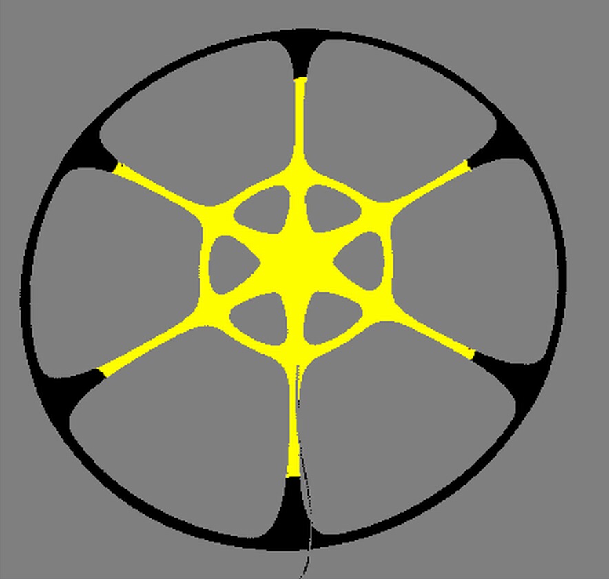

                      Well then, I am open for suggestions.
                      The coils profile resembles a wheel of an ancient chariot, so how about a Gold Chariot or a Grand Chariot?
                        You can name the 1 meter coil: Golden Sun
                        Paint the inner ring together with the rays golden and it looks really luxurious!

                              I know Chariots Of or On Fire but not of gold - those are war-tools.
                              But the sun is big and stands for a prospering life! Ra was the god of sun at Egypt.
                              The sun which shines through the darkness of soil and reveals all the treasures!
