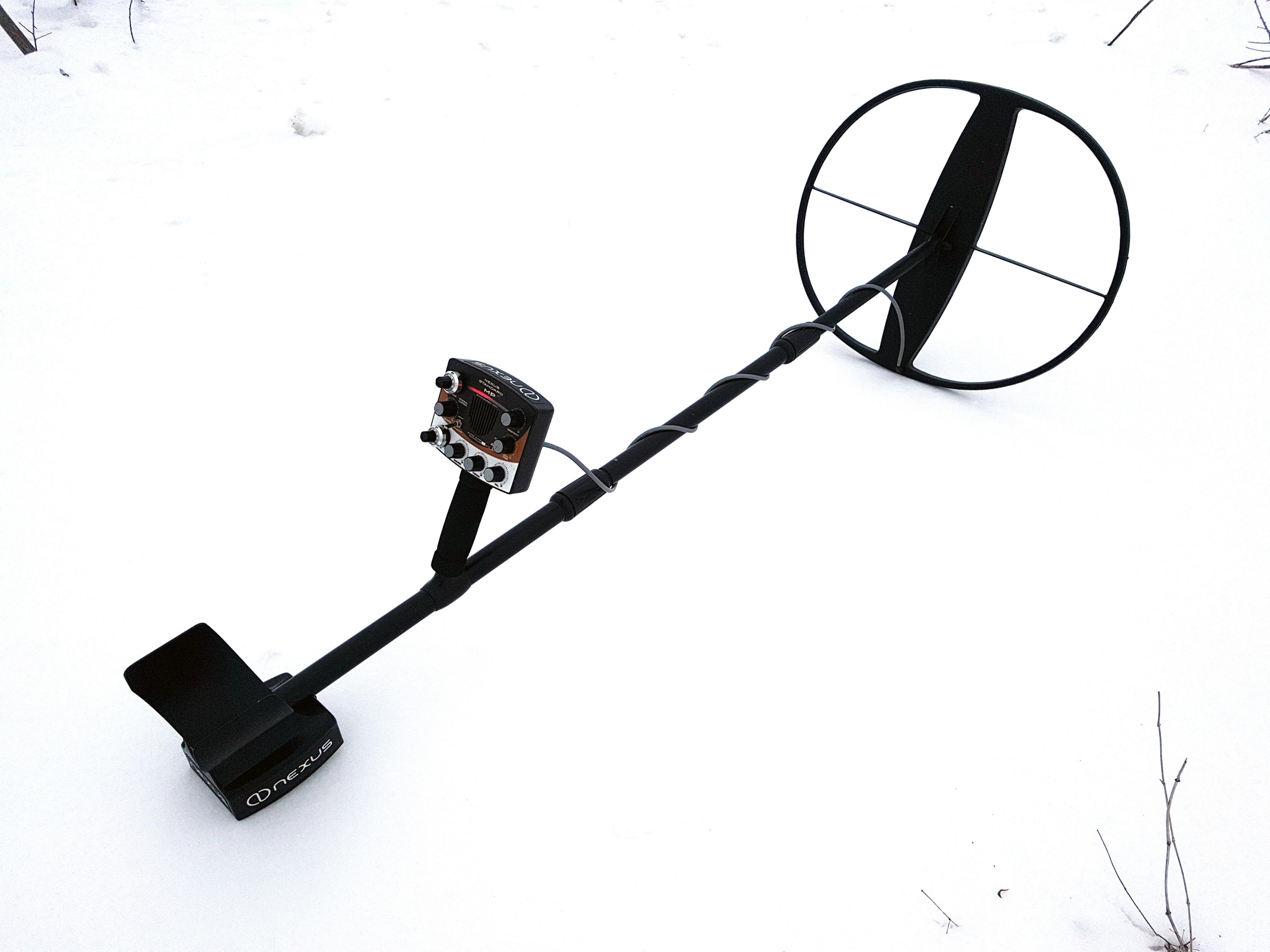

New for 2017. Carbon Fiber search coils for Nexus Standard MP.
    WOW!! Nice.
      btw. the "ears" of such 1m coil really must be extremely stable
      because of the leverage-forces this is THE neuralgic point !!!
      If I interpret the pictures correctly so far those "ears" are
      not stable enough because they are to thin and also should be
      really thick at the base where they touch the coil (ca. 1-1,5cm).
      And I don't know how easy it is to fix carbon fiber.
      I have my doubts this works with superglue or soldering iron.
      Funny idea: with some waterproofed protection cover
      the coil also is useful in times of need as umbrella!
        Those clevis ears look vulnerable to me, as well. I would've liked to see bigger ears, wider spaced, and a special lower shaft to go with the coil.
          All Nexus coils except this one are made with Glass Fiber ears. There is not even one broken Nexus coil Glass Fiber ear for all times by now.
          The ears on the 1 meter coil are made out of 2.5mm thick Carbon Fiber, which is many times stronger than Glass Fiber. They are impossible to break, period.

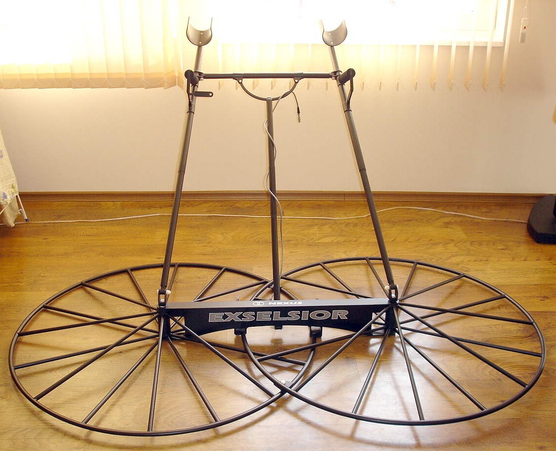

                  Nexus is the sole manufacturer worldwide of huge search coils for IB detectors the largest of them been and still is the Nexus Exselsior a dual 1 meter OO search coil with a weight of 4.5kg and retail price of 15000 Euros (not advertised on the Internet).
                  None of our customers have ever broken those glass fiber coil ears. Not on the coil below or any other smaller one.

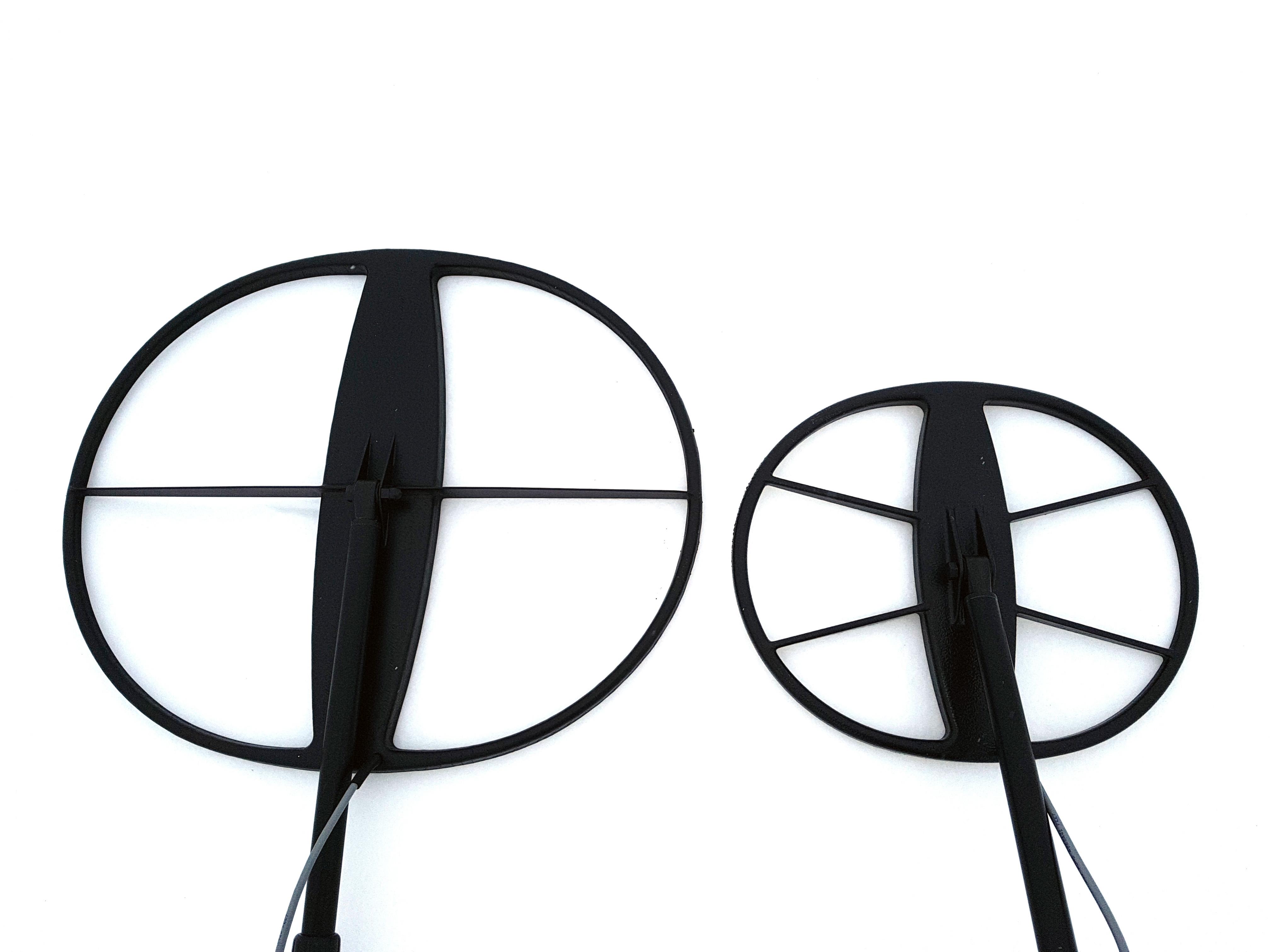

                      The new 20"DD Carbon Fiber coil is on the way. The weight of the prototype is only 690 grams, which is the same as our 13"DD coil.
                      The Nexus MP with 20"DD coil
                      The 20"DD coil next to 13"DD for comparison.
