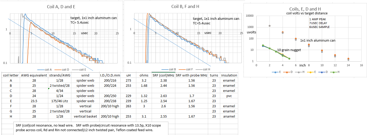

        Mostly just trying to learn or understand why. If I record the decay with 2 stacked US nickels. Touching or with a layer of masking tape between them they chart the same decay, about twice the TC of a single coin. Was thinking stranded wire might not be effected by conductance between wires, looks like I was wrong. Maybe someone could explain why. Posted a test with coils made using different wire in another thread awhile back. http://www.geotech1.com/forums/showt...103#post214103. Litz wire was a little better than solid awg28. Tx current was controlled to be the same for all the coils.http://www.geotech1.com/forums/attac...8&d=1456683394, attachment from other post.
        Started reading the thread from the beginning again. Looks like some of this is a repeat. Has anyone tried winding a coil as suggested to see if it is faster. I don't see a big difference between litz and solid awg28, maybe something I'm doing wrong. Would be interested where someone has compared different coils and seen a big difference.

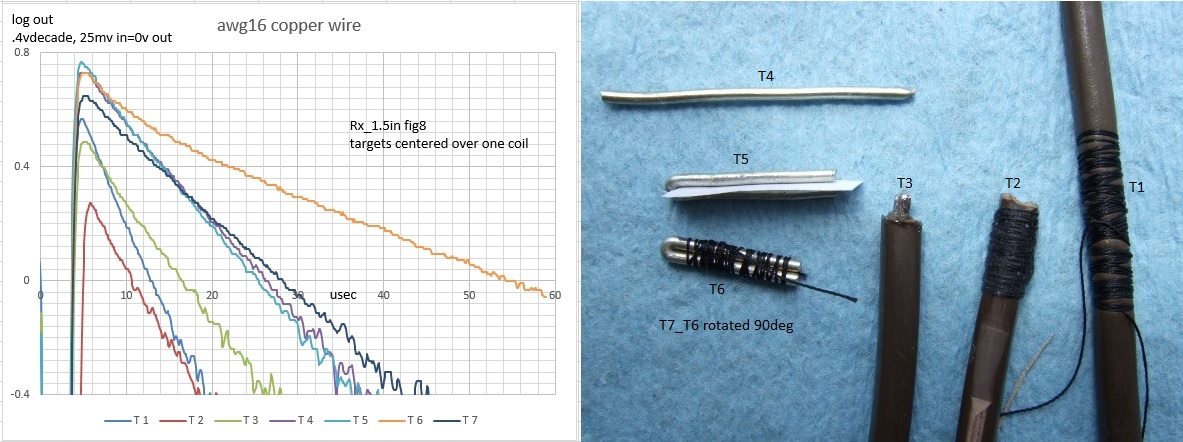

              Finally understanding what may means. Another test with awg16 wire(solid and stranded"26strands of awg30" cut from 110v power cord). Stranded shows no signal until I wrapped it tightly with thread to compress the wires together or soldered the end. Bent solid wire with a piece of paper between, charts about the same as straight piece. TC increased with bent wire wrapped with thread when laying flat, not much on edge. Need to get some silver coated stranded wire to test.
              Chart should be .4v/decade
              stranded wire not coated, think solid is tinned buss wire

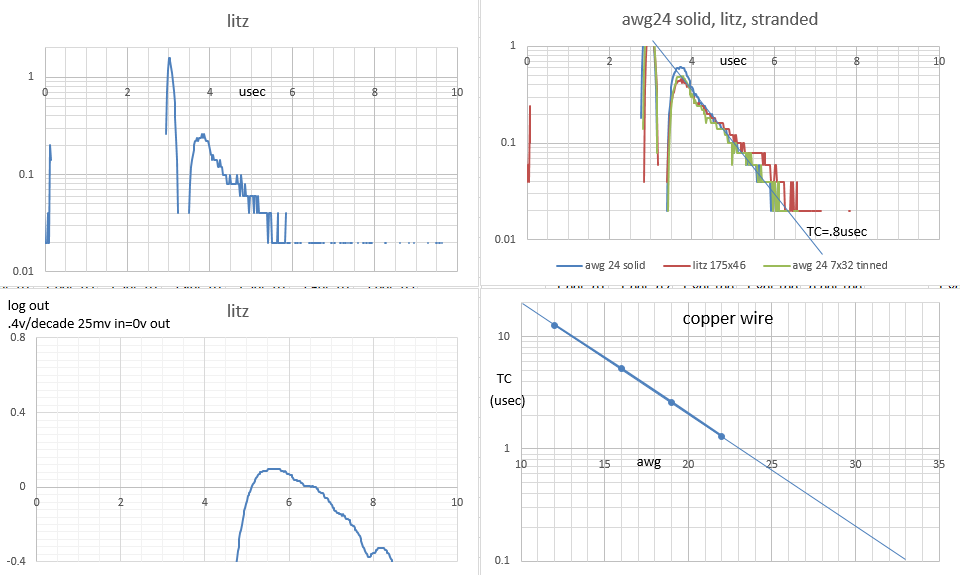

                The size of the wires being used in your tests are so large, that I think that the other characteristics of litz wire that result in high srf and fast eddy current decay are being masked. Try using #20-24 litz wire made up of 300-400 strands of #36-40 wire. I suspect that you will see a difference.
                As an aside, for those wondering how on earth can you solder the stuff, think "caustic paste paint remover". Dip the end in the paint remover, wait a few minutes and gently wipe with a cotton swab on a hard surface until the enamel is gone. If not, dip again, rinse and repeat. Some types of enamel are tougher than others, but eventually they all fail. Dip in rosin flux before soldering. Some litz wire may use enamel that melts at soldering temps.
                Some data with smaller wire. Tried awg28 7x36 Teflon coated(the only Teflon coated wire I have). No indication, stripped and soldered still no indication with my tester(projected .3usec TC). I see Teflon coated wire being recommended for coils. Most is silver platted, did find some nickel platted. Does silver platted always act like solid? Charted some awg24 wire. No indication with litz and stranded until I stripped the insulation from one end and tinned the wires with solder. The soldered wire is the same as solid. Not a large signal with my tester so I added a .8usec TC line(projected TC from copper wire chart). Decay looks close to .8usec. The litz is slightly larger than awg24 and charts a little higher TC. Couldn't use log out because log out had to much delay with such a low signal. The litz I have does melt at solder temperature, easy to use. My tester isn't the best for looking at such short TC targets. Would be interested what a high frequency VLF(gold)detector would show.

                    Green,
                    Another thing to consider is the ability to move the coil connection point to the coax feed wire outside the coil housing where if it were inside the housing, it may act as a target at very low delays. Try extending the Litz coil wires about 6 inches above the coil and make the connection to the coax outside the coil housing or run the Litz wire up to the control box. You will need to find a way to eliminate or minimize noise pickup by some creative way to shield the extended coil wire without the shield being detected.
                    Litz wire is very good with high PPS rate TX pulses. Note which wire types give you the sharpest edge on the turn off current pulse. I have used very thin silver coated strands in Teflon insulated AWG 28 down to about 7 uS delay. Reducing coil and TX circuit capacitance allows the use a higher value of damping resistors which produces a coil discharge TC more vertical and better able to fully stimulate smaller, lower TC targets.
                    Thinner wire strand diameters have less coil turn-to-turn capacitance than thicker stranded wire diameters. Teflon wire usually comes in 300V rating and a 600V rating with a thicker layer of insulation which produces less coil capacitance. You may need to add a coil turn or two to make your desired coil inductance as coil wires more spread out have less inductance.

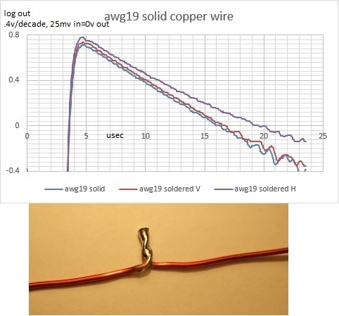

                          What is best way to join 2wires for minimum target signal? Tried some different connections with awg19 and 22 solid wire. Including a chart and picture of the best I found. Similar results with awg19 and 22. Charted awg19, more signal strength. Soldered joint was near coil center, V(soldered joint vertical) H(soldered joint horizontal). Is there a better connection to try?

                            Different coil types will have a null zone somewhere within the coil area. Try to locate that null zone where the response is least intensive, and locate the joint there. This may be more available on DD type and D O D type coils where null zones may be more detectable than on mono coils.

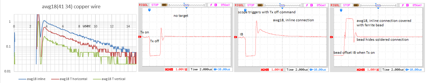

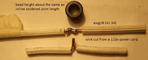

                              Thats a great experiment Green, according to the minelab patent putting a ferrite bead over a soldered joint makes the joint less detectable, it would be very interesting to try on both a T and a - joint, its something I have wanted to try but have no way to test it do you have any beads ?
                              I think you have some 24AWG PVC covered multi strand wire I would be VERY interested if you could test a T and - joint with a bead thanks
                              There is some techno bable in this patent but not the one I want, its somewhere on my PC
                              A metal detector includes means for reducing the induction of eddy currents in conductive elements of a sensor head. The aim of this invention is to remove the effect of small pieces of conductive material, located within or close to the sensor head, being seen as sought targets as the sensor head is moved over magnetic matrix. The means is to surround the conductive material with material with high magnetic permeability and low losses in a time-varying magnetic field, say low-loss ferrite. This will prevent the reflected field from illuminating the conductive material so eddy currents are not generated.

                                Used awg18 to get more signal. No signal with just wire(no solder joint). Soldered joint TC a little higher than awg18 solid. Tried awg24, similar results with lower signal. Ferrite bead does hide the joint. A smaller ID bead would look better, what I had. Bead offsets coil IB. A shorter inline solder joint has less signal with about the same TC. Scope pictures 1v/div to keep from over scaling, ferrite bead saturated amplifier with Tx on.
