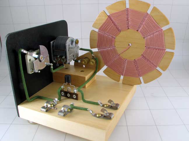

      years ago radio coils used to reduce capacitance (I hope I describe the following in a sensible manner)
      You wind the coil on a round card with an odd number of slots, winding the wire in and out of the slots so that there is a gap between adjacent windings.
      would this strategy work with a detector coil ?
      • #48
        Yes that will work to make a spiral coil.

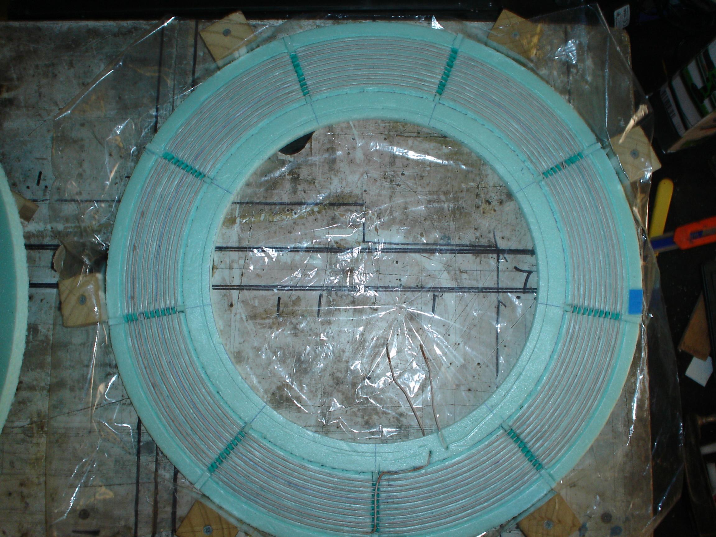

          Like this part built 18" Mono Spider coil for PI.
          Regards Ian.

            Nice work IBGold i too have a crystal radio background and will be experimenting with this when the correct litz gets here i only have high strand on hand and for MONO pi coils you need lower 15 strand or so as not such high freqs involved and better not to saturate as both out going and incoming signals. I have high hope for PI coils made to this standard. Let us know your results and if there is any improvement in depth or quality of the return signal.

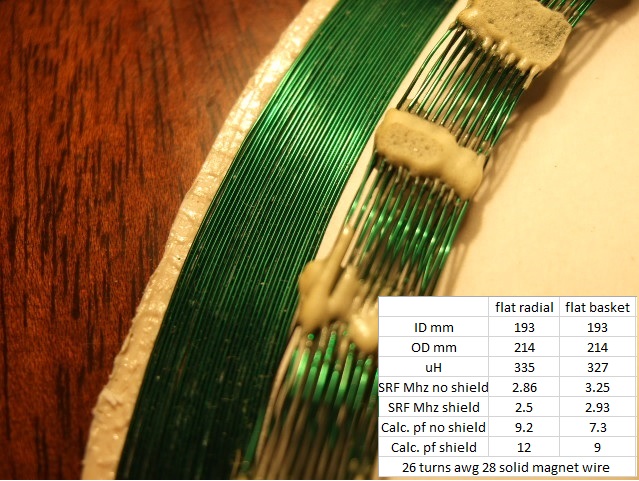

                  Tried a flat spiral to compare with flat basket(spider coil)I've been using awhile back. 200mm diameter, awg28 magnet wire, spider coil wrapped around toothpicks, flat spiral wrapped on sticky tape. Not much difference, data measured with no added leads, both coils have calculated capacitance less than 1 foot of coax. Coil calculator calculates 400uH for a bundle coil instead of 330uH I got. Would be interested in SRF and inductance measurements of different coils to compare winding methods.

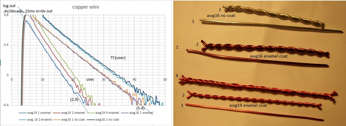

                      I see the word may, did a test this morning with some materials I have. The not coated awg16 looks like it is plated(maybe tin). Adding more wires didn't change the decay TC. TC the same wires coated or not coated. Test maybe not the same as silver or tin platted stranded wire but I don't see how the platting would make much difference.

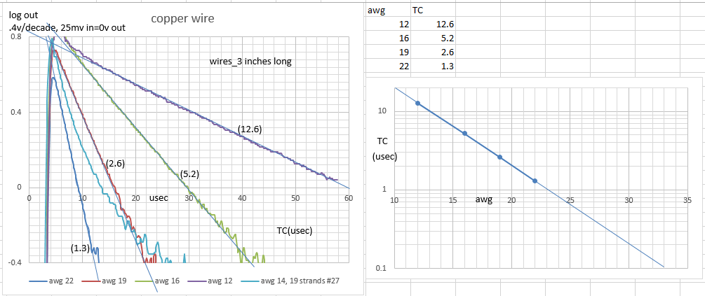

                          Thanks for the reply. Looks like my test this morning didn't show the problem. Maybe not enough strands? Another test. Charted some different size solid wire, 3inch long pieces. Best guess on size of stranded wire(plain copper, strands not coated), 19 strands of I think awg27 wire. Stranded wire charted about the same TC as awg22 at start then TC increased. Need to get some pieces of silver coated, tin coated and not coated stranded wire to compare.

                                The size of the wires being used in your tests are so large, that I think that the other characteristics of litz wire that result in high srf and fast eddy current decay are being masked. Try using #20-24 litz wire made up of 300-400 strands of #36-40 wire. I suspect that you will see a difference.
