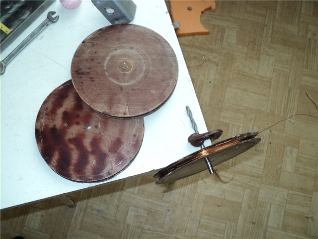

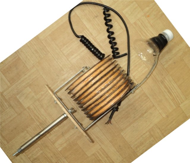

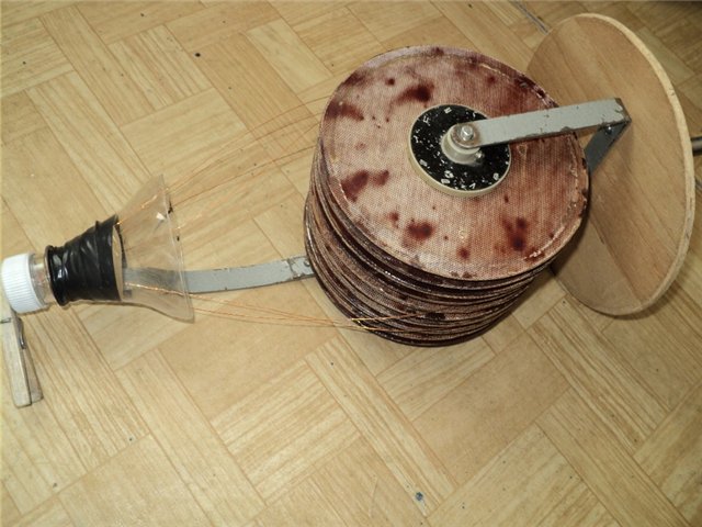

                        I recently saw a simple rig for making litz wire. Somewhere on Russian metal detector review forum. Will see if I can find it again.
                        • #42
                          Here it is. The wires feed through the nozzle of the plastic bottle. Then I guess you have to twist them together with drill.
                          • #43
                            Looks like absolute madness if something goes wrong.
