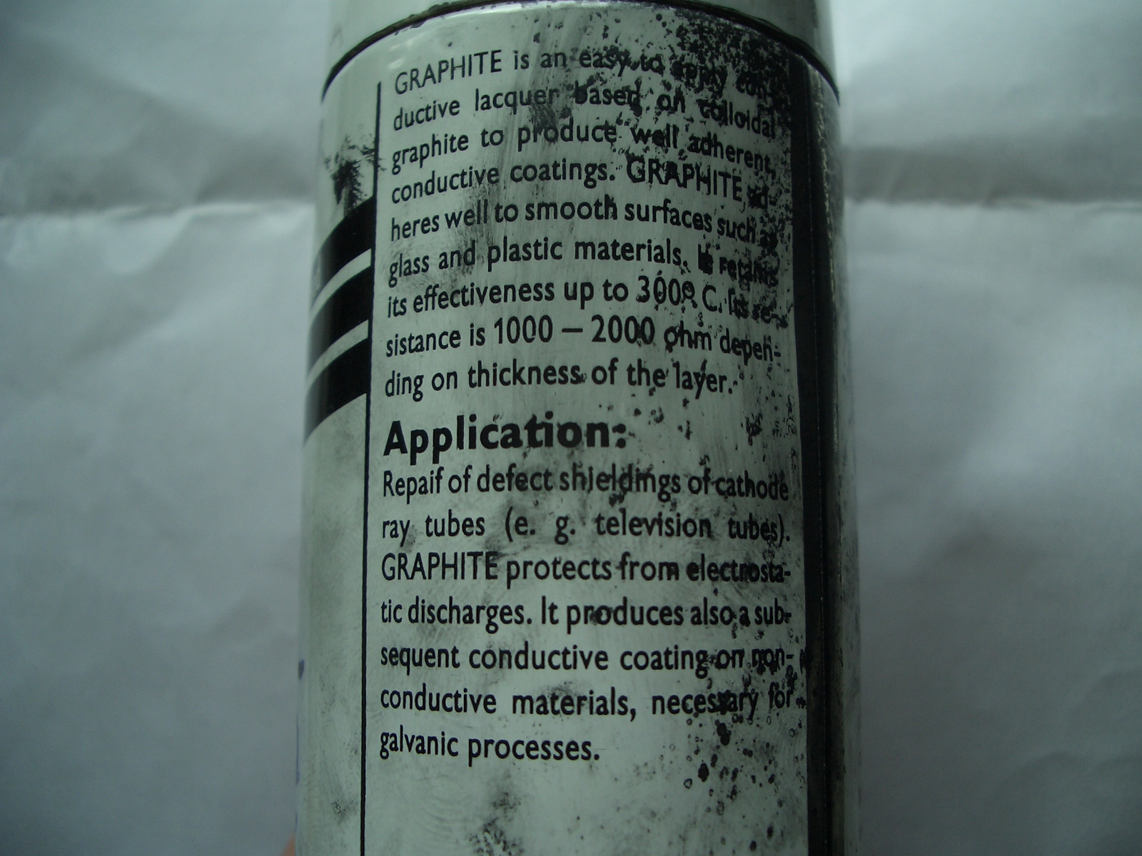

                  i use aerosole '33' (look pic) and put so far a wet a graphite powder on the lacquer. the powder i do by abrasion of a graphite rod from any oldest batts
                  (i find them up everywhere at fields). that gives good result and economy of the 33.
                  http://www.sapphire.ru/linkpicsW/00000006201.jpeg
