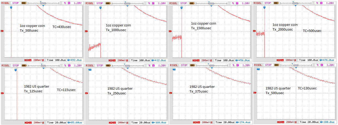

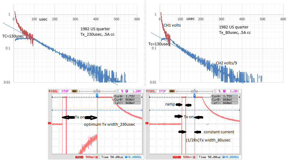

            An attempt at doing a test similar? to yours. My bench tester is different than yours. Some things I could try without a lot of modifying. Tx rate_13pps, about 25usec ramp then .5A constant current. Preamp gain CH1 about 450, post amp(used for charting data only, not part of normal PI detector) gain x9, total gain CH2 about 4000. Rx two 8inch round figure8.
            Procedure: increase Tx pulse width until CH2 saturation time(Tx off)stops increasing then decrease pulse width until I see a slight decrease in saturation time(about 100usec on the first scope trace)determines optimum Tx width for the target. Then decrease pulse width until CH2 amplitude is 1/2 saturated at previous saturated time(Tx pulse width about 80usec)determines 1/2 signal Tx width. Saturation time is about 1/2, maybe an option instead of 1/2 volts.
            Recorded data and charted with Tx=230 and 80usec.
            Was thinking (time CH2 signal crossed 1/2 saturation volts minus saturation time)/.71 would give target TC. First scope trace about(175-100usec) 75usec/.71=105usec, second scope trace about(105-50usec) 55usec/.71=77usec. Looks closer to 130usec the way I normally do it. I think if Rx saturation time was greater than the target TC the calculation might be close to the same. Need to increase signal to try, increase current or a smaller coil would be a couple options.
            The charted data shows a decrease in amplitude(Tx=80 vs 230usec) of 1/2 after the target TC(130usec). Looks like signal amplitude is close to the same at the start(<10usec).
            • #96
              Looked closer at the data after I posted. Eric had a optimum Tx time of 550usec instead of 230usec for the quarter which I think made sense. Tried again, I have a 20turn trim pot for adjusting Tx time. Didn't notice Tx width had stopped increasing when Rx saturation time had stopped increasing(no stop on the pot). (earlier numbers)Rx saturation time 120usec(100usec), optimum Tx width 500usec(230usec), Tx width 1/2 signal 105usec(80usec). I'm thinking increasing the Tx width from 230usec to 500usec increased the signal120/100, not a large increase for the increase in Tx width. Maybe Tx width 1 or 2 times the target TC is all that's needed.
              The calculated TC (time CH2 signal crossed 1/2 saturation volts minus saturation time)/.71 =115usec closer to the 130usec. Still need to try the small coil for more signal(Rx saturation time>TC). Maybe test for Rx saturation times at Tx width=1,2 3,4 and 5 times the target TC(125usec for the quarter). I'll try the 1oz copper coin I have to compare with Eric's 1oz silver coin data, should be close.

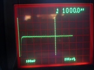

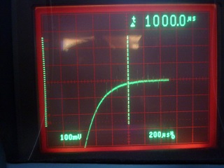

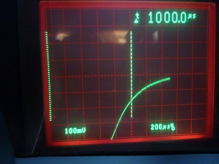

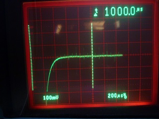

                I have changed to a better preamp (LME49990) and have taken some pictures of the end of the decay. As previously mentioned it is inverted, so the waveform decays from a negative value back to the zero centre line.
                The TX pulse was set to be exactly 1000uS in this instance.
                The coins in order are, US 5 Cents..... US silver quarter..... US silver half..... US copper penny.
                Eric.
                  Eric.
                  [ATTACH]41760[/ATTACH] [ATTACH]41761[/ATTACH] [ATTACH]41762[/ATTACH] [ATTACH]41763[/ATTACH]
                  Been trying your method, looks like an easier way to determine target TC than what I've been using. Couple questions. What is your amplifier saturation voltage? Have you gotten amplifier saturation time to be greater than the targets TC? TC=(time amplifier volts is 1/2 saturation-time amplifier volts is saturated)/.71. I've been using Tx off to trigger scope zero time. I need to try a smaller coil to get amplifier saturation time greater than targets TC so I'm not sure the calculation will give the right answer.

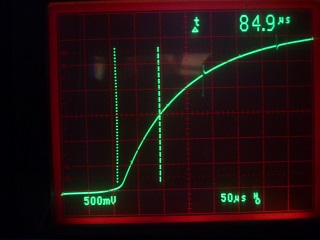

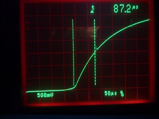

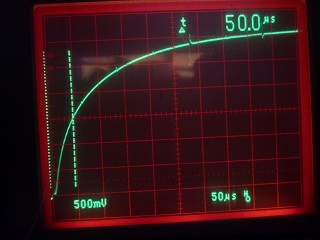

                    I hope this is somewhere near correct, but I am now looking at the start of the decay waveform. The saturation level of the preamp is slightly over + and - 3V. The graticule line just below the 50uS at top is zero level. This makes the middle line on screen to be half voltage. The position of the quarter in the first picture was such that it just touched the saturation level of the amplifier. The time to half voltage is measured as 50uS. which corresponds to 0.7 Tau.
                    Positioning the coin closer to the coil increases the amplitude so that the first part of the waveform is fully saturating the amplifier and we can now look at a later portion of the decay. Re-positioning the cursors to measure just coming out of saturation to the half voltage again, gives 84.9uS.
                    Repeating the above to get yet more signal and a longer saturation, results in a reading of 87.2uS, which is less of a change. These three results show that the first part of the decay has a faster rate due to the superimposed early time diffusion decays (the curved part of your log/linear plot) which settle down later to the single fundamental decay. You could start from the back end and work forward, but double the signal for each measurement.
                    This doesn't seem to match what I have done before, so I will look at the method again.
                    Eric.

                      Hi Eric, posted before I saw your reply#99. Looking at your previous quarter scope picture I read closer to 150usec to cross 2 and 4 divisions. Looks like your amplifier doesn't have a step response coming out of saturation. Maybe if you center zero, the amplifier will be out of saturation when the trace crosses -4div, 500mv/div scale.

                        Another test. Shows what I was thinking wrong. Tx_.5A constant current, Takes about 25usec to ramp up to .5A. Scope triggers on Tx off. Time scope is saturated(trigger to start of decay)is greater than time between 4 to 2 division decay in all scope traces. The TC increased with Tx on time increase. Thought if time at saturation was greater than decay time it wouldn't.

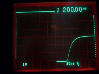

                          Hi Green,
                          Here is my amplifier trace at the end of the TX period. I'm using x10 timebase magnification to expand this portion. Full TX still 1mS.
                          First picture is for no object and the second picture is with Nickel to give a bit of saturation. The scope does not saturate if I increase vertical gain to 100mv div.
                          Eric.
ID:	350313Click image for larger version

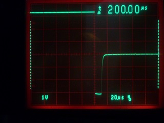

                                Hi Green,
                                Eric.
                                [ATTACH]41775[/ATTACH][ATTACH]41776[/ATTACH]
