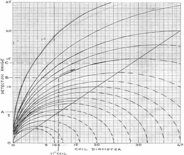

    Target, 20 inches deep. Best coil size, 40 inch diameter. Target just detectable with the 40 inch coil. How to approximate detection depth with a 20 inch diameter coil?
    Keep inductance and current profile the same.

            Presumably your 40" coil figure comes from the not-that-well-known data available online, particularly the graphs drawn by Eric Foster? The ones with the semi-circular curves?
            Based on them, it would appear that a 41" coil or a 39" would be too big/small.
            I'll dig out my copies of those graphs and report back later.
            Update: That was easy, found the graph, can't locate the instructions, yet ....but:
            Target depth with 20" coil will be 17.5"
            I'll add the graph later when I find the 'manual'.

                    Back to Erics graphs: Here's the graph, I can't find the original explanation.
                    This is for PI machines, for circular mono coils, not accounting for ground effects.
                    Basically each solid curve is for one particular size target. Bigger targets have a higher-up curve. So take the point where the 40" coil just detects the large target 20" away. Now move left down that line, and when the coil-size reads 20", you will see a target depth of 17.5", as I quoted earlier.
                    I have never tested out this data, I'm not a PI guy, and how circular mono-coils compare to elliptic DD's is not my specialised subject : )

                          http://www.geotech1.com/forums/showt...438#post228438 Graph with text. Curves are for constant number of turns not coil inductance.
