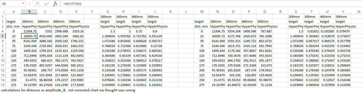

    Hmmm.. you didn't say how you corrected it. So I can't assess your reasoning. But I have spent some (lots) time this evening on hyperphys trying to check your charts - including the constant inductance.
    I concentrated on the Z = 0 points, as that's easier, mathematically speaking, and we seem to agree the general shape of the curves is correct.
    It appears your 'reference' point on both charts is for the 200mm coil, at Z = 0, giving a reading of 12000 signal amplitude. I had to calculate this based on the Z = 25mm data point at 10000 amplitude.
    For the fixed inductance curves, I calculated Z = 0 amplitudes of:
    200mm coil: 12000
    300mm coil: 3270
    400mm coil: 1275
    500mm coil: 709
    These seem to match well with your figures. This assumes 'received voltage' is proportional to 'received current'. (due to fixed inductance).
    For the Fixed number of turns chart, the reference curve is the 200mm coil, with 12000 amplitude at Z = 0, as before.
    I multiplied the 'recieved current' by the calculated inductance L = 278 uH, then found a scaling factor to get 12000.
    For the remaining larger coils, the transmit (current x turns) was kept constant, as turns is kept constant. The received voltage was multiplied by the coil inductance, then by the previously-determined scaling factor. Results are:
    200mm coil; L = 278 uH; 12000 amplitude
    300mm coil; L = 458 uH; 8787
    400mm coil; L = 651 uH; 7025
    500mm coil; L = 853 uH; 5892
    Notice that these are much closer together - you're gaining with the larger coils because: you're transmitting a constant (Amp-turn) product, and because: the coil inductance goes up roughly in proportion to coil diameter, so the received voltage goes up too.

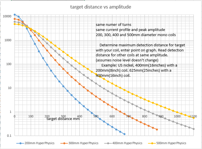

    For same inductance I think I followed your instructions reply#34. I=23.874*(200mm/coil mm)^.5, enter coil radius and target distance, record Gauss. Rx(chart amplitude)=Gauss^2*5331, (200mm coil with 25mm distance=10000)
    added the zero distance points latter.
    For same number of turns. Error chart, I=23.874 for all coils, enter coil radius and target distance, record Gauss. Rx(chart amplitude)=Gauss^2*5331.
    Corrected chart, Rx(chart amplitude)=Gauss^2*5331/(coilmm/200mm)^.5.
    Receive amplitude is proportional to inductance(Tx_Ampere turns, Rx_turns or turns squared) so I calculated what I thought a 300mm coil should be and played with squaring something until I got the same answer. Don't know if it makes sense. Should have checked with inductance increase the first time I charted same number of turns.
    Trying to make sense of what I did, not sure it's correct.

              Calculations for the first 275mm target distance. Makes it easy to compare which coil gives the highest reading at the selected coil radius, Eric's chart. Error chart(I think might be correct now) and same inductance chart. Error chart(same turns)calculations on left side, same inductance chart calculations on the right. Changed I for each coil diameter when calculating Gauss for same inductance chart, I=23.874*(200mm/coil mm)^.5

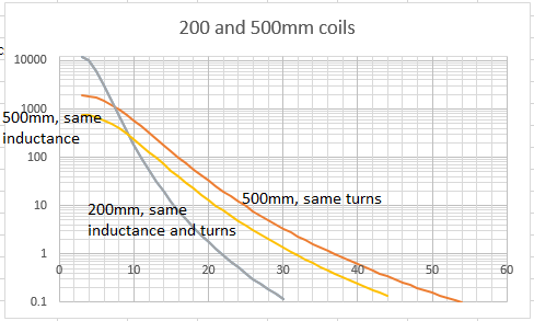

                    • Woke up this morning wondering if I was changing the slope when calculating same turns or same inductance coils. Charted the 200mm and 500mm coils on the same chart. Does it make sense that slope doesn't change and the 500mm same turns Rx signal is 2.5 times the 500mm same inductance Rx signal?
                      • Quote:"Why are you correcting for varying inductance with constant turn coils? Doesn't the HyperPhysics calculation do that when you enter a radius?"
                        I'm working on the assumption that when we use hyperphys, we are putting a current in, and getting a current out. To 'translate' that output current into a voltage, we need to use the relationship:
                        V = -L * dI/dt
                        I hope this is correct.
                        Hence for the constant-inductance coils, we don't need to do any compensation, just assume "Voltage out = current out" and let the arbitrary correction factor take care of it.
                        But for the constant-turns/variable-diameter coils, the inductance varies, increasing roughly in proportion to the diameter of the coil, so I was suggesting that output voltage:
                        V = I * coil diameter * correction-factor
                        I wonder if there's an alternative way we could simulate, such as actually modelling the target, and using the receive coil as a voltage source. For double-checking purposes.
                        • Quote:"Charted the 200mm and 500mm coils on the same chart. Does it make sense that slope doesn't change and the 500mm same turns Rx signal is 2.5 times the 500mm same inductance Rx signal?"
                          The slope doesn't change because that is determined by geometry, just the radius of the coil, and the distance away on the Z axis. So a 500mm coils behaves like any other 500mm coil, shape-wise, it's just things like number of turns, and transmitted current that shift the whole curve up or down as appropriate.
                          Re: the 2.5:1 voltage ratio.
                          I calculated at Z = 0, the same-turns signal was down to 0.4 ( = 1 / 2.5) eg. 12000 down to 4800
                          ... and the same-inductance signal was down to 0.101 ( = 0.42 * square-root(0.4) ) ( or 0.42.5 )
                          eg. 12000 down to 1212.
                          These two figures are pretty much 4:1 ratio.

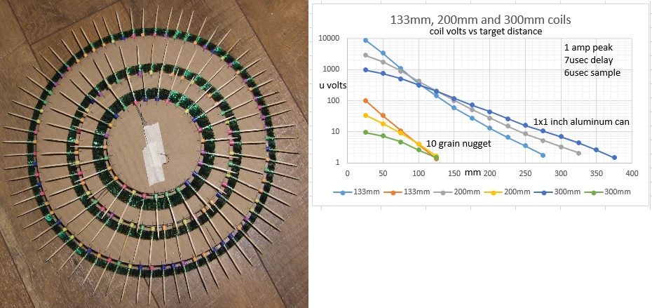

                          I'm curious about the 133/200/300 test coils you made. Do you have more detailed dimensions, eg. outer diameter, inner diameter, of the windings? I'm thinking of how well their performance matches up to our theory ( or many theories..).

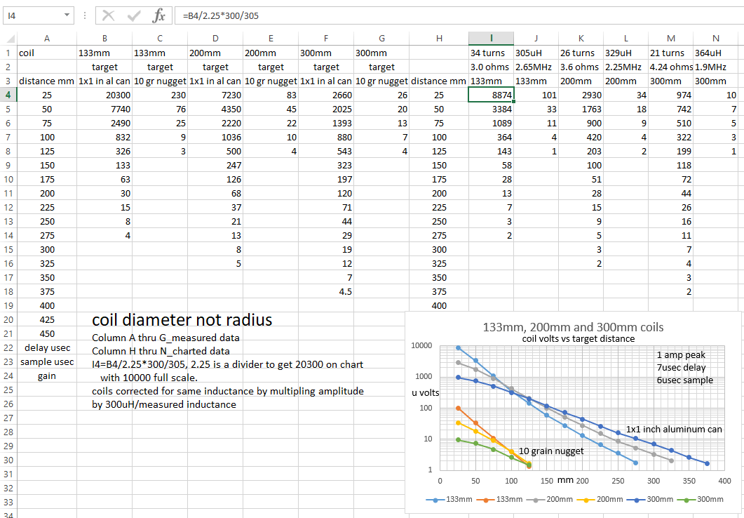

                            • I'm curious about the 133/200/300 test coils you made. Do you have more detailed dimensions, eg. outer diameter, inner diameter, of the windings? I'm thinking of how well their performance matches up to our theory ( or many theories..)
                              _____133mm coil 200mm coil 300mm coil
                              ID ___120mm___ 195mm____ 292mm
                              OD__ 146mm____ 205mm____ 307mm
                              including chart with turns, resistance, inductance and resonance for the coils + test data. Coils are spiral wound around tooth picks with awg28 magnet wire. Inductance wasn't exactly 300uH for each coil so measured date was multiplied by 300uH/coil inductance before charting.
                              After playing with the target response tester and seeing how much target orientation(flux lines crossing the target) effect target decay I wonder if the target data matching HyperPhysics means a whole lot.
                              • Thanks for the test-coil info. I think that assuming coil diameter is the mean of the inner and outer diameters is going to be OK. What is potentially the tricky thing with these flat coils is the lack of mutual inductance between each turn. Which means the inductance will be less than a tight bundle would be. This will affect the smallest 133mm coil the most.
                                I've been struggling to work out how to analyse the measured data, do I use the original or corrected data, can I correct it a different way etc. What I was trying to find out, in particular, was the Z = 0 figure. It would be nice to end up with a straight-line plot of real vs theoretical data, that I could just draw a straight-line through and get the best fit relationship, and hence calculate a good 'measured' Z = 0 value. In the end, I settled for a non-graphical estimation.
