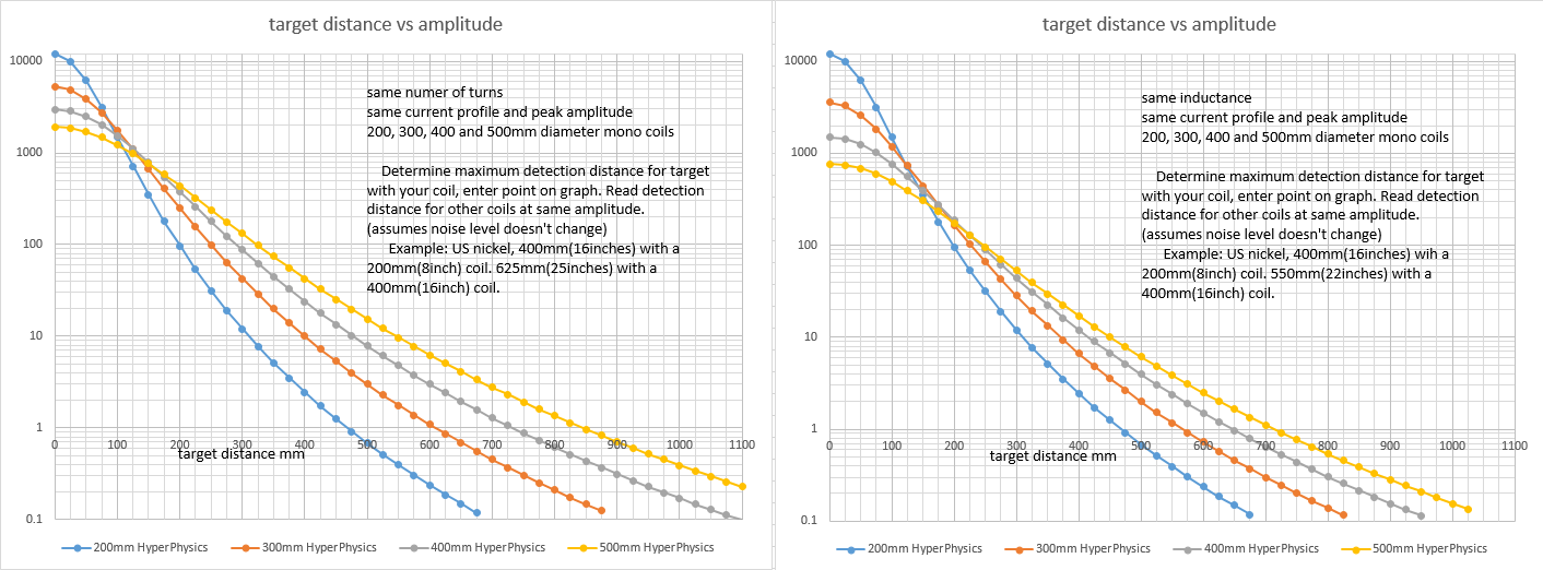

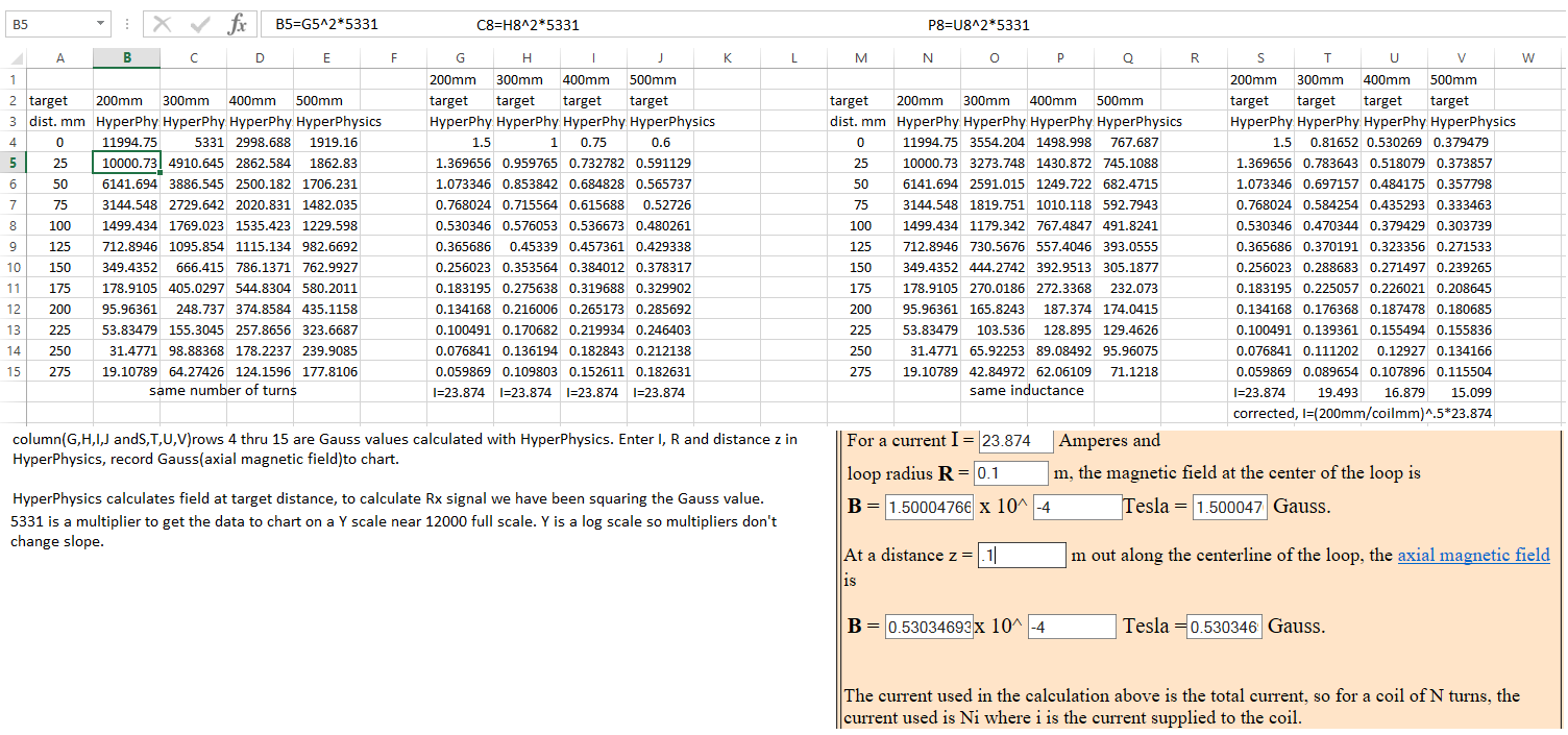

I hope you have cracked the problem. I've been working on a reply but will wait to see your reply first. Did a test awhile back correcting for inductance change.
http://www.geotech1.com/forums/showt...537#post203537
