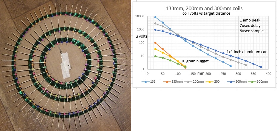

          Wound a 200mm diameter coil and one 200/1.5(133mm) and another 200*1.5(300mm). Charted signal strength vs distance for the three coils(same inductance)and got similar results as Eric's curves. Curves cross at diameter(coil A + coil B)/4. The chart suggests a 48 inch coil would give the highest signal strength. Maybe not the best signal to noise. Can't swing it if the ground isn't smooth. I would think a coil diameter equal to the depth would be a good place to start if terrain allows.
          chart for the coils I posted awhile back.
            Doubling the coil diameter reduces the target signal to 1/8. What does doubling coil diameter do to the ground signal?
              Everything else being equal. it stays the same. At least, that is what my tests in Australia indicated, a few year back.

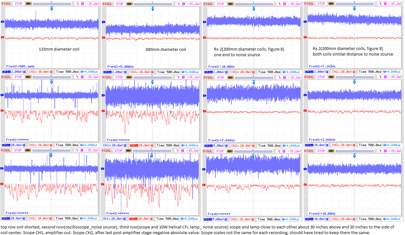

                Was wondering about noise with different size coils. Some tests with 133mm, 300mm diameter mono coils and Rx 2(200mm diameter figure eight). Scope pictures varied each scan, stored a typical scan. Moving the noise source effected the noise signal. The 300mm coil appears to be noisier than the 133mm coil, noise sources were fairly close to the coils, wondering if the recordings would be different if stronger noise sources were 100 meters or more away. Guessing the figure 8 coil wouldn't be effected as much by orientation if the noise source was a lot farther away, maybe not? Scope scales not the same for each recording, looking at the picture it would be easier the see the difference if they were the same scale.
                Is the noise increase with the 300mm coil over the 133mm coil what would be expected or should it be higher or the same?

                            Back to Erics graphs: Here's the graph, I can't find the original explanation.
                            This is for PI machines, for circular mono coils, not accounting for ground effects.
                            Basically each solid curve is for one particular size target. Bigger targets have a higher-up curve. So take the point where the 40" coil just detects the large target 20" away. Now move left down that line, and when the coil-size reads 20", you will see a target depth of 17.5", as I quoted earlier.

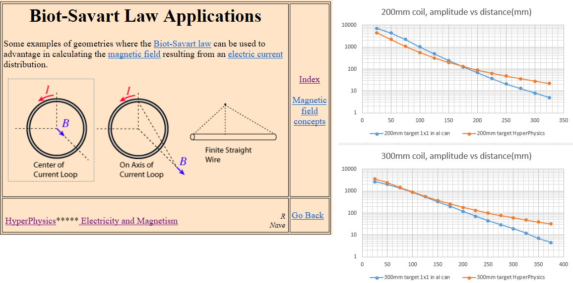

                              Still wondering about best coil size. Example: an eight inch coil can detect a target at sixteen inches, what diameter coil would detect the target the greatest distance and what distance would that be? Everything the same(inductance, current amplitude and profile, PI timings, noise level, etc.)except coil diameter. I charting some data with a 200mm and 300mm coil vs output from Hyperphysics. Entered twice the distance in Hyperphysics to get it to make sense. Still not close to my measured data. Think I'm doing something wrong with Hyperphysics. Wanted to chart distance vs amplitude with Hyperphysics for a 200, 300, 400 and 500mm coil to see if that would help determine best coil size. Any ideas where I'm going wrong(maybe the wrong law in Hyperphysics) or how to calculate best coil size for the example?
                                I have lots of target strength vs distance charts plotted out (VLF machine, 11" x 7" bi-axial DD coil) . So I laboriously plotted your 200mm Hyperphys data onto paper to compare. And you've definitely got something wrong. All my small targets dropped away much faster than your HP figures. The only target that resembled your HP data was a 3" long ferrite rod, end-on to the coil. It was actually a good match (when close to the coil) , but I don't think there's anything to learn from the match. The rod is not a small target - when it's at 0", some of it is 3" away.
                                It looks like your HP model isn't correct when targets are close to the coil - there just isn't the steep fall-off in signal strength as distance increases.
                                But seeing as I don't know how you've modelled your coil & target, I've no idea what's gone wrong.
