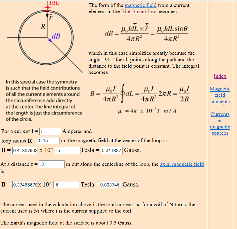

      Probably doing it all wrong. Entered 1amp, .15 R for 300mm coil, .3m for .15meter distance(out and back), charted Gauss*E5(amplitude) at 150mm distance. Charted distance vs amplitude(entered 2 x charted distance)for the other data points.

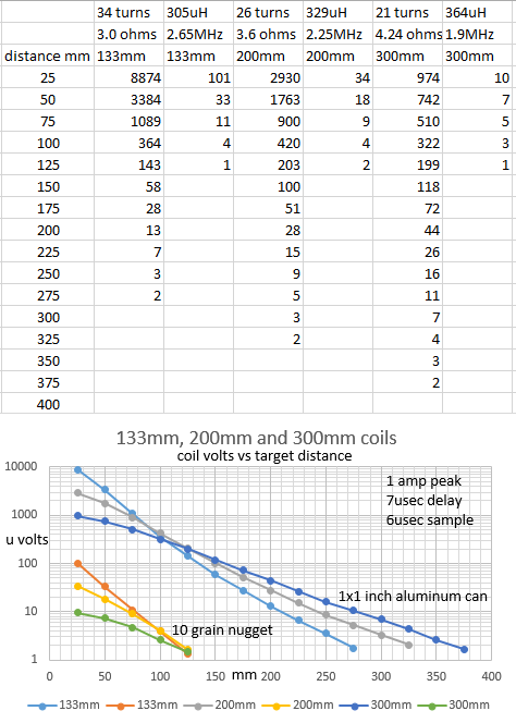

        Want to add calculated distance vs amplitude data to the measured chart. The data was measured with two targets, 10grain nugget and 1x1inch aluminum can side. The measured amplitude was multiplied by 300uH/coil inductance for equal coil inductance, coil current in a control loop for equal current amplitude and profile. Measured data: coil diameter effected slope, target effected amplitude. Could someone suggest a method to calculate target distance vs amplitude data to add to the chart? Don't know if target matters, trying to match measured slope. What I tried with Hyperphysics didn't work probably because I don't have a clue, just guessing.

          For the benefit of everyone else, this is the hyperphysics page Mr. Green is using for his maths:
          http://hyperphysics.phy-astr.gsu.edu...ic/curloo.html
          What I suggest is:
          Use a current that gives a field strength of 1.00, makes the sums easier. So enter I = 23.874 for the 0.15 radius coil. Then at Z=0, field = 1.00 Gauss. Now at target z = 0.30 m, field = 0.0894 G. Now square this, to account for the 'round trip' back to the receive coil, and you get ReturnSignal = 8 x 10E-3 ( = 1/125 )
          Sadly this is nothing like my measured DD coil figures. Going from (an estimated) Z=0.00 out to Z = 0.30 m for a small target like a US 1 cent coin produces a signal that drops off from 3000 to 0.5, ie. 1/6000. A whole lot of difference.
          However... this is a DD, not a monocoil. And a coin isn't a perfect target, it's thin and flat, and not tiny in size. I've never tested any spherical targets, and obviously monocoils don't fit IB VLF's.
                What I suggest is:

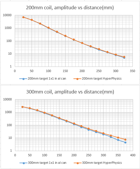

                Many Thanks, Tried your method with a multiplier to match recorded data at 25mm. Looks good, might need to retest 300mm coil at longer distances.
                  That's better. It might be worth plotting the hyperphys data for Z = 0, and Z slightly beyond your max real measured data, next time.

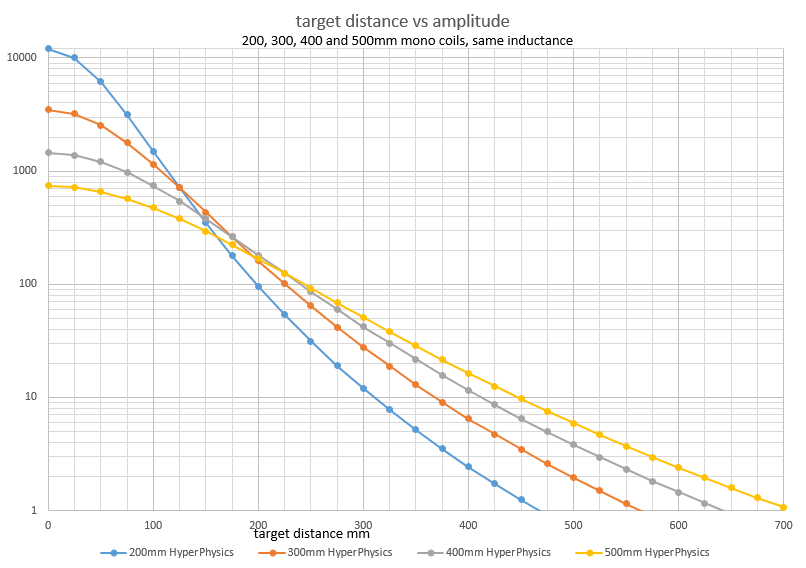

                    Still wondering about best coil size. Example: an eight inch coil can detect a target at sixteen inches, what diameter coil would detect the target the greatest distance and what distance would that be? Everything the same(inductance, current amplitude and profile, PI timings, noise level, etc.)except coil diameter. I charting some data with a 200mm and 300mm coil vs output from Hyperphysics. Entered twice the distance in Hyperphysics to get it to make sense. Still not close to my measured data. Think I'm doing something wrong with Hyperphysics. Wanted to chart distance vs amplitude with Hyperphysics for a 200, 300, 400 and 500mm coil to see if that would help determine best coil size. Any ideas where I'm going wrong(maybe the wrong law in Hyperphysics) or how to calculate best coil size for the example?
                    Thanks to Skippy an attempt at charting the coils. Example: a 200mm coil can detect a target at 400mm, what diameter coil would detect the target the greatest distance? The 500mm coil has the same signal amplitude at almost 600mm distance. Would need to chart some larger coils to answer the question assuming the chart is correct and noise level didn't increase.
                    A target just detectable at 100mm with the 200mm coil wouldn't be detected with the 400 or 500mm diameter coils at any distance.

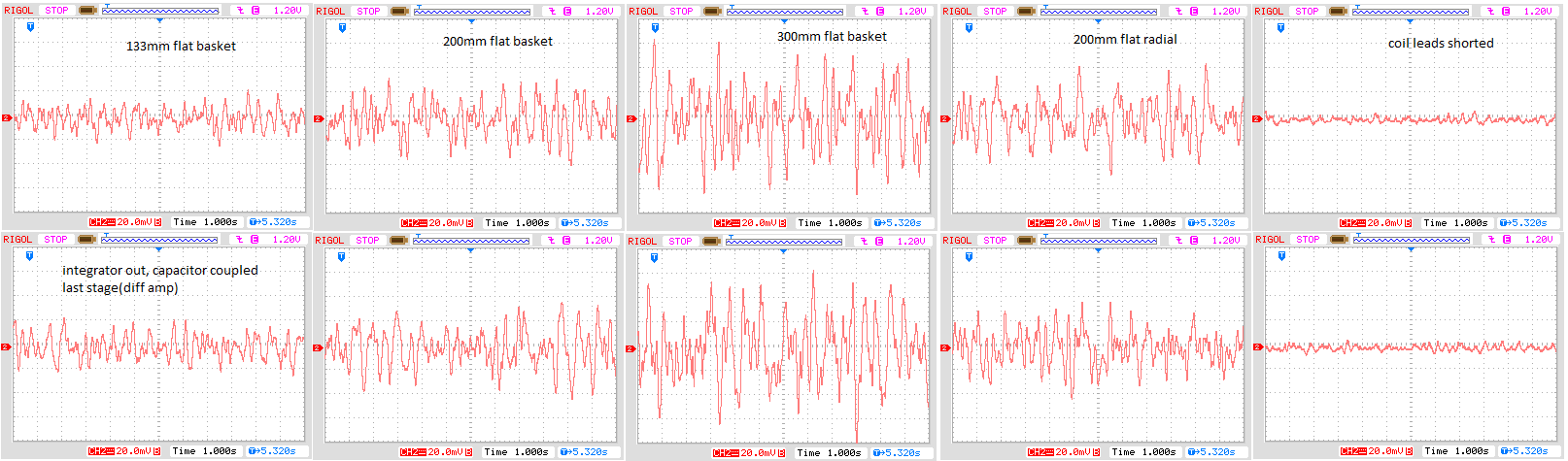

                        Coil noise test. Coils not shielded, connected to a differential amplifier(gain about 450) transmitter disabled. Scope connected to last stage of amplification after integrator, 10usec target and EF sample , 1000 samples/second. Noise increases with coil diameter on the bench(scope is the only thing turned on near the coil, about 4feet). Is it possible to shield a coil from EMI to reduce the noise level? Thinking might try to EMI shield the flat spiral coil(suggestions appreciated). Should I expect a similar increase in noise with increasing coil size with a detector on the ground? Is the noise trace shape similar to other PI detectors, shape not amplitude? Maybe someone could post some scope pictures(.5 or 1sec/div time scale) of the last stage of amplification before audio at 2 or 3 div p-p amplitude.
                          Try dividing the coil field strength by the coil surface area and the coil surface area by the target surface area. Compare the ratios with different target/coil ratios.
                            To avoid loading the coil with too much coil wire to shield capacitance, place a spacer of about 1/8 to 3/16 between the coil wire and the shield.
                              Trying to understand how to use your reply to answer my question or how you use it. Can you give an example? [same coil inductance and current profile]200mm coil(23turns, 1amp peak) 400mm coil(15 turns, 1amp peak)[used coil calculator, both 325uH]. Target signal not proportional to target area, recorded integrator out for US nickels and quarters, nickel(smaller diameter) has a higher signal than quarter. Signal for three coins probably 3 times 1 coin signal(meter resolution), Use 30mm x 30mm for target that can be detected at 400mm with the 200mm coil. What distance would the 400mm coil give the same signal strength or how would you look at it? Just trying to learn or understand. I have seen coin detection distances reported in other threads that would be hard for me to detect, trying to understand the variables that I would need to change to get there.

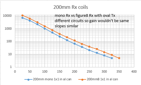

                                Charted distance vs signal for the figure eight coil I've been using. Two Rx 200mm Rx coils covered by a oval Tx. The two 200mm Rx coils for the figure eight coil same as 200mm mono coil used in above thread charts. The slopes were close, amplitude was different because of different circuits(gain, current and sample times).
