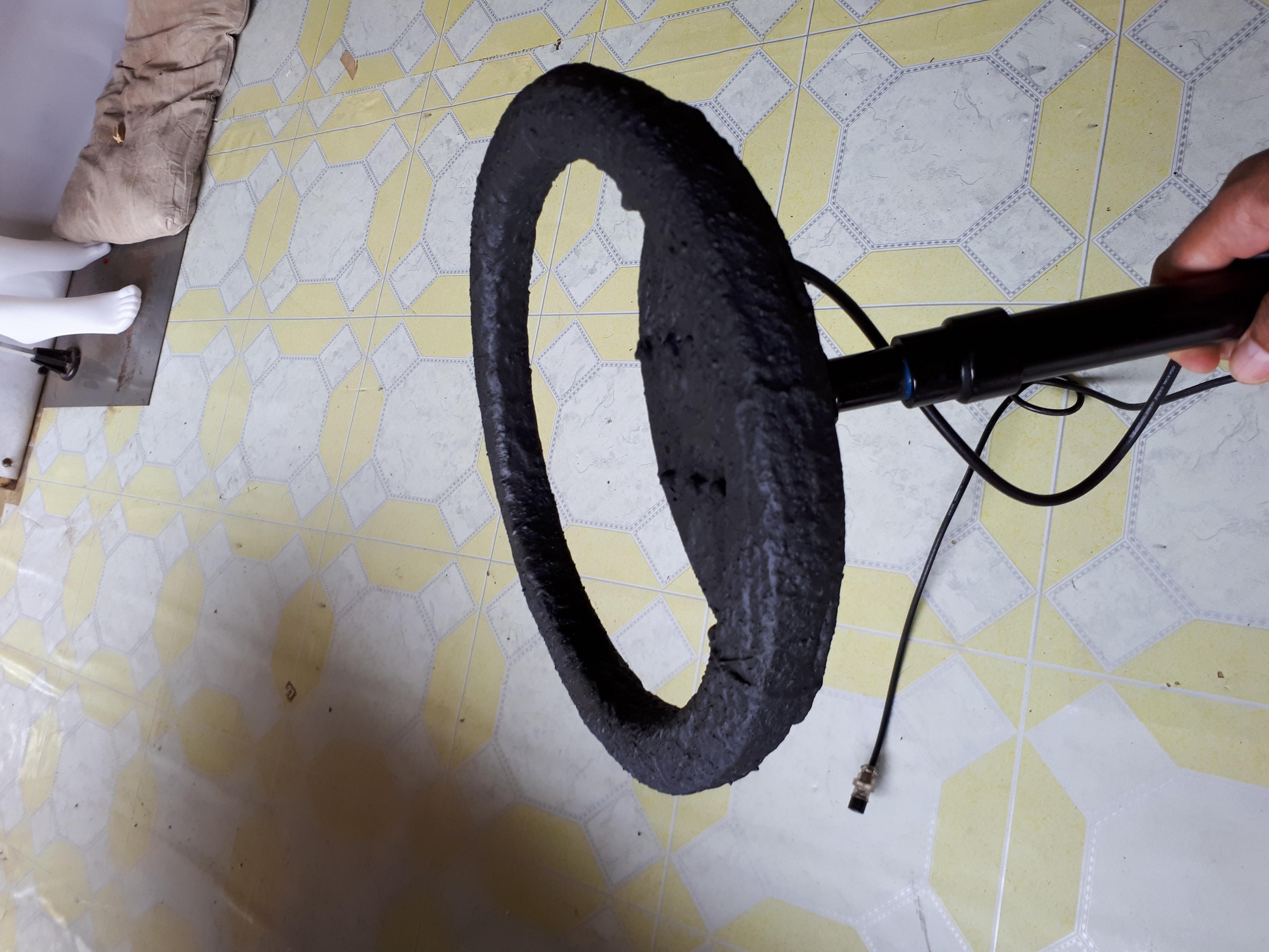

          I just finish the charcoal mix with wood glue. Is that good to have a reading of 2.2k ohms from end to end of the coil shell or it need to be an open circuit? And does it really need a gap? Because i believe that using non metal shield dont need that gap..
ID:	349340 results is the machine is very stable, can crank the sensitivity to max, threshold can be heard without falsing. But sensitivity to target drops up to 30%.

                      [ATTACH]40588[/ATTACH] results is the machine is very stable, can crank the sensitivity to max, threshold can be heard without falsing. But sensitivity to target drops up to 30%.
                      Hi jladre, thats P.I coil? After shield have you been check decay again?

                        Yes it is a pi coil. I don't check the decay. Im frustrated of the results. I think i need to gamble on graphite.

                          Yes it is a pi coil.. i hav'nt check the decay..i remove those black charcoal. I think i just put to thick on to it thats why it ruin the depth.

                            jladre what was the source of the charcoal ?, I'm no expert on this but maybe the low 2K resistance could be starting to act like a shorted turn , if you are going to remove the charcoal shield it could be worth first cutting a small gap and retesting the depth, or remove the charcoal shield and reduce the amount of charcoal in the glue mix to increase the resistance.
