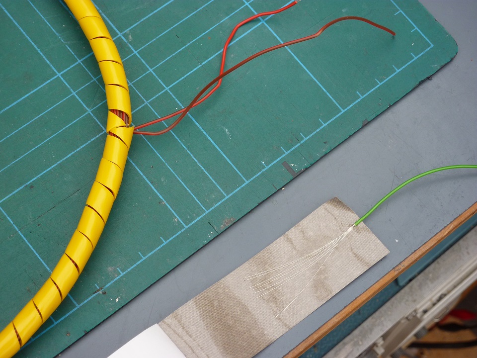

    I have found some conductive fabric tape that works extremely well and is very reasonably priced in various widths. It is item 262159780594 on ebay. Wrap around coil but leave a gap to prevent shorted turn and connect with a drain wire under the adhesive. I used a 15cm length of 7/0.2 stranded pvc insulated wire with 75mm stripped, splayed out slightly and under the start (or end) of the shielding layer. The connection from the drain wire to the tape surface measured 0.1 ohms, which is good. To the far end of the shield at the gap it measured 0.5 ohms to the drain wire.

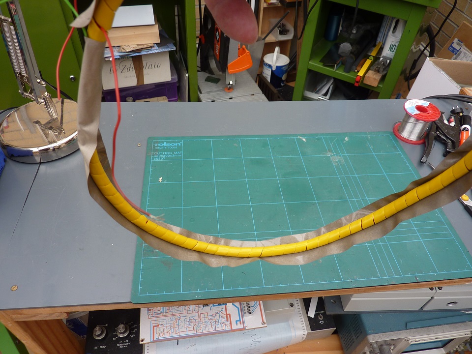

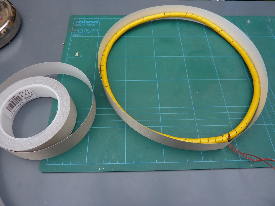

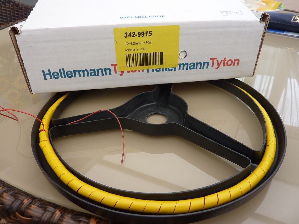

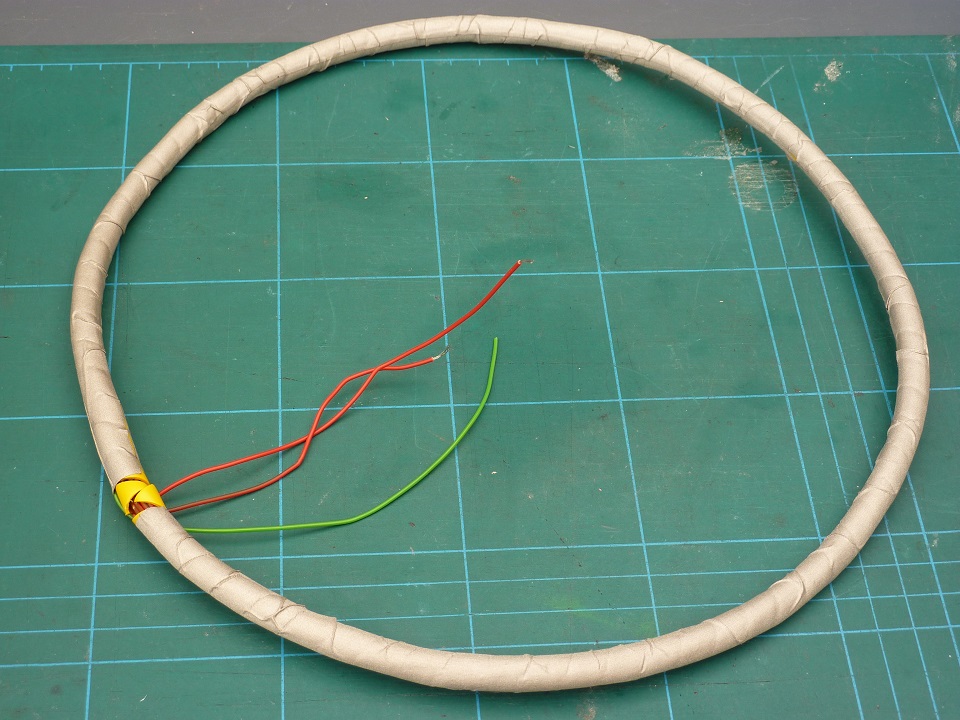

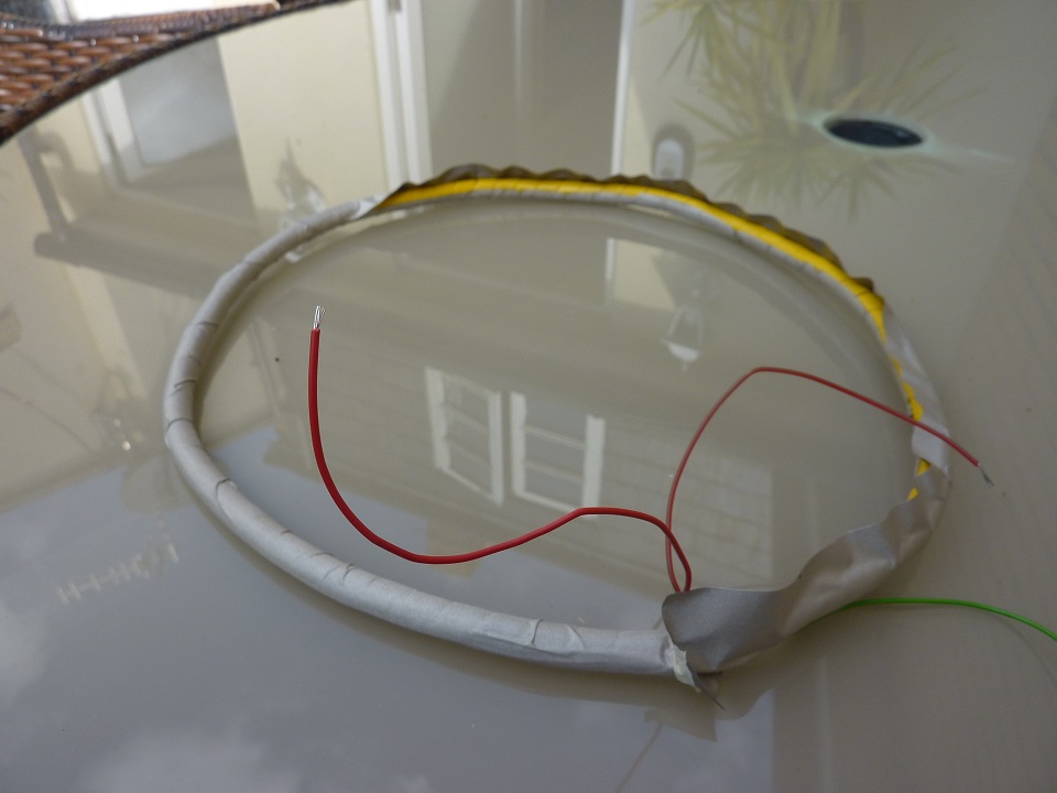

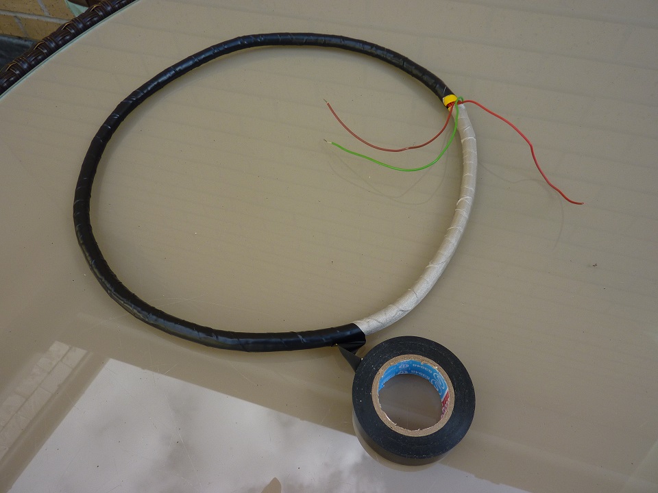

            I have bought both 25mm and 30mm widths. I depends on the bundle diameter but if possible I do not spiral wrap the shielding as it is very tedious, especially on small diameter coils. I cut a length about equal to the coil circumference and do a fold over job around the coil winding. First though I put on some spiral wrap as a spacer to reduce the coil /shield capacitance. Below are some pictures of the process. The 30mm width tape just overlaps on the coil, whereas the 25mm is right for coils with thinner wire e.g. the Vallon detector. A wrap with pvc tape prevents the resin in the potting process from softening the shielding tape adhesive. It is only a precaution, but did happen with some previous tape some years ago. Don't forget the gap in the shield which is best where the wires come out.
              Eric.
