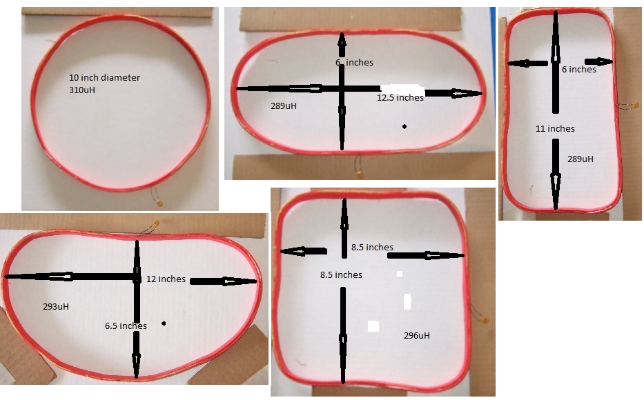

                      Made a 10inch diameter single layer vertical coil that I could bend to different shapes awhile back. Took some pictures with different shapes and measured inductance.The round coil had a little higher inductance, the others close. 95% of the round diameter inductance would come close for the others. Don't know if bundle wound coils would be similar. Could try to bend to other shapes if anyone is interested.

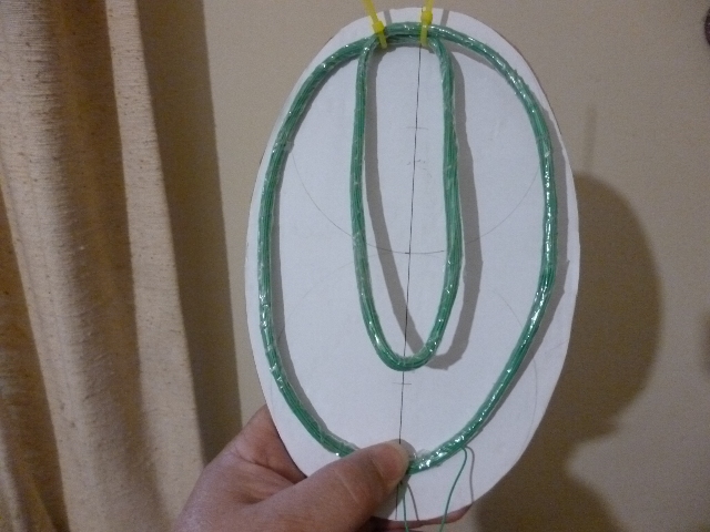

                        This sort of plays tricks on your mind as to what should the inductance do if you bend the coil out of shape, guess what the inductance did when I bent a folded 8 coil.

                          Green thanks for sharing it, very informative.
                            Some years ago, I did a similar experiment to Green, with a smaller bundle-wound coil. I had similar results, a rectangular 2:1 aspect ratio coil was about 6% lower inductance than the circle.
                            In one of the other previous threads on this topic, I reported this, and as a result, recommended using the circumference of an off-round coil as the basis for a circular mathematical model, just allow for 3 - 6% drop depending on the severity of the shape.
