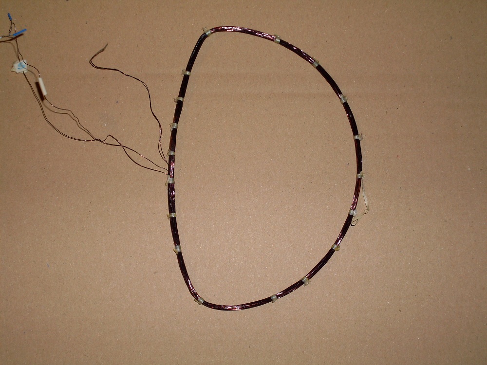

    One of my experiments
Name:	80 Turn D Coil b.jpg
ID:	349389Click image for larger version
Name:	80 Turn D Coil Graphic b.jpg

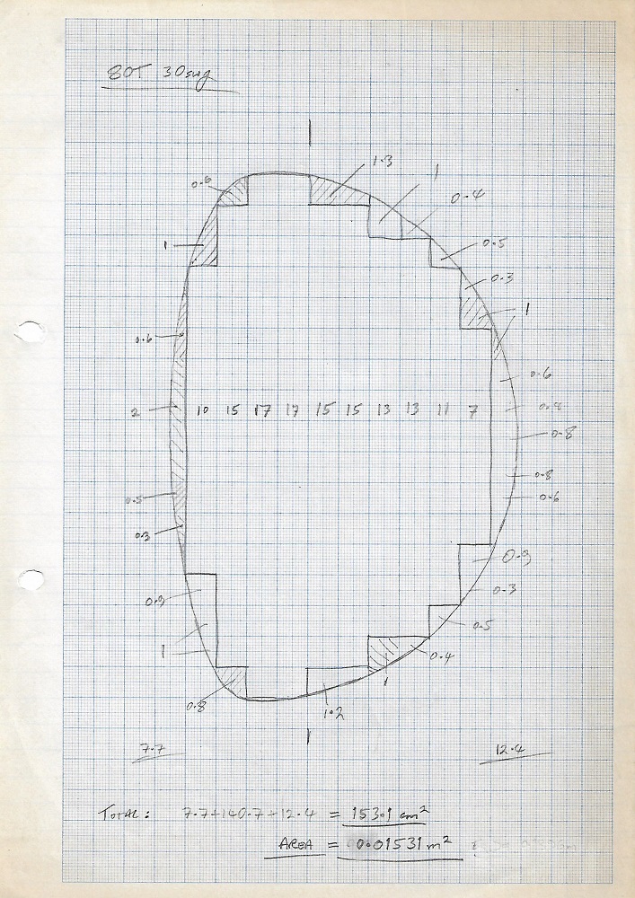

    This is a roughly 'D' shaped coil with 80 turns (centre tapped) of 30swg wire, outside diameter 0.344 mm. To find the area it enclosed I drew the internal shape on graph paper - as this was an experiment I tried to get it as accurate as I could, which meant I ended up counting square millimetres. The area was 153.1 square centimetres.
    For a circle, Area = pi*radius squared
    Therefore radius = sq root (Area/pi)
    From this the radius of a circle whose area is 153.1 sq cm is 6.98 cm or 69.8 mm.
    Putting this radius into Qiaozhi's Inductance Calculator along with the no. of turns and the wire diameter gives a result of 2.31 mH. The measured inductance was 2.29 mH.
    That's close enough for me - I'm convinced the 'Area' approach is correct, and should work for any shape coil as there's nothing special about this one.
    What is interesting is that the ITMD method described in post #2 also gives, for this coil at least, a surprisingly good calculated result (2.37 mH). This method is mathematically equivalent to finding a circle with the same area as an ellipse, and it is true that a lot of 'D' coils do roughly resemble ellipses with both ends skewed over to one side. More evidence that the 'Area' approach is right, I reckon.
    Summing up: For the best accuracy, measure the area enclosed by the coil. For what may be good enough accuracy use the ITMD method, but this will depend on the coil shape.

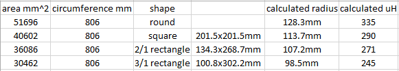

        Calculated inductance based on area for four shapes. Kept circumference the same. 20 turns, .4mm diameter wire, Qiaozhi's coil formula. Don't know if using circumference or area to calculate radius for the formula is more correct. Using area predicts a greater change than Skippy or I got in our tests using circumference(compared change in shape against a round coil). Wrapping a string or piece of wire around the coil form to get circumference, calculating radius and using Skippy's calculation reply #14 would be easier than measuring the area.

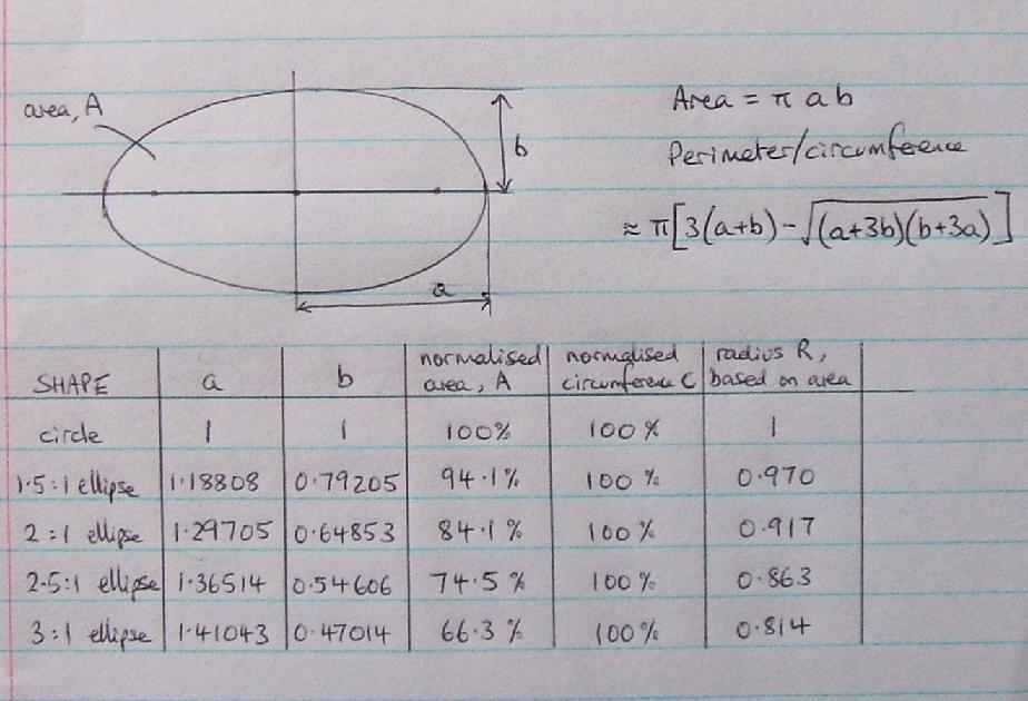

          I read up on the maths of ellipses, and learnt something new in the process. Surprisingly, there is no precise formula for the circumference/perimeter of an ellipse, only good approximations. The formula I vaguely remembered,
          Perimeter = pi * sqrt(2 * (a^2 + b^2))
          is only a simple approximation, there's two other better ones, which I used in my calculations.
          I assumed a circular coil of radius 1 (metre), and then calculated the dimensions of various ellipses when the same coil is re-shaped. So the circumference remains unchanged. For each elliptic shape, I calculated the area, expressed as a percentage of the circle's area. I then worked out an equivalent circular coil radius, based on this elliptic area.
          These figures are shown on the attached jpg.
          So, as an example, the ( 2.5 : 1 ) elliptic coil:
          If you used the "circumference method", you'd end up with a radius the same as the original circle, obviously. This would give you a real coil with a slightly low inductance, something like 6%. You would compensate for this intuitively, for example using Green's photo of his re-shaped test coils as a guide.
          If you worked out your equivalent circle size based on elliptic area, you would have R of 86.3% of the original circle, ie. 14% down. This looks to be over-compensating, compared to experimental data indicating about 6% lower inductance.
          If you used the "mean of the two diameters" method, you would end up using an equiv. R = (1.365 + 0.546)/2 = 0.955, ie. 4.5% lower than the original circle. This is actually pretty close to the experimental data.
          As a summary, I think:
          *The "circumference method" works regardless of whether the coil is an ellipse or a squashed D shape, but it does require some empirical guesswork to compensate for the off-round shape.
          *The "mean-of-two-diameters" works well for true ellipses, but for flat-sided shapes it requires a bit of 'fine-tuning', which I'm not sure about.
          * The "area method" gets progressively worse as the elliptic shape gets more severe. For near-round shapes it's not too bad, but there are simpler ways of achieving the same result, in these cases.
          Here's a link to some ellipse maths:
          An ellipse is a curve that is the locus of all points in the plane the sum of whose distances r_1 and r_2 from two fixed points F_1 and F_2 (the foci) separated by a distance of 2c is a given positive constant 2a (Hilbert and Cohn-Vossen 1999, p. 2). This results in the two-center bipolar coordinate equation r_1+r_2=2a, (1) where a is the semimajor axis and the origin of the coordinate system is at one of the foci. The corresponding parameter b is known as the semiminor axis. The...
          And attached are my calculations:
            The advantage of the circumference (actually perimeter) method is that it doesn't care what the shape is (within reasonable limitations) and is based on fundamental physics (inductance of free space). In other words it gets you "almost there" from first principles using elementary school math. After you've actually wound the coil and measured it, guess what-- your prediction will be off! so you change the number of turns in proportion to the square root of how much you missed it by. The second pass usually gets you within the resolution of a finite number of turns. ......No matter what method you use, that second try is almost always necessary anyhow. Sometimes a third. So you may as well keep it simple and use the "circumference" method.
