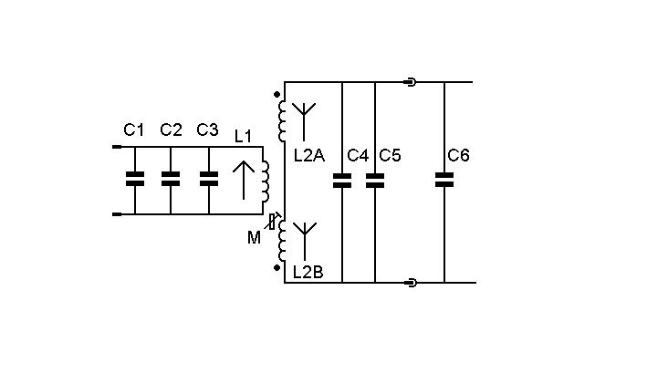

        Currently, I am facing the problem of choosing the parameters of the receiving coil. I decided to make 2 receive coils, connected in series in the "DOD" configuration (similar to the Super-D), working at close frequency of 15 kHz resonance. Click image for larger version
ID:	351604 Click image for larger version

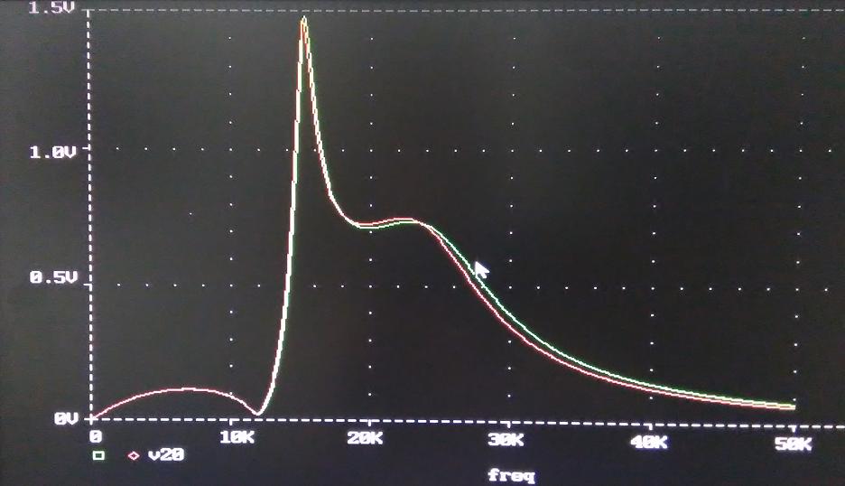

        I made simulations of DFX input circuits with a standard RX coil with inductance of around 14mH and 36 Ohm resistance, connected in series with 220nF capacitor according to the scheme and modifies the capacitor values ​​for this frequency, because the current characteristic due to supported two frequencies (3 and 15 kHz) is wide. I will try to get resonance narrow and steep characteristics. I'm afraid that with such a large induction, getting a strong enough signal from a small object can be difficult to achieve, or maybe even impossible ...Click image for larger version

          Despite striving to obtain a sufficiently strong signal from the receiving coil by using more coil turns - I came to the conclusion that the inductance of the transmission coil for a given detector operation frequency can not be too large and its value determined by the manufacturer is not accidental. Large inductance means a reduction in capacitance, and the parasitic capacitance disturbs the stability of the amplitude-phase characteristics. The greater the inductance for a given frequency - the smaller the capacity that is involved in shaping a stable resonance characteristic and, unfortunately, becomes more significant. Please correct me if I'm in error

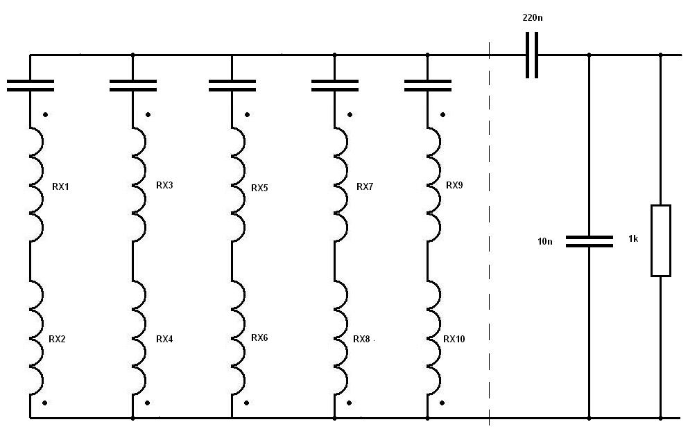

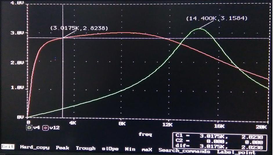

            After many trials and computer simulations, I came to the conclusion that the best will be a set of 5 parallel-connected sections of receiver coils tuned to resonance, composed of 2 wound series-opposing. One large coil has too much voltage unbalance and has less sensitivity due to fewer turns for the same inductance as smaller coils and a larger number of turns.
            Resonance characteristic
