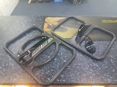

    Your design looks interesting, where did you get the idea from? It looks somewhat like the gpz 19 inch super D coil shape. Bigger coil bigger EMI effect. Required very good shielding.

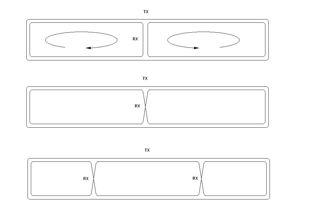

                  I still have a question about the configuration of the coils: what are the advantages and disadvantages of the following in relation to the DD system?
ID:	351519Thank you in advance for all the hints

                      i think first and second pics are same.
                      • #71
                        They look the same for reversing the flow. The second one I think I've seen this coil before.

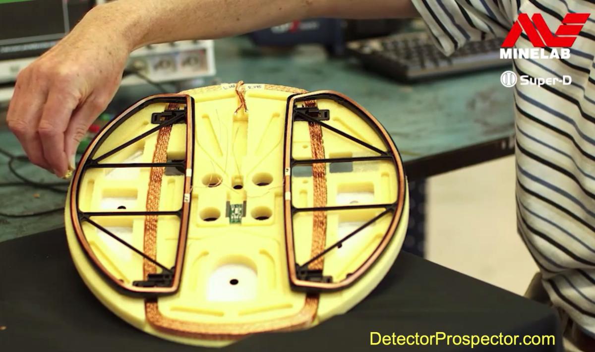

                            Does someone know how the windings of the receiving coils are wound and connected in the super-D system (in series or parallel)?
