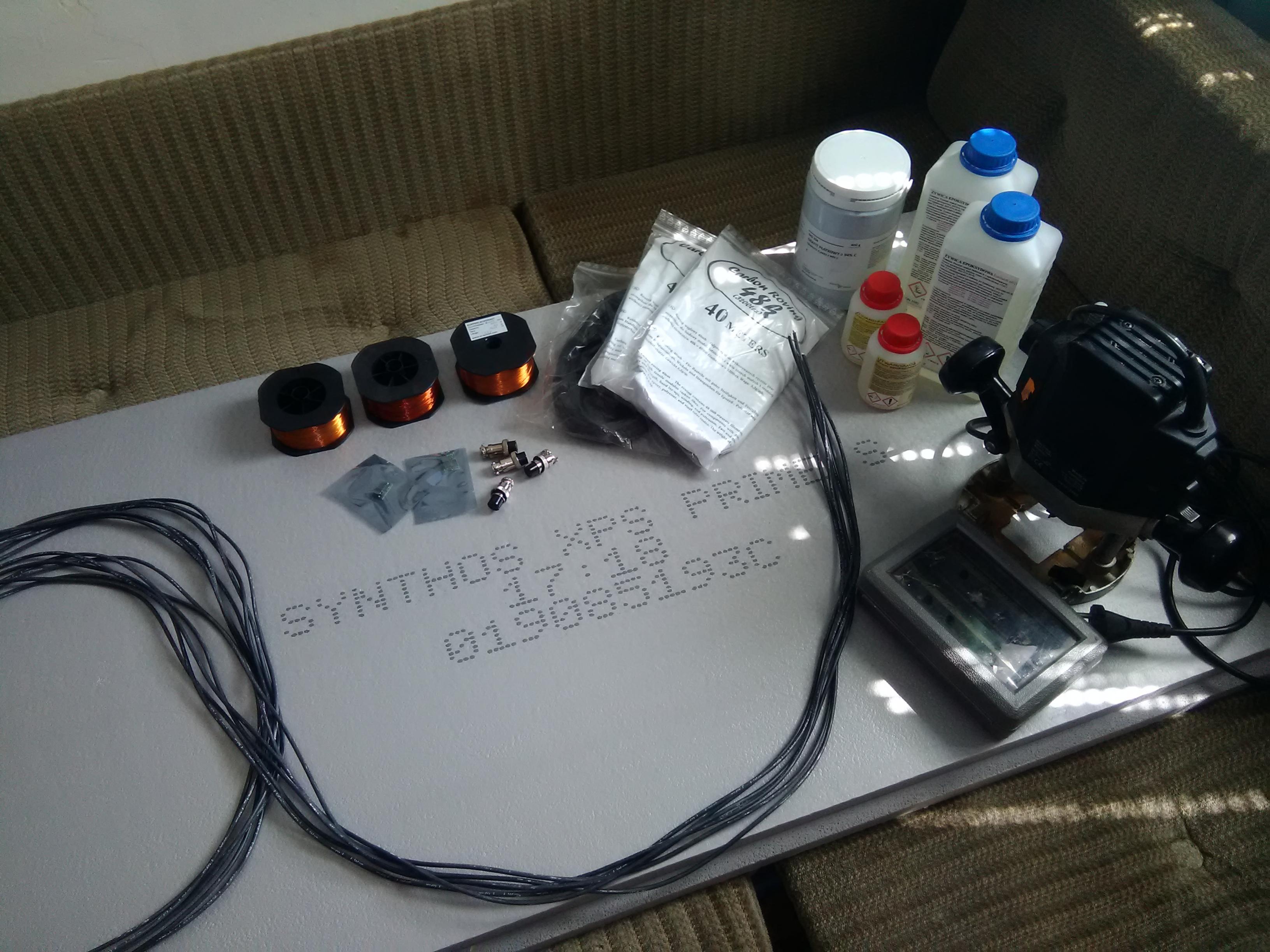

    I have already collected all the necessary materials: enamelled winding wire, extruded polystyrene foam, carbon fiber, graphite, epoxy resin with hardener, shielded cables, plugs, DC-DC converters and a router to cut grooves on the coil winding.Click image for larger version

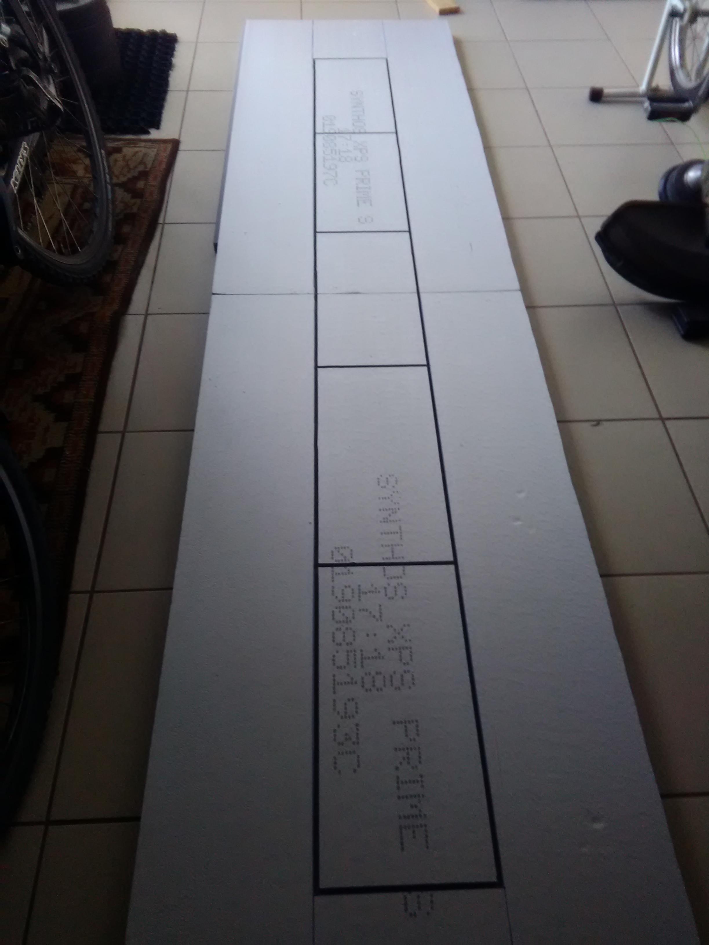

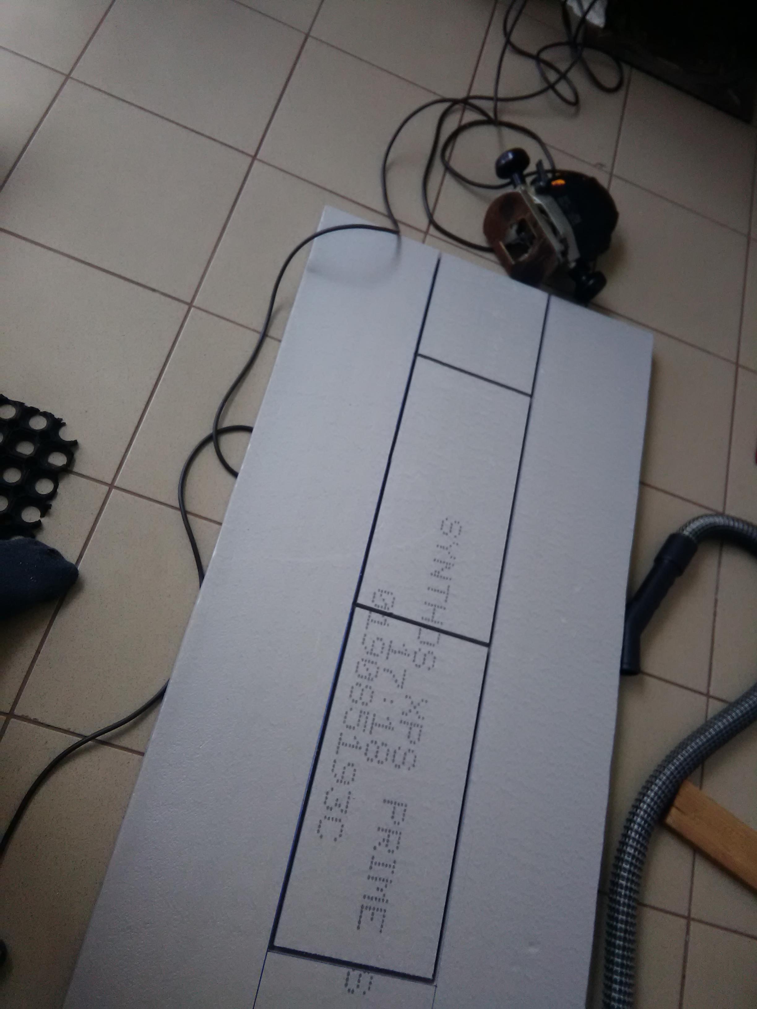

        Today I cut in the plate of the soil under the winding of 5 transmitting coils, which will flood the epoxy resin
        • #49
          first mistake. you do not have to flood coils the epoxy resin.
          • #50
            I know I do not have to, but it seems to me that the resin will give the coil additional stiffness, and the low weight of the coil is not so important. In addition, the resin mixed with the carbon fiber will become slightly conductive and will constitute an electrostatic screen [for the receiving coil only]. If you know a better solutions - hint, if it's not a secret.
            • #51
              wind round the winding by rope. take a wide one. take cheapest. paper or canvas done. may do several layers (of the rope). then
              only wind around sticky scotch lenta, also several layers. after that put at the place and fill the epoxy resin.
              you get the coils in air, not saturated by resin.
              • #52
                OK, thanks for the advice. Did I understand correctly that enameled wire should be wrapped with a wide rope or tape? Is it because the coil so made does not transfer vibrations, tension and other unwanted effects from the resin to the windings?
                • #53
                  Yes, it is for isolation from vibration at a certain frequency being transferred to coil. The rope acts like shock absorber.
                  • #54
                    I can't say for sure,but tiny movements across such a long axis is amplified, and could affect the coil.
                    • #55
                      not. not vibration. we say again about εr --- is the relative static permittivity (sometimes called the dielectric constant) of the material between the plates (for a vacuum, εr = 1);
                      look https://en.wikipedia.org/wiki/Capacitance

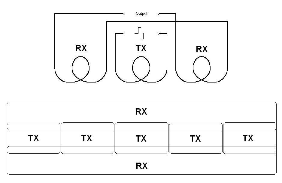

                          I plan to make two RX windings on both sides of the TX transmit coil connected with antiparallel. This will be a simple system for verifying false signals from the coil excitation. I will consider single signals to be false, and double signals to be correct. Is it good idea?
