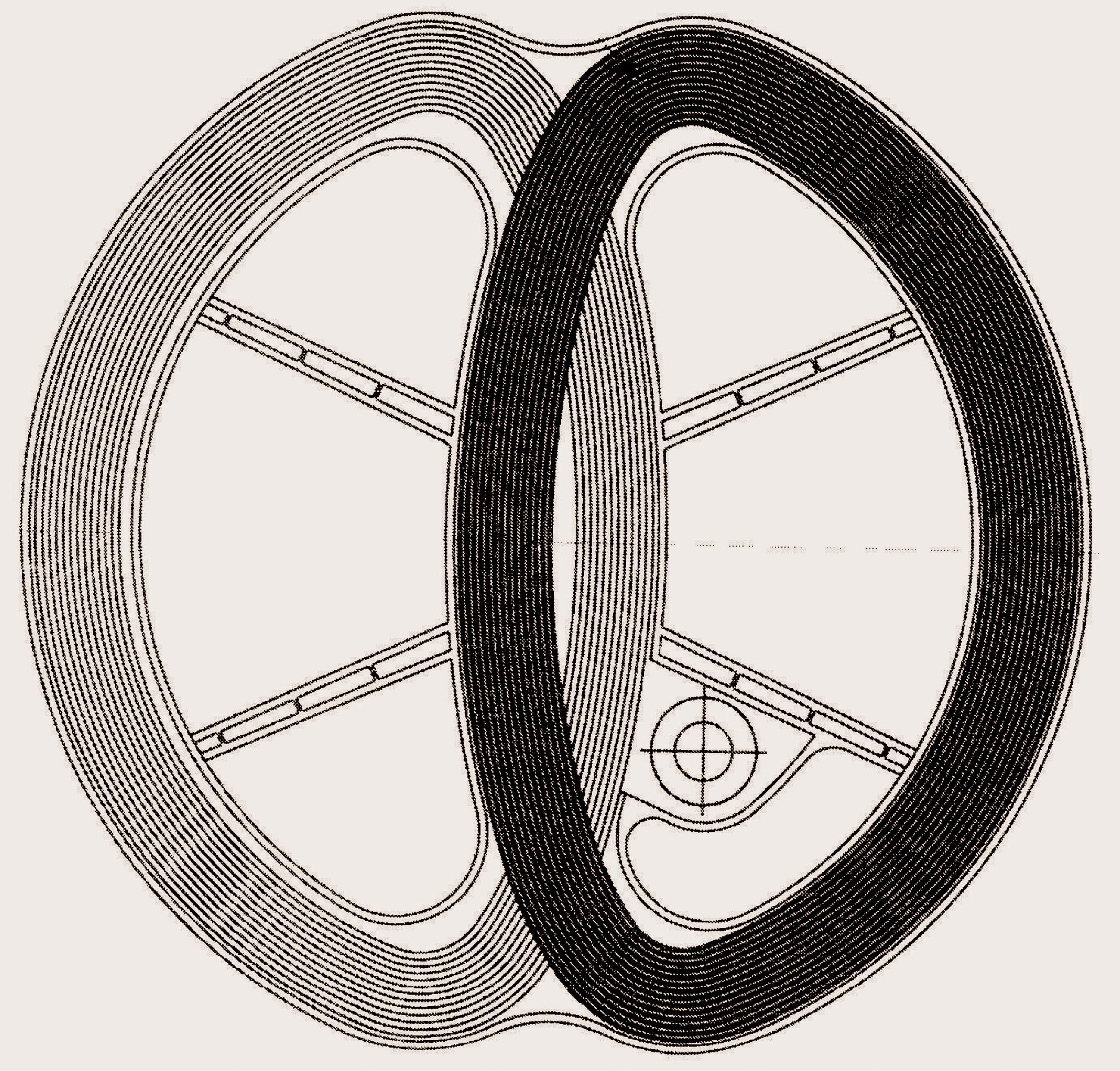

            Carl, can you give opinion on this type of flat spiral coil in DD configuration for pulse machine. With a rig like the one shown in video, it would be easy to make.
              No idea, I've never made a flat-spiral DD.
                  like this ?
                    Yes, exactly like that. You could make this coil no problem if you had device shown in video.
                    This would be a superb coil for pulse machine.
                      Seems that Detechs makes a 15 inch flat spiral Double D coil for the Minelab GPX,GP and SD series detectors. If I am not mistaken, these are PI detectors, so obviously the flat spiral is a superb type of coil for pulse machine.
                      The price of the 15 inch Detect is around 400 US dollars.
                      You could easily make such a coil for very little expense if you had the rig shown in the video.
                        One of the problems I foresee is how to accurately calculate the inductance of a qausi D shaped flat coil. You would need to experiment a bit.
