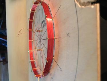

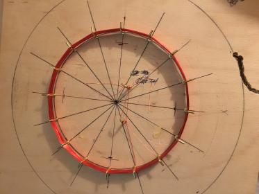

    Hi all, I think you guys are great and there is a vast amount of knowledge out here. I have a coil question for a BFO (ETI561). Yes I known old tech but I like playing around with them. But anyway my question is would it make any difference if I kept the coil of wire flat (vertical) instead of wrapping it into a round bundle. I could use plastic strips to glue the coil to to keep it flat until I set it into a mold of some kind. If I was to use carbon fiber strips (which super glue loves to adhere to) would the carbon fiber effect the operation of the coil? I tried to include pictures but I don’t think it came out right. I guess I need help how to include picture in my post also. Also have 2 question on shielding the coil, the instruction say to use aluminum strips to wrap most of the way around the coil I have some 1inch wide copper tape will that work as well, be better or worse? I think I read somewhere about a gap between the coil of wire and the shield if I was to wrap the coil in some plastic spiral loom wrap before I apply the shield would that be better, worse, or make no difference? Sorry for the long post and so many question still learning. Thanks to all. Rob.
    Your coil looks good, but keep in mind that the search oscillator should be around 110Khz. I'm not sure what your search loop inductance would end up being if you leave it flat as apposed to bundle coil, but it should be OK. However I would go with bundle coil as its what the project suggests. Not sure about the copper tape for this particular project. Good Idea to put electronics in metal box.
      The coil you show (solenoidal) is generally the most efficient way to create magnetic fields. In a BFO, it might add a couple percent to the sensitivity. The carbon fiber should be fine. A small gap between the coils wires & shielding helps, but the most critical is the gap between the beginning & end of the shield -- don't completely encircle the coil.

          You can calculate the B-field for 2 extremes, the solenoidal and the flat spiral, and find that the solenoidal is more efficient. In a flat spiral, flux created by outer windings cuts through the inner windings and reduces efficiency. Same effect for inner-on-outer. Scramble-wound coils are somewhere in between and due to their random nature don't lend themselves to calculated solutions. But they have slight efficiency degradations for the same reason. It's not a big difference, and scramble-winding is so super-easy that almost no one goes to the trouble of making a more perfect coil.
            I did some reading up on the solenoidal coil since you brought that up. The only thing is as you put it being scrambled because my winding is in no means wound nice and neat and all in perfect order and in a row with each other, wouldn't that still be scrambled up and not so much of a solenoidal coil. The only difference is I haven't pulled the wires up into a bundle yet.
              Since the wires are already randomly wound, just bundle the wires, make life easy for yourself, don't try to make coil too fancy. There will be no appreciable difference in performance.
              Stick to the no. of turns and all will be alright.
                I first try to make working circuit, with first coil. then I experiment with other coils.
                  According to some quick calculations, the bundled coil achieves a selected inductance with fewer turns than either the flat spiral or single-layer solenoid. For example, an 8" ~300uH bundled coil using 0.56mm thick wire requires 23 turns, the solenoid 28 turns, and the flat spiral 29 turns. Intuitively that's what you would expect.

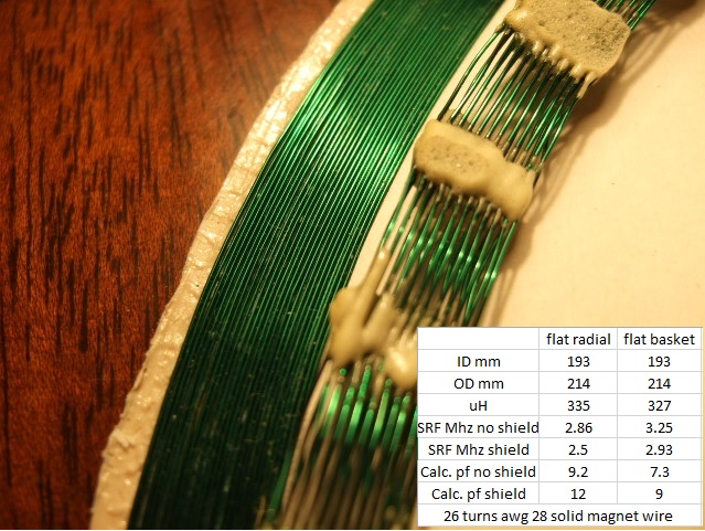

                      Couple tests I tried with different coils. Didn't see a big difference between the coils. Tried a bundle coil when I first started playing with coils, didn't seem as good as the spiral coils. Not sure why, maybe because of using AWG28 solid magnet wire. Interested in what you learn with your experiments.

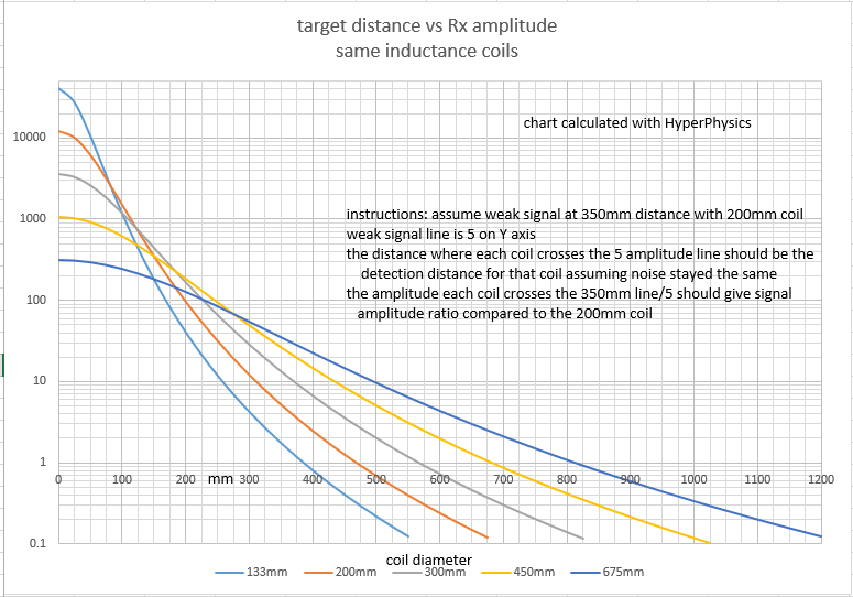

                          What coil sizes are you comparing? Is the coil inductance the same? What is the target distance you are comparing at? Including a chart calculated with HyperPhysics. Increasing coil diameter probably increases noise so detection distance difference probably not as much as charted. Think chart is correct, maybe someone that knows more about metal detectors could correct my thinking or add some thoughts.
                            Eric Foster posted a good rule of thumb for target types/sizes and coil sizes. It works like this. If you can detect a target at exactly the maximum distance equal to the coil radius, that is the maximum distance for that target and increasing the coil size will make the detecting distance less for only that same target. Increasing the coil size until the maximum detecting distance equals the coils radius is a way to optimize but only for that target. However, larger coils also are affected by more noise.
