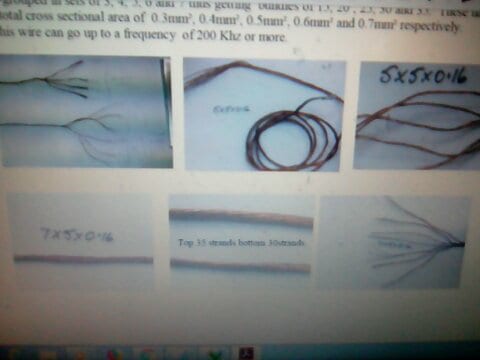

          To understand my intention
          no problem of detection with coil like 20 cm and 40 cm and also with 75 cm. but the problem is with coil 1m or more .a the size of 20 cm metal
          did not spend a lot of time trying to classify a bigger size of 70 cm but a few attempts
          It's the quality of the threads that I made.
          To reduce the coil capacity.
          And to get a fast response coil and little noise and more stable
          The focus was on big coils.

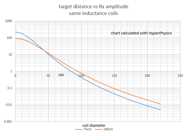

                  Thanks, just what I was looking for. For interest I'll chart the two coils with HyperPhysics. If you still have the two coils, could you measure inductance and resistance?
                    I have an ESR tester that gives the inductance .frequency resonance of the coil and the resistance .il m gave
                    coil A 2.7 ohm.375 uh
                    coil B 3.4 ohm.360 uh

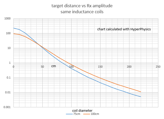

                        HyperPhysics predicts the 100cm coil would have the same signal strength at 200cm(you are getting 150cm detection distance) as the 75cm coil does at 175cm. 100cm coil has more resistance(probably less peak current), less inductance so its going to have a little less signal. Not enough to see the difference you are seeing. Maybe noise or something else is causing that much lose in distance?

                              I'm replying, not because I know the answer but like you I wonder why the larger coil detects at less distance. The 100mm coil predicts twice the signal of the 75mm coil at 2meters. Should give an increase in detection distance of 20cm+ if inductance and noise stayed the same. If noise doubles with the 100cm coil, detection distance shouldn't change. Monitoring integrator out with a scope should give an indication of change in noise level.
                              I've charted target distance vs receive amplitude(same as HyperPhysics chart) by monitoring integrator out with a digital voltmeter. What PI circuit are you using? Do you have a scope? 30cm coil is the largest I've made so I'm trying to learn something with this thread. Maybe someone else could suggest what might be causing lose of detection distance or what to try to find out.

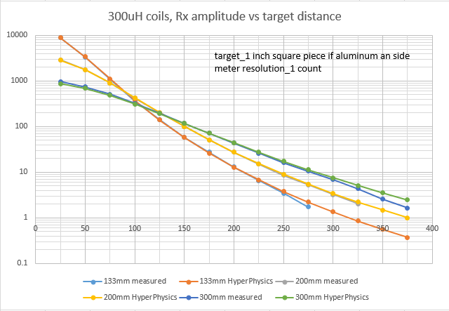

                                Hi sbalio
