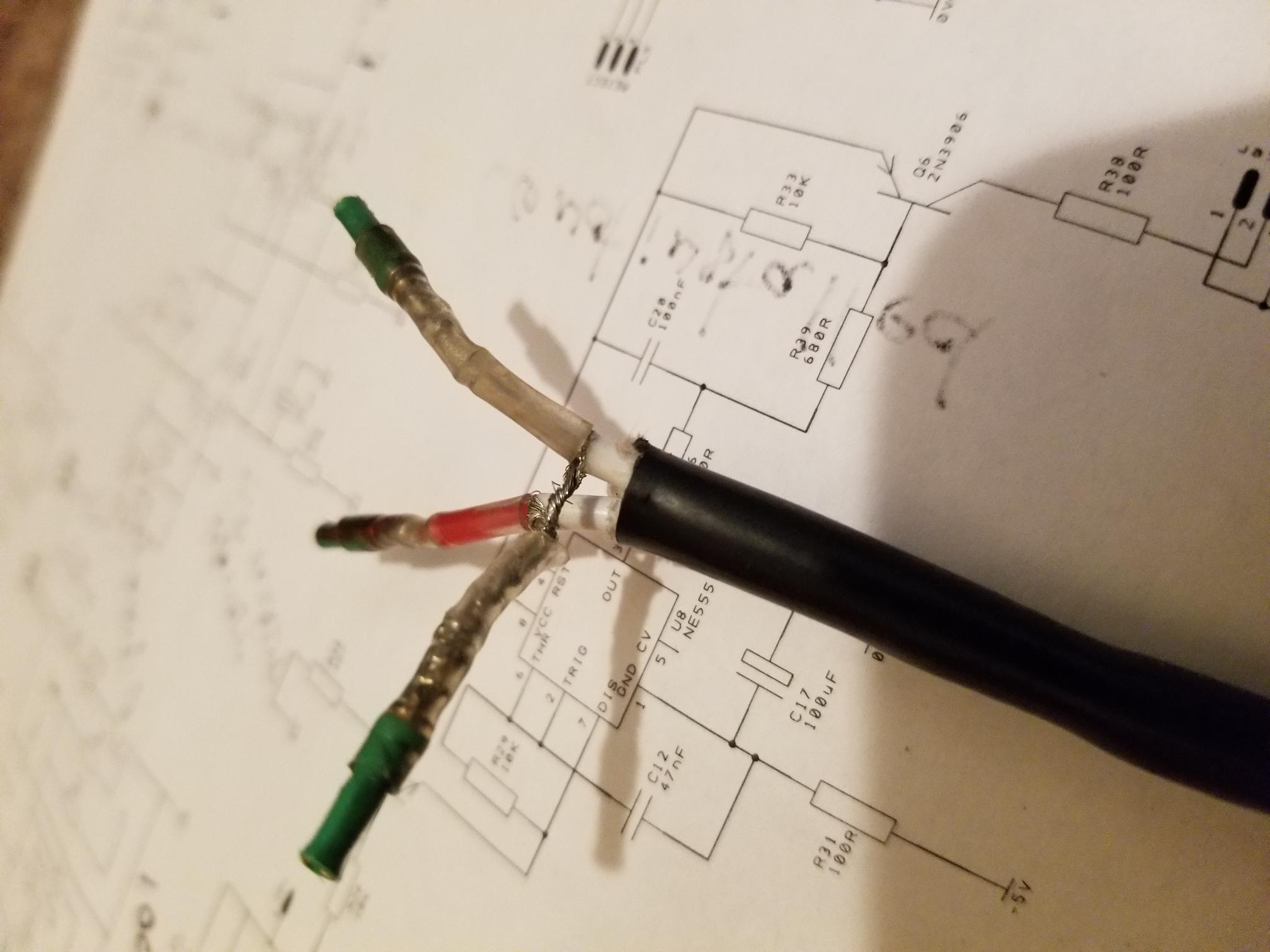

                        here is the TDI cable each wire has a seperate shield.

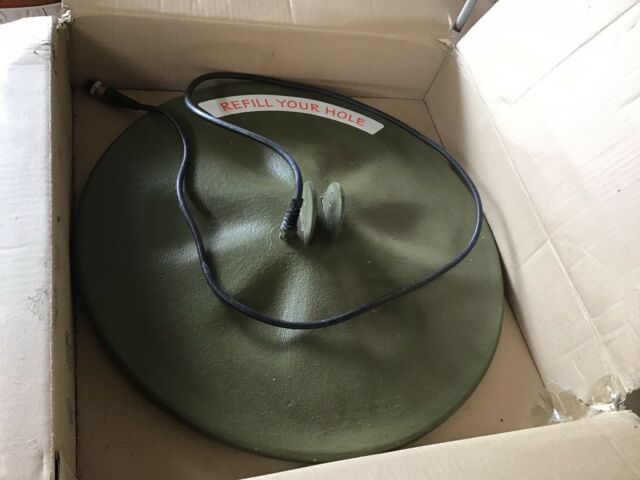

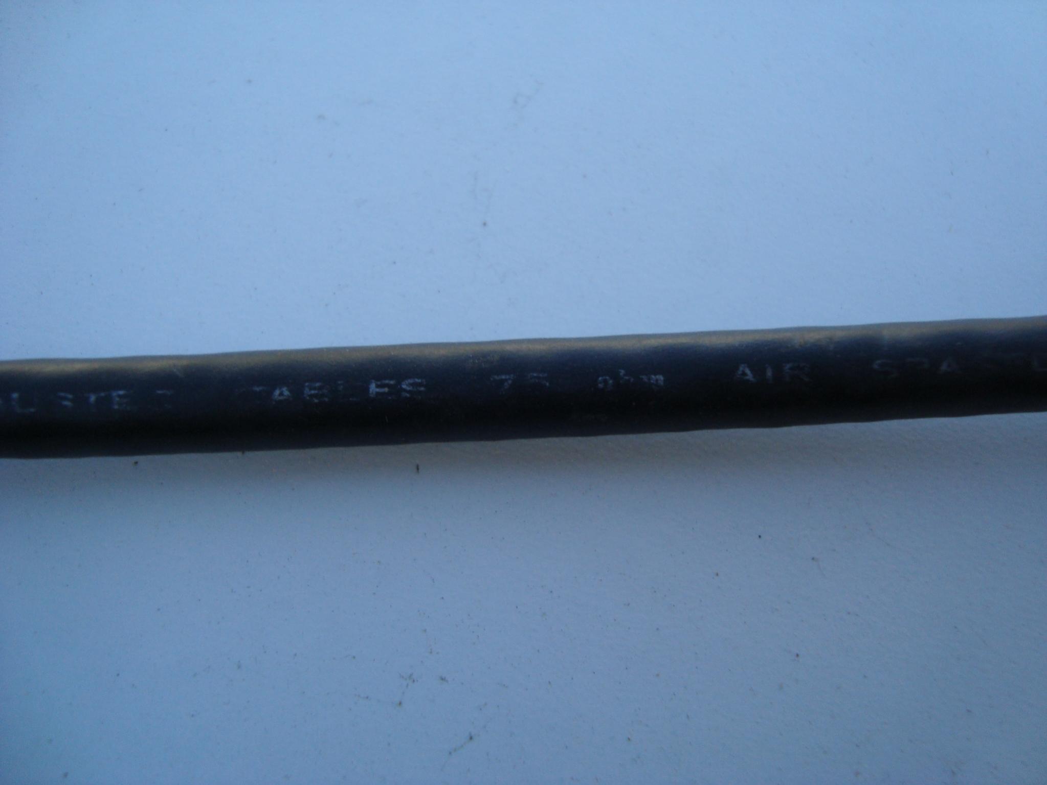

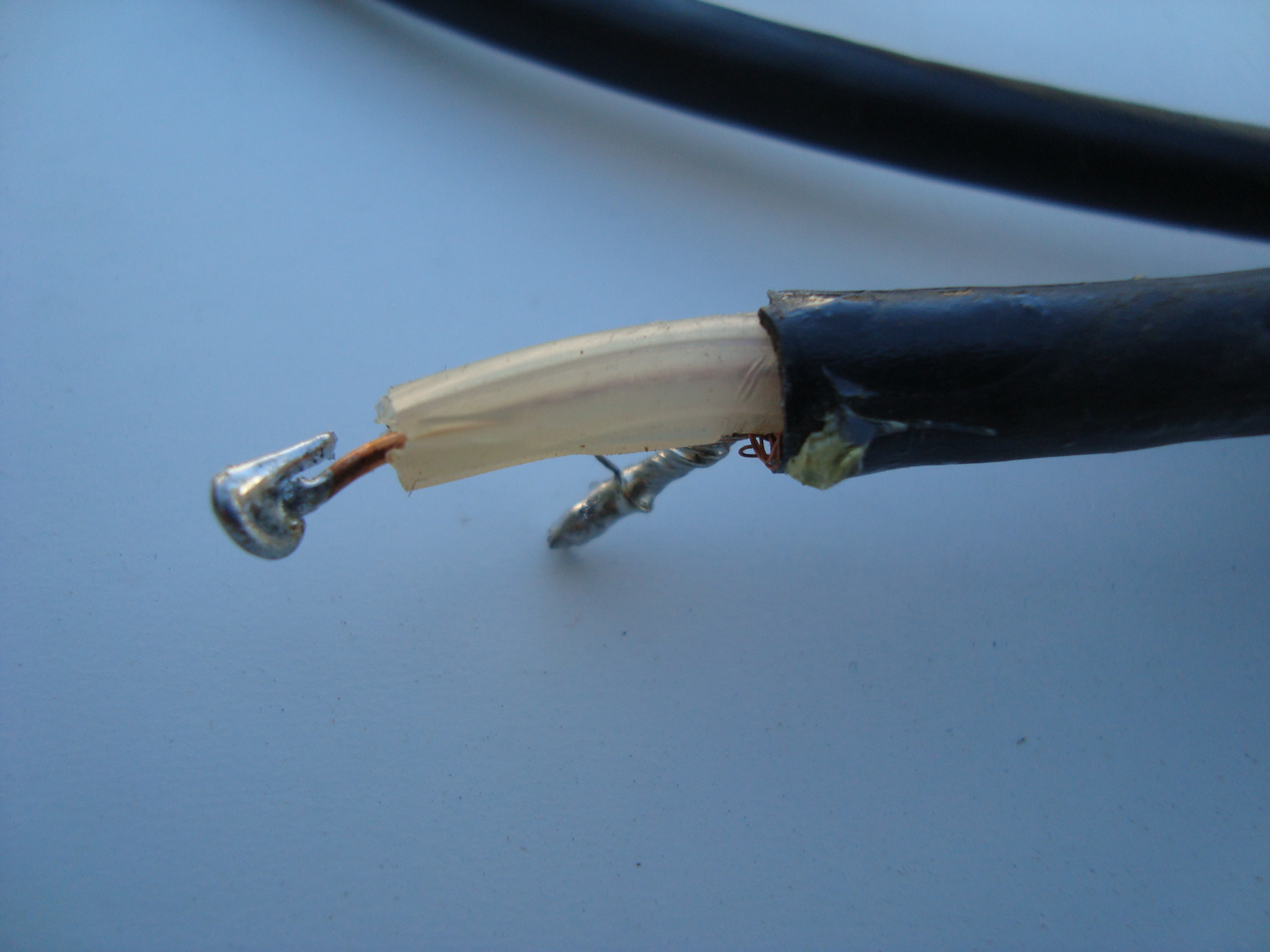

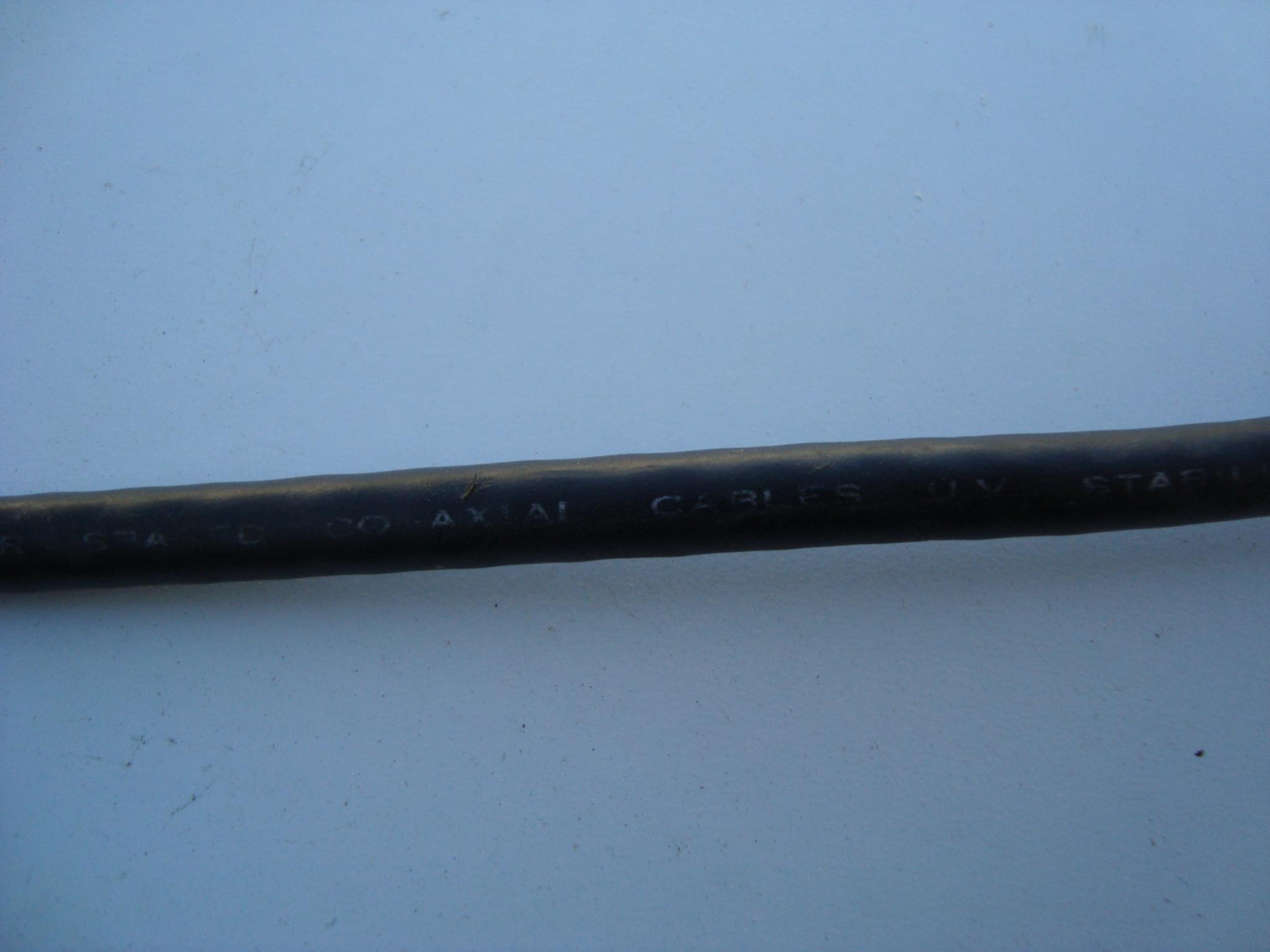

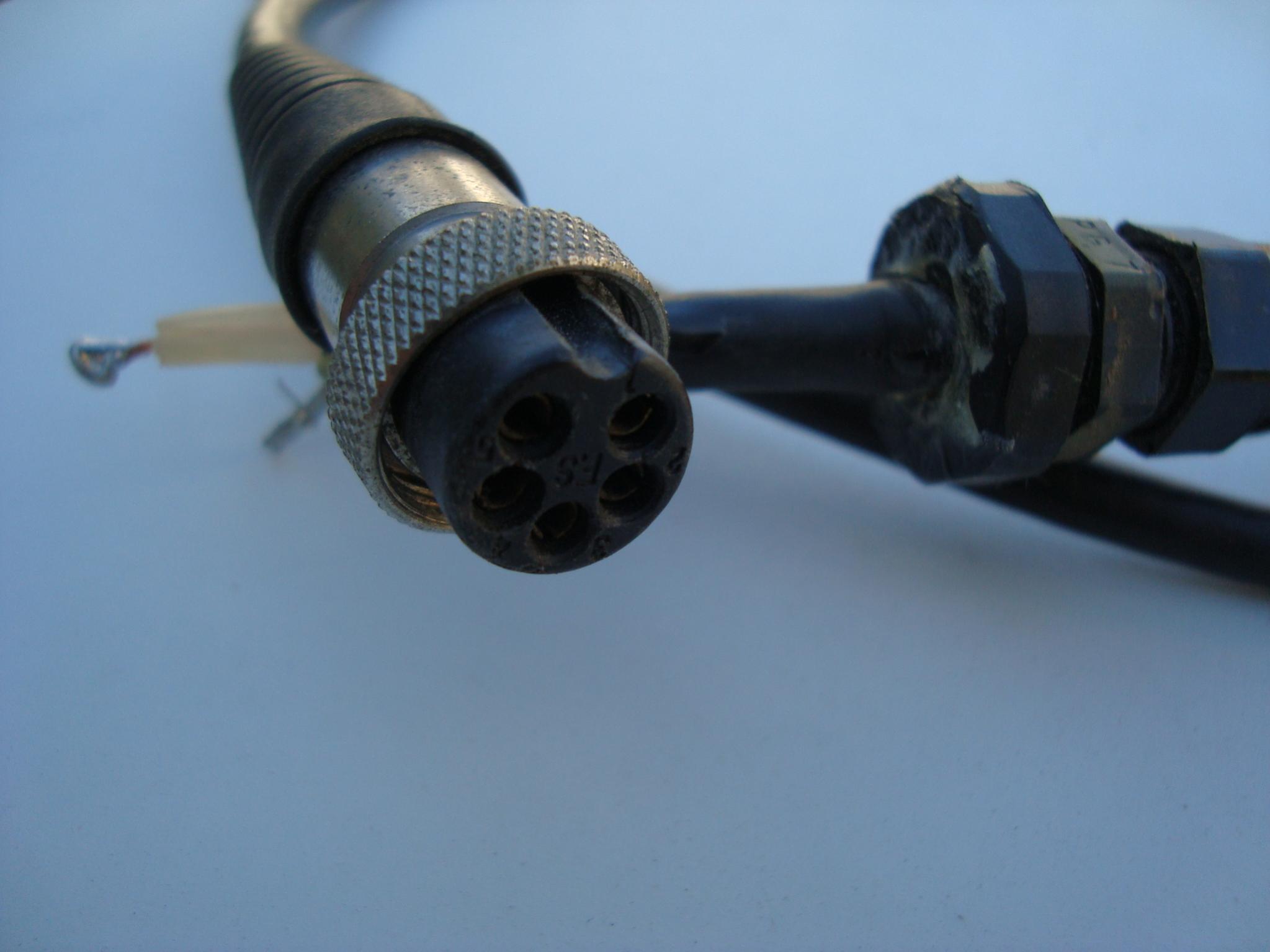

                              that may help. I got the info from an ML "Dust bin" 18"coil.
                              the coil was used with the SD2000 and it was one of the very early coils that they made.
                              it is labelled as fallows
                              AUSTEC cables 75 ohm Air spaced Co Axial UV Stabilised
