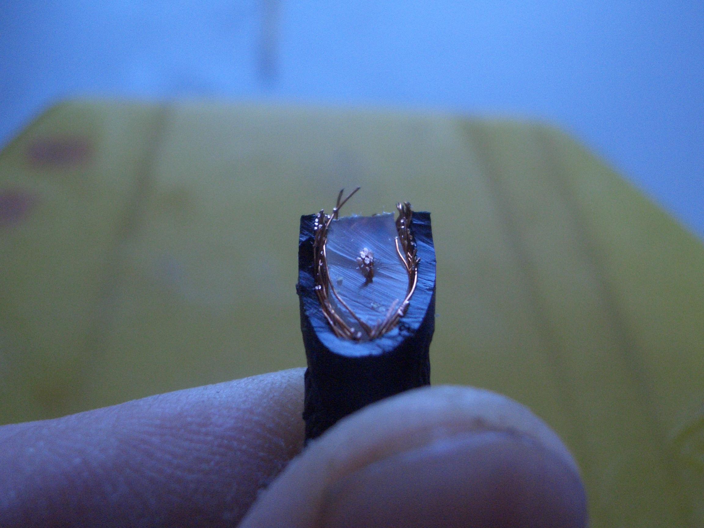

      that may help. I got the info from an ML "Dust bin" 18"coil.
      the coil was used with the SD2000 and it was one of the very early coils that they made.
      it is labelled as fallows
      AUSTEC cables 75 ohm Air spaced Co Axial UV Stabilised
      mine cables are multistrand.Click image for larger version

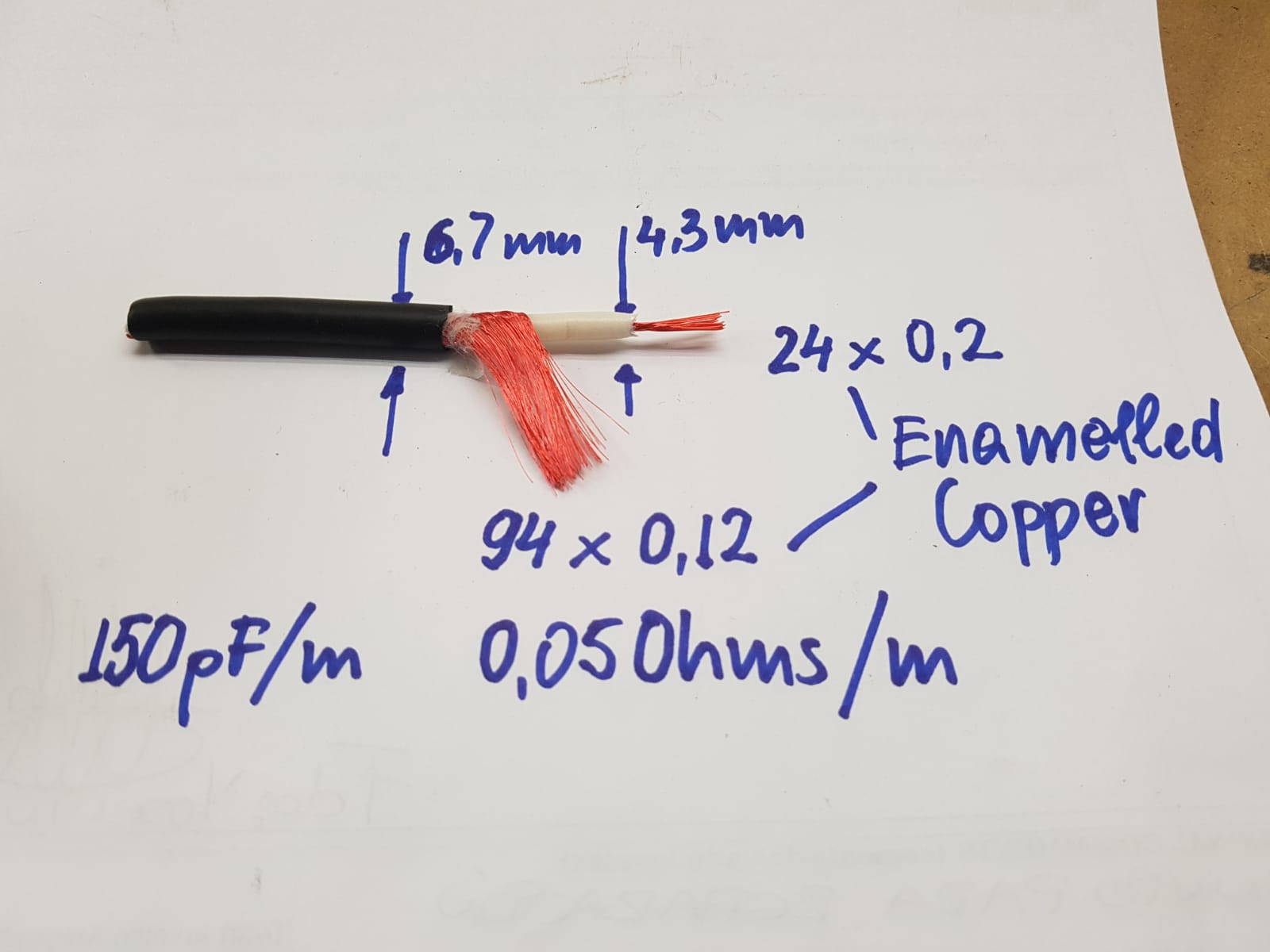

        Cable from Minelab mono coil. I would be curious to know if anyone knows where to buy something like this.
Name:	Minelab cabla.jpg

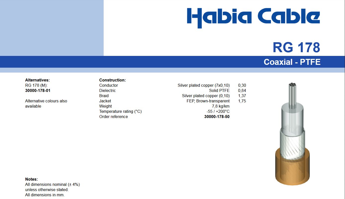

          https://www.distrelec.de/en/cable-wi...AV_PL_09110201
            I personally stay away from coax cables to the coil where the inside conductor only has 7 strands -like above- .
            For testing on the bench they are OK though. Breakage can occur much faster than with say 19 strands inside.
            Beware of the many coax types with copper plated steel inside like many have already mentioned. These break extra fast.
            Often the composition is not directly mentioned, so read the data sheet. If this is not even in the datasheet then it is most likely cheap crap.
              nickel gave pics with ONE strand cable. its ML. so mine is much better
              but i do not want disput with you, i have HARD cable i AGAIN write that. that does not the breakage.
              i wrote its SOVIET MADE, NOT CHINESE MADE, not FAKE.

                    Oh my KT ... Look at the data of the cable link you provided from distrelec, only 7x0.10mm ... that is skinny I'd say: Click image for larger version
                    The silver plated copper shield doesn't look good for fast coils either. Why did you actually post this link?
                      [ATTACH]45899[/ATTACH]
                      Once uploading image with a spelling mistake in the heading it was impossible to upload the correct file again. phu...
                      Wow! That certainly looks like a great cable. Each filament is enameled - and so many of them too.
                      The white insulation looks stiff, but is it so? What is your perceived stiffness of this cable?
                      I will be on the lookout for stuff like this and post if I find something in this range. Just hope it isn't bespoke manufactured just for ML.

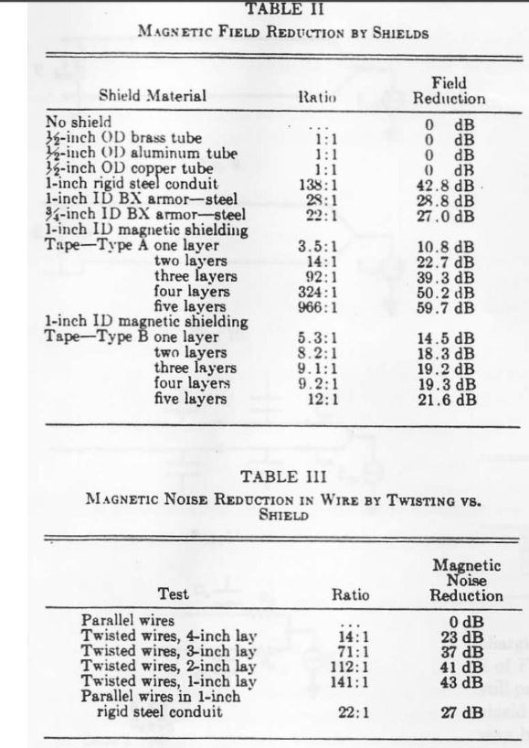

                                Thought this might be interesting, esp. table III.
