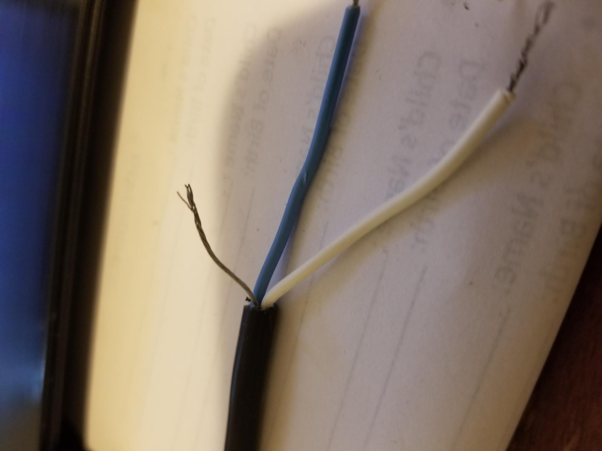

              Here is a cable I have and have not tried yet for a coil .
              Its a belden digital 1800a 110 ohm 24 guage 2 wire with a shield wire.

              Ok all thats normal but I started to look at the shield and thats where I was suprised.

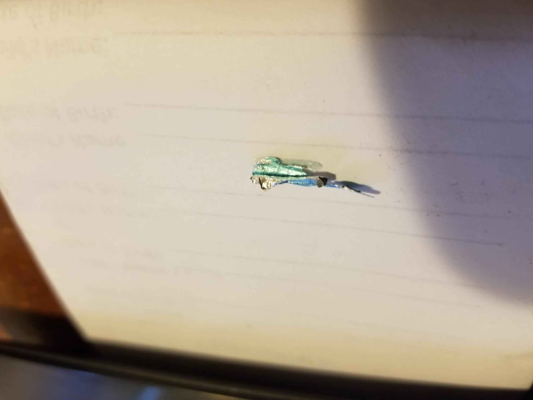

              It has two individual shields in the foil layer. Both sides are conductive to themselfs but not from side to side of the foil.
              Futher looking at it there is a layer of polyester or something between the foil layers.
              So the inner shield foil layer would be the only one connected to the ground lead .
              My question is is this extra layer of shielding not connected to anything of benefit or it it the extra conductive layer Eric mentions above ?
              Another expensive cable that may not perform?
              Good thing I got it at a estate sale a partial spool for the price of a foot.
              It does work great on my surround set up though.
