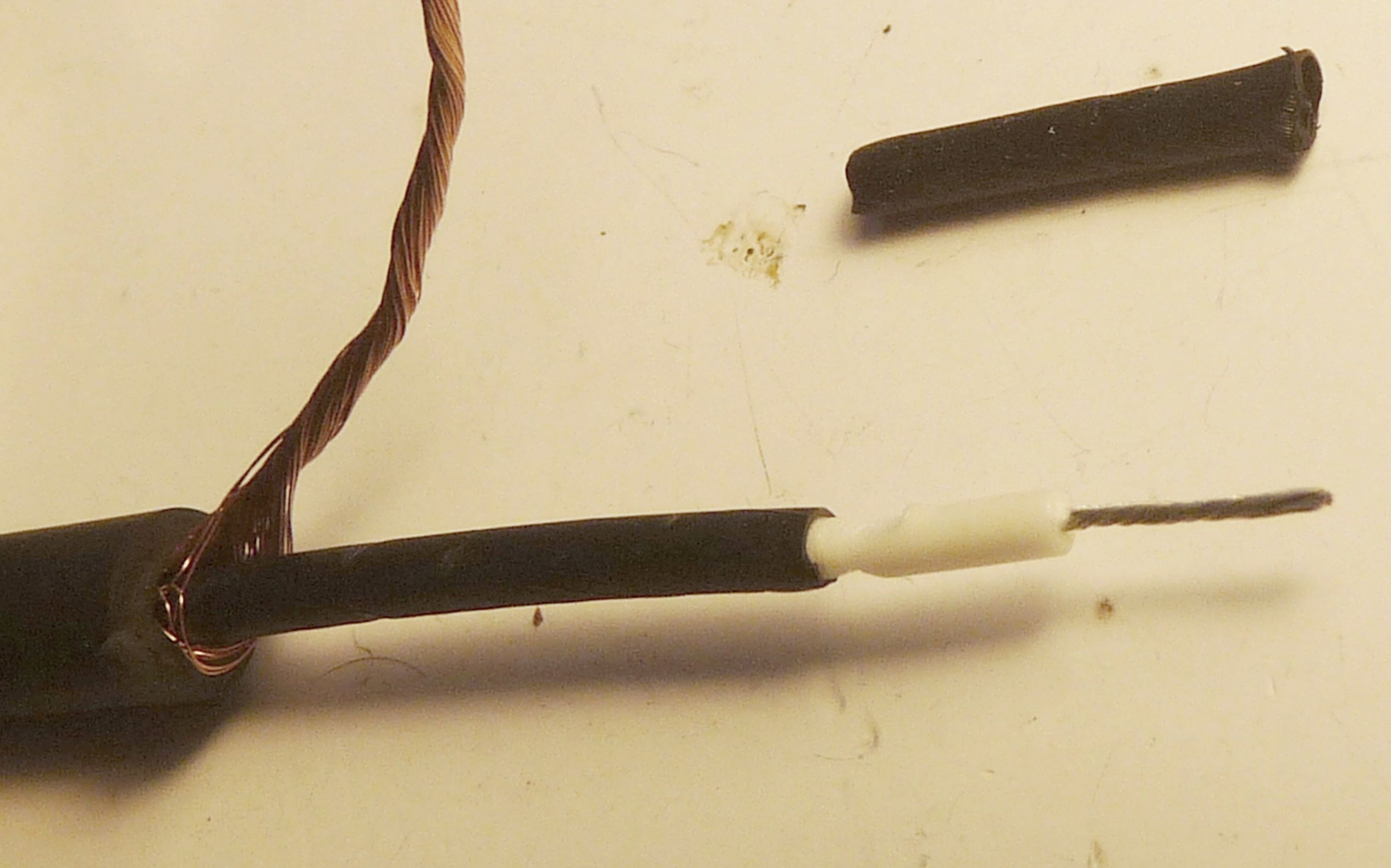

        Here a photo of the culprit, just to complete the picture ... Click image for larger version
        Can you post a picture(s) of what type of cables(s) you mean in the last paragraph, I can't quite follow what you mean.

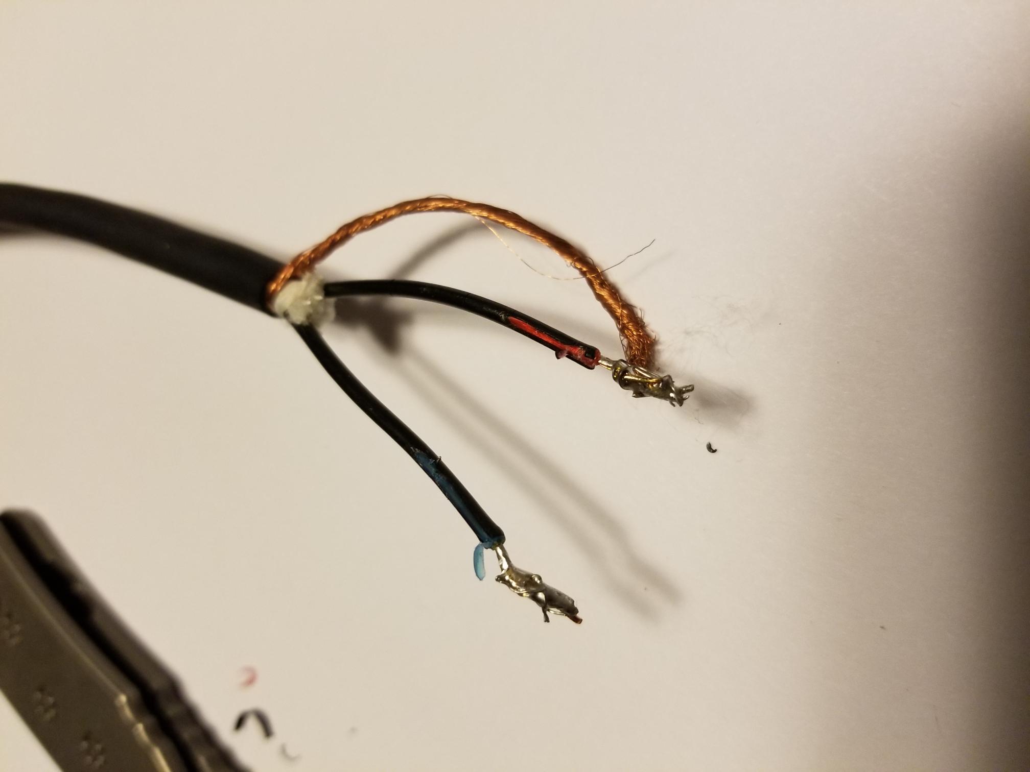

          Here is a picture of the cable I was using.

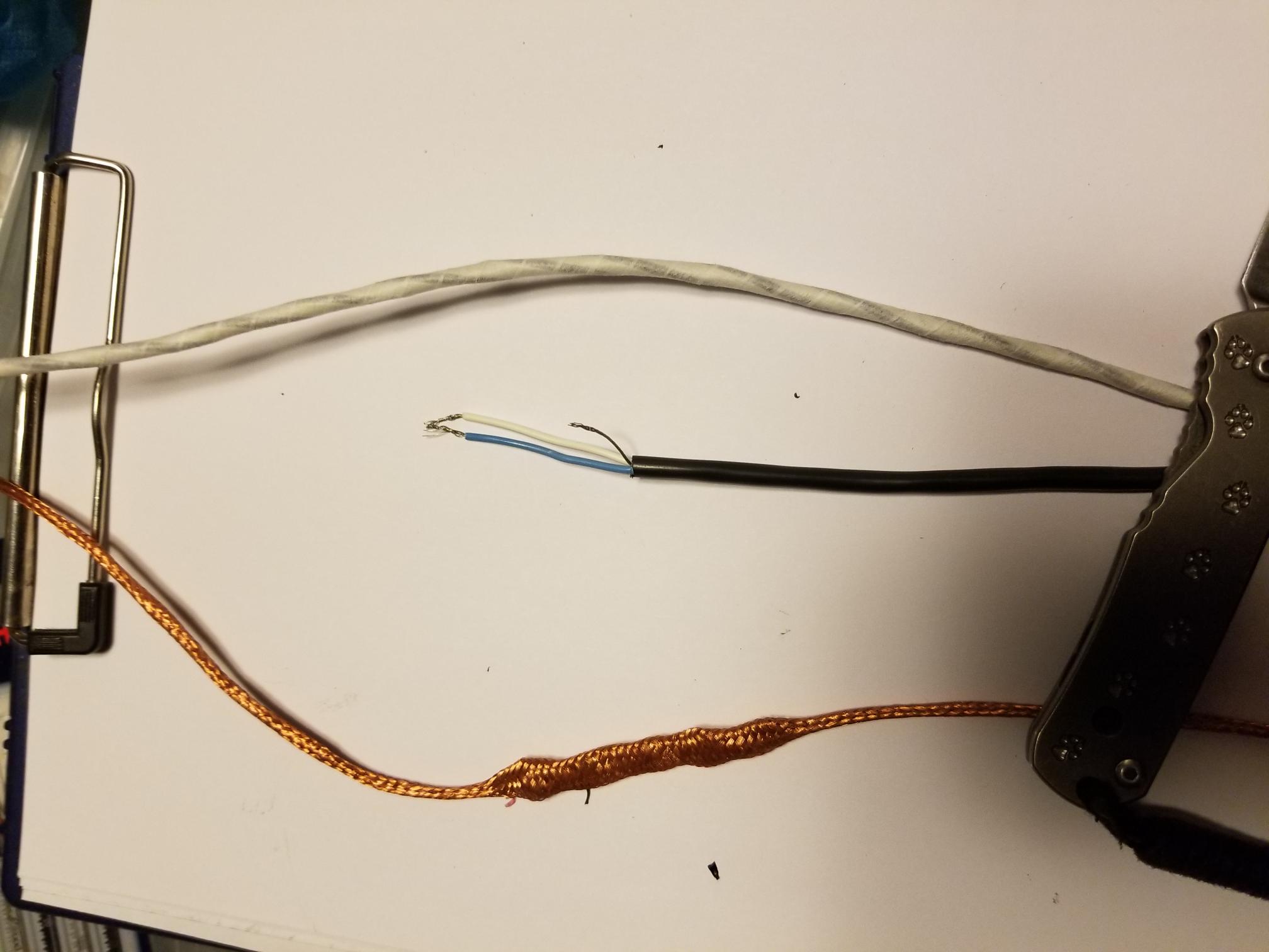

          In the other photo I have pulled the wires and shield out of the cable. I placed the belden 110 ohm cable in the middle.
          you can see the belden cable is pretty close to the same diameter. so what I was saying is you can pull the bad wires out with a fish line pre attached and that way you can pull whatever you want back into the shield. within reason of course. Good way to shield if you want to use solid coil lead wire to the pcb. One thing I did do is test this shield and even though it is pure copper it does not detect well on a PI. A eight inch peice is only detectable if I wad it up if I remember correctly it was a few years ago. and that was a stock surf pi.
          The beld shield I refer to is in this link or if you look around you will find a little info on it. They do have a 4 wire version of this cable where both sets are shielded form one another too. https://catalog.belden.com/index.cfm...=pd&p=PF_1800B

            godigit1, weren't you happy with the first cable you were using? Looks like it has a spiral shield, as opposed to a braided or foil one.
            If I got this right you are removing the foil parts of the belden cable? If not, have you tested the foil with the PI you'll be using?
            Not sure if a test with a stock surf PI you once did is valid as to the 1st delay time with a home brew one. Yours will likely have a shorter delay time.
            That can make a world of difference with foil stuff as I have seen myself - squealing PI when foil bits get anywhere near it.
            You were asking about overkill ... Hmmm ... what are you trying accomplish?

                          No just the opposite. The cable I was using has the conductive black layer on both wires.
                          What I was talking about doing is using the Copper schielded cable after removing the inner wires. This leaves the schield completly intact and a very nice cable left to work with.
                          Then I was talking about either pulling the belden cable through the copper schield, In essence combining both schielding techniques
                          The propritary Beld shield Plus a standard copper mesh shield.
                          The other possibilty if for schielding continious leads from the coil as Dan is talking about in post #51

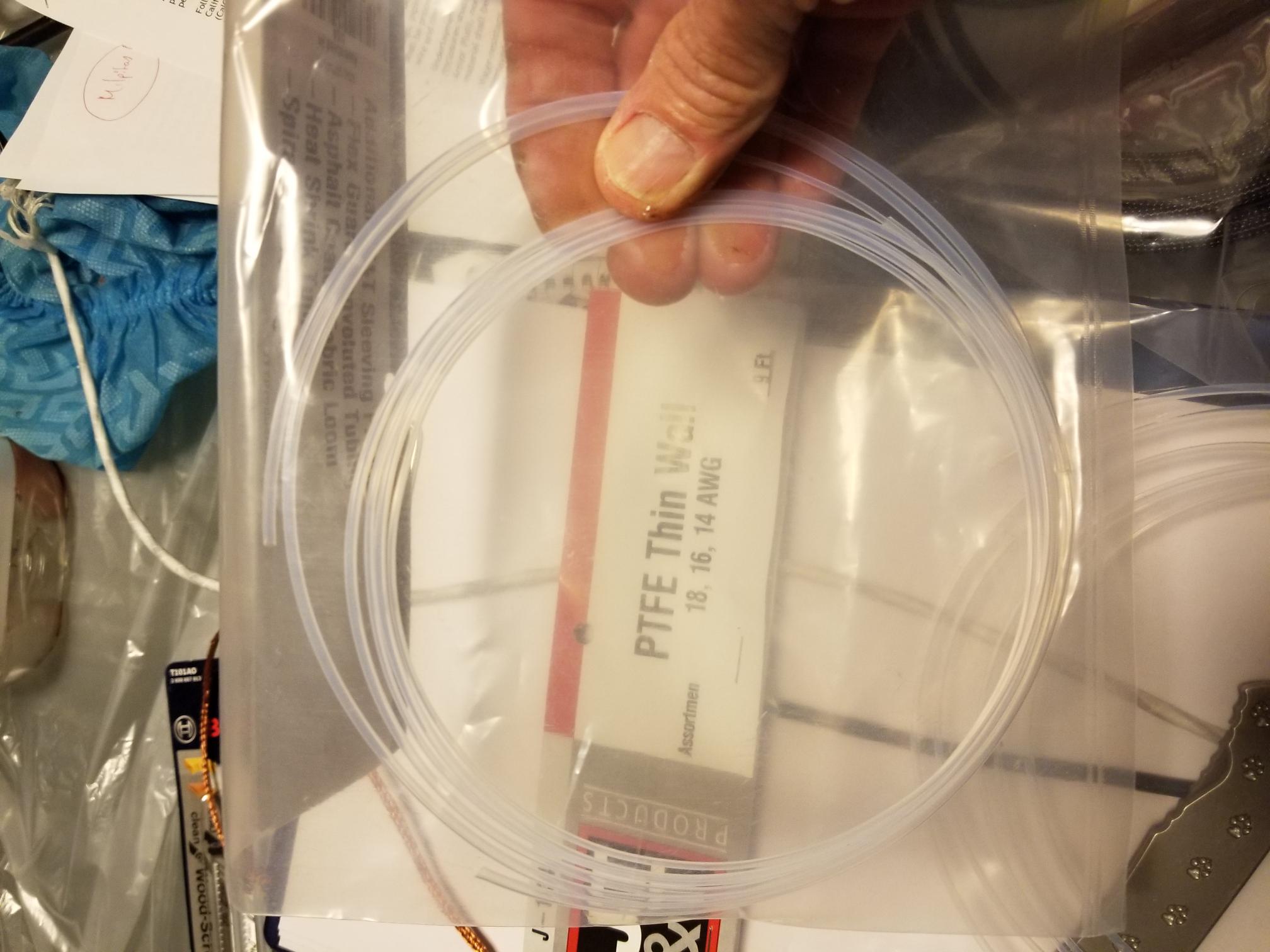

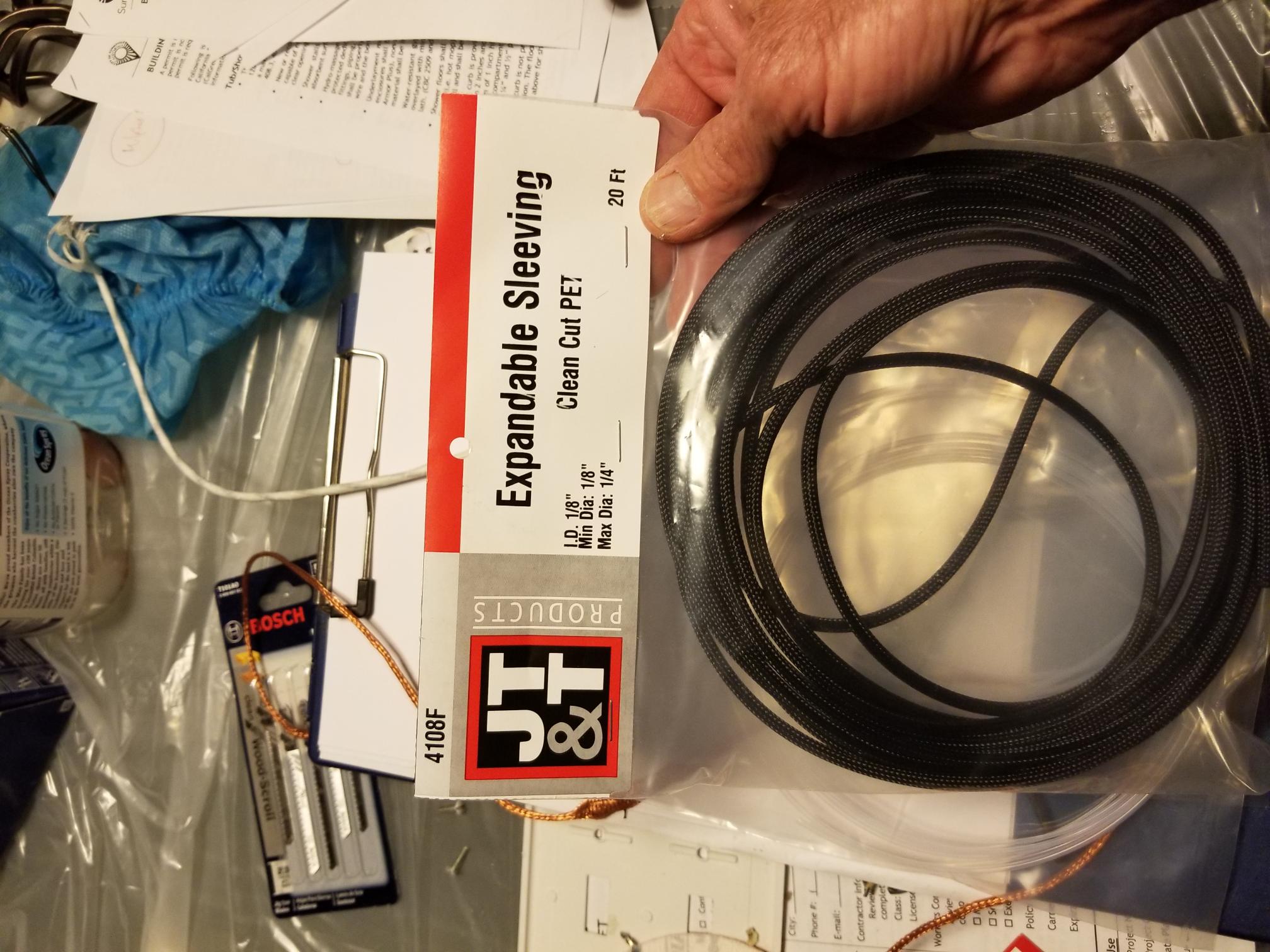

                          Using supplys Like this Ptfe tubing and expandable sleving one can make a very nice lead wire assymbly to pull back into the copper shielded cable.

                          As far as what I trying to accomplish? A good way to make a cable immune to noise without signal loss.
