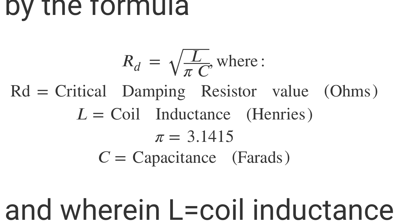

      Is it as easy as inductance divided by capacitance?
      how does the pi come into it and what does the big v with a tail mean?
      if someone could point me in the right direction to decipher this I?d be ever so grateful
      edit: so the v with a tail means radical notation I?ve just found out

          Don't know how to get capacitance without measuring SRF. Use Rd=pi*L*SRF.

            I have an lcr meter so measuring inductance and capacitance of the coil is no problem, I’m just trying to get my head around the formula from the patent.
            Been watching some vids on YouTube and I sort of understand what the radical notation symbol means, it’s a way to get the root, not sure how it’s used in the formula though but I’m chipping away

              The 'radical' symbol means that the Square Root is taken of the value obtained inside (under)
              Another way to write that equation is:
              Square Root of L/ (PI * C). Your calculator should have the radical symbol. Play with it and if you take the square root of 2 the answer is 1.414.
              PI (3.14) is required since this is a calculation of an AC (sine wave) signal.

                      ok so with your help I think I’m getting somewhere, inductance is .120 capacitance is .430, if I’ve got this right I times capacitance by pi and then inductance is divided by the previous result which gives me 0.0888 and some change. I’m not 100 percent sure how accurate the readings are so will go back and measure again once I’ve got the formula.

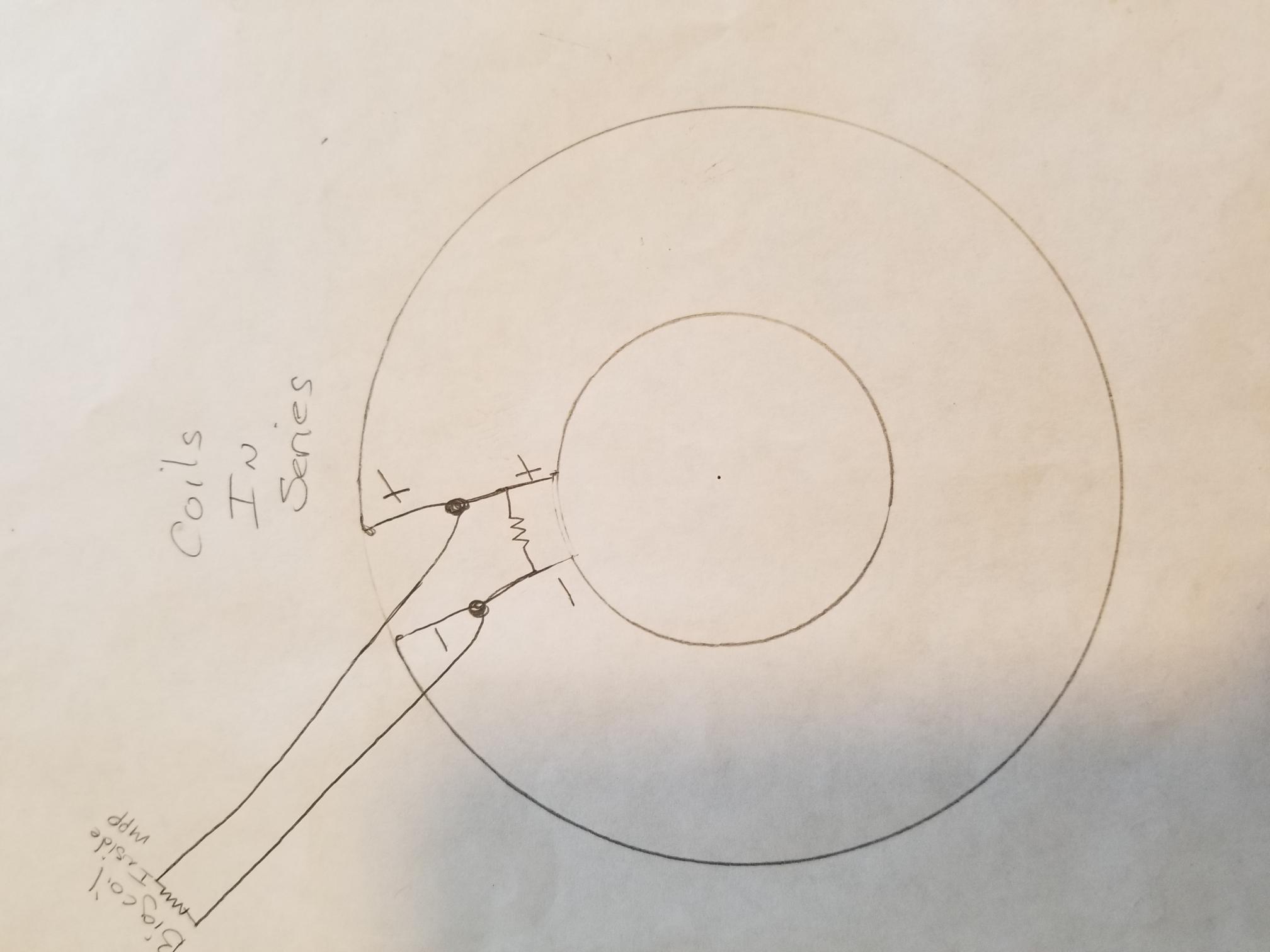

                        Anyway I think you are asking what the actual connection looks like?
                        Here is a crapy drawing but this is how I did the coils in series.
                        I think the damping procedure could probably be done both ways, I didnt do this but maybe could even use two adjustable damping resistor set ups and do both coils in secession either way.
                        Hope it helps
                          Those coils don't appear to be in series, it looks like they are connected in parallel.

                            Your right Im still not thinking straight, food poisioning dehydrated.
                            Thanks for correcting me.

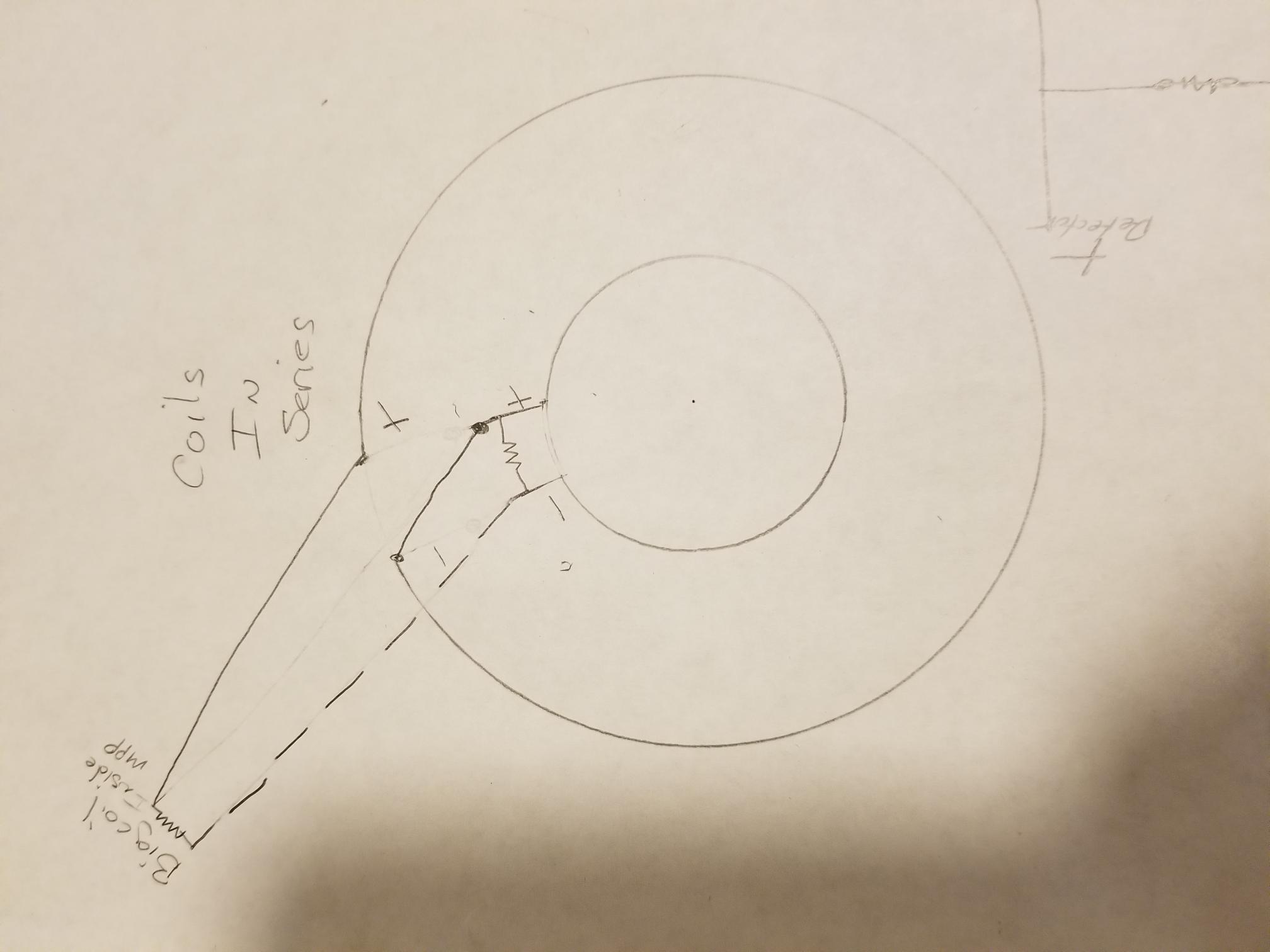

                            corrected Photo

                              That looks about right. There is one last step in the procedure above.
                              5 Once the search coils have been properly damped, remove and measure resistance of the damping tools and replace with fixed resistors of closest value.
                              Remember to adjust main damping resistor tool first, and then if necessary, the inner coil damping resistor tool last, in the above procedure.
                              It may seem counter intuitive, but I believe this is correct way.
                              Now some one may want to try this method and report back their findings. Seems simple enough, but you never know
