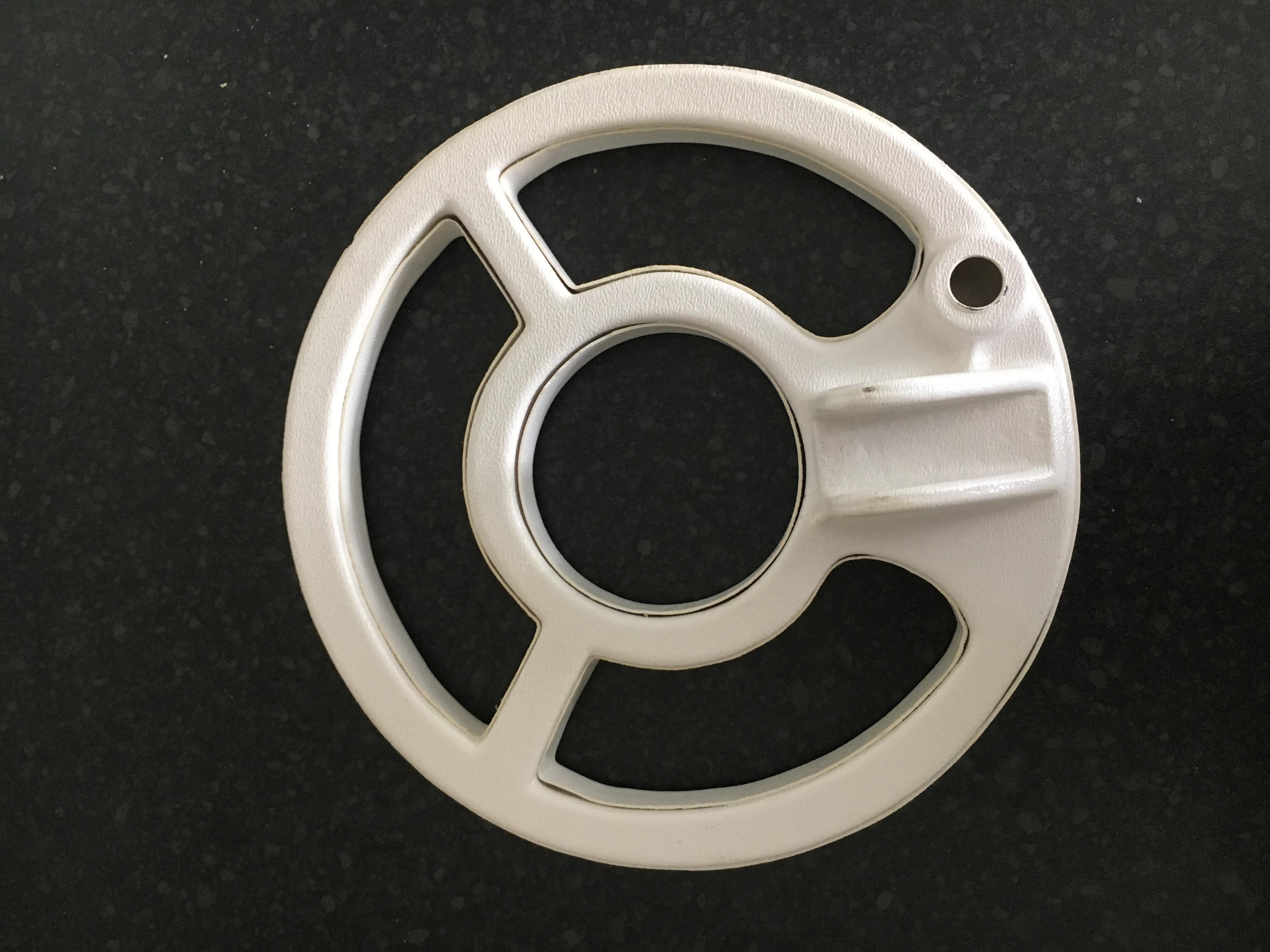

    Hi
    i have a dual coil housing id like to use for my mpp, please see the attached photo
    looking around it seems most people use a DD coil but I already have this housing so would like to use it if possible.
    There are a couple of things that I?m wondering-
    1. Is there a reason nobody seems to use a coil like this? Possibly not compatible with pi detector?
    2. Is the smaller coil tx and bigger coil rx?
    3. Could someone give me a rough base line to start with for the inductance and resistance of each coil please, from what I understand each coil has a different inductance reading?
    many thanks
    Hi Denots,
    Looks exactly like a dual field coil.
    Ive wound one dual field it was a experimental two 3dss coils.
    Actually easy to build and tune.
    I dont have a way to measure the values of the individual dual field coils I have but I just split the desired Inductance between the two coils.
    You can do the coil bundle the way you desire as long as it fits your shell and leaves room for shield spacing.
    Predamp the inner coil before assymbly( resistor in coil). then final damp when the second coil in attached.
    I heard different opinions of the dual field coil but I think its a very good beach coil. I like it on my Mpp.
    Just double checked the 12 inch dual field. Im gettin 3.1 ohms so im not sure the two coils are damped seperatly or co wound on the actual dual field.

            Denots, respondents are discussing 2 entirely different solutions. Let's start with your questions, assuming your intention was an IB coil.
            1. You can easily build a concentric IB coil for a PI detector. Most people use DD instead because concentric has a stronger ground response in nasty ground, and nasty ground is often where PIs are used.
            2. Large coil = TX, small = RX and bucking.
            3. You would typically wind the TX just like a mono coil, i.e. 300uH and 1-3 ohms or so. The RX has a little more leeway, but 1mH might be a practical max. Then you also have a bucking coil wound on top of it. There is lots of info on these forums for how to do this.
            The other solution is a non-IB "dual field coil," where you wind large and small mono coils and wire them in series. The trick is that the inner coil needs its own damping resistor, and the overall connection also needs a damping resistor. This may require trial & error.
            If you want "easy" I would suggest the dual field coil.
              The Whites dual field patent has all the math information required to make calculations for the damping resistors for a dual field coil. It also shows how the coils are connected in series and the relative dimensions of the two coils, namely, the inner coil and the outer coil.
              The outer coil measures about 12 inches, but the inner coil is just a little short of half the diameter of the outer coil. If I were to build one of these search coils, I would use a ratio of 2:1.
              Now if somebody could provide the inductances of the outer and inner coil, along with type and size of wire, well.......

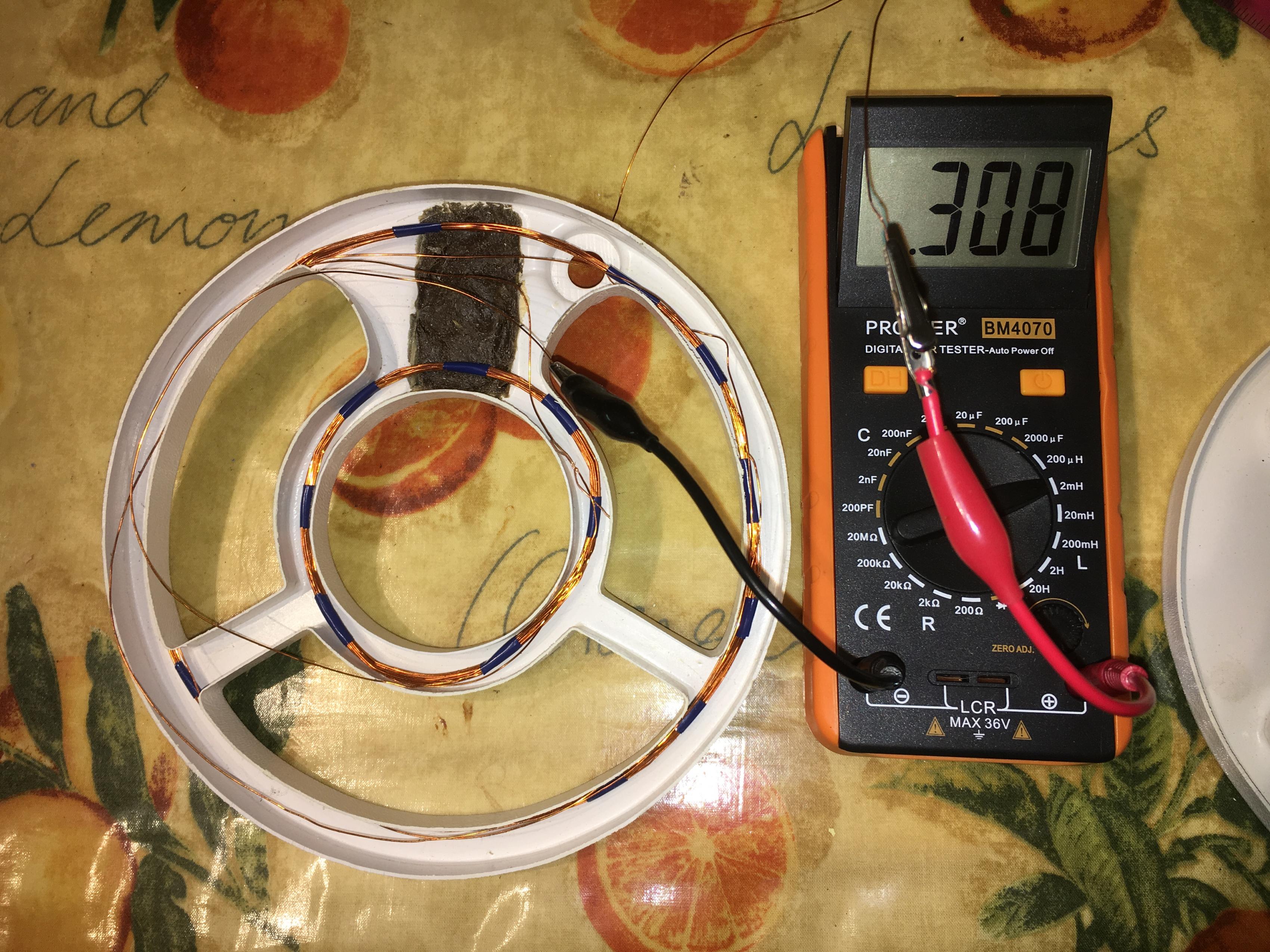

                    I don't know the particulars of the White's coil, but I would start out splitting the inductance. If you do 150uH/150uH then the total will be higher than 300uH due to mutual coupling, so maybe start with 100u/100u.
                    You can always skew the coils to optimize for bigger/deeper or smaller/shallower.
                      Made a start
                      Big coil 136uh, there are some extra windings that I have left loose from the rest of the coil and should be able to drop it to 120 if needed.
                      Small coil 120uh
                      Together in series 308uh

                      thats it for tonight I?m going to bed, I?ll carry on with this tomorrow if there?s time

                          well, for a 150uH inner coil, with an estimated capacitance of 150pF, the calculated value of the damping resistor is 488 ohms, so I guess 470 ohms would get the ball rolling as far as damping the inner coil is concerned. I suppose the other damping resistor(the one which is across the overall connection) would be set using the conventional method oscilloscope and damping tool setup.
                          Just how would one determine if the inner coil was ringing is beyond me at the moment.
                          Carl, you got to know the answer to this.
                            Setup and proper damping of a dual field coil can be tricky.
                            I propose the following method:
                            First, calculate the critical damping resistor(the resistor which goes across entire connection referred to as resistor #1 from the diagram in the patent. This value is calculated using the total inductance and stray capacitance of both coils.(use the formula in the patent)
                            with this resistor in place, check waveform on oscilloscope, there you will observe ringing due to effects of undamped inner coil.
                            Now place a damping resistor across the inner coil and adjust its value until the ringing observed on oscilloscope goes away. This will be the value of the inner coil damping resistor. The coil is now set.

                              What a noob, I just remembered there’s a damping resistor inside the metal detector box, I then went and attached a damping resistor to the new coil I was testing, 2 x damping resistors is what caused the monumental slow pickup speed lol.
                              Electronics for dummies book turned up today so will be reading through that tonight, I need to clear some things up in my head before I progress, back to the basics
