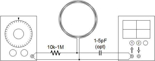

                    A example using this method
                    Coil 25 wraps 3.25 I.d 30 awg wire I measure 135 uh with inductance meter.
                    Using the method above I get 3.264Khz with a 1 pf cap and 3.355 with a 5pf cap. ive also verified this in other test methods.
                    Then using dip meter a diferential probe method the method Green uses on the same coil I can get 6.9 Mhz.
                    At 6.9 Mhz I get 3.8pf 2586 ohm damp value.
                    at 3.333 I get 16.89 pf and a damp value of 1413 ohms.
                    Actual damping on a Mpp with a damping resistor set up in this shot is 447 ohms.
                    https://www.geotech1.com/forums/atta...9&d=1570936662
                    If I count the input resistor 1k the 3.333 works with the MPP.
                    Im not trying to argue just getting different damping results Ive been totaly ale to get the same srf as Green using multiple test methods.
                    Maybe Im not taking into account full rx impediance? Should I be?
                    Thanks for any input.

                        If I do capacitance calcs for you coil at 6.7 Mhz and 115 uh using this calculator
                        http://www.1728.org/resfreq.htm
                        I get a capacitance of .28 pf are we using the same calculations what do you get for capacitance ? I think you allready posted it but im not finding it.
                        Seems somewhere we are not on the same page trying to figure out what Im missing? Im about to throw in the towel you win dbanner.

                            6.7mHz, 115uH calculated capacitance 4.9pF using this calculator:https://goodcalculators.com/resonant...cy-calculator/
                            • I'm running some numbers using the 6.7mHz and 115uH, 4.9pF. I can't get Green's result for the calculated Rd.
                              I'm using the formula which Carl posted.
                              4.9pF seem kinda low, come to think of it. But that's what the 6.7mHz SRF and 115uH works out to.
                              • But using 4mHz circuit resonance and 115uH, I get 13pF. Then calculated Rd I get 1487 ohms, which is in keeping with green's results.
                                So then, what is the point of the SRF 6.7mHz value??
                                (I am referring to the data Green has posted above)
