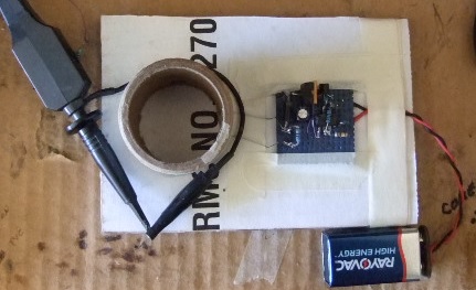

    • Tester stopped working a couple times. Added a 10nf capacitor to pin 5 of 555. Don't think it should need it but it hasn't stopped working since I added the capacitor.
      Including a picture of tester. The small diameter solenoid coil has the advantage of placing the loop over the coil and placing the test coil on the solenoid coil when testing.
      • Green, I wish you had a dip meter to measure that solenoid. If it agreed with the 6.71mHz from your test circuit, that would be neat! I think that would have been game over.

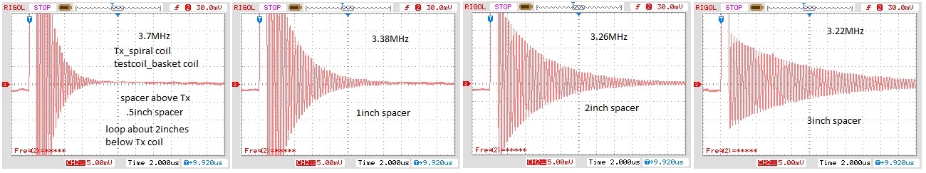

          • Was wondering again what effect coupling between PI Tx coil and test coil have when measuring SRF. Haven't seen a lot with my testing but then the coils have been deferent sizes. Tried with two coils the same size. Measured basket coil SRF this morning, got 3.25MHz same as measured before. The closer the coils(more coupling)lower Q. Think I see why the Q is lower, don't know why SRF increase. Any thoughts why SRF increases with higher coupling? Any thoughts if the test should have been done different?
            Tx coil was critical damped. Test coil open.
              It's clearly due to the amount of coupling. The larger the magnetic coupling, the greater the resonant frequencies will vary from that of an uncoupled resonator.
              This implies that the decaying oscillations of the Tx coil are having small effect on the test coil and vice versa.
                No argument but why does the SRF increase instead of decrease?
                  The SRF only "appears" to be increasing, in fact, it is only just moving "closer together", as the two coils attempt to reach mutual resonance.
                  I have no idea what I just said.
                  • I suspect if you were to try a different test coil with a higher SRF than the Tx coil, you would observe the opposite effect, the SRF would decrease with more coupling. Try it!!

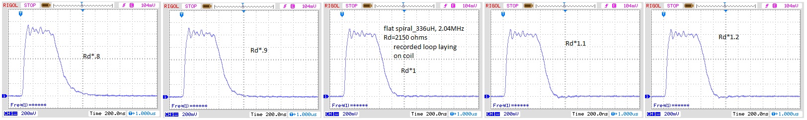

                      Not sure about your second question. SRF tester is packed to ship. Calculated Rd(Rd=pi*L*SRF)for the tester, needed a lower Rd than calculated to critical damp.
                      Tried with my TRT tester and the flat spiral coil reply #140. Calculated Rd looks correct. May have to unpack SRF tester and try again tomorrow. I remember it being more critical to adjustment. If you want something tested before I ship it ask.
                      2.04MHz was circuit resonance with Rd disconnected, coil connected to Tx circuit.

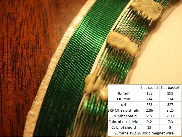

                        Tx_bundle wound, same diameter as test coil, 700kHz circuit resonance. Test coil flat basket wound, 3.25MHz SRF. SRF increases with increased coupling. Didn't have a same diameter test coil with a higher SRF so used a Tx coil with a lower Tx circuit resonance.
                        pickup loop about 2inches below Tx coil, spacer above Tx coil.
                        .5inch spacer_3.6MHz
                        1inch spacer_3.4MHz
                        2inch spacer_3.3MHz
                        3inch spacer_3.25MHz
                          1inch spacer_3.4MHz
                          2inch spacer_3.3MHz

                          Just so that I'm sure of your setup, the order as I understand it is as follows: pickup loop then Tx coil then spacer then test loop. Is that correct?
                          And just why is the pickup loop below the Tx coil? I thought you were scoping the test loop? What am I missing?
                            Well that shoots my guesswork right off the duck line.
                            Thanks.
                            Yes
                            I have been placing the pickup loop on the test coil. I tried the pickup loop below the Tx coil on the SRF tester I'm sending to godigt, worked fine. So I tried it for the coupling test reply #140, Didn't need to move the pickup coil when changing the spacer between the Tx and test coil. Just experimenting, don't know what is the best way. I suggested in another reply that highest SRF would be closest to being correct, probably not correct. Inductive coupling like added capacitance with the signal generator method effects SRF. It appears the effect is very small if spacing is enough, maybe 2 or 3inches between Tx and test coil.
                                On the damping resistor I was curious as to finished damping value. If it matched calculated damping value. Sounds like you did have to go lower than calculated.
                                Im thinking this is our way of validating the measured Srf.
