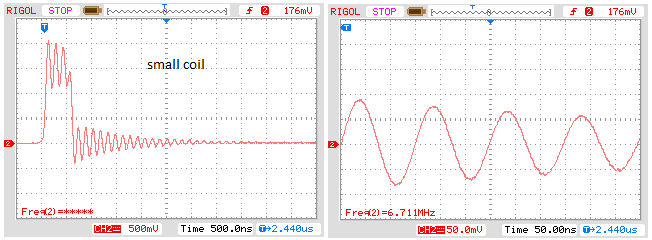

    Hi godigit, your scope pictures look good. Wondering how you get 454 oohms for the inner coil. Reply #97 you have 6.67MHz reply #65 135uH. Rd=pi*L*resonance, =2829 ohms.
    Hi Green.
    I did not use that SRF # I used the 1.316 mhz I had originally got. Calculating with the formula Rd=pi*L*resonance, I get 558ohms close to what I damped at with the resistor set up. If I use the formula L/(Pi*C)=Rd I get 4640. and move the decimal over 1 I wrote 454 down mistakingly.
    This coil no way would damp out a 2800 ohms it would be totally underdamped by what im experiancing.
    So I ended up with a inner value of 447ohms. The coil works very well for as much as Ive abused it and only twisted wireing together for the tests.
    Some idea of sensativity is a 1/4 square of soda can side at almost 3 inches in a bad test inviroment. Thats better than my TDI but im sampling at 5US first sample on the Mpp with a unshielded coil.
    All that brings to question SRF again like dbanner said Im definatly damping for a lower value right close to the 1.3 mghz.
    By my scope im doing things the best I know how. Please some one check my oscopy To me the coil looks sampleable at 4 us Is that correct? Am I looking at the sample window correctly?

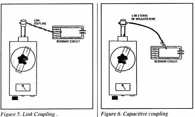

    • I guess the coil must be closed for it to be tested, right? I mean the coil excite, pickup loop method.
      Is there a drawing or sketch of how the test is setup?
      Look at this diagram of possible ways to couple a dip meter. I'm not sure a PI coil could be coupled in this way? You can even take a tap off of the dip oscillator and connect it to one of those cheap frequency meter kits on Ebay. Then you can directly read the SRF of the coil. All of this can be put into nice little project box.
          https://www.geotech1.com/forums/show...450#post261450 _8 is a picture of the measurement, test coil leads are open. I'm thinking the SRF of each of the two coils allows calculating Rd for that coil with no shield or lead, Rd in the box damps the completed coil and circuit. SRF of the completed means something but calculated Rd would still need to be changed depending on the Tx circuit.
          • Yes. Of course the coil ends must be open. Don't know what I was thinking.

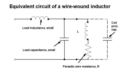

            It helps to visualize a model of an inductor, which has a series resistance and a parallel capacitance. If you short the ends, you short out the circuit. How stupid of me. I must have been thinking of the scope probe loop.

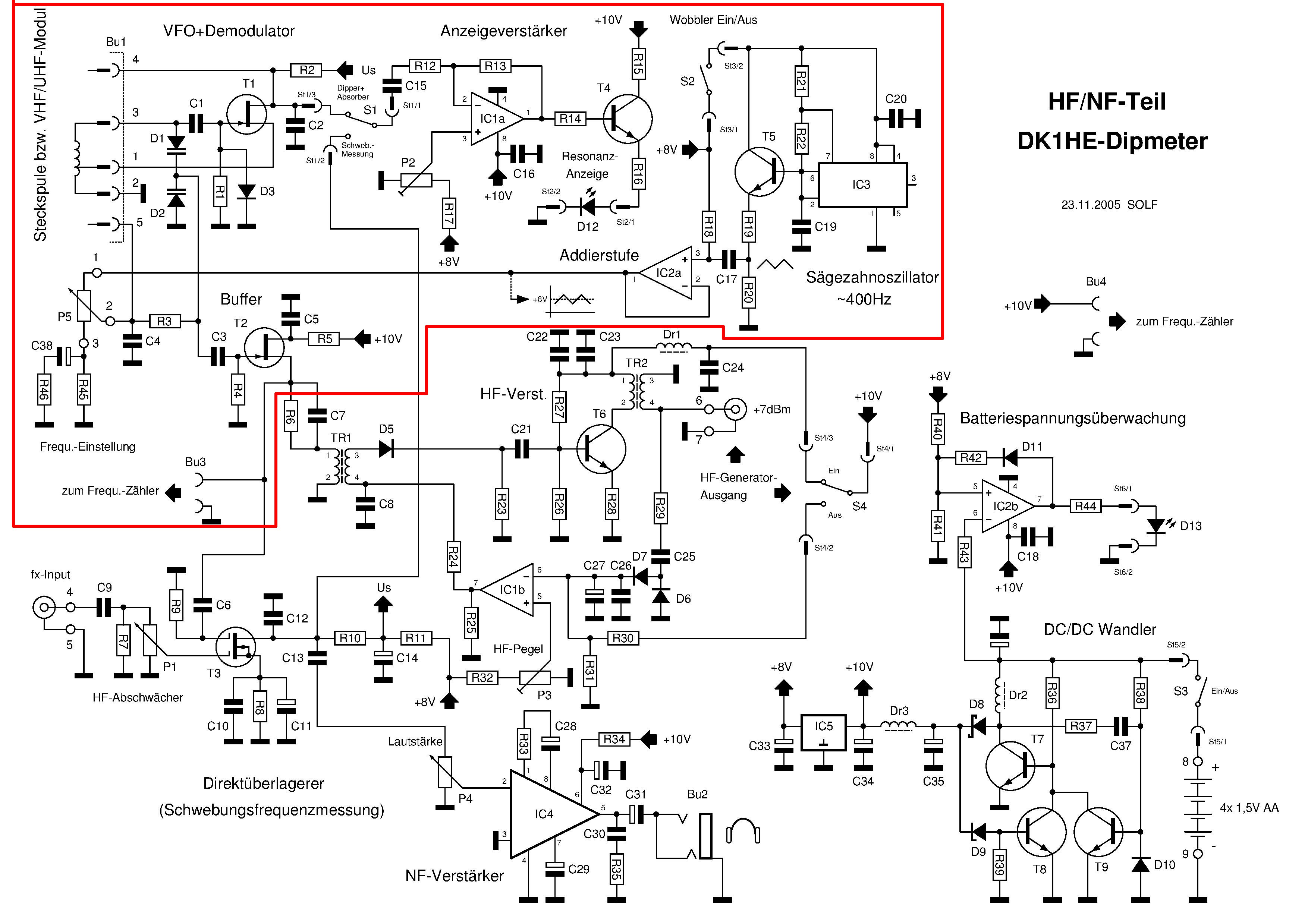

                I found a nice circuit for a dip meter oscillator which has a pot instead of a variable cap to tune the oscillator. It has an LED to indicate the dip.
                This could be a nice little project. The section in red is all you need. The output after the buffer is your frequency output wich can be connected directly to the scope.

                  • Equivalent circuit of an inductor.

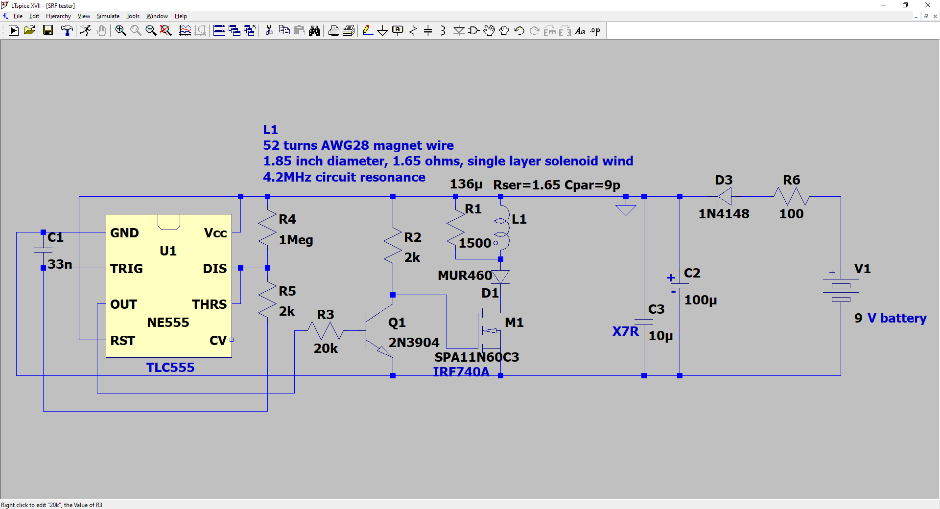

                      Made a SRF tester(PI Tx) to compare with my bench circuit. Faster current decay. Plan on measuring SRF of small and large coil with SRF tester and bench circuit for compaeison. Sending coils, 10nf(measures 10.32nf)npo ceramic, and SRF tester to godigit to see if he gets the same SRF. Connecting 10nf capacitor across coil and measuring resonance should allow calculating coil inductance. Don't have an inductance meter but godigit does. Can compare calculated inductance with his meter. Anyone think of something else to try before sending. Placed test coil on PI tester coil then placed loop on test coil and read SRF on scope. Played with the circuit with spice, used TLC555 and IRF740 to make circuit because that is what I had.
