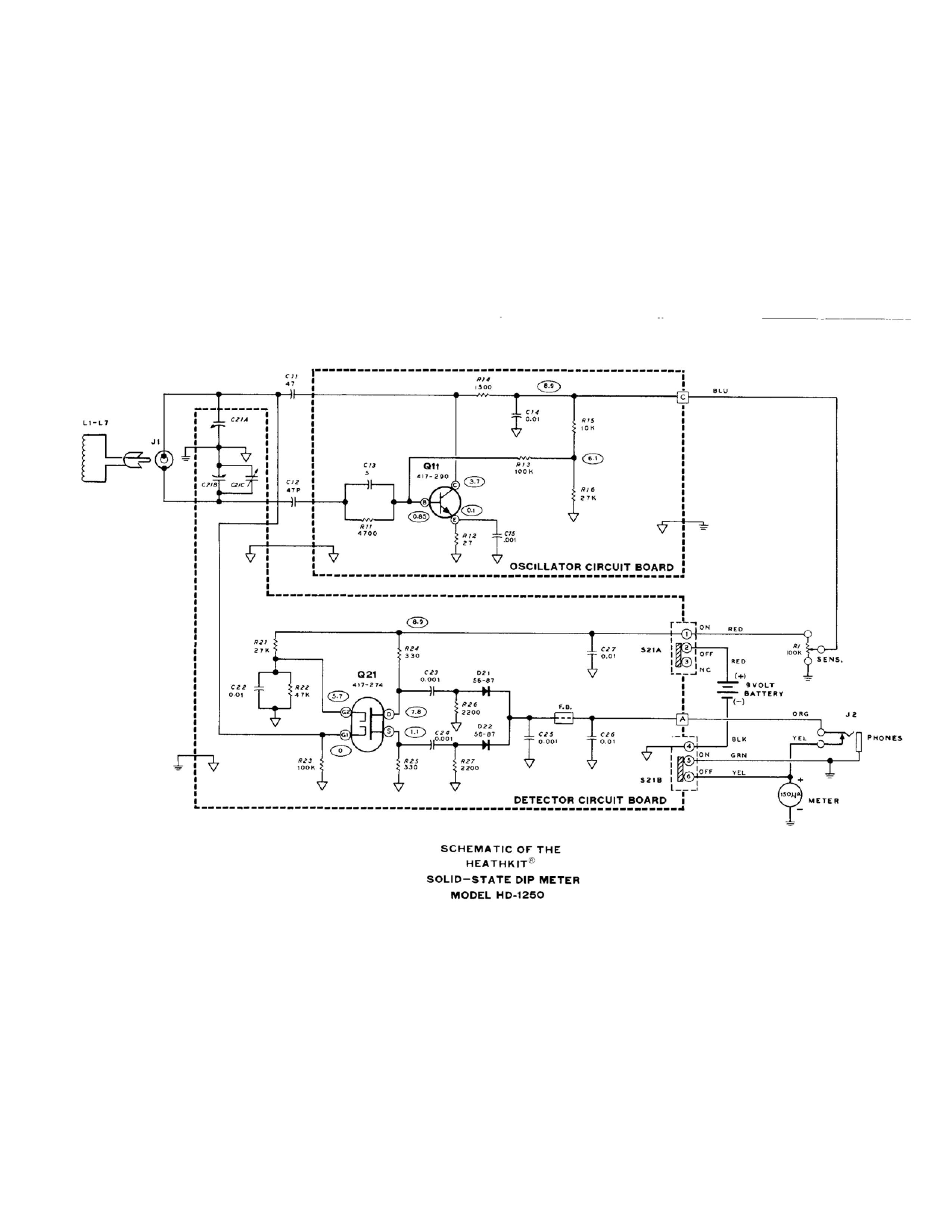

  • I am thinking that one way to test the SRF of a PI coil( several inches in diameter), would be to use a sort of a dip meter principle, except that the dip meter would be modified to accomodate a large coil(several inches) for coupling to the PI coil. Dip meters usually come with small coils to attach to the dip meter, depending on the frquency band, but you could just the same wind a larger coil to attach to the dip meter circuit, so it can be coupled to the PI coil under test more easily. Once the dip meter dips, you then take it over to a scope or frequency counter to check the frequency of oscillation and that will be your SRF of your PI coil.
    https://www.youtube.com/watch?v=_HwIL6mqq_k
    • Here is the schematic for the Heathkit HD-1250 solid state dip meter, It's perfect for measuring SRF. A very simple circuit to construct. Q21 is a dual gate mosfet 3N201, 20V 50mA.
      I think it might be useful to conduct some experiments with such a circuit. Not sure if it is possible to couple these small dip coils to a large PI coil, but worth a try maybe. I think accuracies to within 5% would be acceptable.
      • Also, an LED could be used to indicate the "dip" or resonance instead of the micro amp meter.

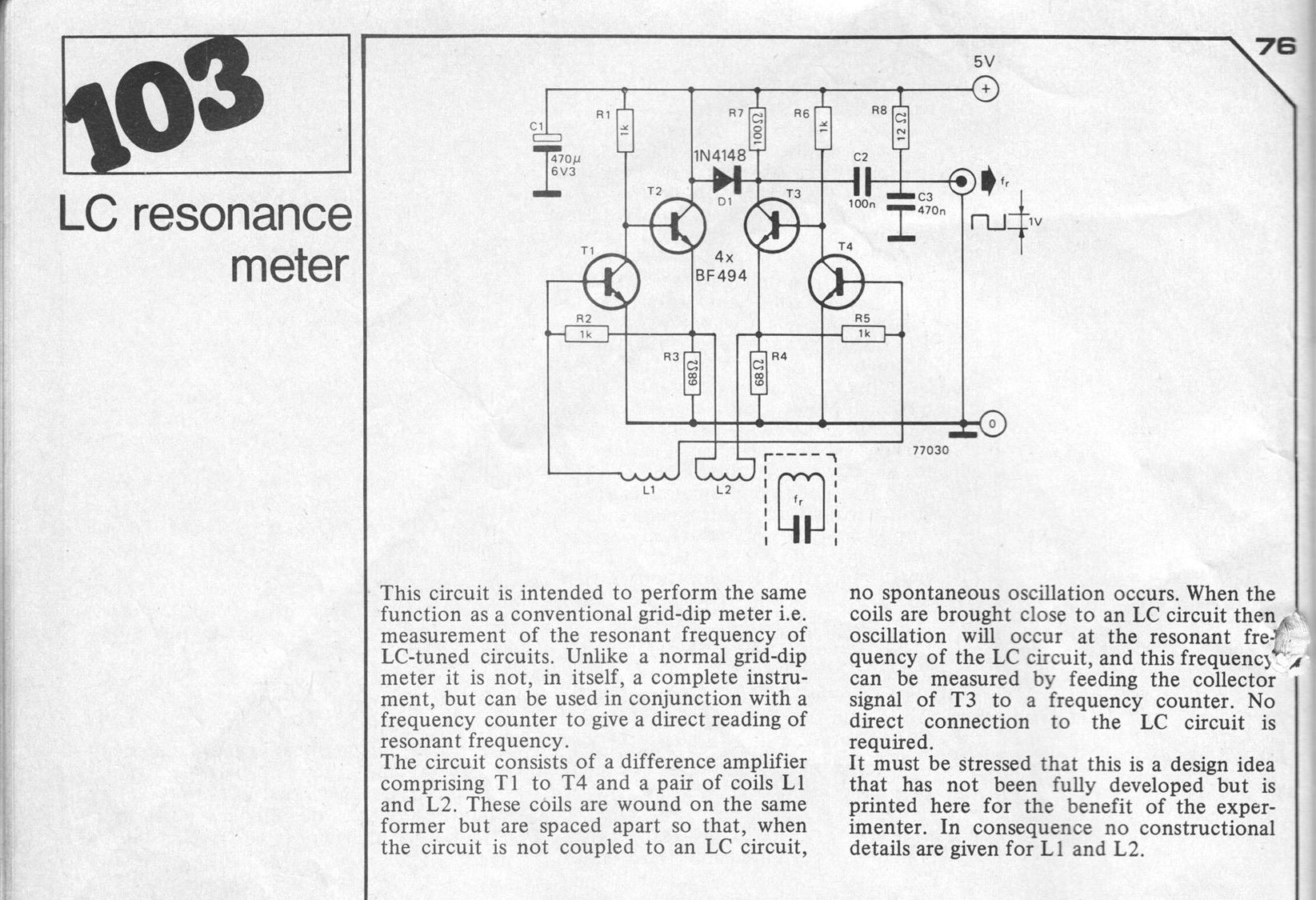

        • Here is another interesting circuit for coupling to a coil. I outputs a frequency equal in value to the resonant frequency of the coil it is coupled to. It seems it can be directly connected to an oscilloscope or frequency meter. Perhaps this circuit can be made into a sort of probe, such that when placed next to a PI coil, the SRF of the coil can be read.

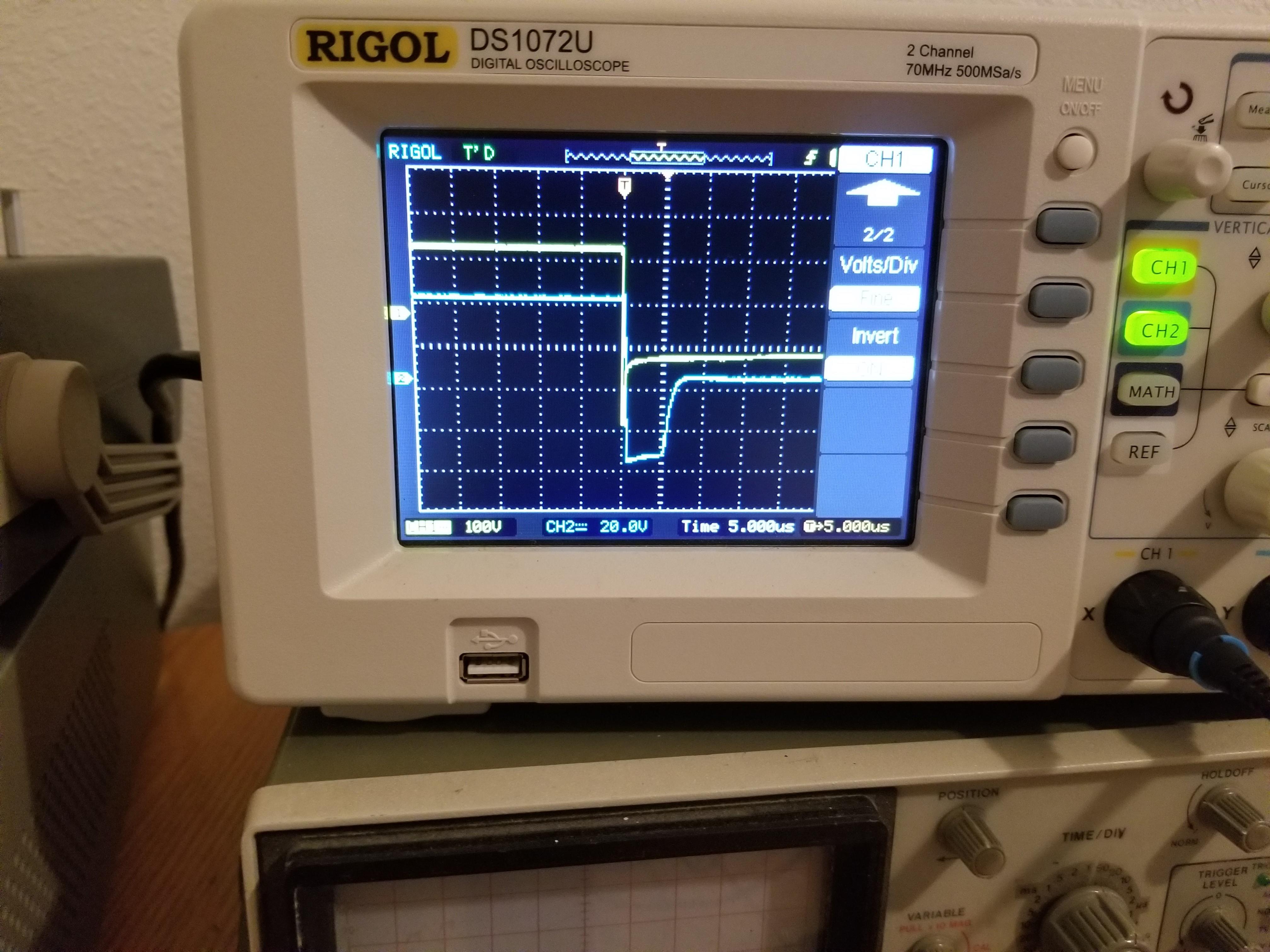

                          • Ive finished my testing of the dual field as far a damping the coil goes.
                            I tried damping with both a damping resistor set up and with the calculated damping resistor from the patent formula.
                            Damping the inner coil with the damping resistor set up my value was 528 ohms.
                            the coil maybe was slightly underdamped but performed best there on small gold targets tests.
                            Final damping value for the two coils with this set up was 725 ohms.
                            this is the scope shot triggered from the Fet turn off so you can see actual coil speed.
                            I calculated the inner coil damping resistor at 454 ohms My series resistor set up came out to 447 ohms.
                            testing the coil with this value looked ever so slightly overdamped and target response was slightly deminished.
                            Final damping value using the calculated inner damping resistor is much better at 1.236k as well as coil speed is slightly faster.

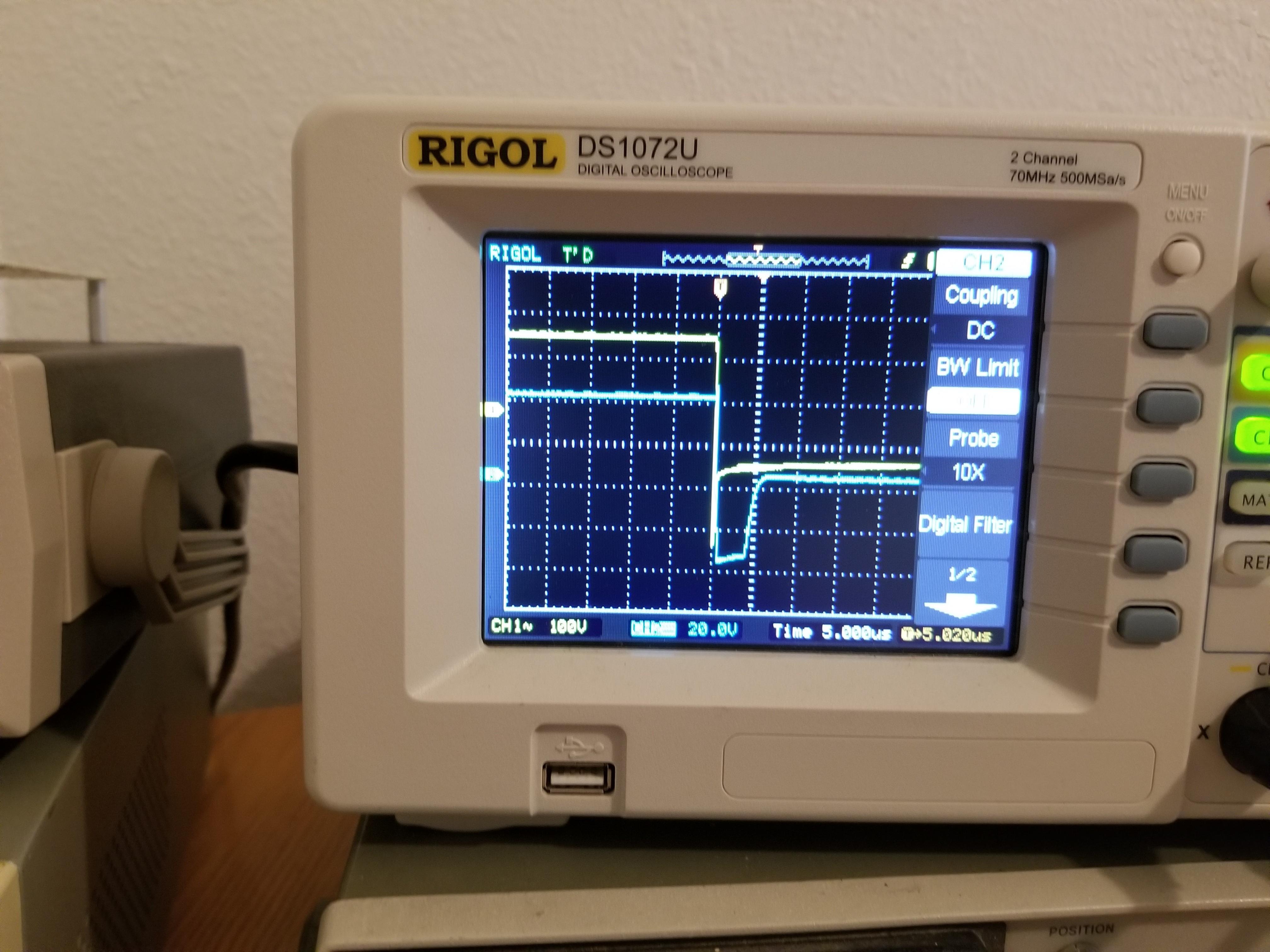

                            I did allot of target testing both ways and end performance is so close depth wise it hard to tell but the damping resistor set up is maybe just a little more chatty.
                            The patent says the inner coil is isolated by the outer coil and indeed it is but I found a way to get a glimps at least.
                            With the 528 ohm set up i noticed if you hit the coil with a large target, for just a instant I would get flash of a underdamped resonate coil then it looked good.
                            Testing further with the 447 ohm damped coil, the resonation response was gone and like I had said the coil is less chatty and end performance as you can see by the scope shot is a bit faster.
                            I wanted to play with it a bit try to understand the coupling of the coils. It appears that after coupling, the inner coil was underdamped and I think thats the brief ringing I was seeing with the 528 ohm set up but only if you hit the coil with a bigger target would it show.
                            The patented method is of coarse the way to go.
                            Thanks All
