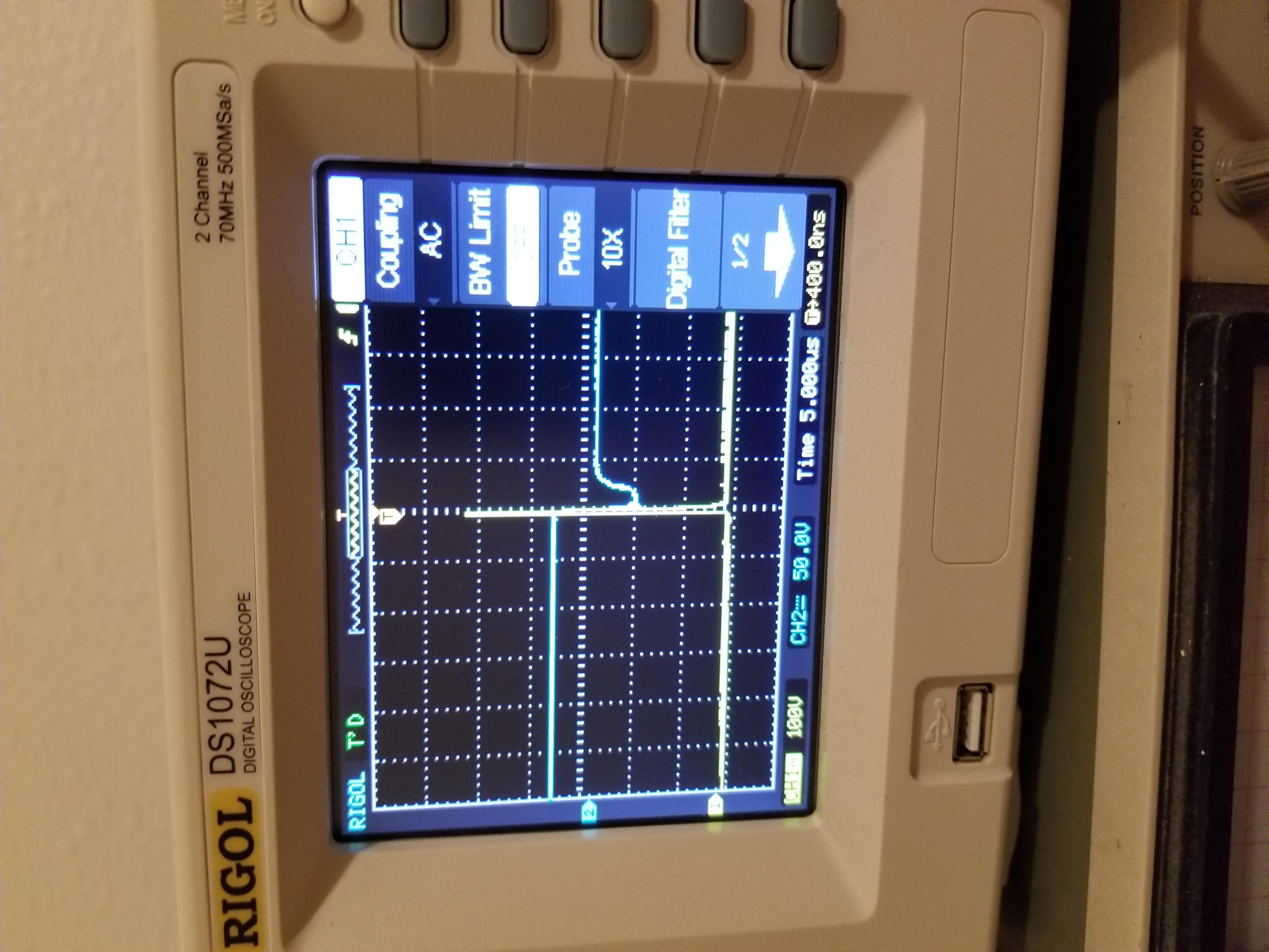

    godigit, what do you see if you place the loop on the operating coil without the test coil?
    I see the tx cycle .

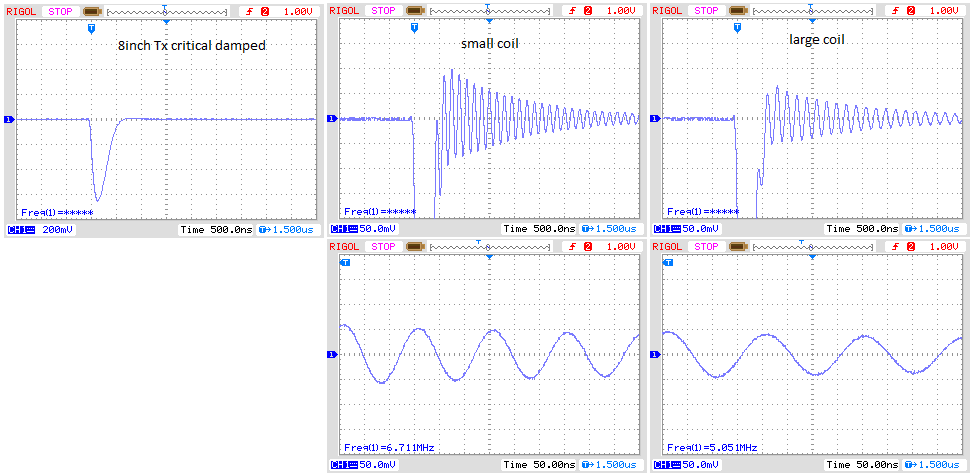

    I'm just trying to figure out why I get 6.7MHz SRF and you get 1.3MHz SRF for the small coil. Don't think AWG30 would be much different than AWG28. I have a RIGOL 1052E 50MHz scope, don't think our scopes could cause the difference. I twisted the wires to see what effect it would have measuring SRF, would have to make a lot of twists to get resonance near 1.3MHz. Maybe someone else has a guess at why our SRF measurements are a lot different. Your picture of the small coil looks like a flat spiral with no spacing?
    Looked at your picture reply #72 again. Scope leads were connected to coil, not a loop. Tried SRF measurement with my leads connected to the small coil(probe x1)reads 1.35MHz about the same as you. Try the loop when you disassemble your coils.

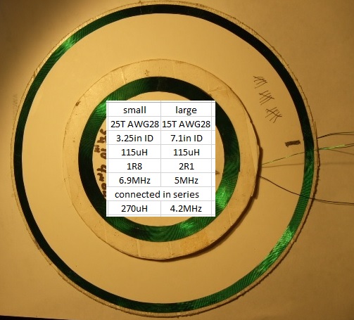

      Made the large coil.

        Was wondering what the SRF for the small coil would read with the signal generator method vs PI excited method. Don' have a signal generator so tried with spice. PI excited method is closer for the 115uH coil(small coil), both methods the same for the other two coils(300uH).
        • #94
          Just ran a couple quick tests.
          The small coil is harder to excite using a live pi than the larger coils.
          To get it to resonate in a way I can measure it, I have to have the probe at 1 times and distance the coil away frow the Live coil to reduce amplitude enough to measure it.
          On the larger coils Im able to use the 10 x on the probe and tape directly to the live coil.
          The small coil will not resonate at 10x probe setting, I start seeing the flyback pulse some ringing but it is damped to much to get a measurement.
          I tried a 6" loop of 26 awg and Im getting only the TXcycle, Im not getting SRF at all. I tried 1x 10 times coil shorted and open.
          I only get a inductive look at the Tx Cycle.
          When pulsing with the coil attached to a live Pi and both the damping resistor and input resistor removed, I can measure just using the probe as a loop and see resonation .
          But I get the same measurement as live pulsing.

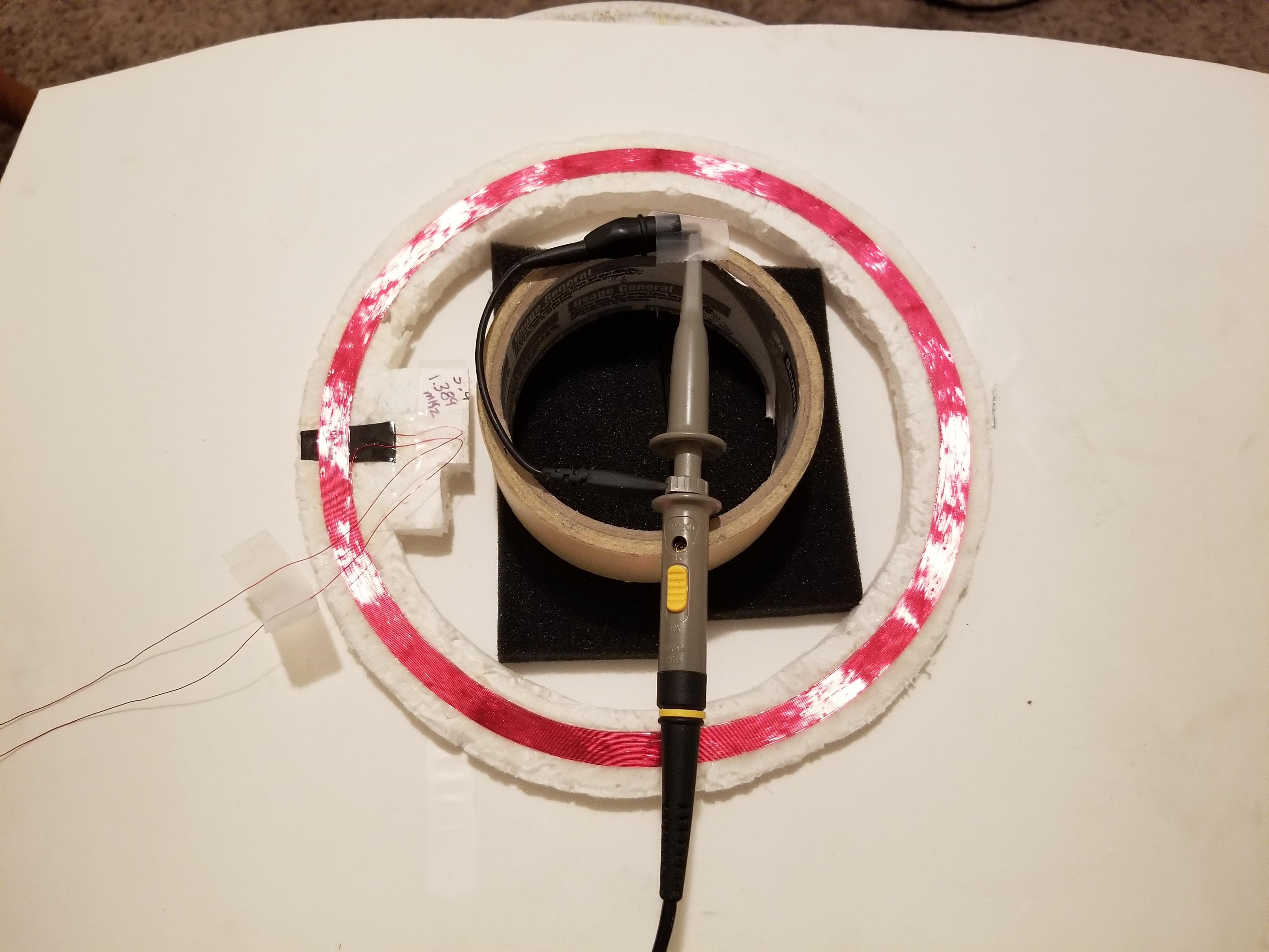

          Im wondering exactly how you made your loop.
          Updates to windows 10 have left me unable to save pictures I keep trying they just dissapear even my phone changed and flipps all the pictures now.
          I made my 6" wire loop out of 26 awg magnet wire with no twists and attached to pos and neg of the probe.
          .But I really think its all a probe issue. I think the Rigol probes are of a much nigher impediance that the ones you are using now.

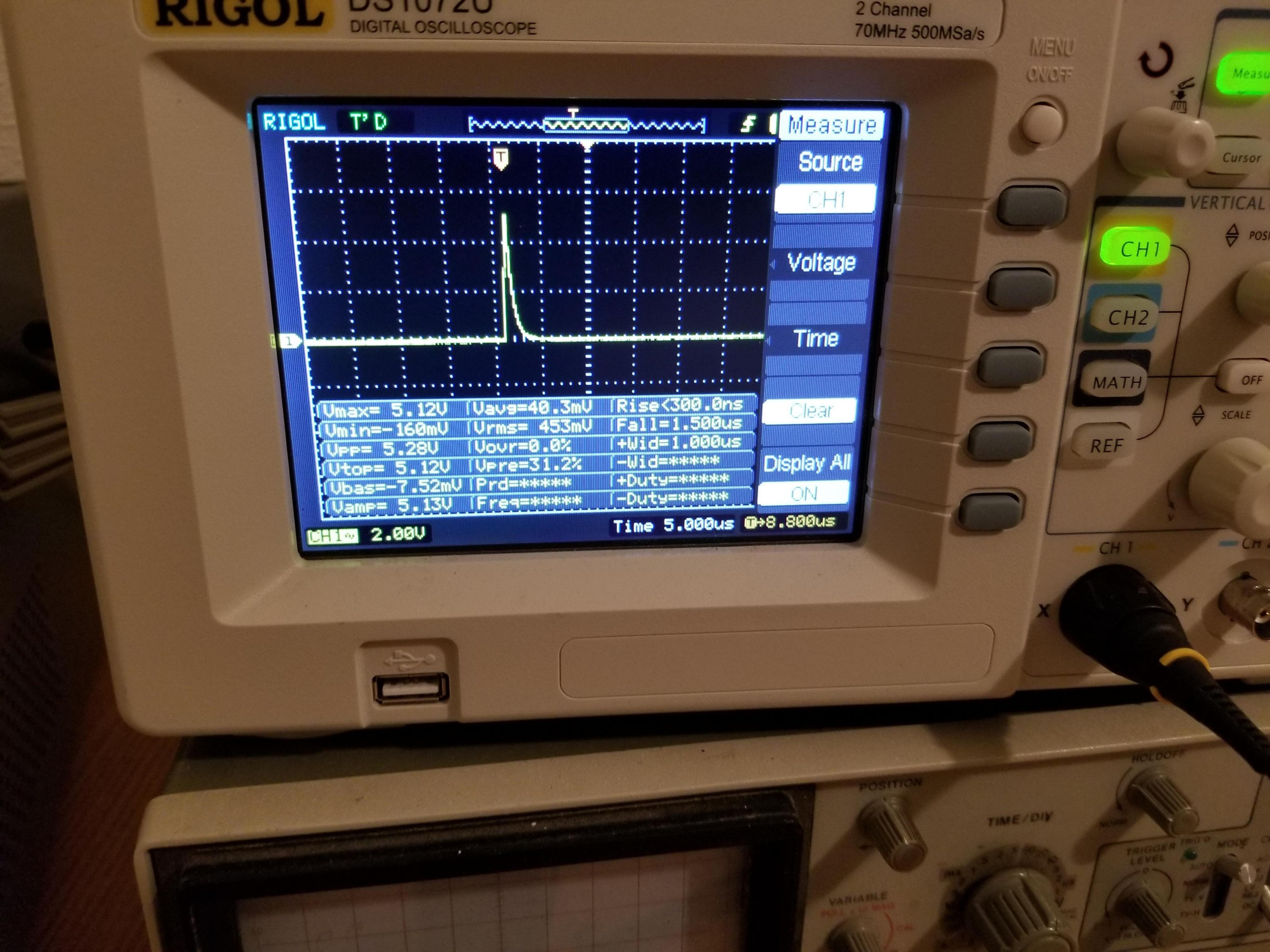

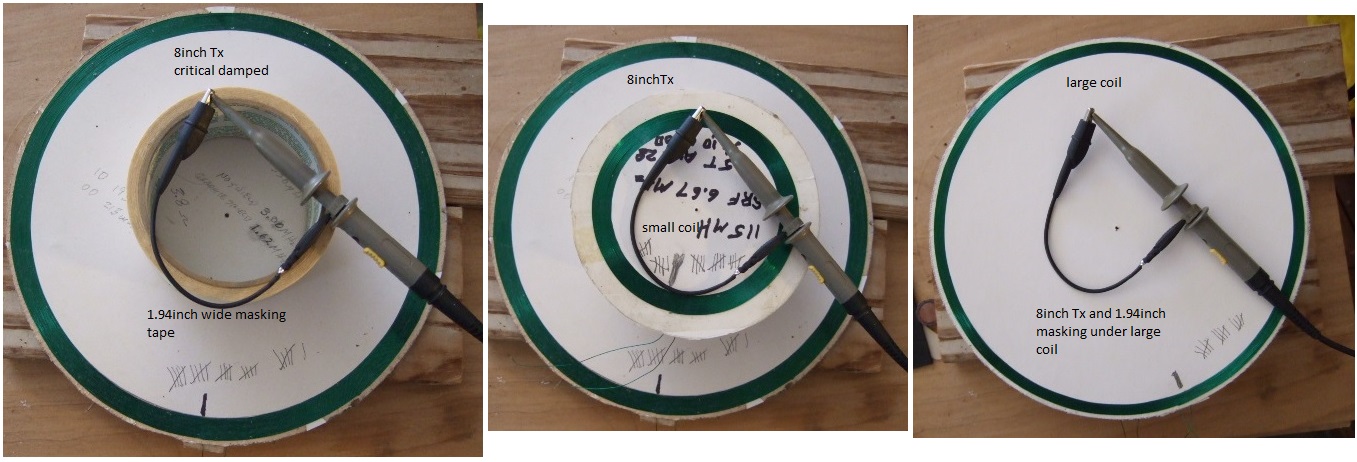

              Hi godigit, some pictures of my measurements. PI Tx coil_8inch critical damped, size not critical but coil should be critical damped. Used about 2inch spacer(about a 2inch spacer seems to be best)between TX and test coil(roll of masking tape)piece of foam worked too. RIGOL probe x1, ground lead connected to probe making a loop. Probe not connected to anything. Scope pictures from probe loop.
              I made a loop(one turn)of wire because the RIGOL probe didn't work the first time I tried the other day. Found my ground lead had opened(if you look at pictures you can see solder joint where I repaired the lead). RIGOL probe works as good as my other probes.

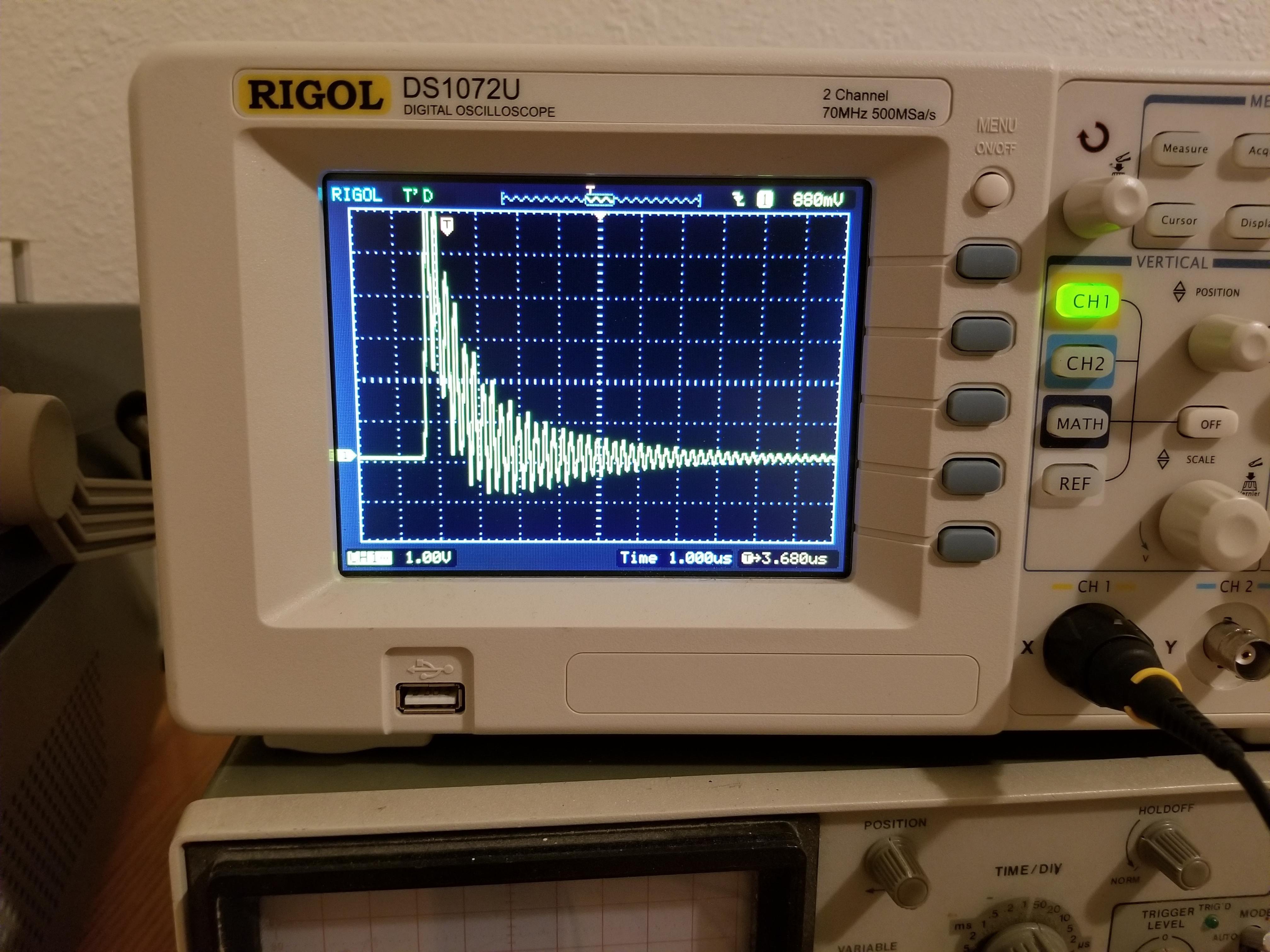

                I set up pretty much exactly as you and Im able to get better SRF but the wave forms I get still look damped.
                Im not sure whats up with that but both coils together look better.
                Here is the test set up And shot of the damped 6.5"Id coil.

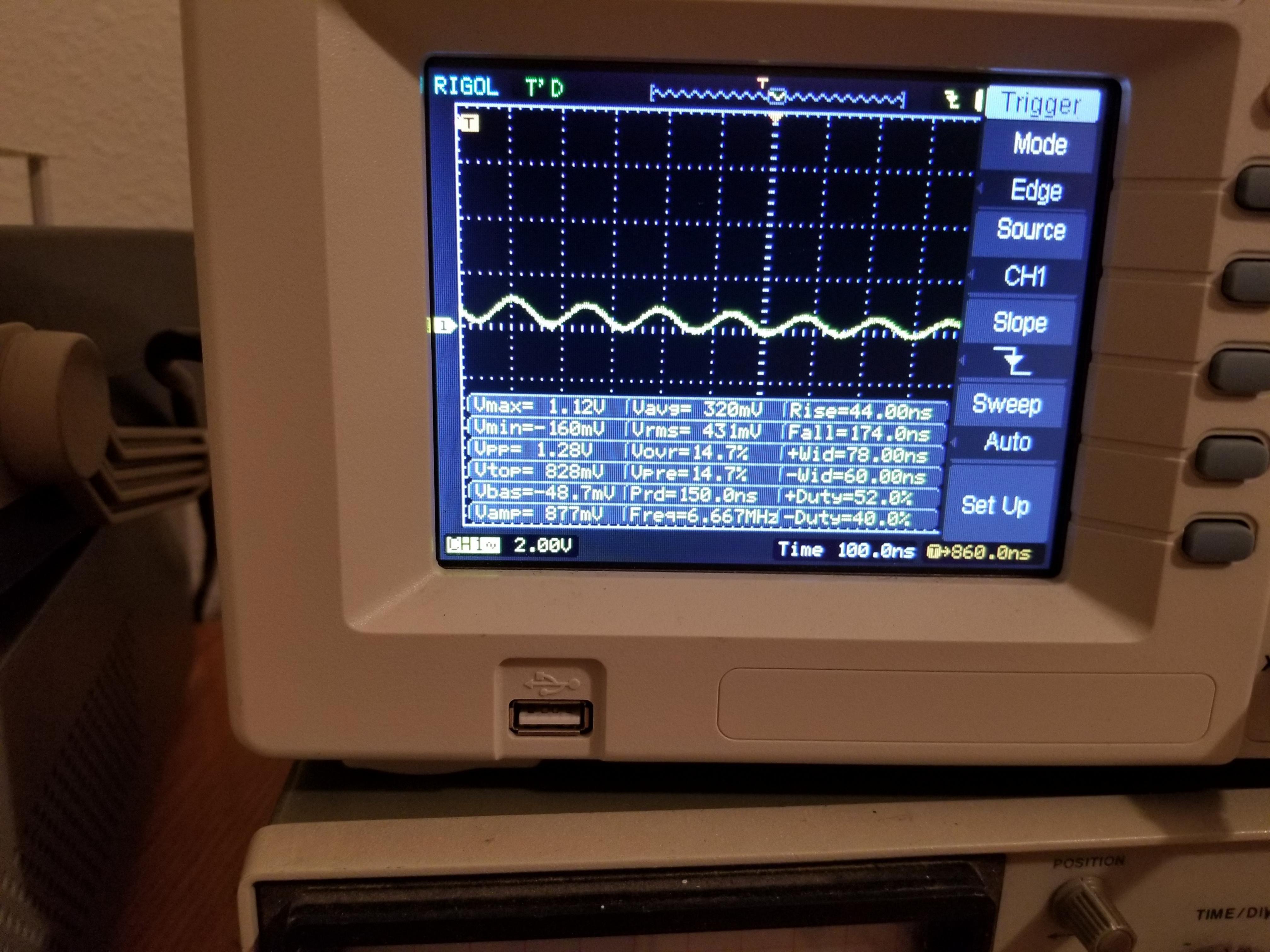

                Small coil SRF is now 6.667Mhz
Name:	SRF small coil.jpg

                The full waveform
Name:	SRF waveform.jpg

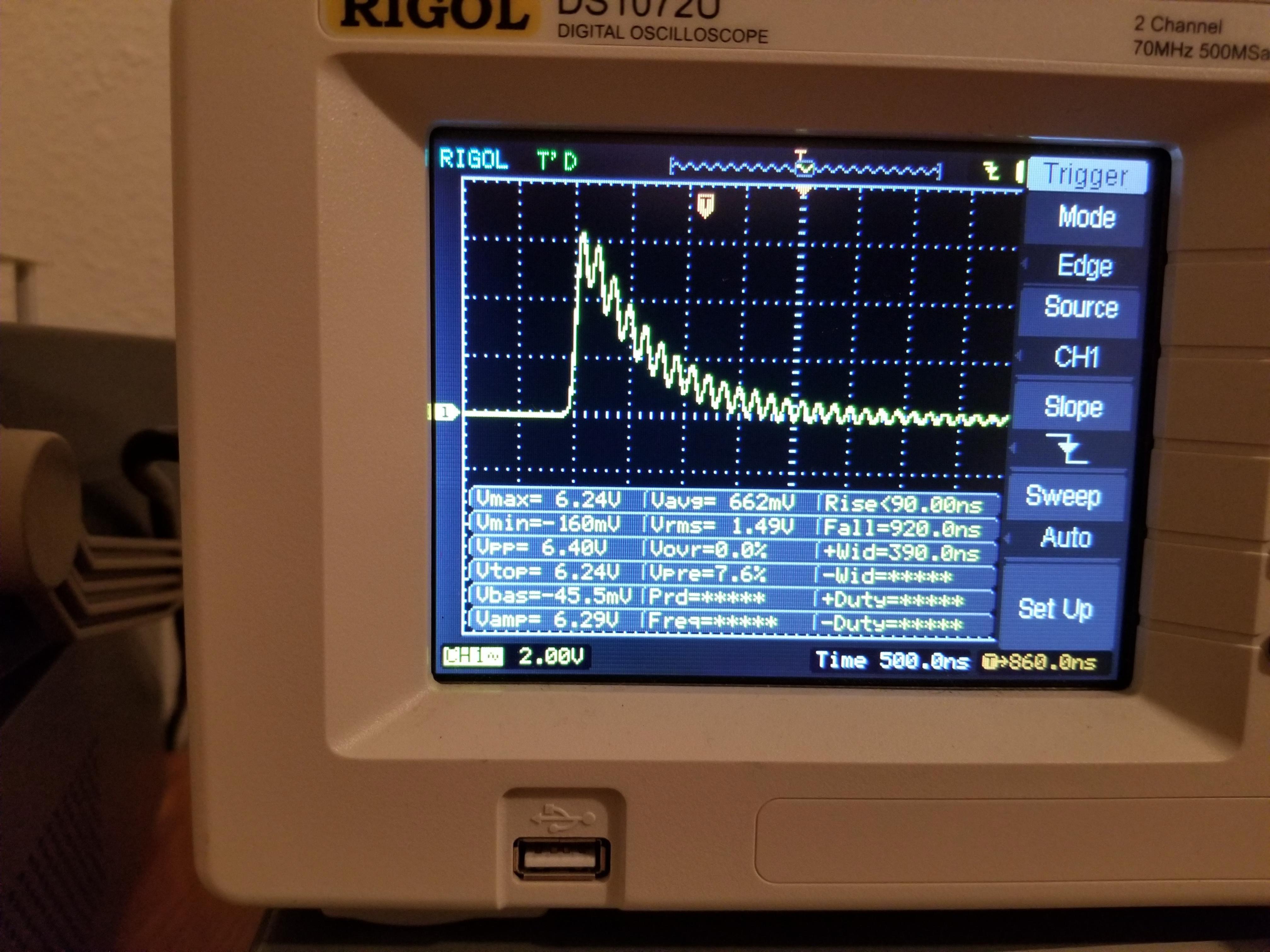

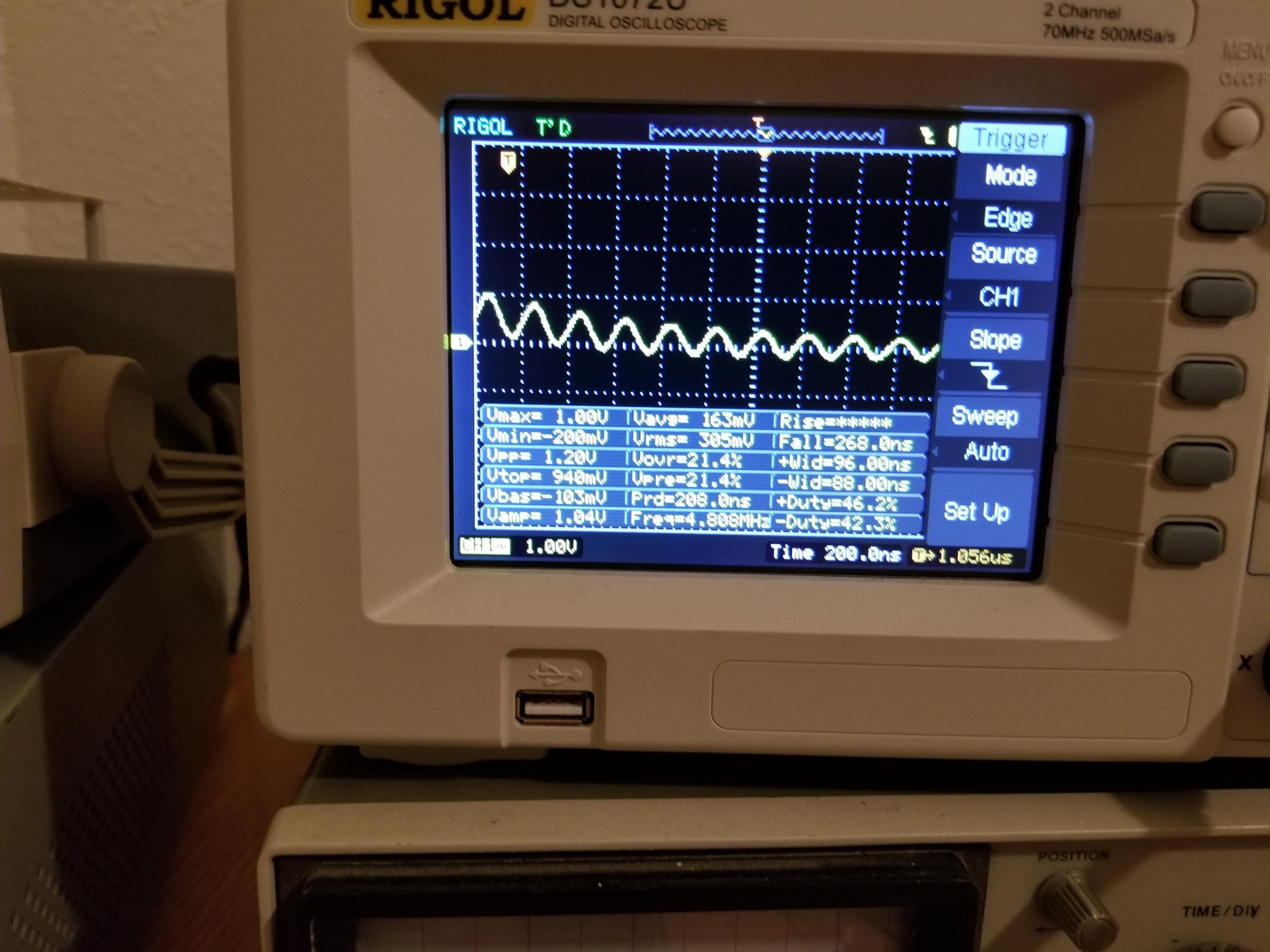

                Large coil SRF is now 4.808Mhz
Name:	outer coil SRf.jpg

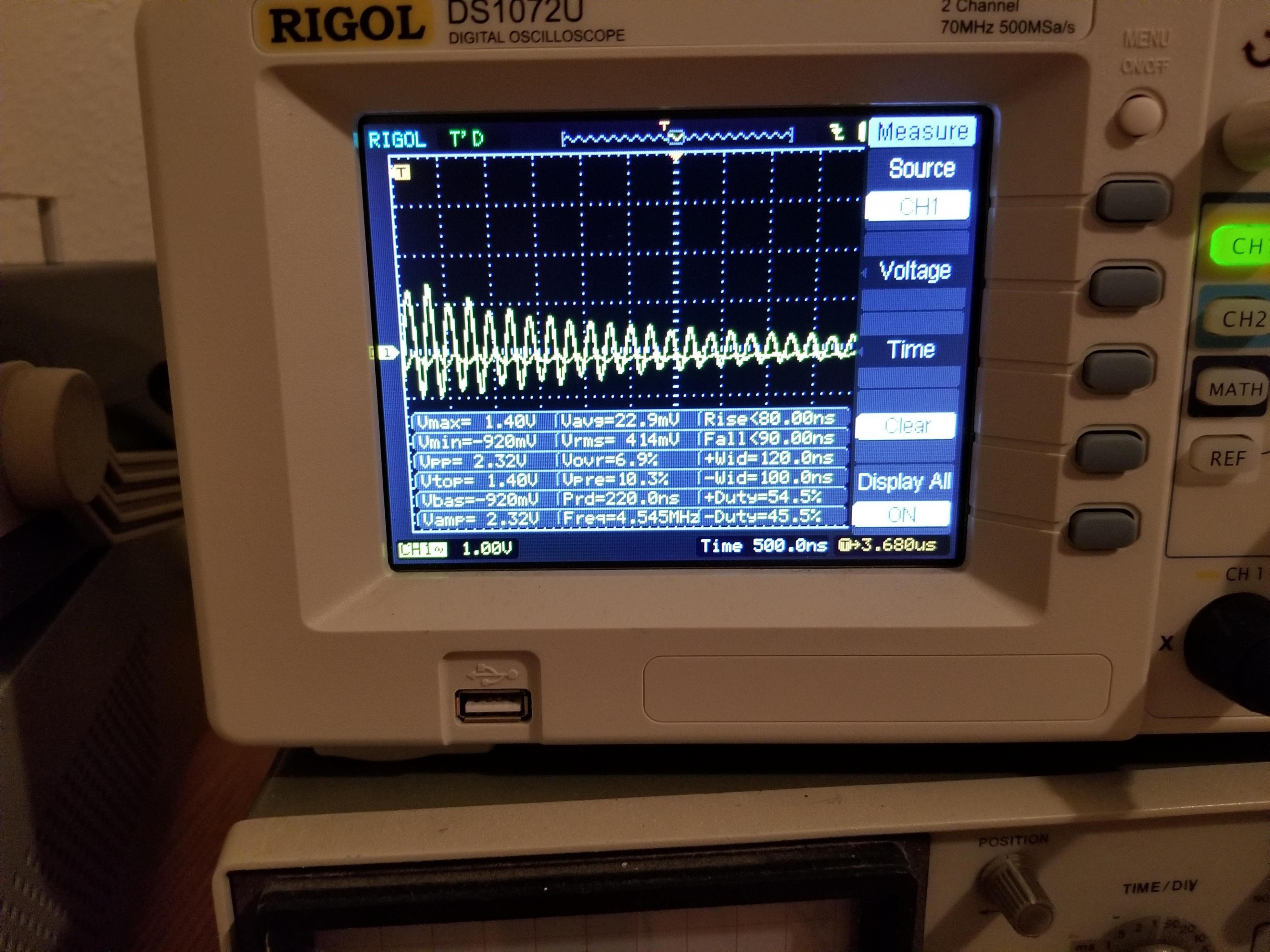

                Coils combined SRF Is 4.545Mhz

                        Reply #93 I did a comparison of SRF measurement with loop pickup PI excited and using signal generator. Both methods were close to calculated SRF with higher Cpar values. Signal generator method reads lower when Cpar was 5pf. The 1pf series capacitor effected the reading, changing it to .1pf in the simulation gives a SRF close to calculated. I had thought coupling between PI coil and test coil might effect SRF measurement. Does have a very small effect with spice. Spacing appears to have a very small effect with actual testing. Haven't seen anything that suggests signal generator method is better. Maybe someone has a different opinion and could explain why signal generator method might be better or something wrong with my simulation.
                        What do you mean by live pulsing?

                          Try Y position so center screen is near full Tx decay(2.5 to 3us after Tx off)set Y scale to maybe 100mV/div and X scale to 50ns/div.

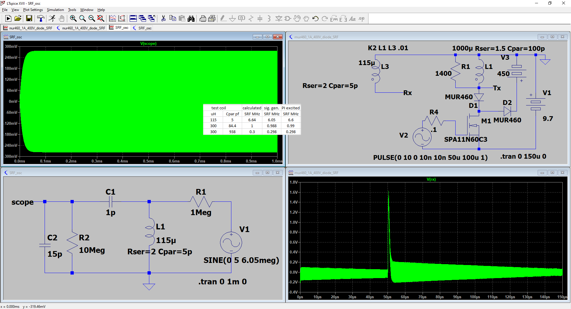

                          Don't have a MPP, been playing with spice. Will send coils for measurement comparison when I get done playing.

                                I take live pulsing to mean taking the readings off a directly driven coil, whereas the probe loop method induces a current/voltage. Maybe there is some small but significant difference in the results between the two methods, the question is what can this be attributed to, and how can it be rationalised.
                                When I first tried the loop method I thought coupling between the PI Tx coil and the test coil might be a problem. Very small effect with my tests. When coil is connected to signal generator circuit, a PI Tx circuit or probe connected across test coil while exciting with a PI Tx the circuit effects SRF. There would be a very large difference in SRF if the coil was connected to a PI Tx circuit without the series diode, not as much with the diode included. Think 6.7MHz is correct SRF.
                                SRF
                                6.7MHz____PI coil exciting small coil, loop pickup
                                3,87MHz___small coil connected to Tx with diode, loop pickup
                                2.82MHz___small coil connected to Tx with diode, x10 probe across coil
                                550kHz____small coil connected to Tx no diode, x10 probe across coil
                                1.3MHz____PI coil exciting small coil, x1 probe across small coil
                                3MHz_____ PI coil exciting small coil, x10 probe across small coil
