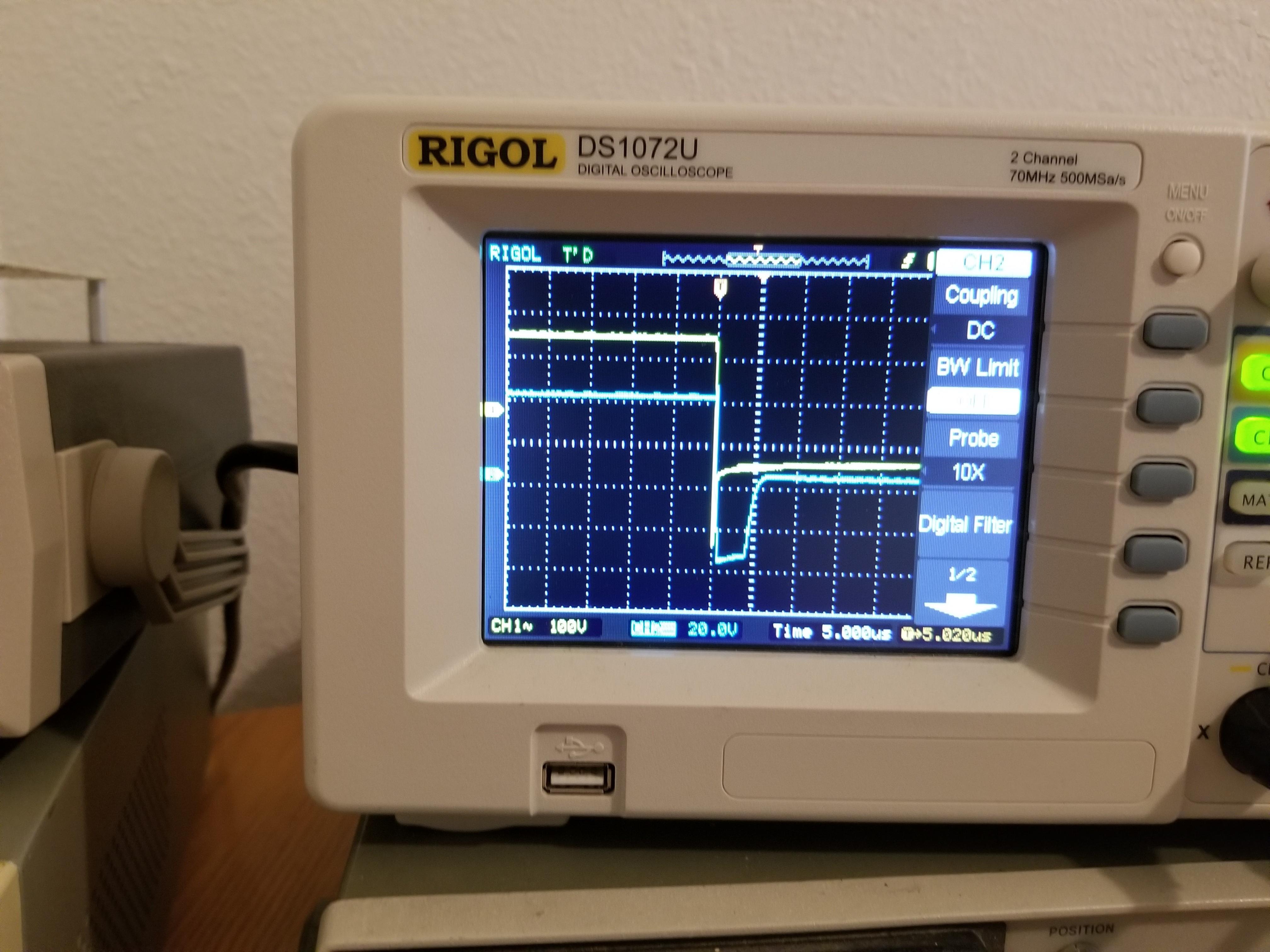

              Hooked up the coil tonight as you have it wired now (inside to outside) first with a 449 ohm inner resistor then a 530 ohm and a 1 k ohm.
              On my inductance meter with the inner damping resistor installed I read the coil at 290uh and 3.8 ohms resistance.
              So with no futher adue I will show the scope shots,
              This is the 1 k inner and it damped out to 479 on the final damping resistor set up.

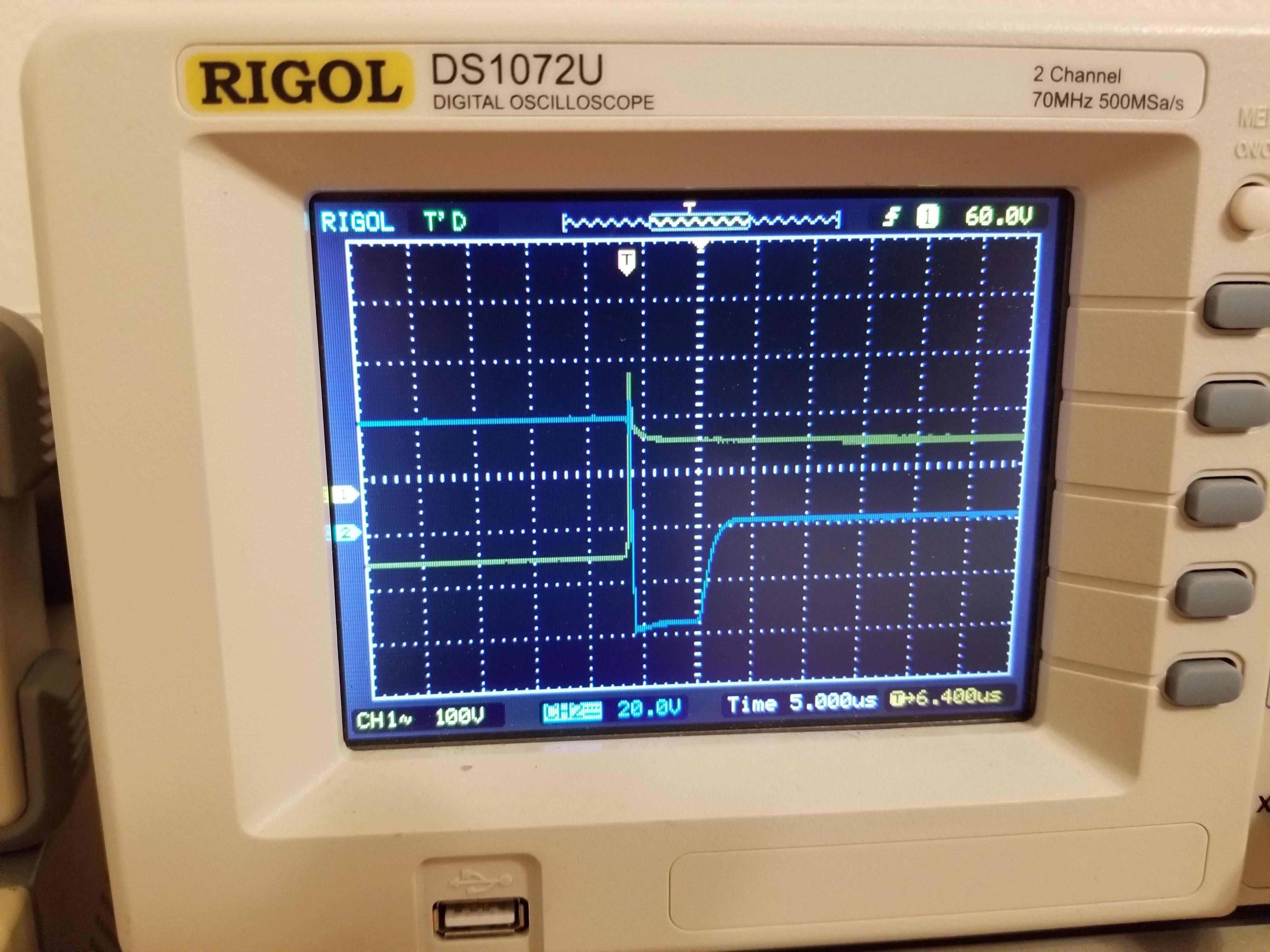

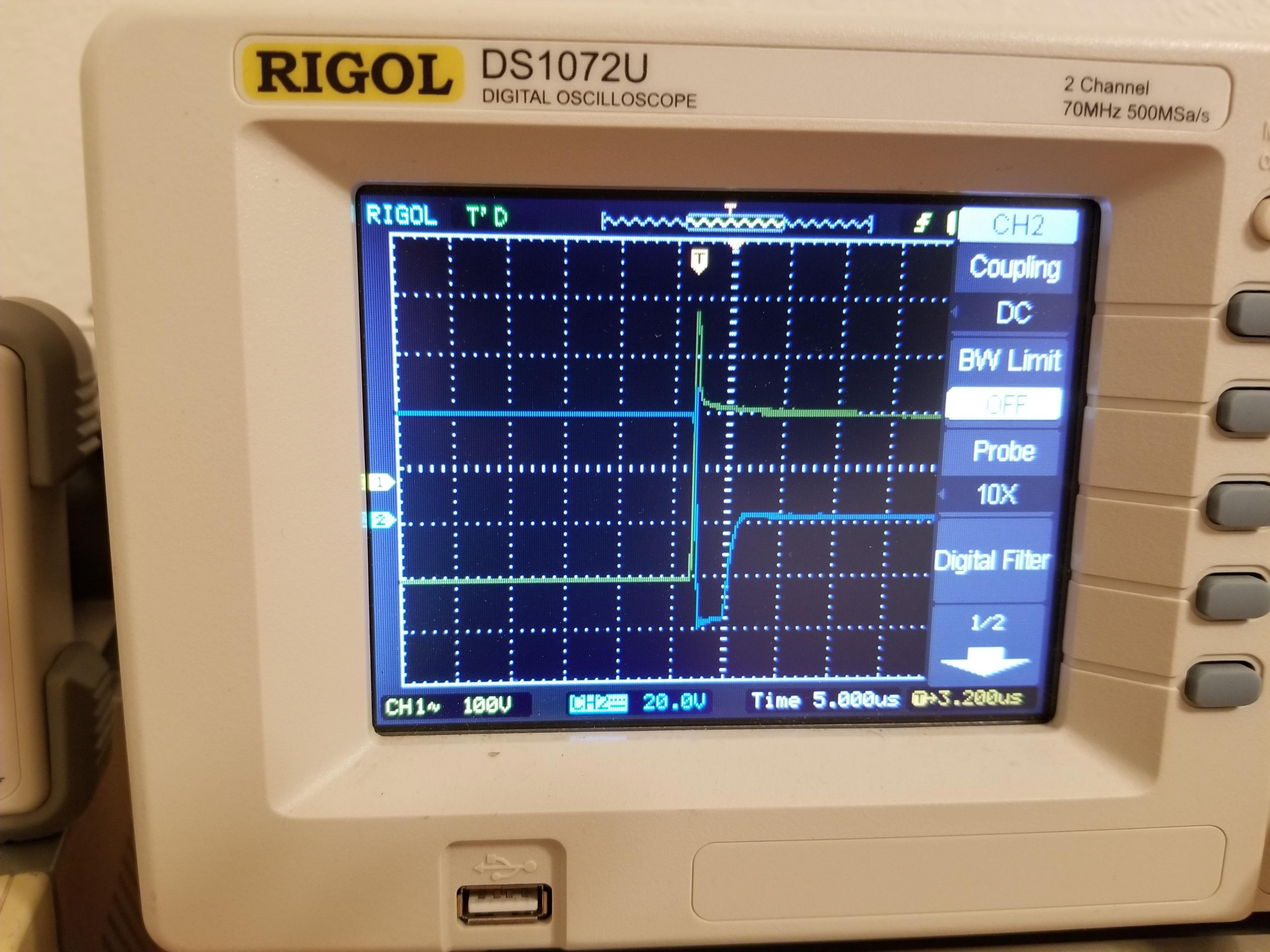

              With the 530 and 449 ohm inner resistors I damped to the 449 inner resistor and used the same final damping value for the 530 ohm.
              It damped at 1.585 K. Both were within .2us of each other so ill show the best the 449 ohm.

              So Im seeing things a bit faster than the 10 us you were getting, Im not sure if its the cable totally yet.
              Not sure about the twisted pair included was this your test cable?
              The coil is fully shielded as you sent it and looks to still be very fast. Im interested to see whats inside but want to know if there is anything specific you would like done before I open it up and seperate the coils for testing?
              Im able to get a very nice stable threshold at the lower inner damping values but once and a while it gets chatty with the inner 1k resistor not too bad.
              I was actually expecting and hoping to see a little more speed out of the 28 awg vs the 30 awg and it apppears to be so at this point.

                Hi godigit, thanks for the testing.
                Your first picture is similar to what I got when trying to critical damp. Second picture a lot better. The twisted pair is what I used for lead. See what you get with the twisted pair. The coil is just taped together, open it, do what ever you can think to try. Can be put back together.

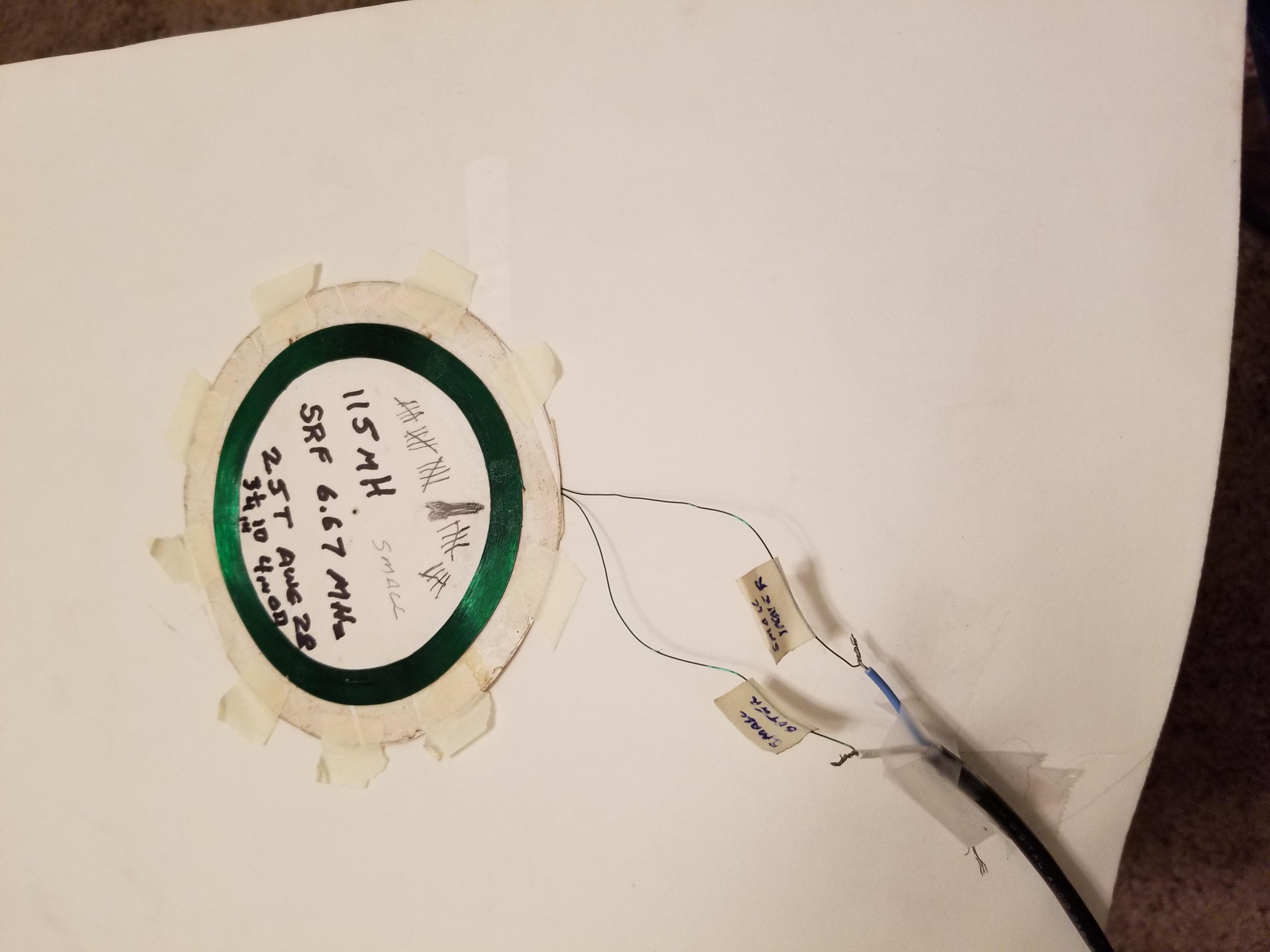

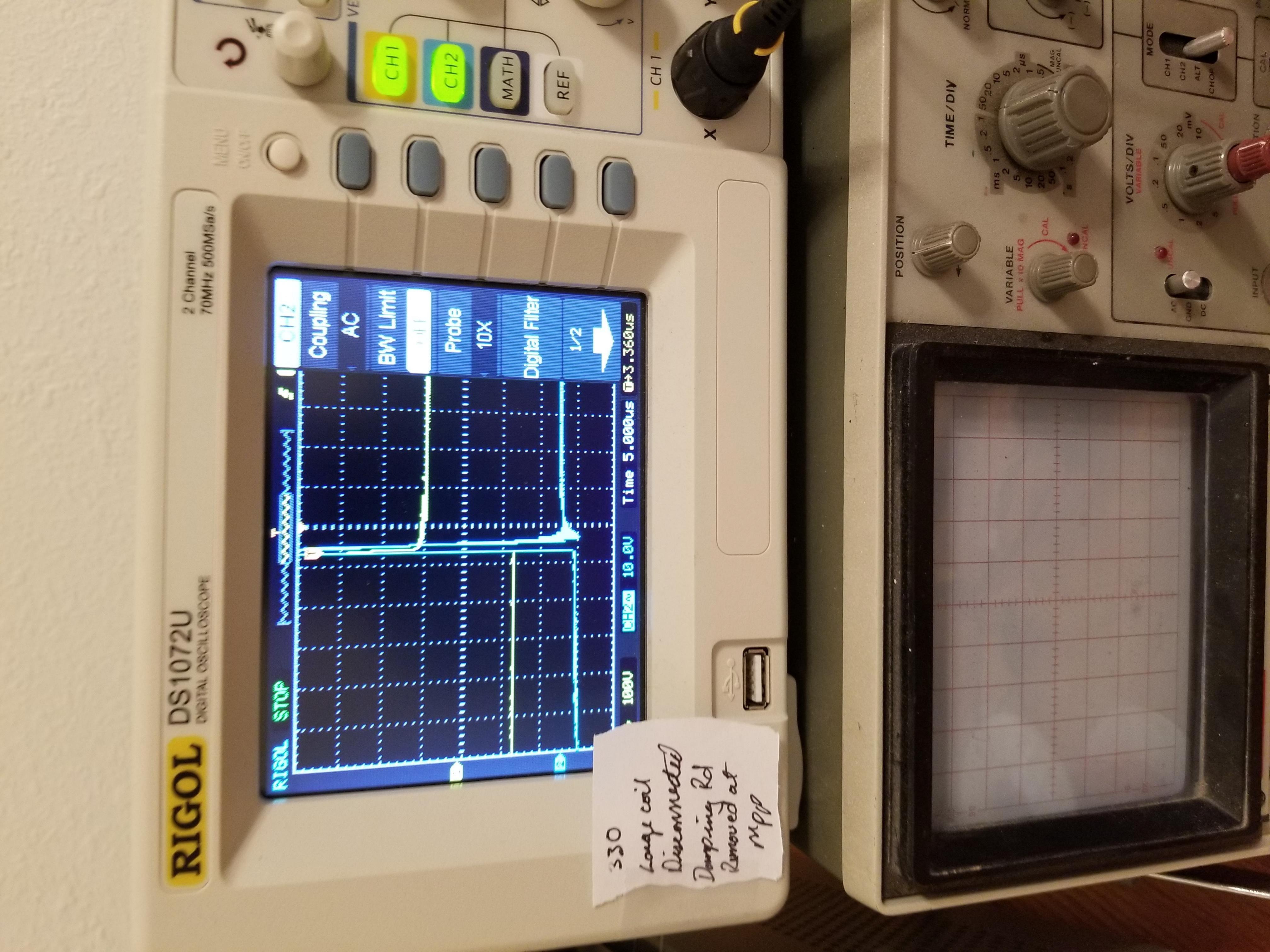

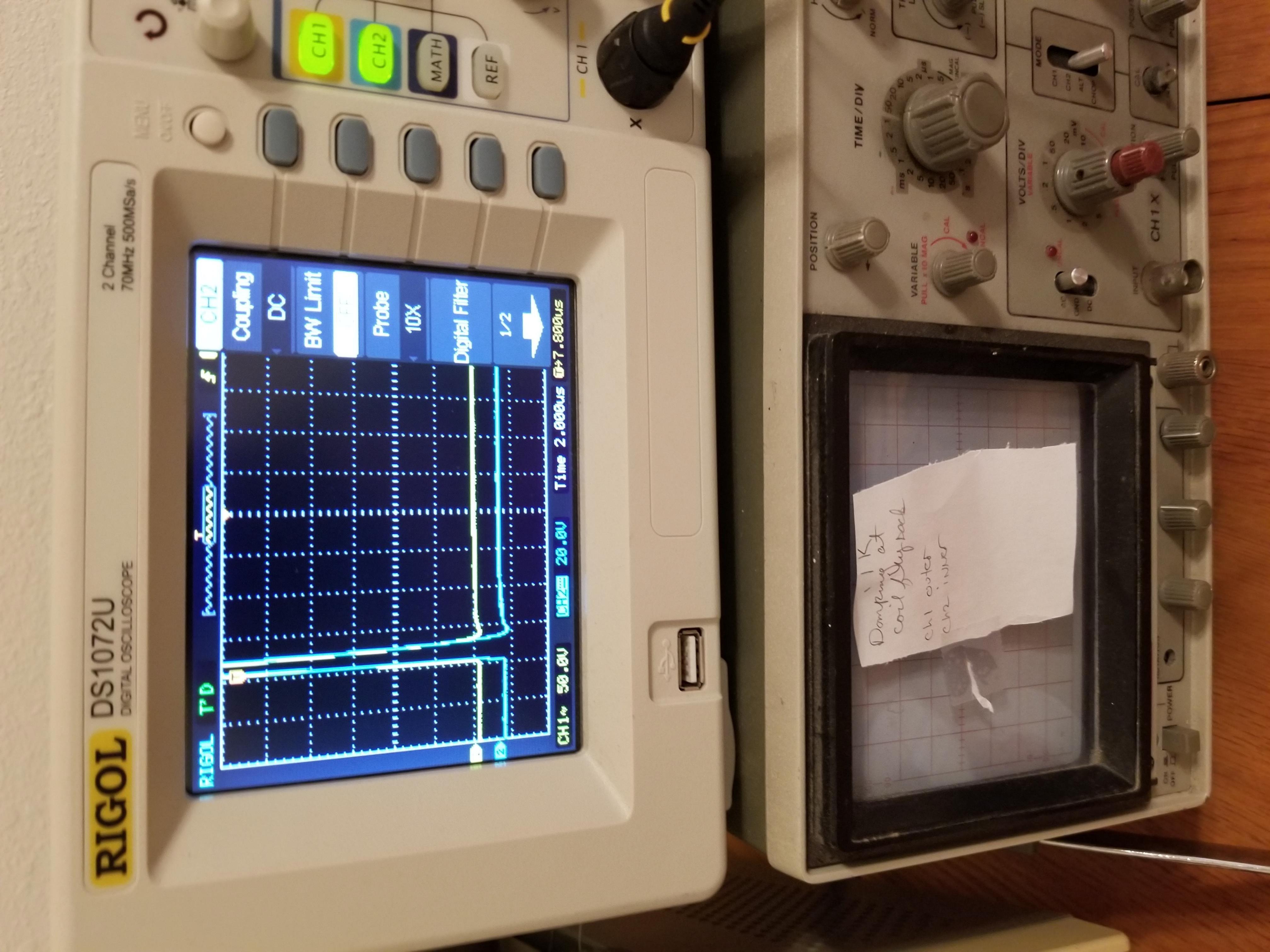

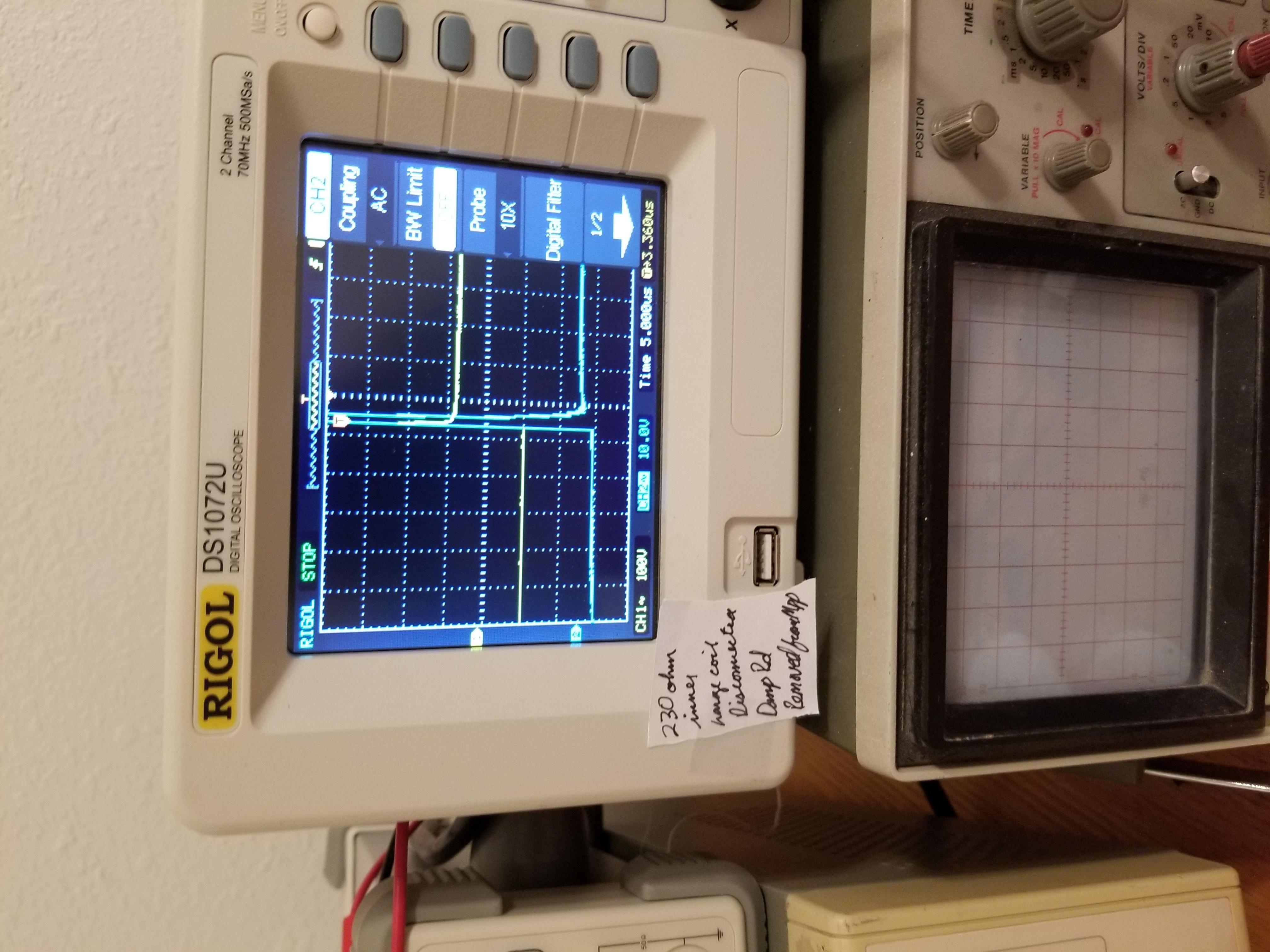

                  For this test I first seperated the coils,
                  Inner coil Rd values were determined connected to the MPP with a standard damping set up.
                  A criticle damping at 236 ohms and aggressive damping resistor value at 328 ohms was chosen.
                  I also threw in a 1k wild card inner resistor as it will prove to be important to the end results.
                  I will show pictures of the complete 1 k results and the final results for the 230 and 330 ohm resistors to keep the pictures down.
                  And I have to appologize my phone is fllipping the pics sideways again.
                  Here is the inner coil seperated and shots of the op amp at 230 ohms and 330 ohms.

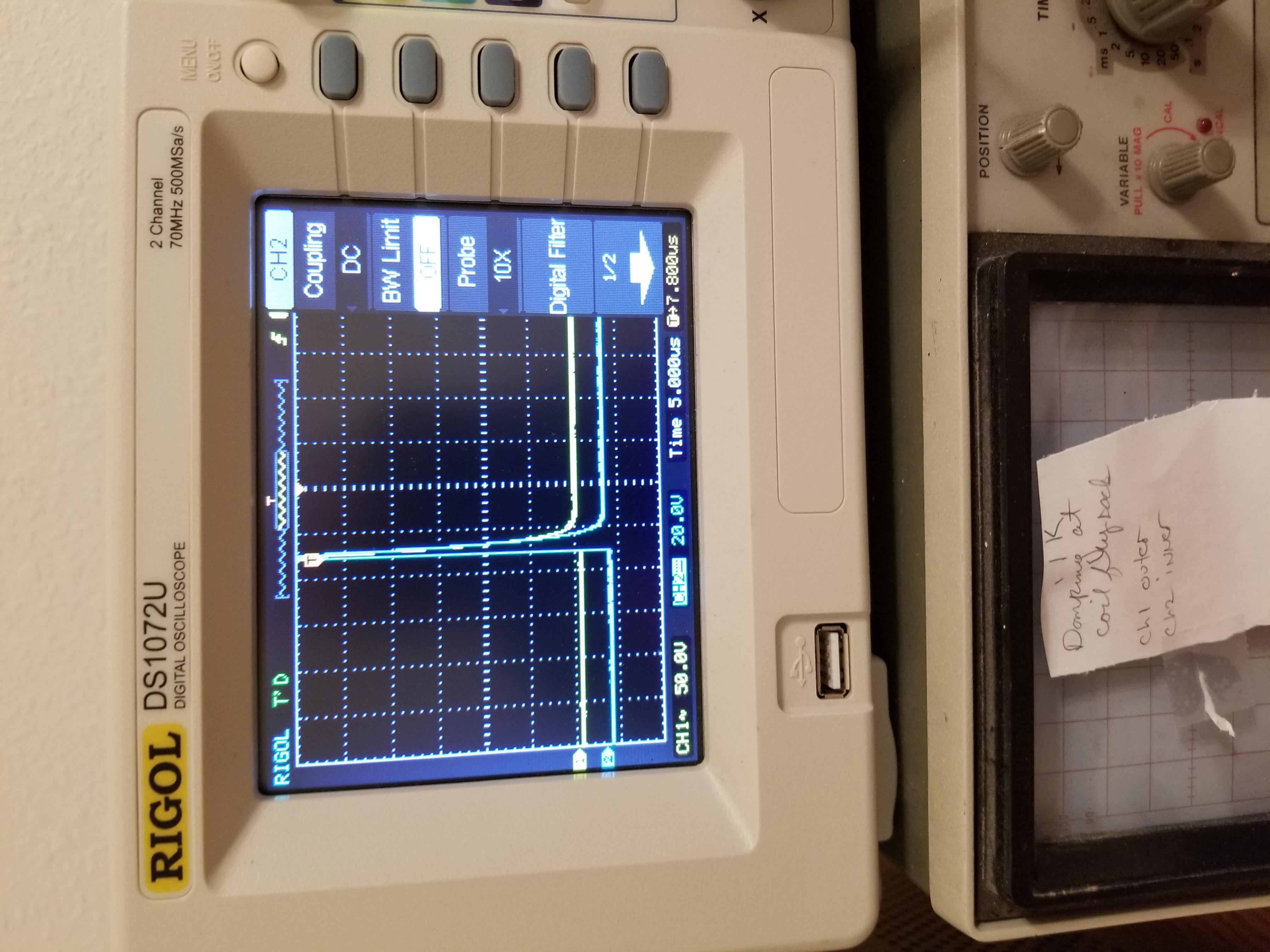

                  Here are shots of the complete 1 k tests with the coil fully assembled.
                  I will use the raw coil flyback of both coils for the first part of the test.
                  1k inner resistor criticly damped
                  Fly back pulse doesnt look too bad.
                  But if you zoom in the first signs of trouble, the inner coil looks underdamped but not too horrble.
                  Here is the same set up aggressively damped notice the speed differance.
                  Now looking at the flyback both coils are loooking underdamped.
                  The exact tests were done on the 230 and 330 ohm inner Rd.

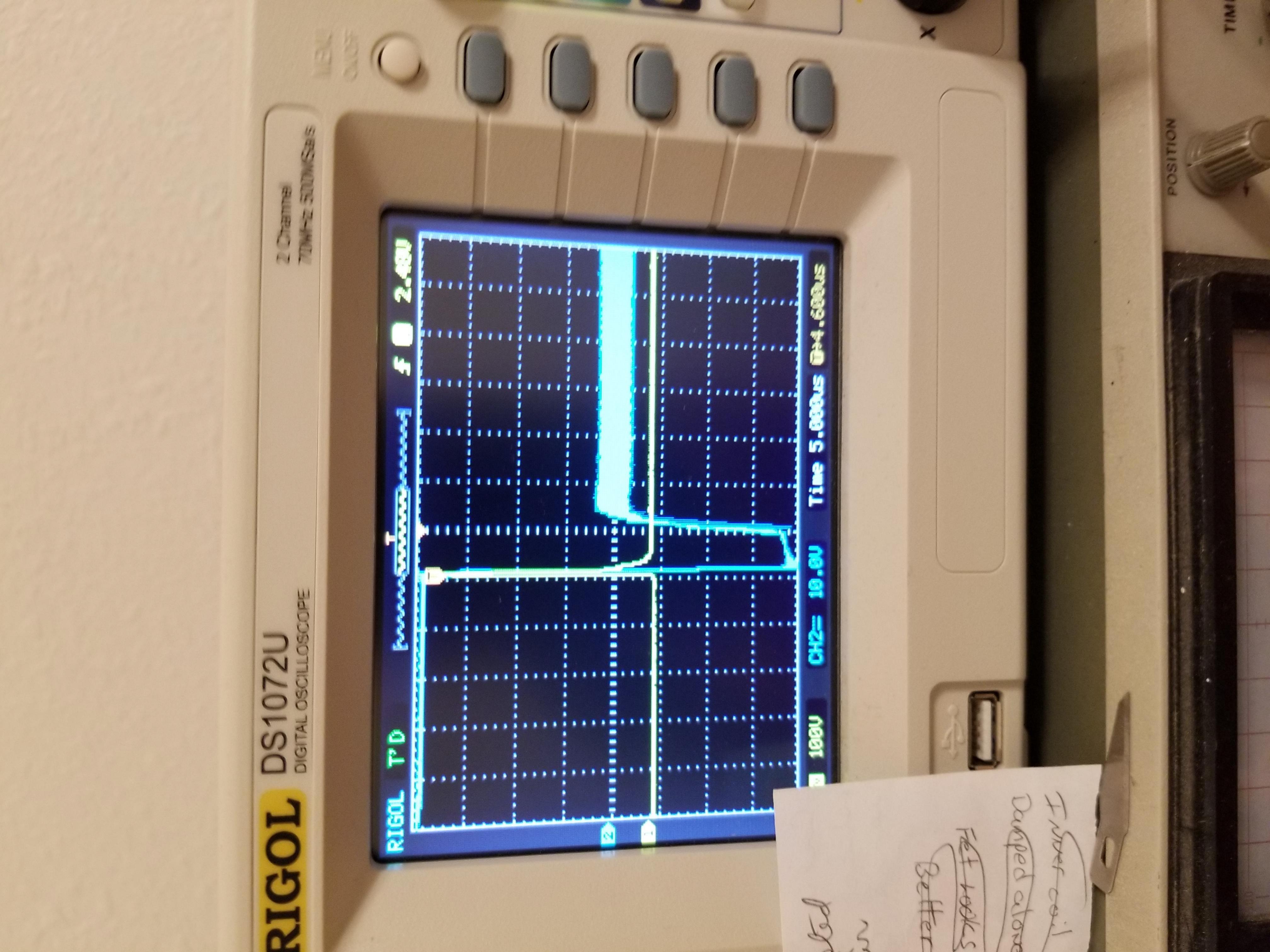

                  for the next half of the test I remove the large coil from series by disconnecting it from the RX only. Then attach the rx to the small coil and remove the MPP damping resistor.
                  This way we can get a look at what the inner coil is doing at the op amp.

Name:	330 unpluged.jpg
Name:	230 unpluged.jpg

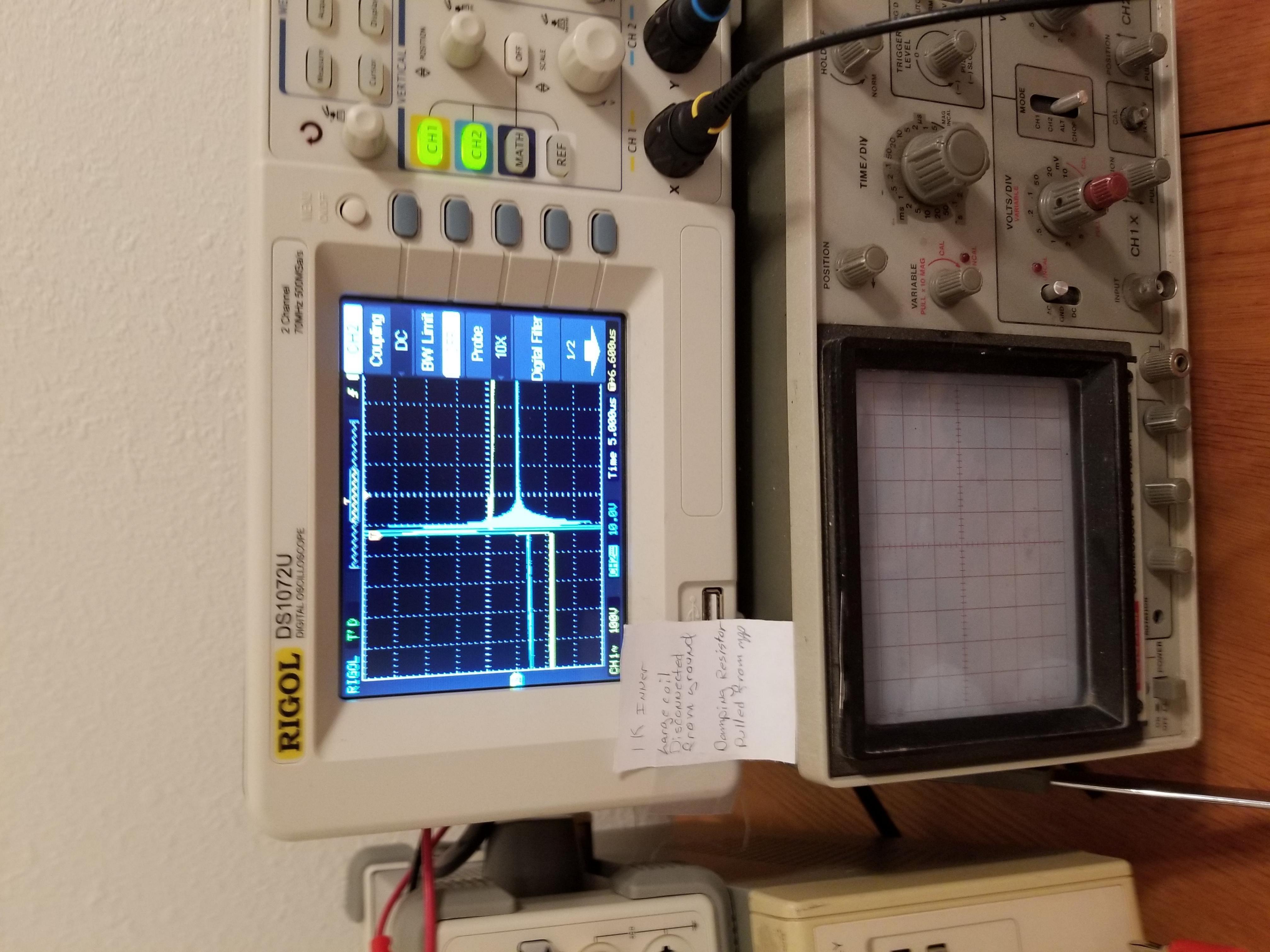

                    So by these three end shots I choose the 230 ohm inner damping value.
                    Here is the coil speed fnally damped with the 230 ohm inner resistor.
Name:	final damp 230 ohm inner .jpg
                    this is conservative and I can push it to 4.6 us
                    Any way you look at it this is a fast coil, with your shielding the speed hardly changed if at all really.

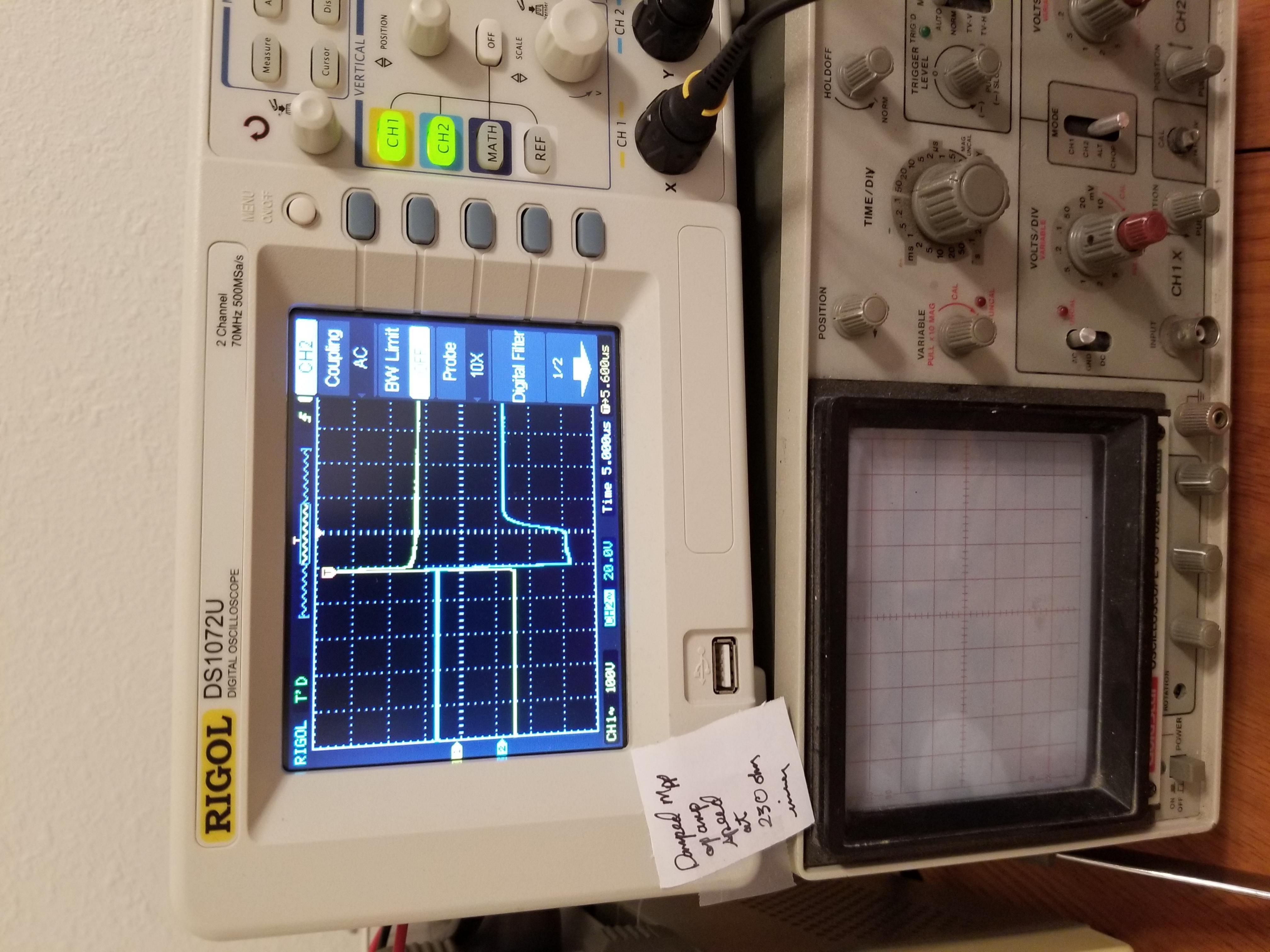

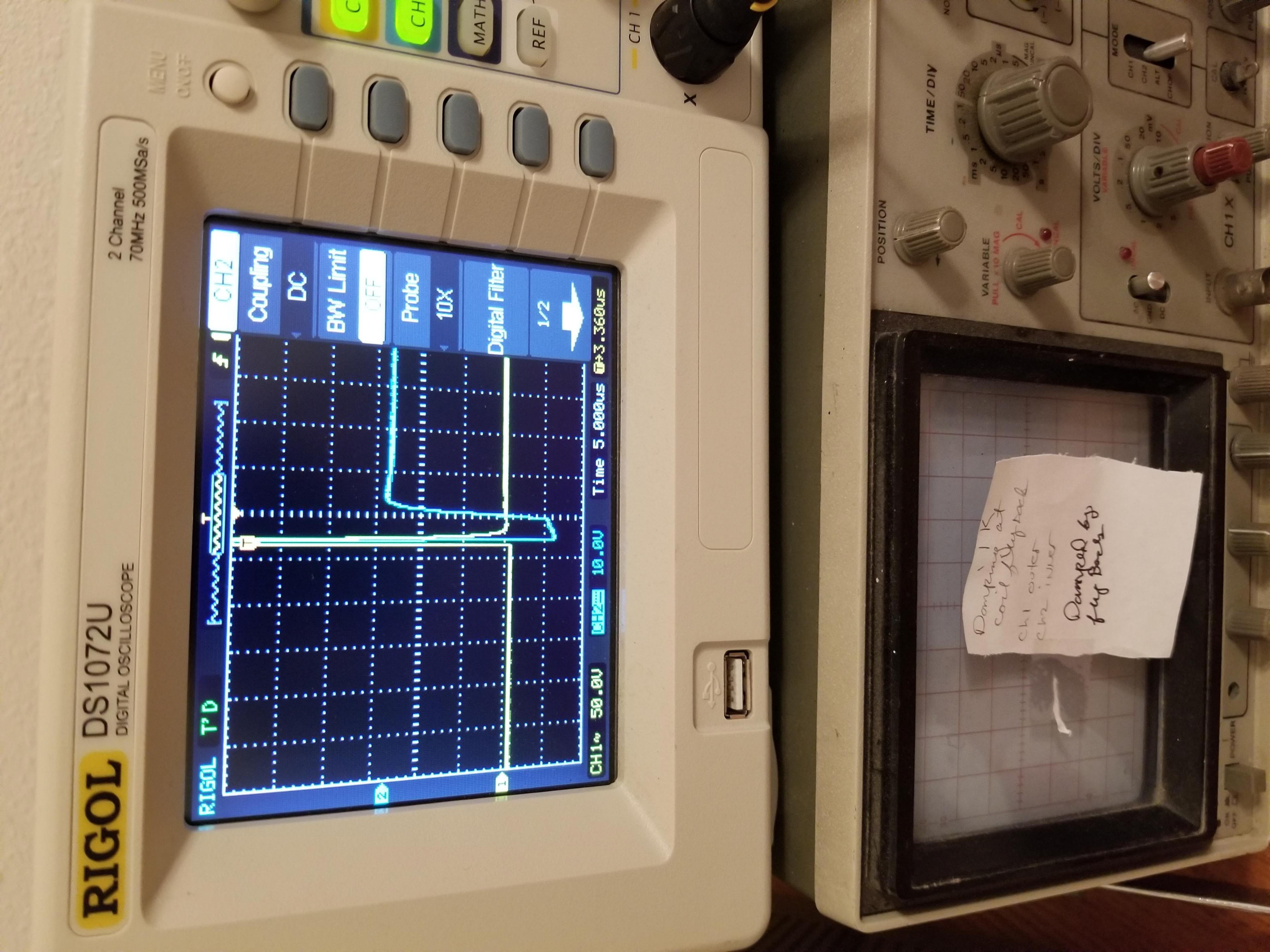

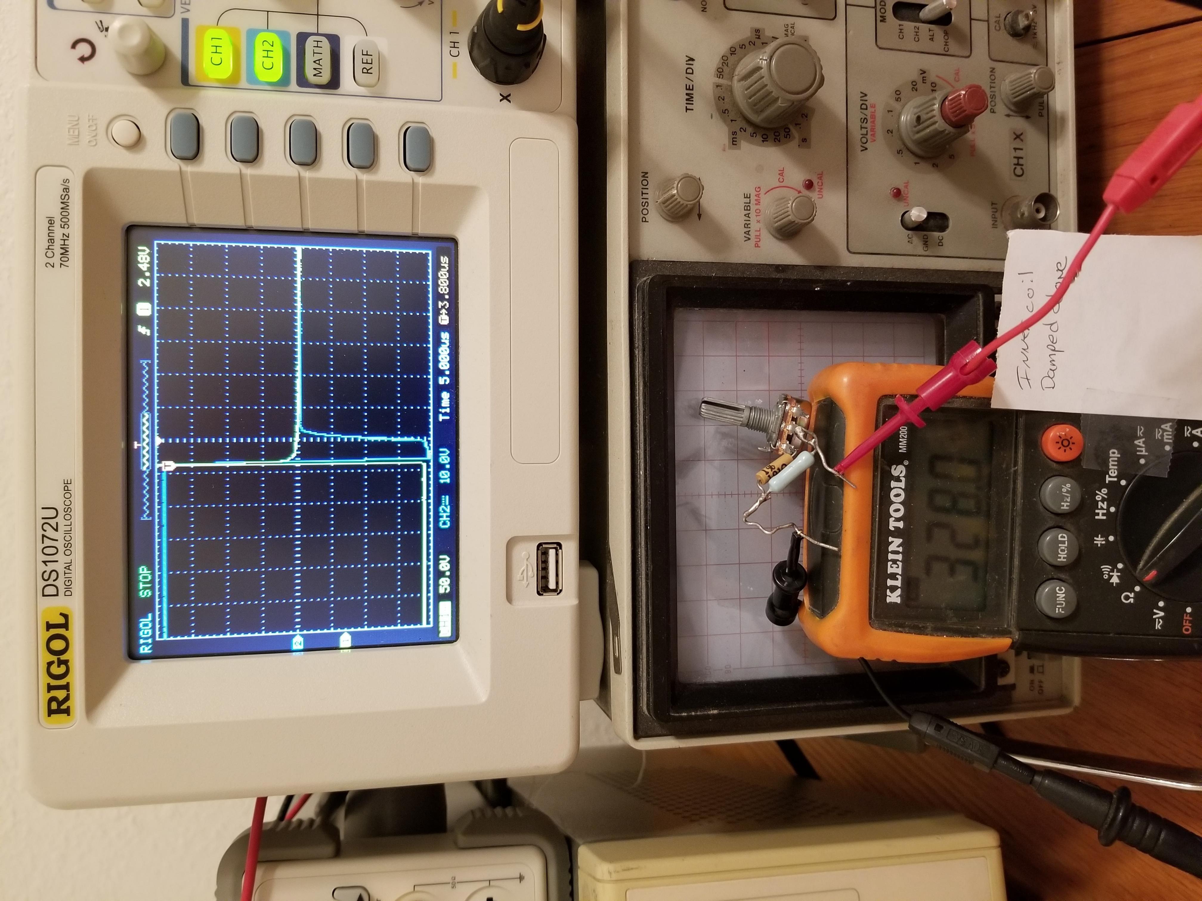

                        • Hi Green,
                          Sorry for dragging this out rough week behind me.
                          First I forgot to thank you in the last post for sending your coil. Its been interesting having a shielded coil assembly to test.
                          Im just starting to learn more about shielding. Thank you
                          So Ive been trying different methods of damping and inner coil damping resistor values and trying to find a way to view the results on the inner coil once fully assembled.
                          I made a statement at the beginning of the thread that it was easy to damp the dual field coil. My method of damping the inner coil seperatly works good but turns out there is a bit more to the dual field.
                          It comes down to how aggressively you damp the inner coil.
                          In post # 182 dbanner describes what the results end goal of what the damping should be not just a test method.
                          "A circuit with a value of resistor that causes it to be just on the edge of ringing is called critically damped. Either side of critically damped are described as underdamped (ringing happens) and overdamped (ringing is suppressed).
                          The critically damped response represents the circuit response that decays in the fastest possible time without going into oscillation."
                          This is what I consider a aggressive damping stratagy for the fastest speed a coil is capable of. Ive always damped my coils with this mind set as well.
                          When I originally damped my dual field inner coil I damped to the fast side and noticed ringing when a target was introduced. Less agressive damping of the inner coil seemed to fix it, I can now show it by the end of this post, I hope.
                          With that said I want to add that once the two coils are joined you can change the inner resistor around willie nillie and still damp the final coil at the op amp and have it look perfect. The inner coil is hidden and compensated by the outer coil. the higher the damping on the inner coil the lower on the outer and visa versa>>>
                          Ive poured back through the thread and think Ive maybe found a differance in our inner coil damping set up.
                          Dbanner describes the inner coil should be connected as per patent then the inner coil damped first.
                          Im not sure if you did it that way as well or not.
                          But the way I see it I read the patent as the coil should be damped by its own merets. So in my testing I have seperated the inner coil and damped it alone to get the Rd values Ive used.
                          Ive found a way to check the inner coil after assembly of both coils.
                          At least as best I can.

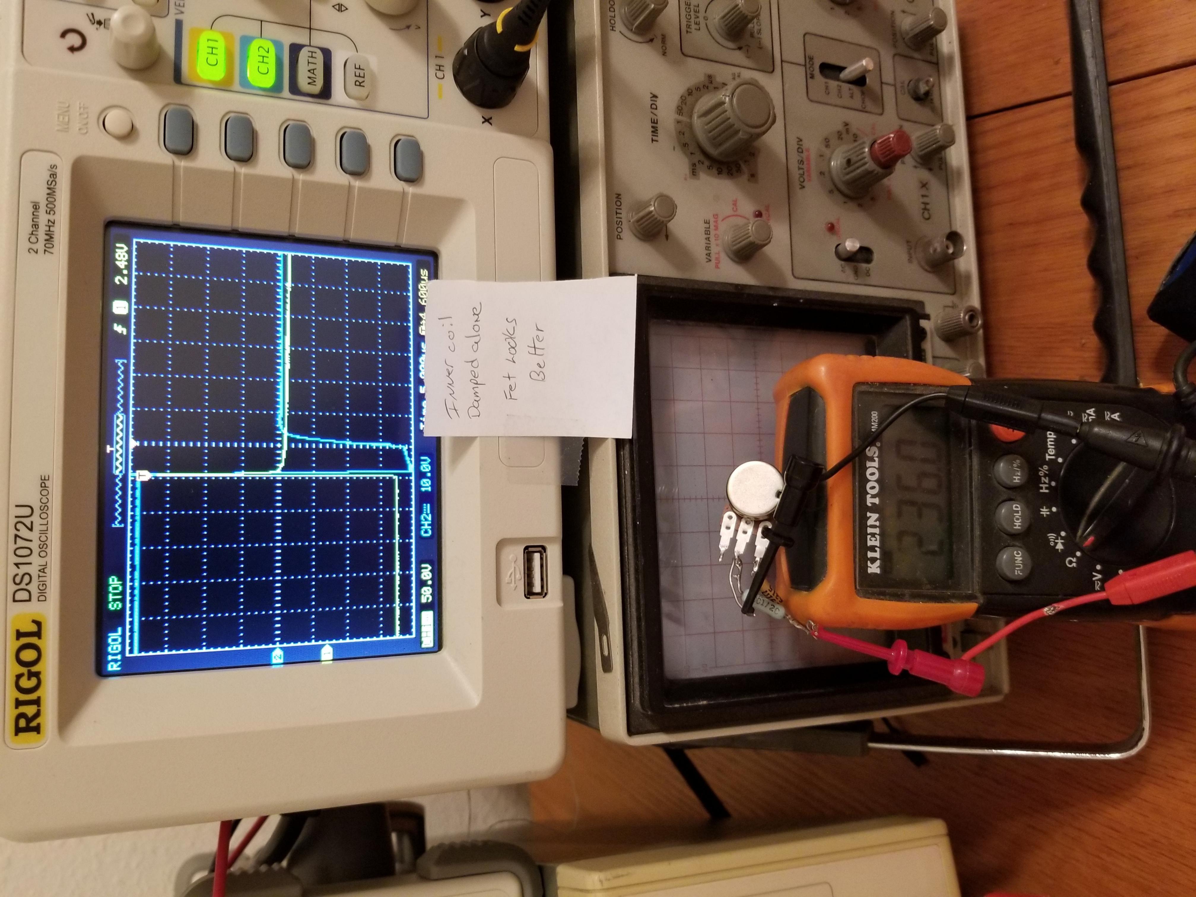

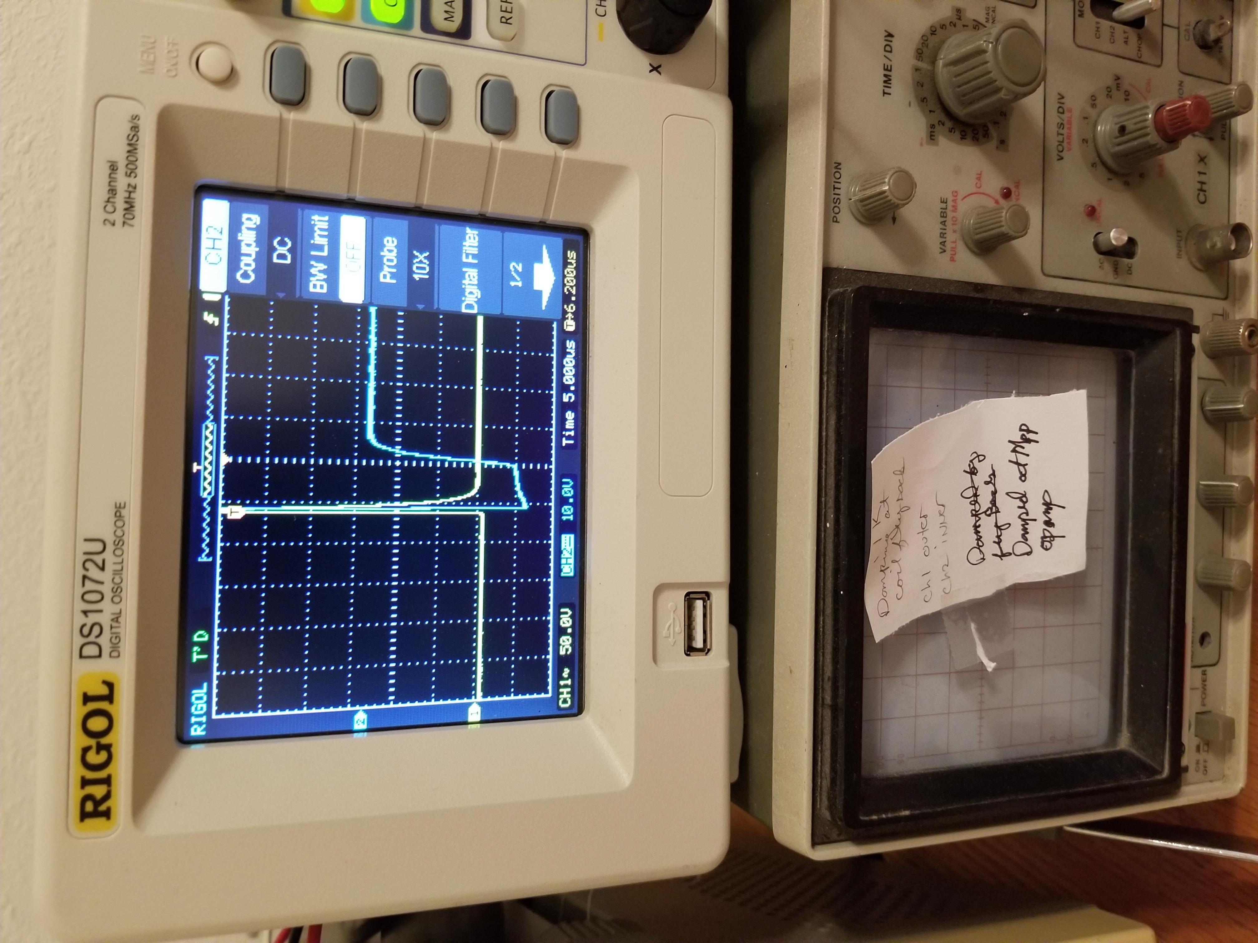

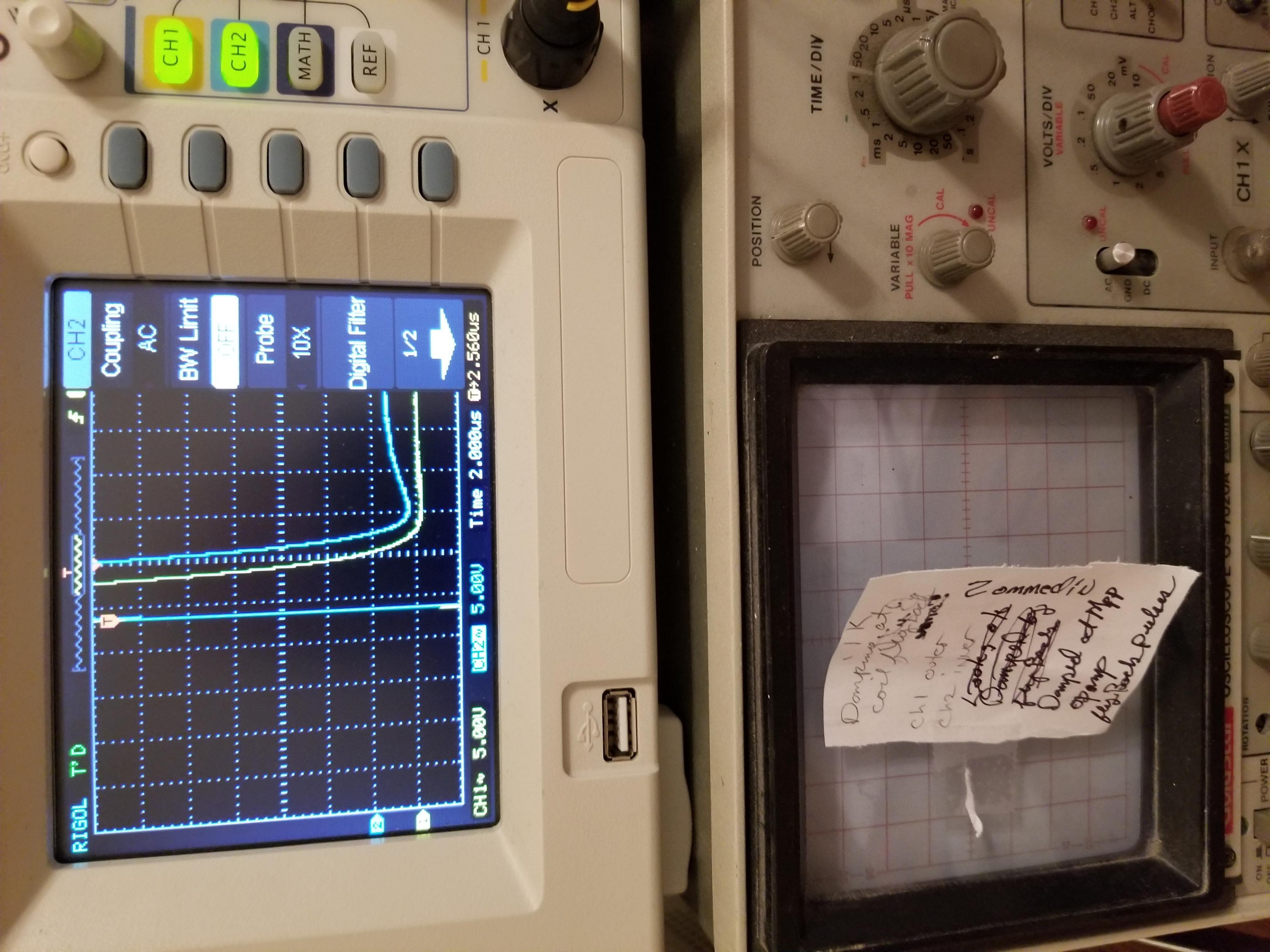

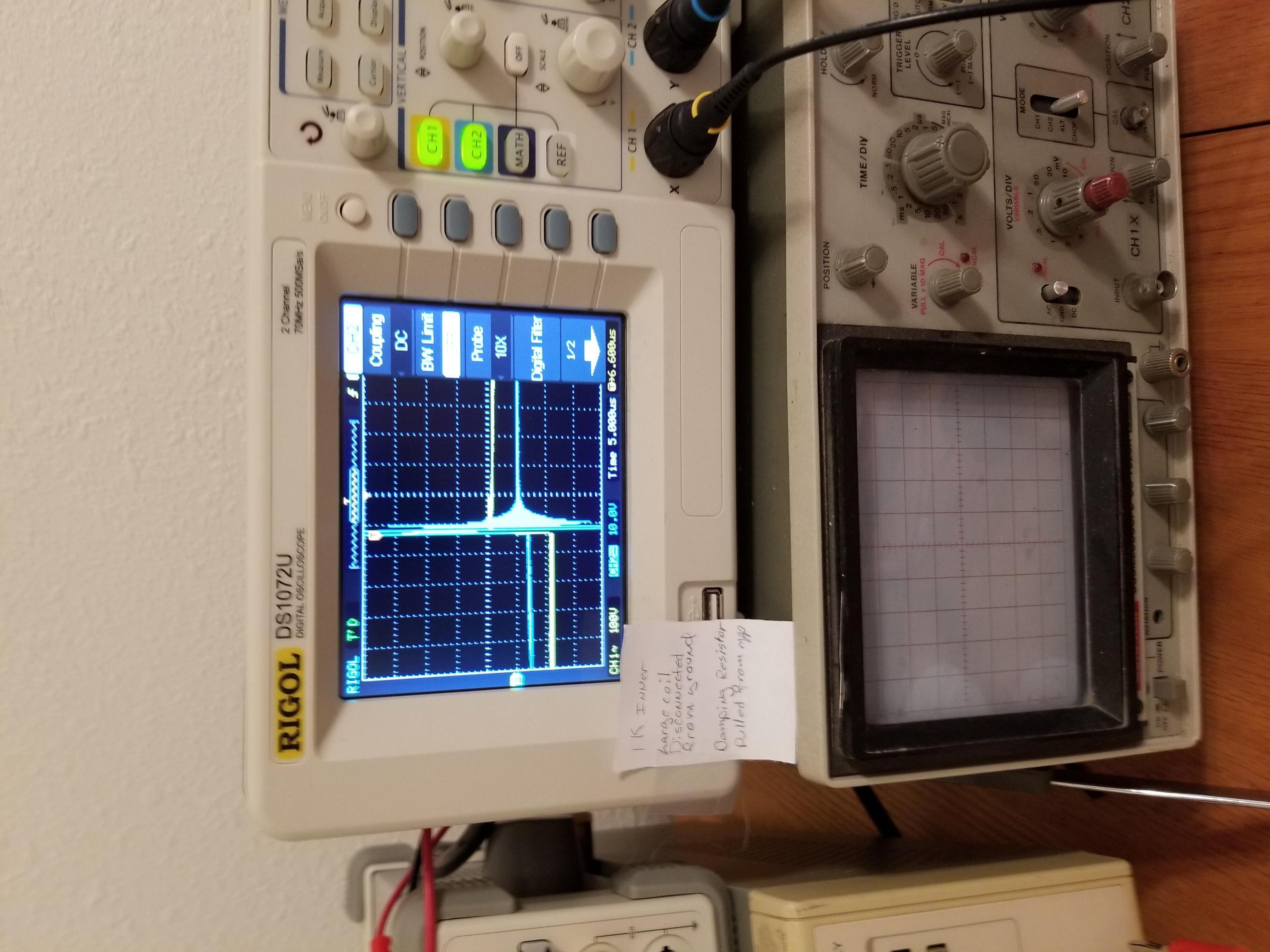

Name:	1 k conservative.jpg
Name:	1k flyback conservative.jpg
Name:	zommed in  1k conservative.jpg
Name:	1k agressive.jpg
Name:	1 k agressive flyback.jpg
                          this post from here all the pictures are in post #249
                          • Another thing to mention and should be taken into consideration for anyone who wants to make a dual field coil.
                            When testing flyback voltages there is a differance between the coils. Both are 115 uh so would think that if everything was perfect the voltages would match.
                            right now its at a 2 to 1 ratio outside to inside.
                            Outside coil 300 volts
                            inside 176 volts
                            Things to consider , adjusting inductance of the inner coil or posssibly coil spacing.
                            When the size of these coils was chosen it was scaled from a 12 " dual field.
                            I thought per the patent they were planar coils but they are bundle. maybe the planar coils need tighter coupling.
                            Just saying.
