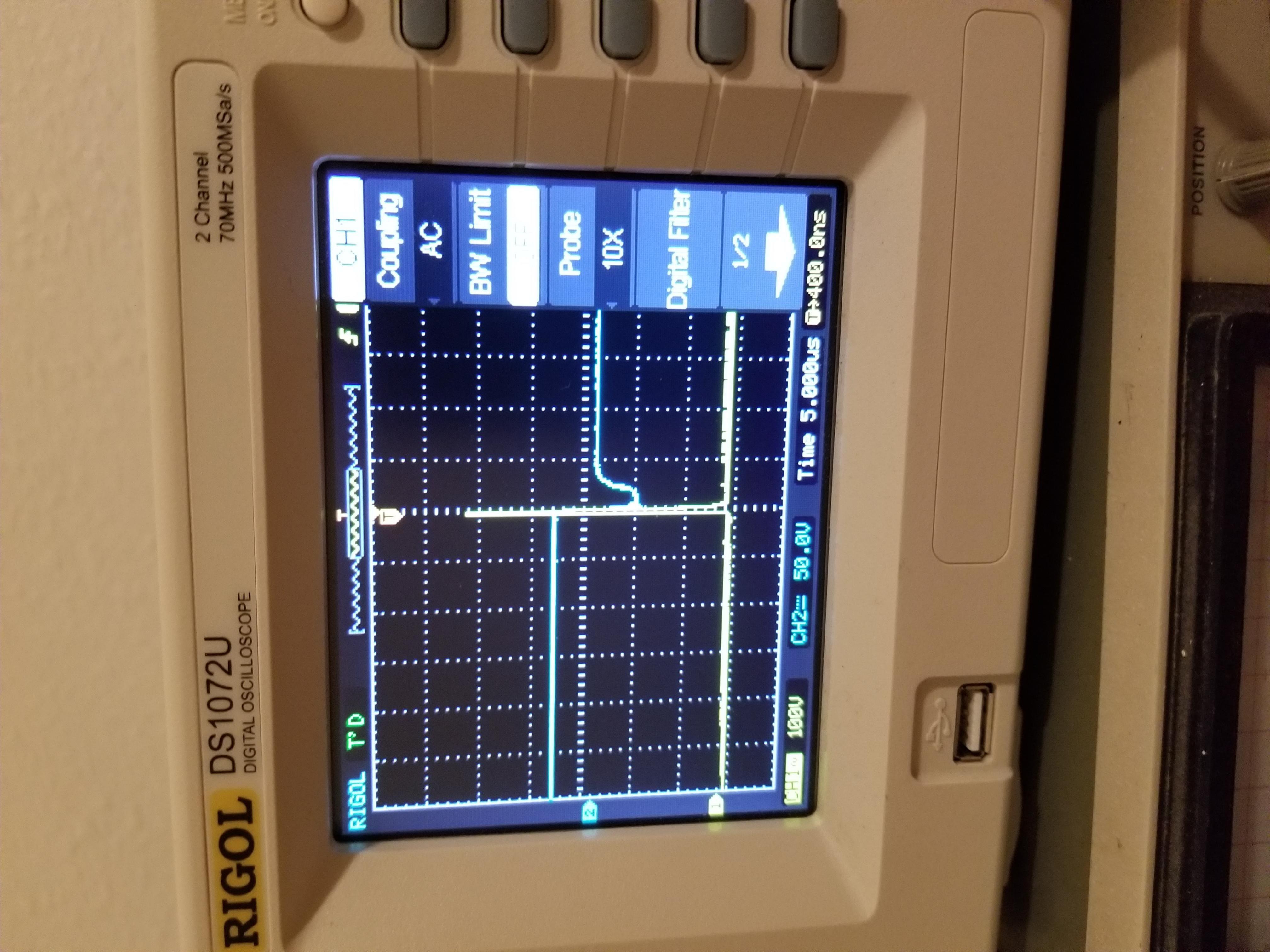

      I went ahead and got the #s on the coils.
      Im a bit suprised by the capacitance of the single coils and the end result.
      the coils are 30 awg tested with no leads.
      Inner coil----------- outer coil---------------combined
      25 wraps135uh-----15 wraps135uh--------309uh
      2.9 ohms------------3.3 ohms---------------5.6 ohms
      1.316 Mhz-----------1.496 Mhz-------------1.639 Mhz
      108Pf----------------83.8pf------------------30.516pf
      scope shot is of both coils together.
      [ATTACH]47610[/ATTACH][ATTACH]47611[/ATTACH]

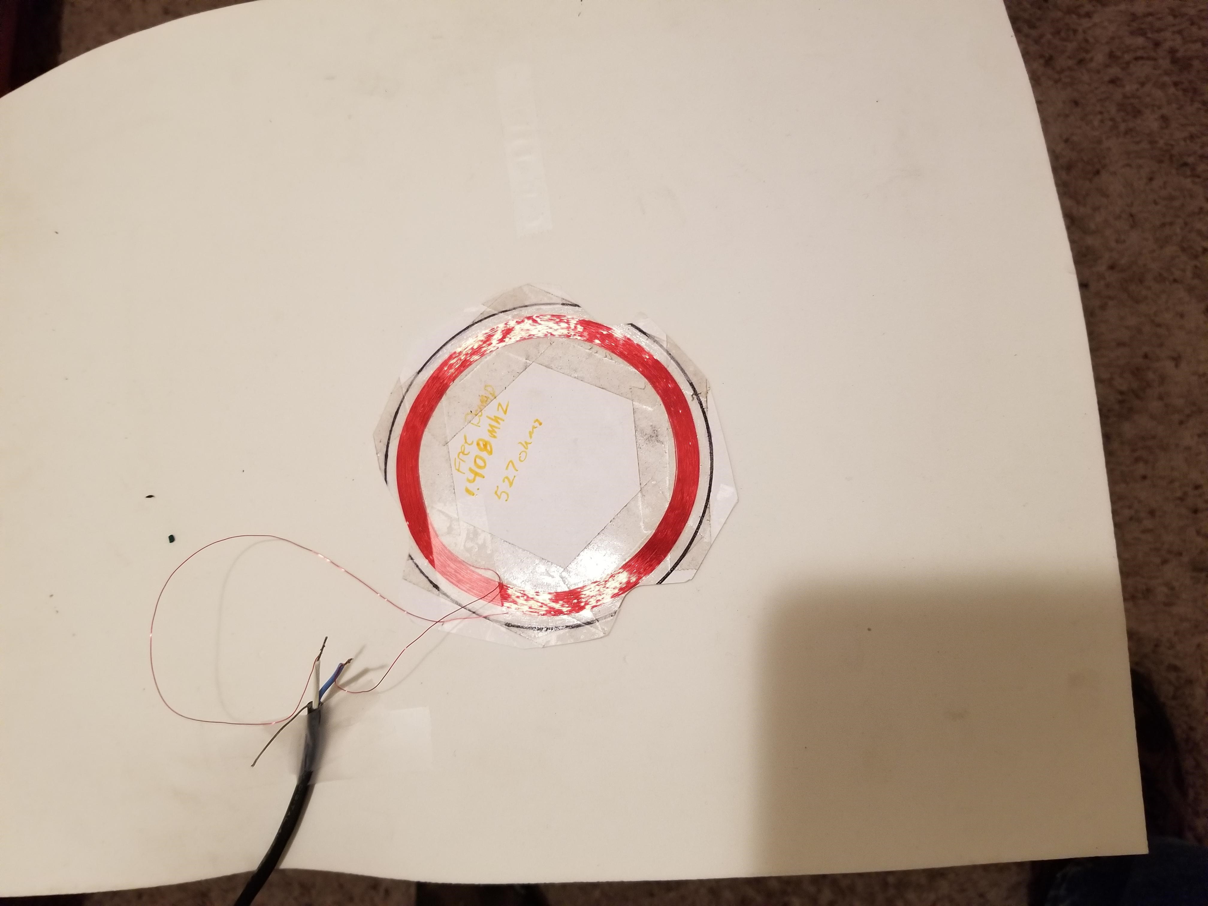

        So Ive damped the coil First time around splitting the two apart and damping the inner coil first as I had originally done on my other coil.
        These results are with the coils connected in the following configuration.
        Tx to large coil +
        Large coil - to Small coil +, at that Connection the damping resistor is connected to the + side of the small coil also.
        Small coil has damping resistor connected to - side and wire continues to - of the tx circut.
        Coils are wound from Inside to out + on the inside -on the outside.
        Here are the shots I took sorry they are fliped.
        Inner coil damped stand alone Damped at 527 ohms.

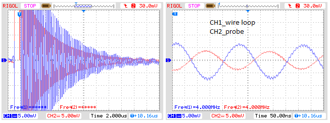

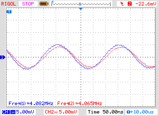

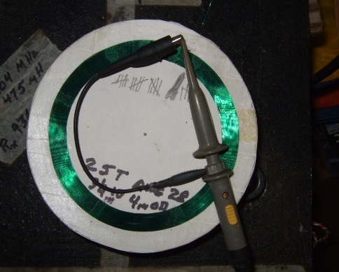

              godigit, you were correct about the probe. Found my original probe, lot less signal. Had a 6inch diameter circle cut from cardboard laying on the desk. Wrapped 1 turn of wire around circle and tried it. Repeated test reply #76.
              Used original probe with 6inch wire loop. Original probe doesn't make a good loop for some reason. Zapped one of my original probes long time ago. Using some we had at work from an old scope that failed and was replaced.

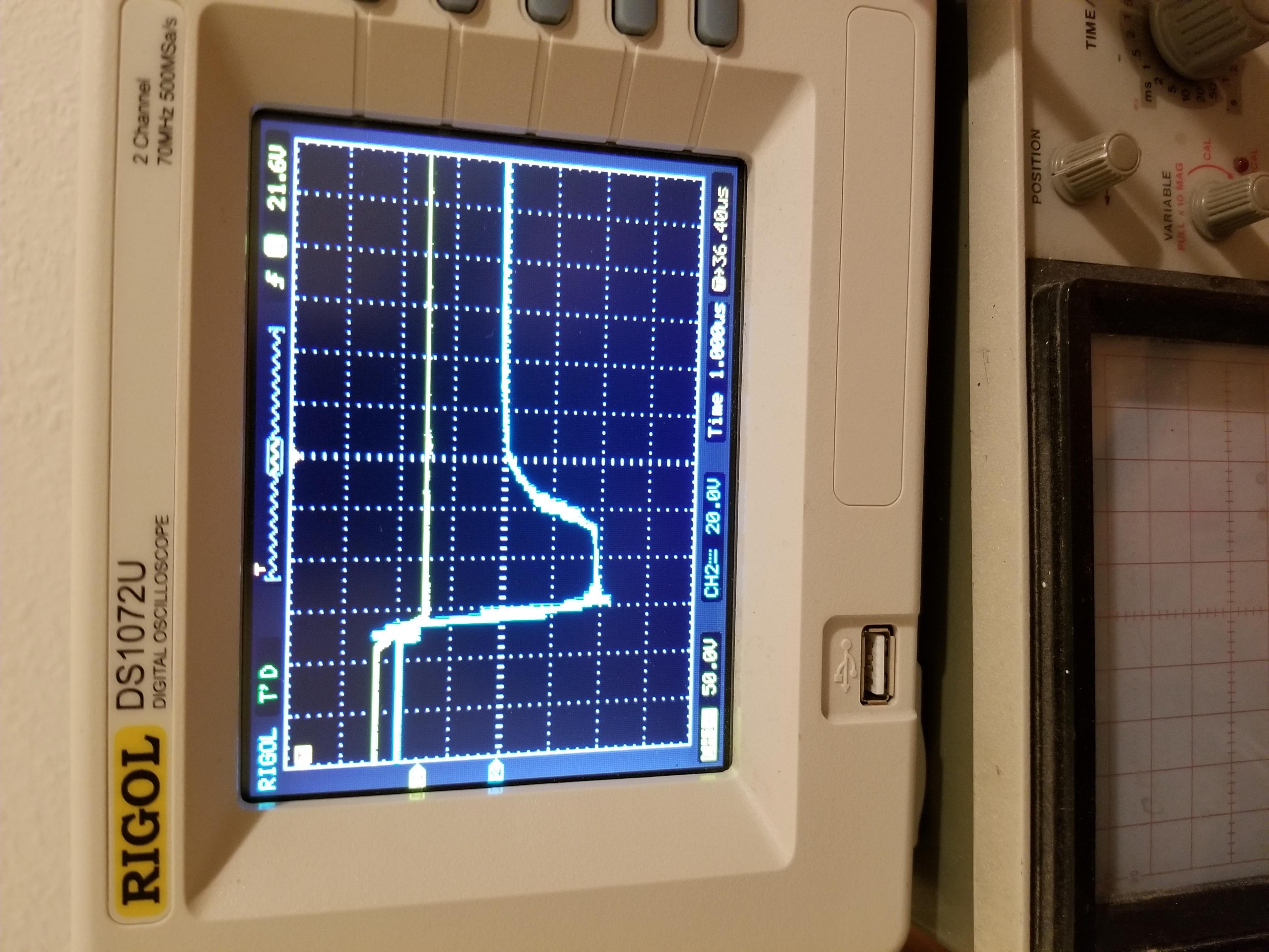

                I also looked at the coils a bit different I set my scope to trigger of the op amp disconnected the probe from the board and used both channels with the probes lying on the individual coils grounds connected to probe end.
                Lying both lops there you can see the Tx flyback on both coils Its hard to get voltages to match due to probe positioning but you can see the end decay is the same between the coils.
                I think this may be a way to check things out once the coil is assymbled .
                Once I make a inner damping set up Ill be able to check this out.
                      I was wrong. RIGOL(original probe)was a lot less signal above because the ground lead was open on the end that connects to the probe. Didn't make a loop. Repaired ground lead. Scope picture with both probes(CH1, RIGOL). The frequency displayed isn't the same for the two channels. Frequency varies a little each sample for each channel when sampling.
                      If you try he loop method, scope should trigger at Tx off. Can use the loop CH to trigger but when I was playing the trigger could be adjusted to trigger at Tx on or Tx off.

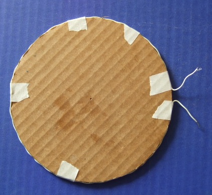

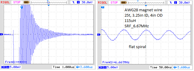

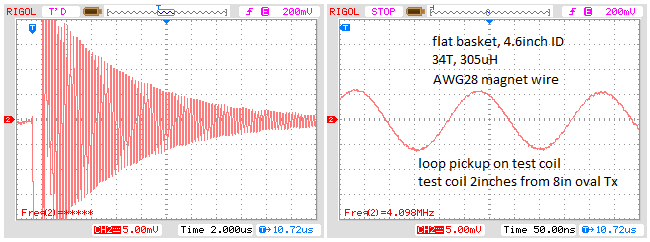

                        Hi godigit, wound small coil. Will wind large coil when we find what we are doing different measuring SRF. Maybe you could try again. We get a lot different frequency, don't think it's because of wire size. I calculate about 5pf coil capacitance.
                        Planning on sending my coils to you when done to see what you measure. Think our coils should measure closer than they do.
                        Calculates 2400R to critical damp.
                        test coil was 2inches above operating 8inch oval Tx PI coil.

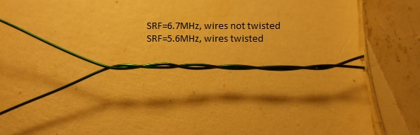

                          I got it working but im only getting just under 10 k out of it. Tried swapping to tlc 555 as its rated for 2 meg and a 555c but only the 555p is working. Im getting a overload type shut down on the tlc Comes up nice signal shuts down and cycles that way. The genney design may not support CMOS type chips.
                          Wondering if it makes any differance on SRF but your tester may have a very rich harmonic content compared to just a detector if thats the right term .
                          Maybe also adding to the srf beacuse your getting almost triple what I am.
                          I think wire and capacitance definatly have to do with it to a extent.
                          5 pf is super low Im thinking the larger wire has a smaller mating surface than the 30 awg. 28 is not that much bigger though so I wouldnt expect that much differance.

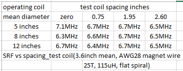

                            A test comparing SRF reading with different size PI Tx(operating coils)and different test coil spacing between operating PI coil. Test coil reply #86. Some variation but not much. Zero spacing with 5inch mean diameter operating coil surprised me.
                            If you can explain another method and someone else can get the same results, this is not magic bbsailor replied in another thread discussing methods for measuing SRF. We aren't getting the same numbers so it's looking like magic. Wondering what we need to do to get close to the same SRF readings. Looks like might need a signal generator that would go to 8MHz to try the signal generator method. Maybe someone that has done SRF measurements could suggest why our measurements are so far apart.
                            godigit, what do you see if you place the loop on the operating coil without the test coil?
